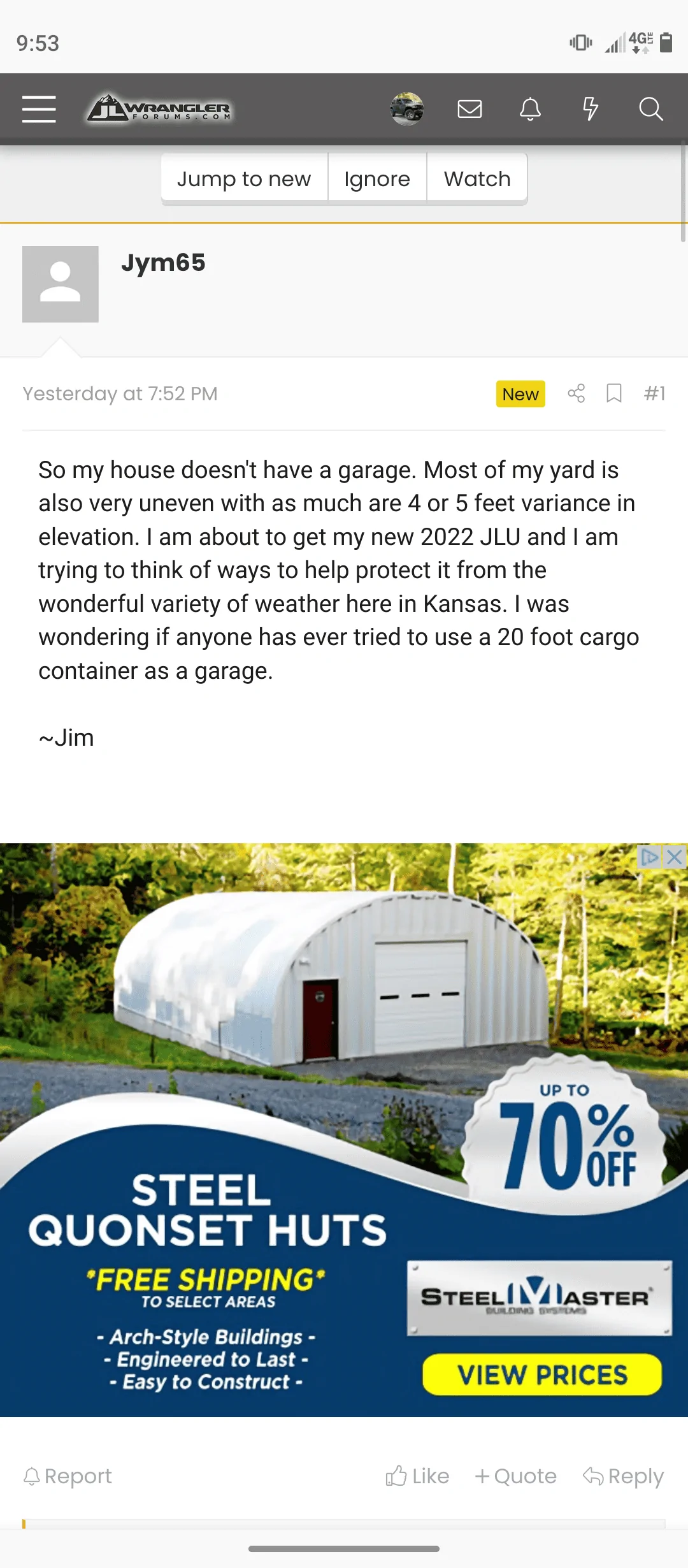

So my house doesn't have a garage. Most of my yard is also very uneven with as much are 4 or 5 feet variance in elevation. I am about to get my new 2022 JLU and I am trying to think of ways to help protect it from the wonderful variety of weather here in Kansas. I was wondering if anyone has ever tried to use a 20 foot cargo container as a garage.
~Jim
This is what I saw when I opened your post.
Jeep Wrangler JL No Garage Screenshot_20221005-095346
