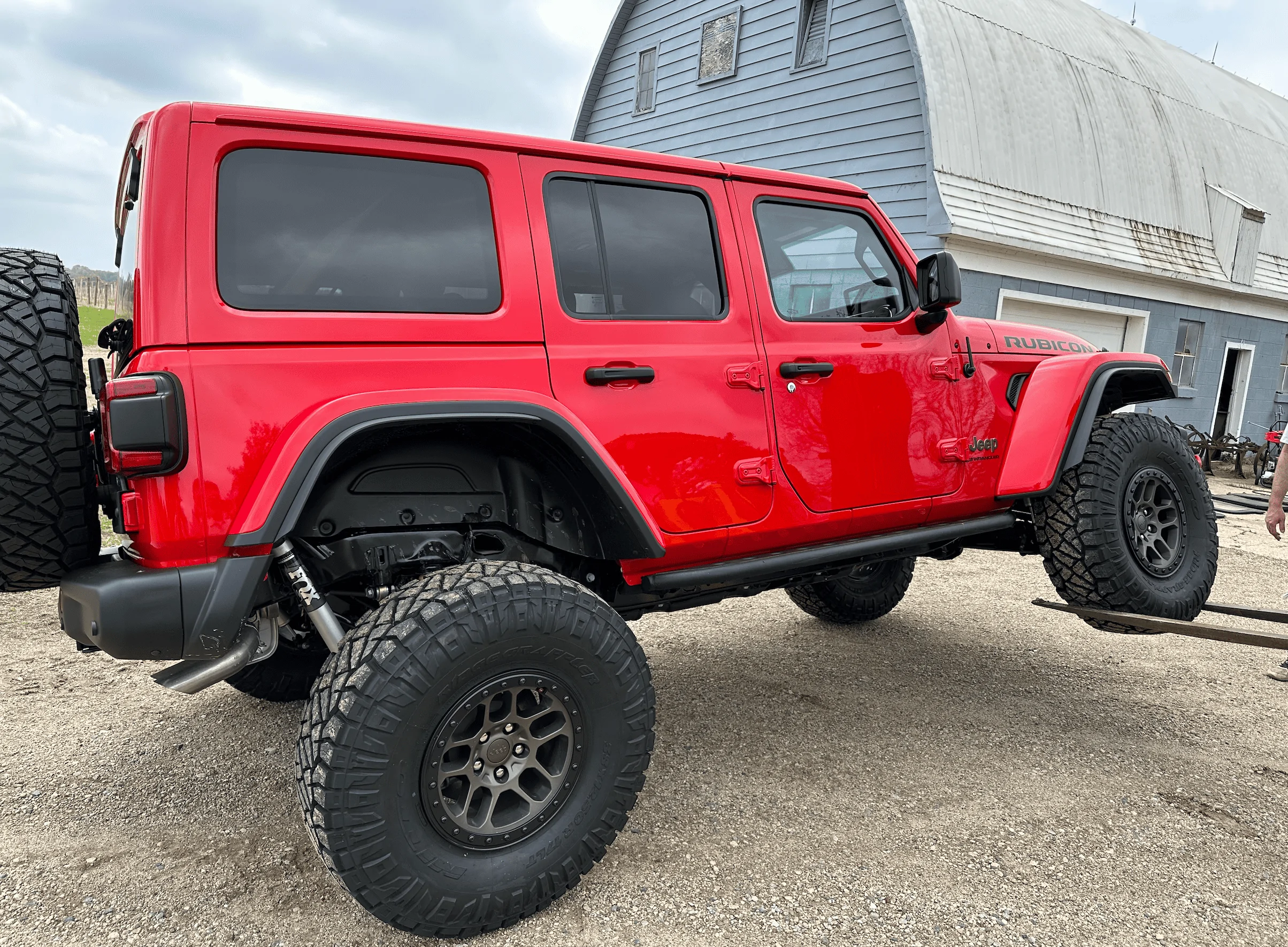

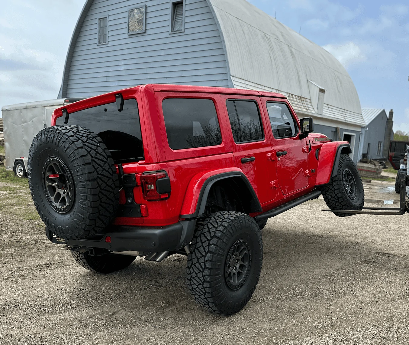

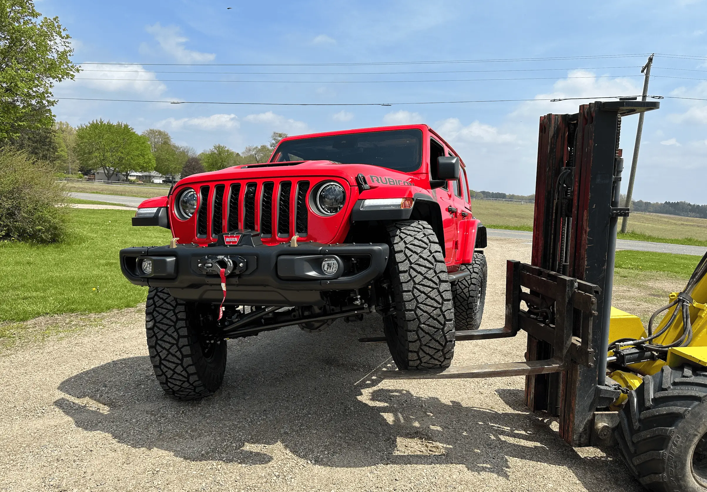

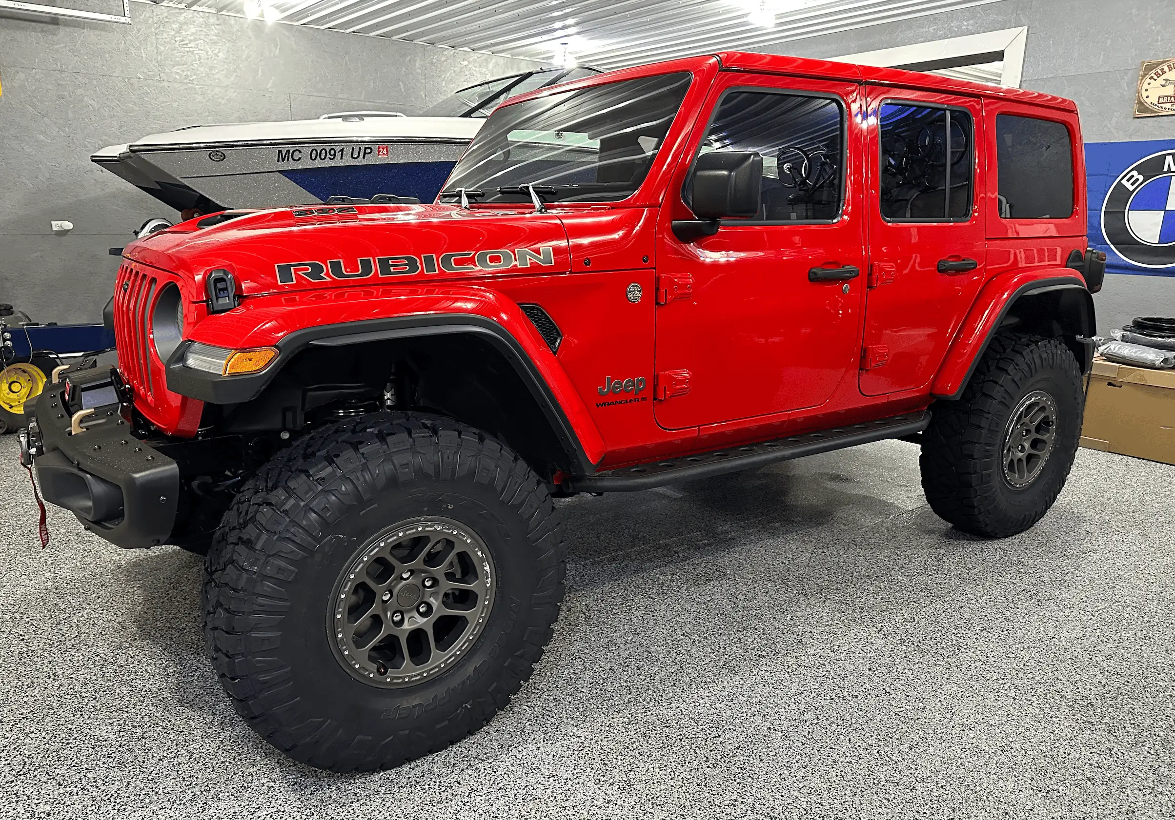

Running 38 12.5 Ridge Grapplers on stock XR wheels (non beadlock config). A little different situation as it's a 392 with 3.5 inch rock krawler springs and end links, Clayton arms (overland plus) and track bars, fox shocks and ATS stabilizer, metal cloak bumps. Coming from 37 BFG's (one set of KO2's and one set of KM3's).
Overall: They are very heavy - took a ton of weight to balance and I still have one that isn't quite all the way balanced yet. Similar road noise to the KO2's - they are very quiet. Running them at 28psi and the ride quality is good but does feel a little more "floaty" vs 37 BFG's. They would not fit on my factory reinforced tire carrier. Installed the teraflex Atlas carrier on the factory reinforced and relocated tailgate and they fit perfect - could fit a 39 on on there I think.
Only have about 800 miles on this one so far and no trail runs yet to report performance there, but so far pretty happy with road manners and ride comfort. I slightly regret not getting the 39" KM3's at this point (slightly) - bit of a BFG fan so it was tough to take the leap to try these. Drummond Island Michigan end of July so will have more feedback after we really test 'em.
