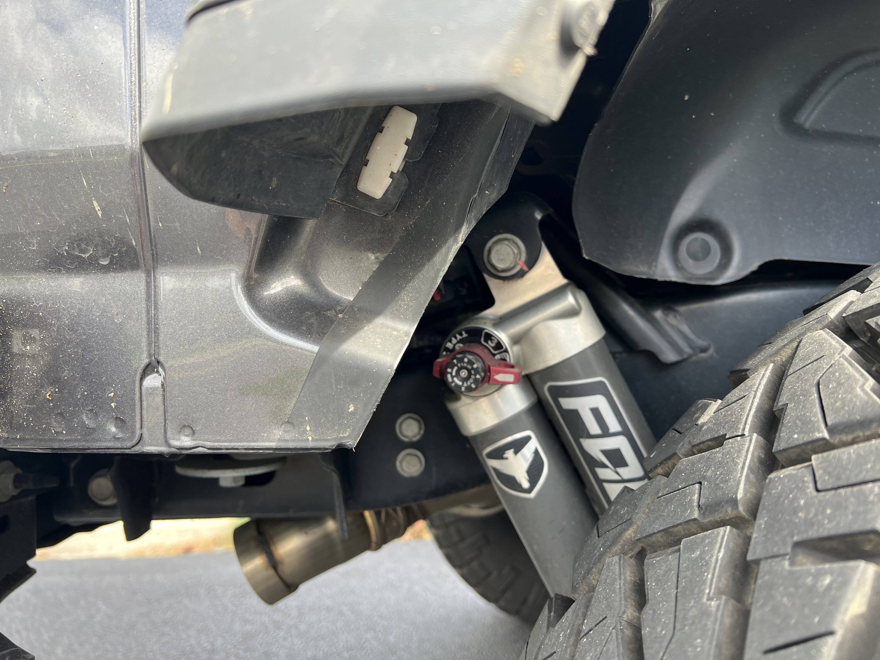

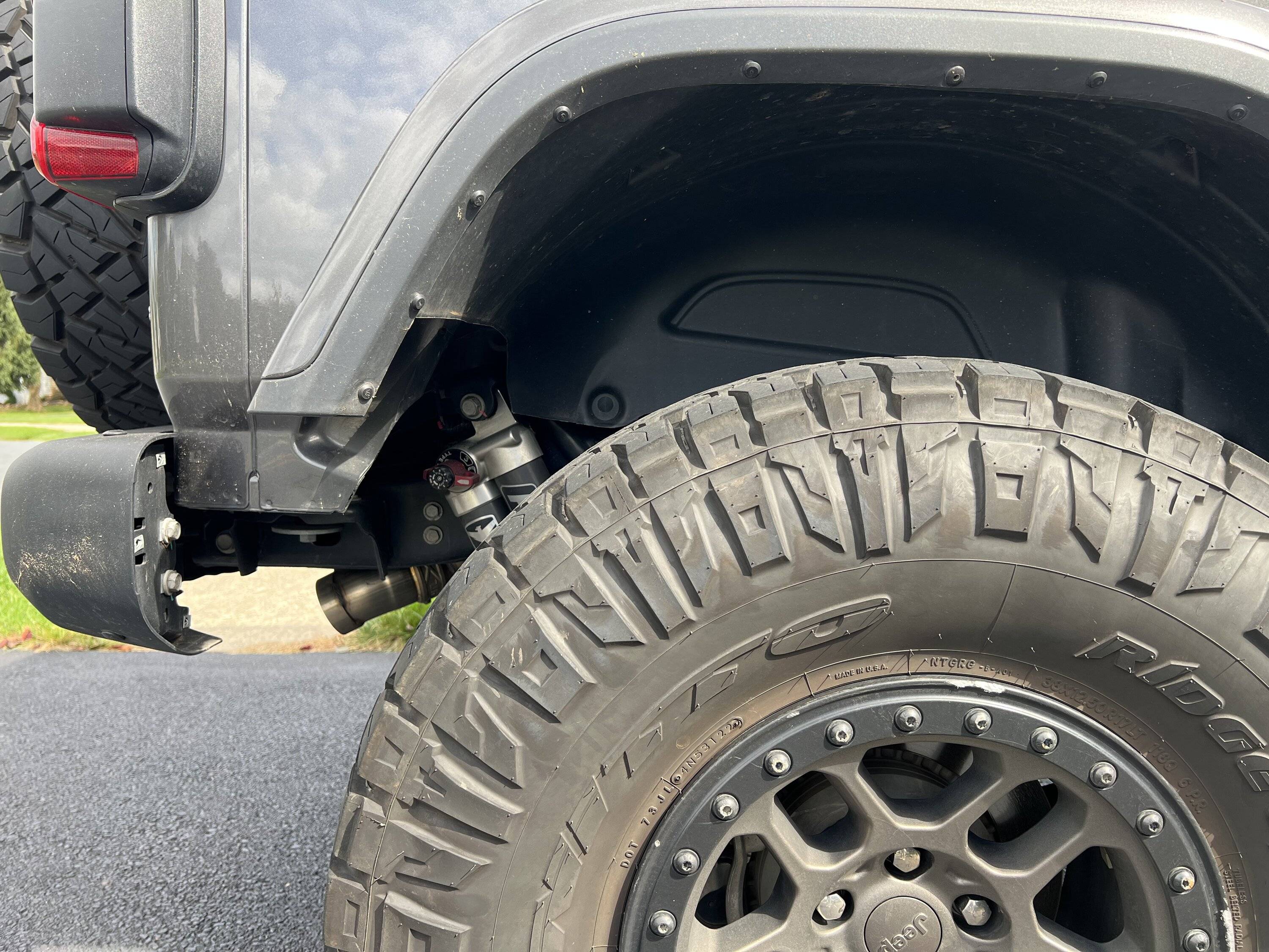

I’ve been super happy with the 38” RGs. They are quiet and smooth on road and have good traction offroad, especially for a non-MT tire.
I’m still running the stock 4.56 gears that come with the XR package. While still plenty of power, there was a noticeable difference in resposiveness when going from the stock 35” tire to the 38” tire. I feel it could use a slightly taller gear, however I’m eventually going to go up to UD60s so I’m not going to regear and will just deal with it for now.
I also had to trim about an inch and a half off of the rear pinch seam on the body to keep the tires from rubbing at full flex off-road (see pics below). Not a big deal. That’s with the 3.5” Clayton lift.

It’s a 2022 392 with the XR package. I’m still running the XR stock wheels (which have since changed for the 2024 MY), which I believe are a -12mm offset. I am not running any spacers which may have contributed to the need to trim the body despite the 4” of bump and a 3.5” lift.
I am running the Teraflex carrier and hinge gate. It’s very stout and has the fit and finish that I think is better than the stock Mopar reinforcement. No rattling.
I’d say without the 392 engine you’d need to regear on 38s. The 392 provides enough power and torque for me to get away with the 4.56 gears.
Unless you plan to take off-road often, I would not recommend an axle swap. It’s very expensive (around $25k installed, give or take a few grand) and you run the risk of issues down the road that your warranty won’t cover. There are some unique issues with the 392 transfer case and axles that is driving me to consider the swap.
