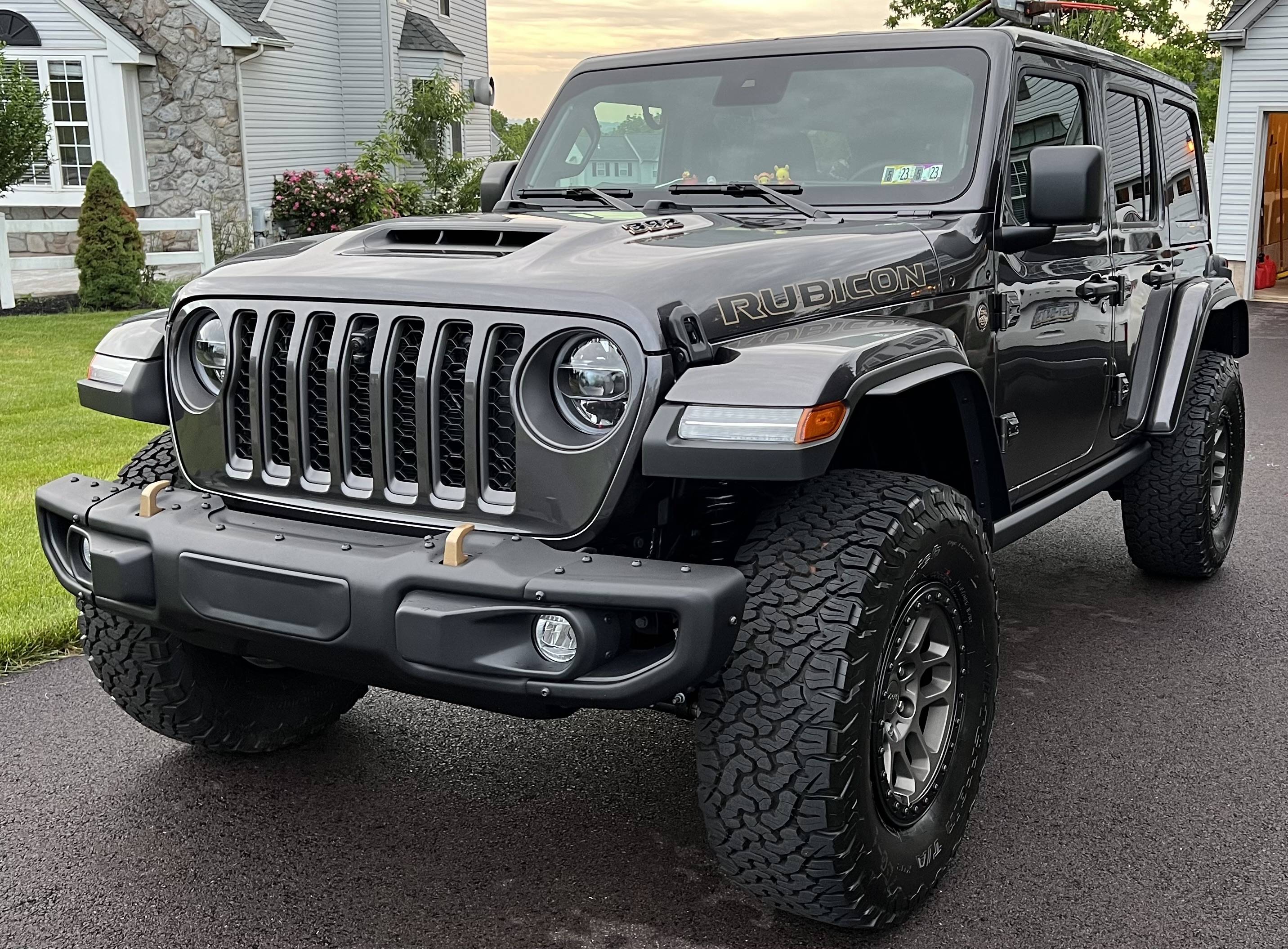

Stock on Purchase Date (ordered 1/19/22, picked up from dealer 6/2/22):
Jeep Wrangler JL Matt's 392 Build Overall - Stock Front Profile
Jeep Wrangler JL Matt's 392 Build Overall - Stock Side

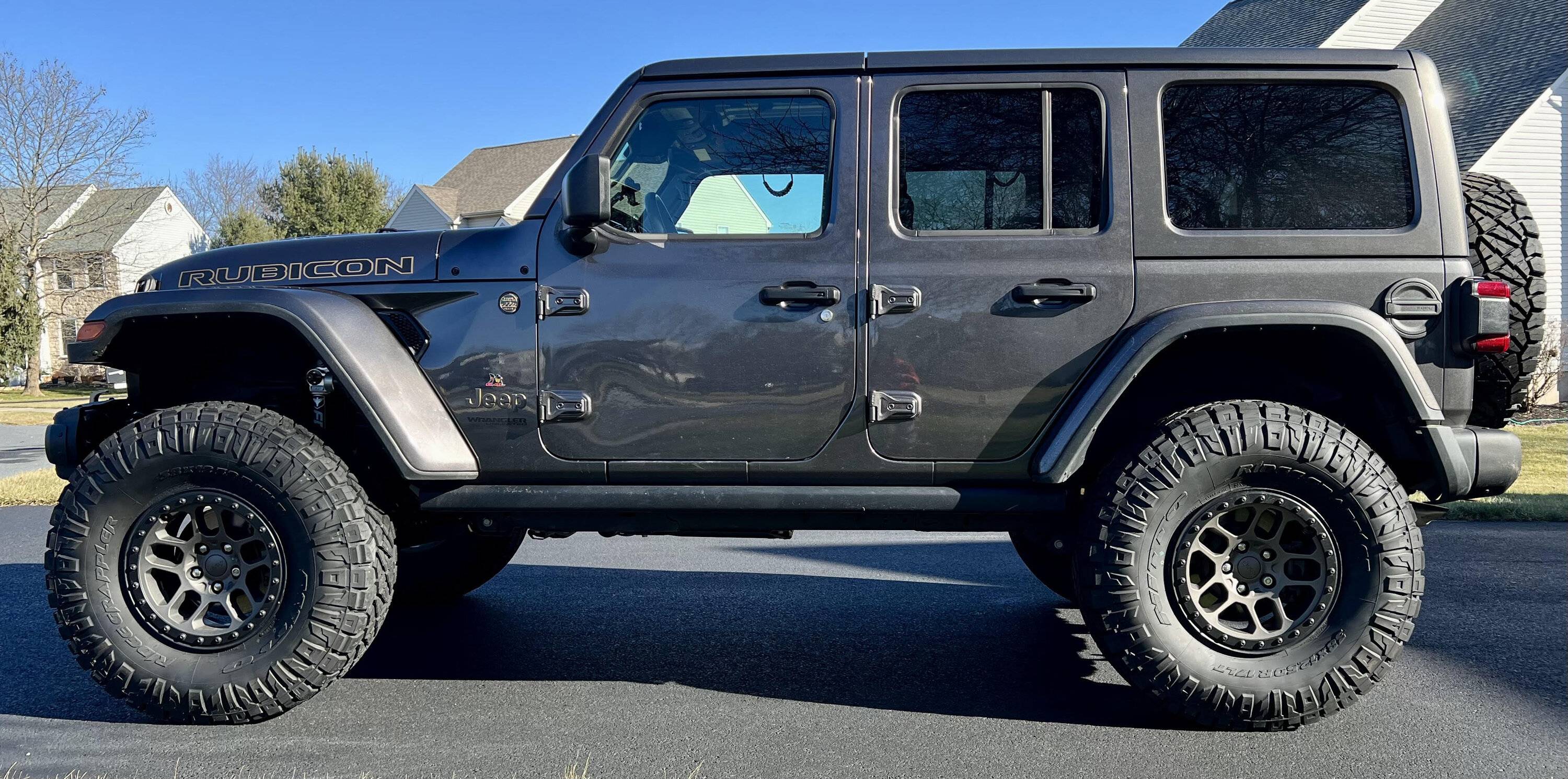

Post Lift (As of January 1, 2023):
Jeep Wrangler JL Matt's 392 Build Overall - Front Angle Profile
Jeep Wrangler JL Matt's 392 Build Overall - Side Shot
Jeep Wrangler JL Matt's 392 Build Overall - Front Profile
Jeep Wrangler JL Matt's 392 Build Overall - Real Angle Full

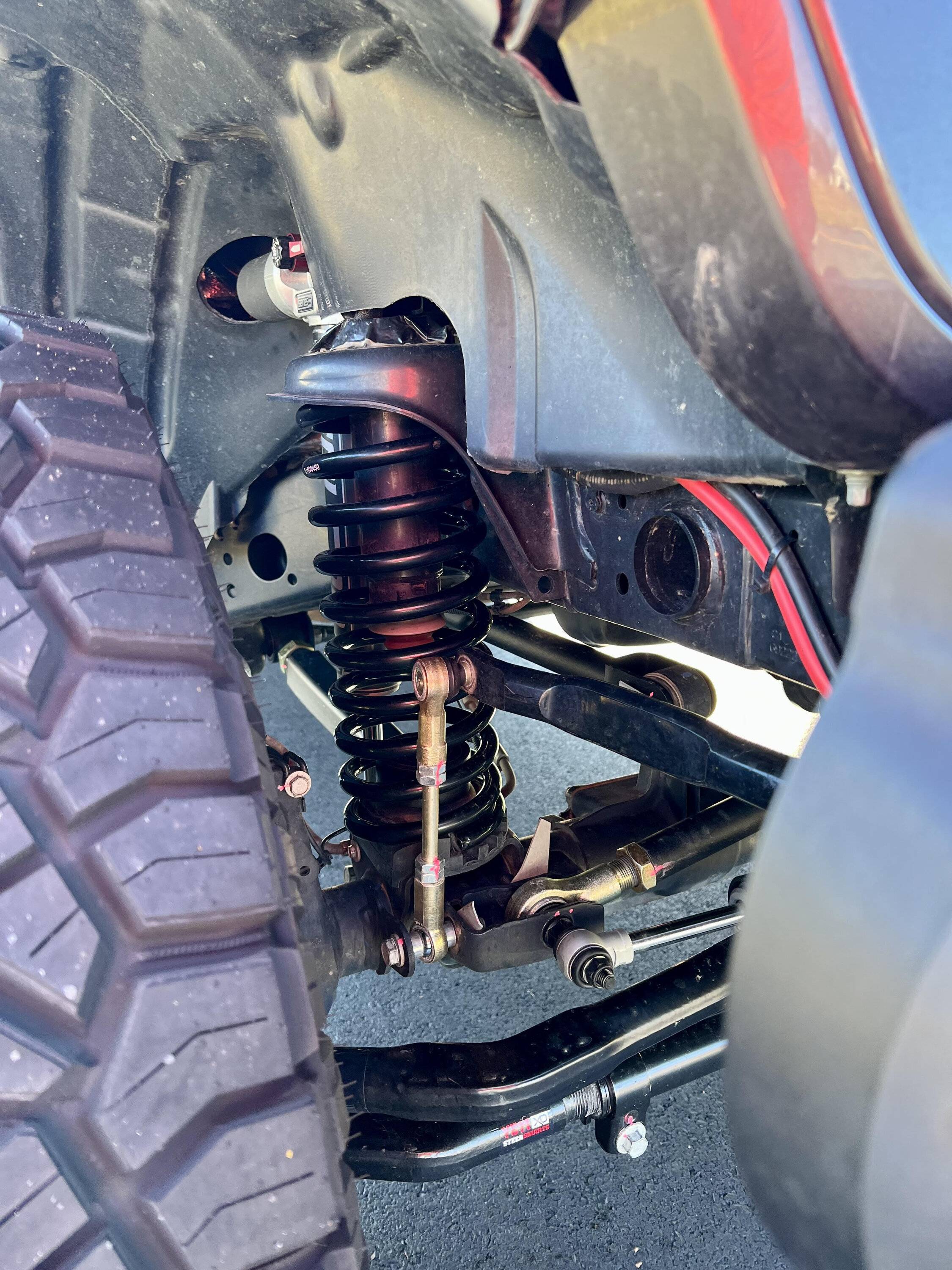

Tires / Lift / Shocks / Steering:

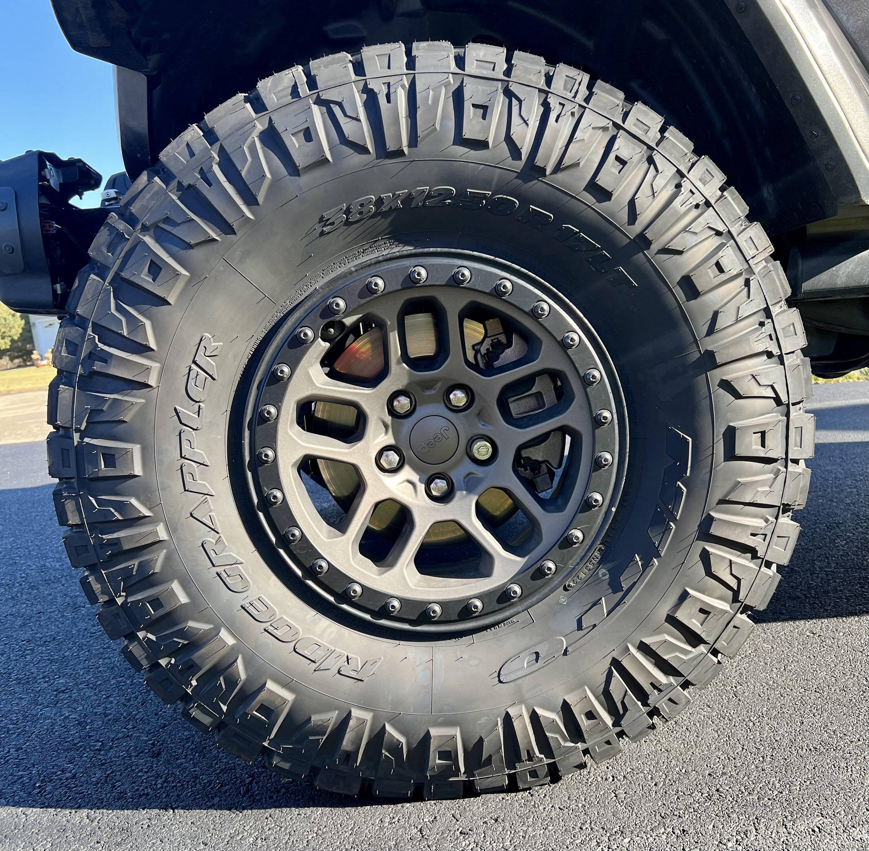

My overall initial post lift impressions are that it drives and handles great, the steering is super tight (much better than stock), and the adjustable Falcon valved shocks are not even comparable to the stock monotubes. You can absolutely feel the Hemi working harder to turn those big tires, and there is a noticeable loss of acceleration and feeling of power. It also handles a little more like a truck now and feels a little less 'sporty'. However, I don't mind that at all given I bought my 392 for its off-roading capabilities, not on road performance.
Surprisingly the 38s fit just fine (at least for on road use) without wheel spacers with the 3.5” lift. I have no rub at all under full lock of the steering. I haven’t yet taken it out on the trails, so not sure if that will hold up under full flex situations. I will report back once I start wheeling again in the spring.

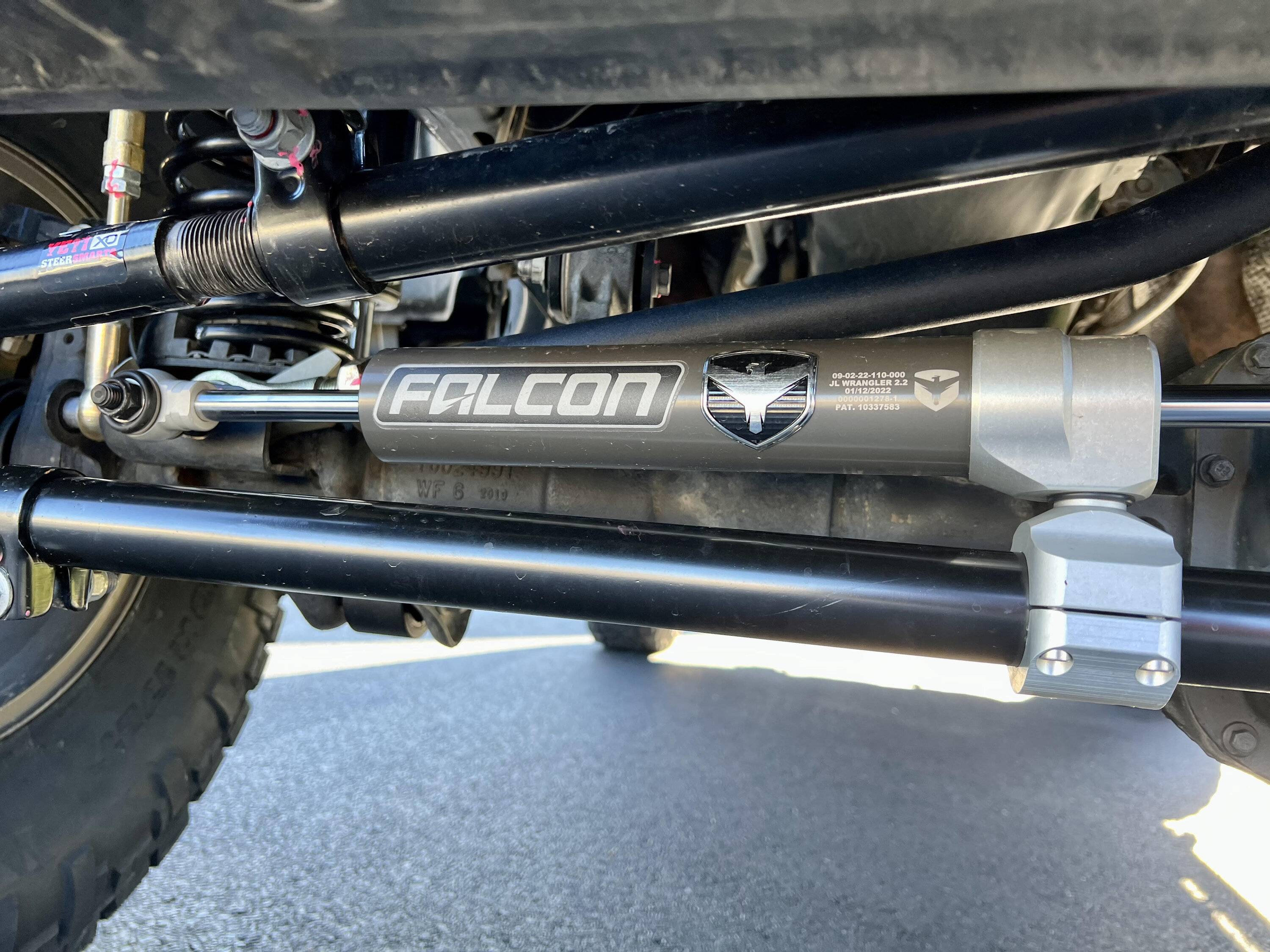

The Falcon steering stabilizer really tightens up the steering, and the front end feels rock solid with the Steer Smarts parts up there. Note that the bracket that the Falcon stabilizer comes with is not compatible with the Steer Smarts XD Tie Rod. Had to get a bracket to mount. The link is below:
https://www.northridge4x4.com/part/...steering-stabilizer-tie-rod-clamp-kit-1-5-8in
I love these Falcon adjustable shocks too. Still playing with the adjustability. So far I like setting 2.4 the best for local in town driving, which allows the shocks to absorb the bumps a little more while keeping body roll down, and 3 (firmest setting) for highway driving. I’ll probably use setting 1 (softest setting) for off road use.

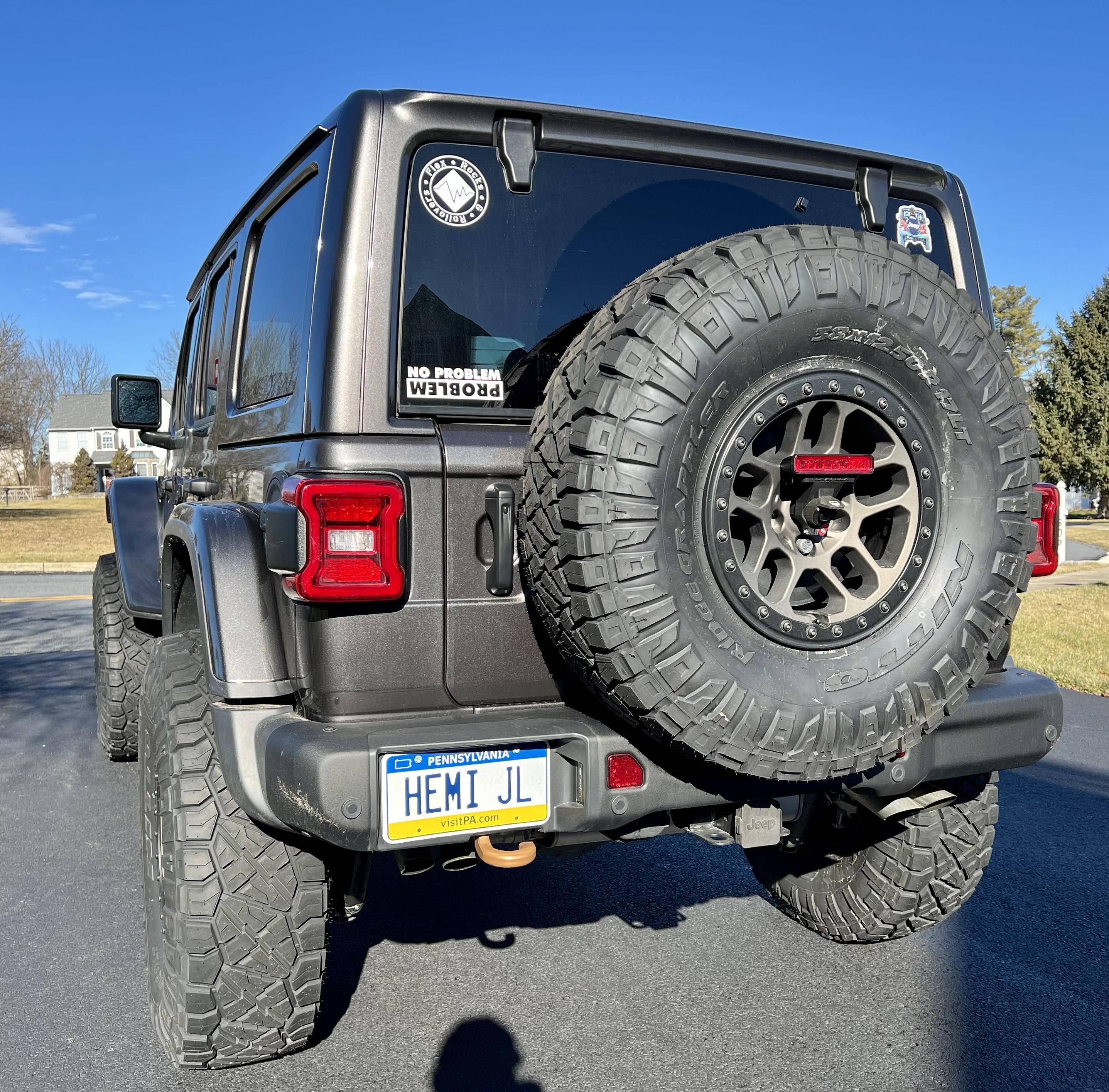

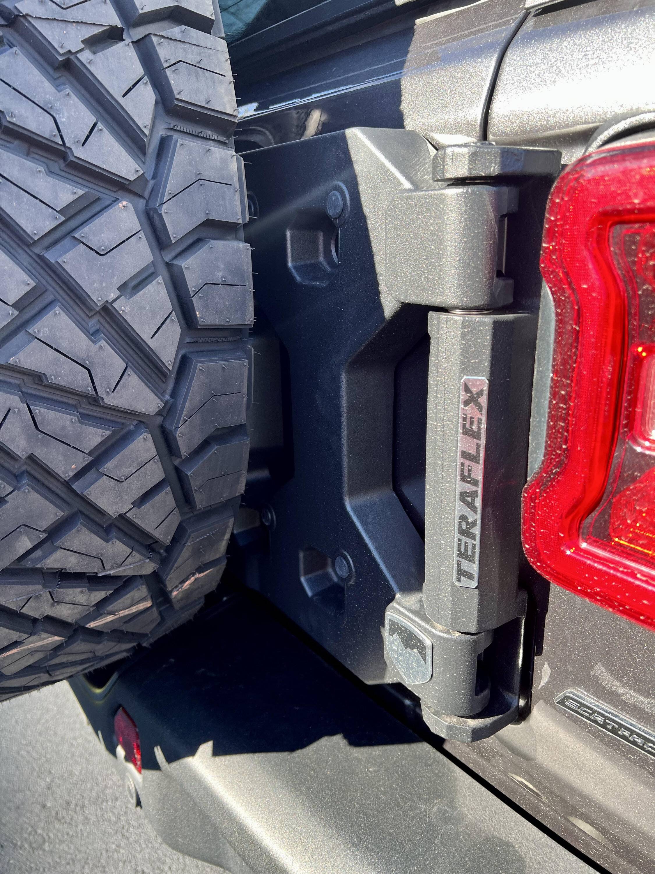

Tire Carrier:
This Teraflex kit is rock solid. Way more solid feeling with a 38” Nitto than the stock one did with the 35” KO2. I did learn in the process that the max tire size with this carrier and the stock rear bumper is 38”. Mine clears, the bottom of the spare tire barely touches the top of the rear bumper (there is no resistance from it touching when I open and close the tailgate). The shop I had install it noted it did take a little longer than they expected to install and align everything. Overall I’m very happy with it, and it looks real clean, just like it was from the factory.

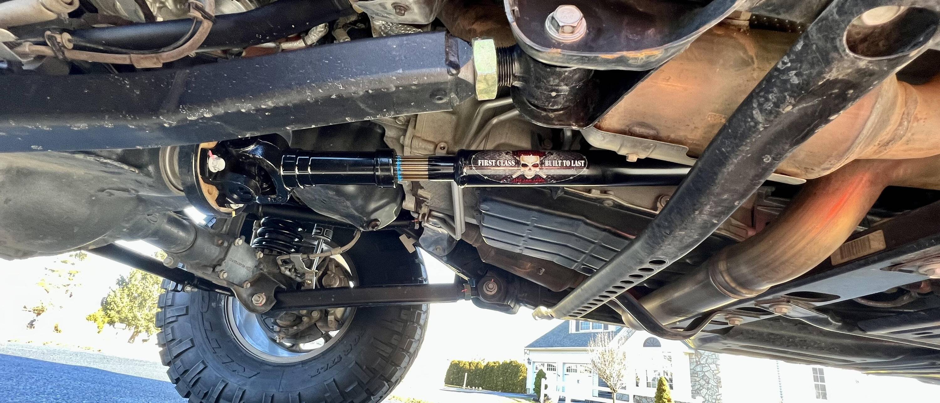

Driveshafts:
The Adams driveshafts are super beefy. They feel much more solid than the stock shafts. Note that with the full-time AWD system that we have on our 392s, the front driveshaft is always spinning (absent using a Tazer to override to 2WD, however I do not want to destroy my axles / diffs so I do not run in 2WD at all). Given there is no aftermarket driveshaft for the JL that has an rzeppa joint, there is potential for driveline vibrations with the single / double carden joints on the Adams (and other brands) shafts. See below link for a whole thread on this forum regarding this issue on the 392s.
https://www.jlwranglerforums.com/fo...et-driveshaft-mega-thread…buyer-beware.88097/
We initially had the caster set to 6.3 degrees (which is optimal for a lifted JL), however this much caster caused the pinion angle to be too low, causing fairly significant vibrations in the driveline above 45 MPH. We adjusted the caster down to 4.5 degrees and boom, all of the driveline vibrations went away. Not optimal from a handling perspective, however it drives just fine and will hold me over until I can get some UD 60s on there down the road, which have a higher pinion angle than the stock axles which will allow for more caster in conjunction with the AWD system on the 392. Note the stock caster is 4 degrees.

Tire Carrier:

I love the Teraflex kit. It looks awesome! I was thinking about doing that myself, although I paused when I read your post and that it took the shop extra time.
The shop said it was the alignment that took the longest. Also they said they had to tear apart the whole back of the Jeep to install. You’d never know it though, they did a great job.
