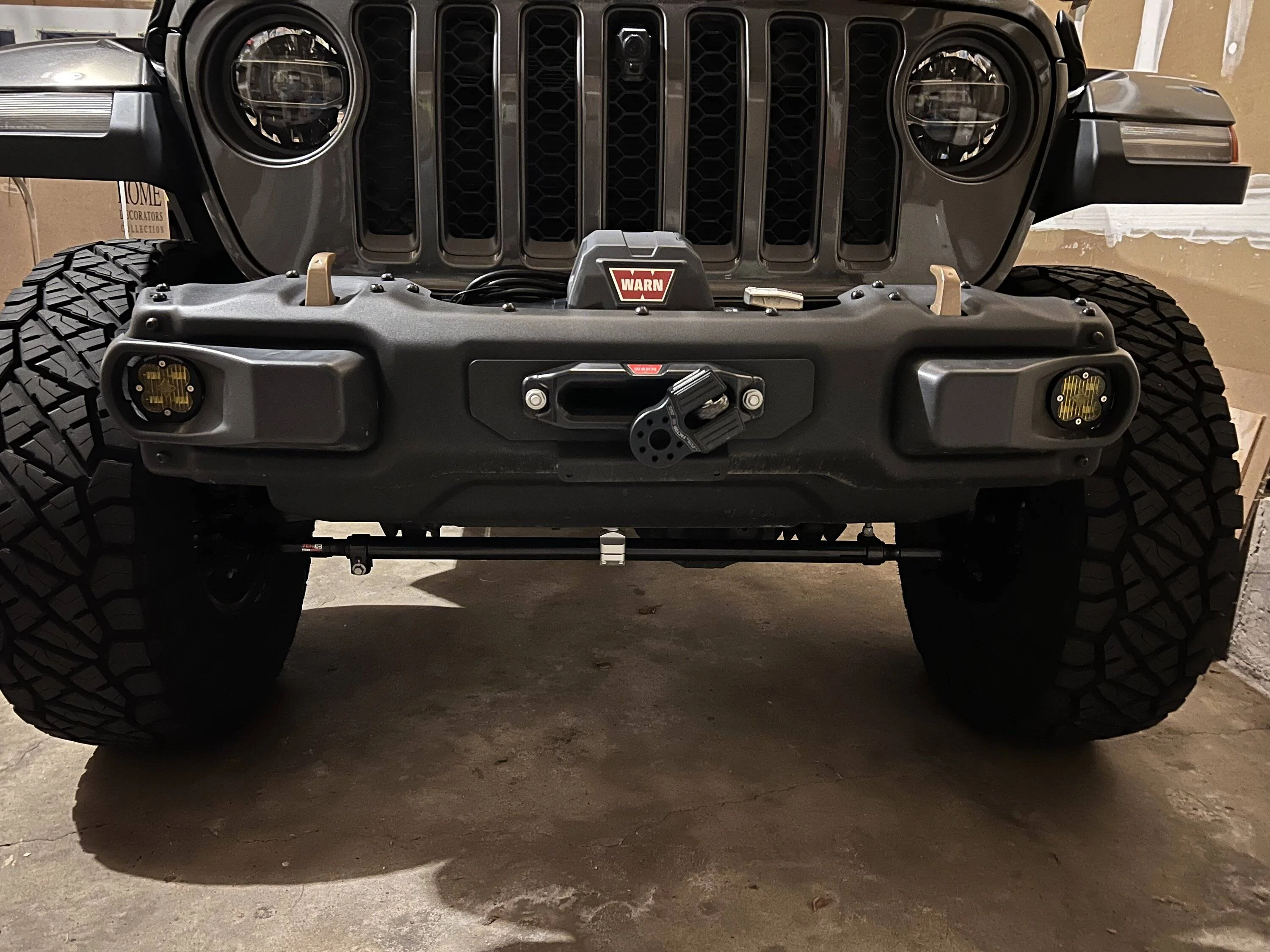

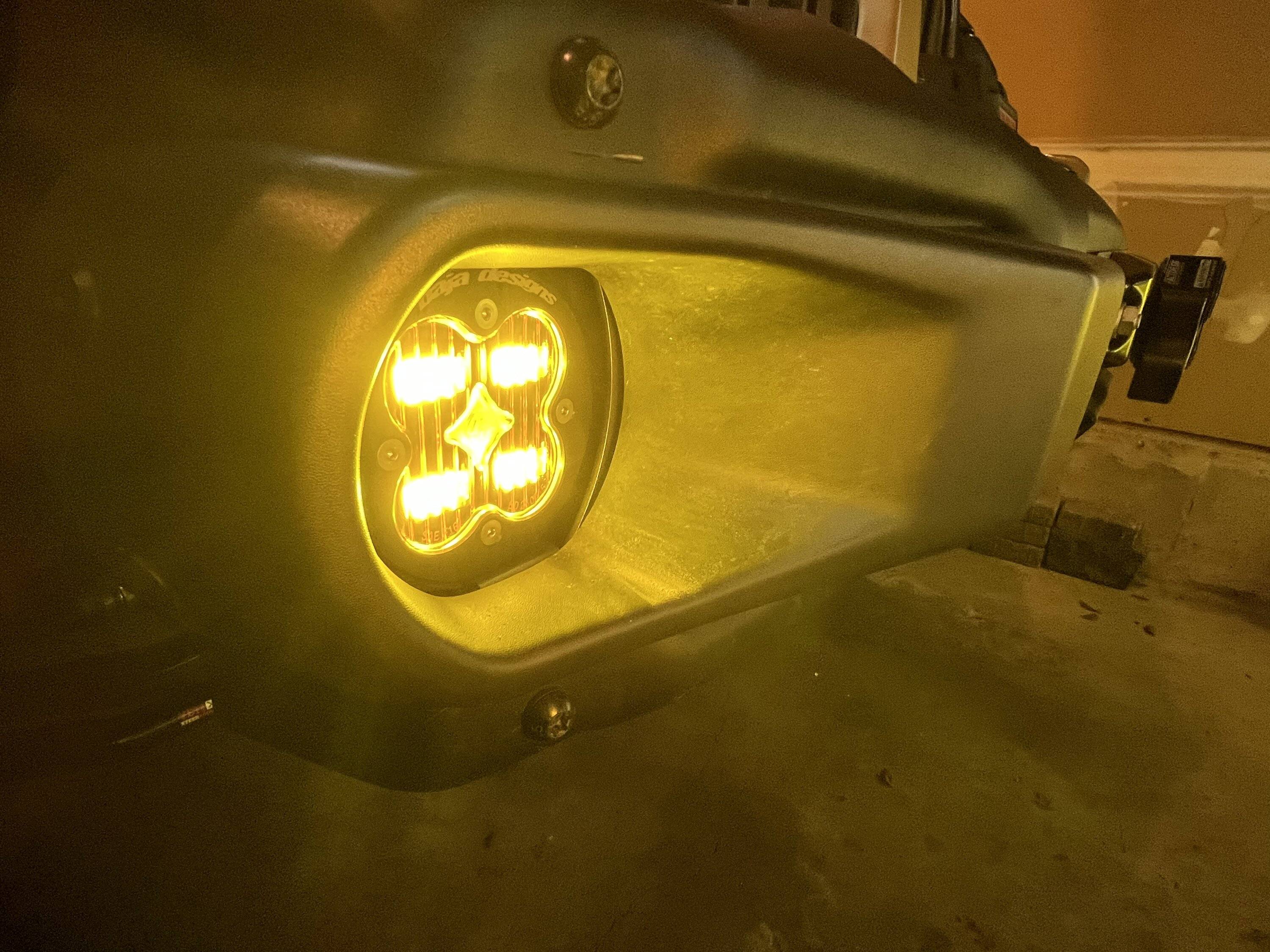

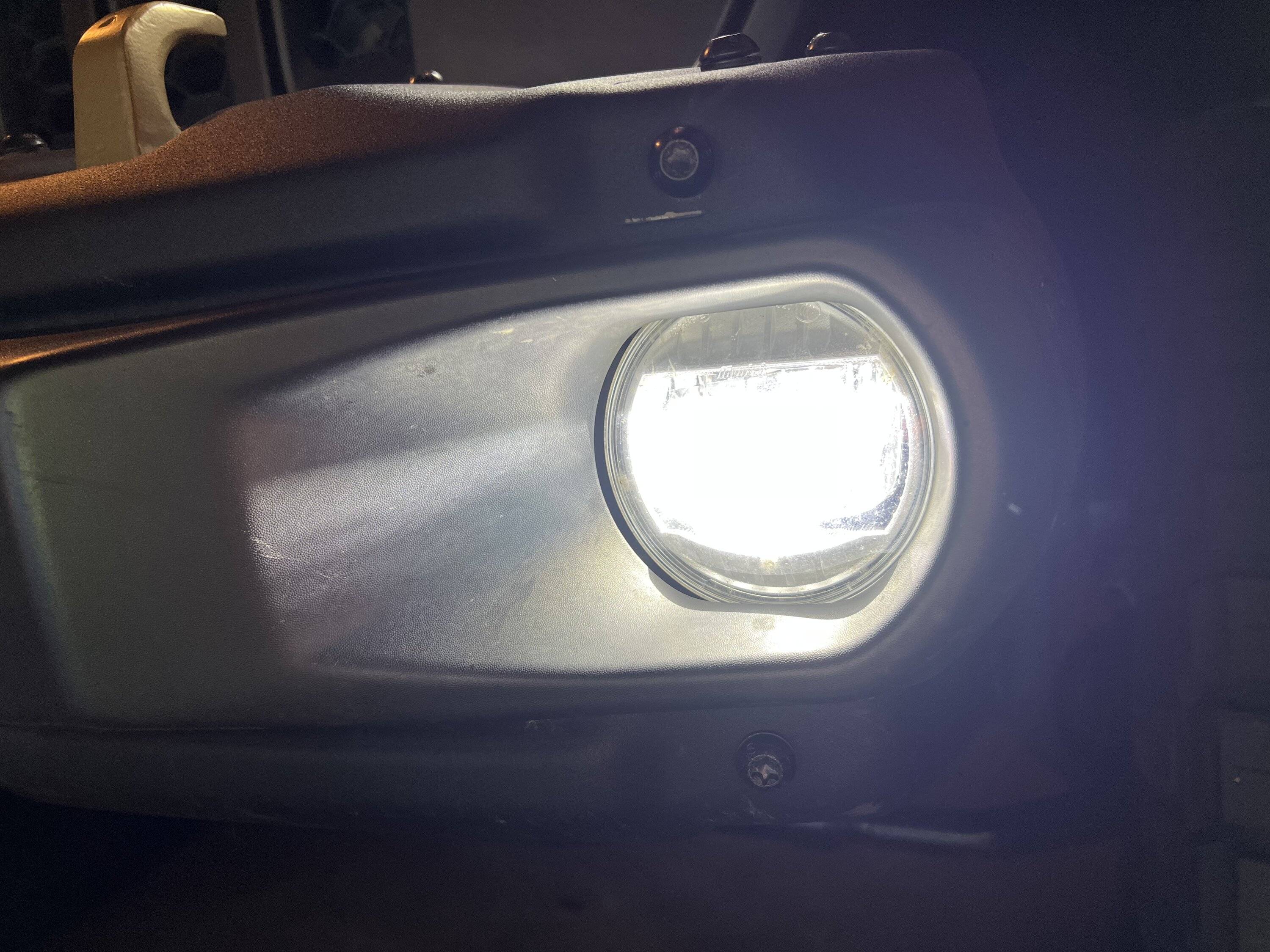

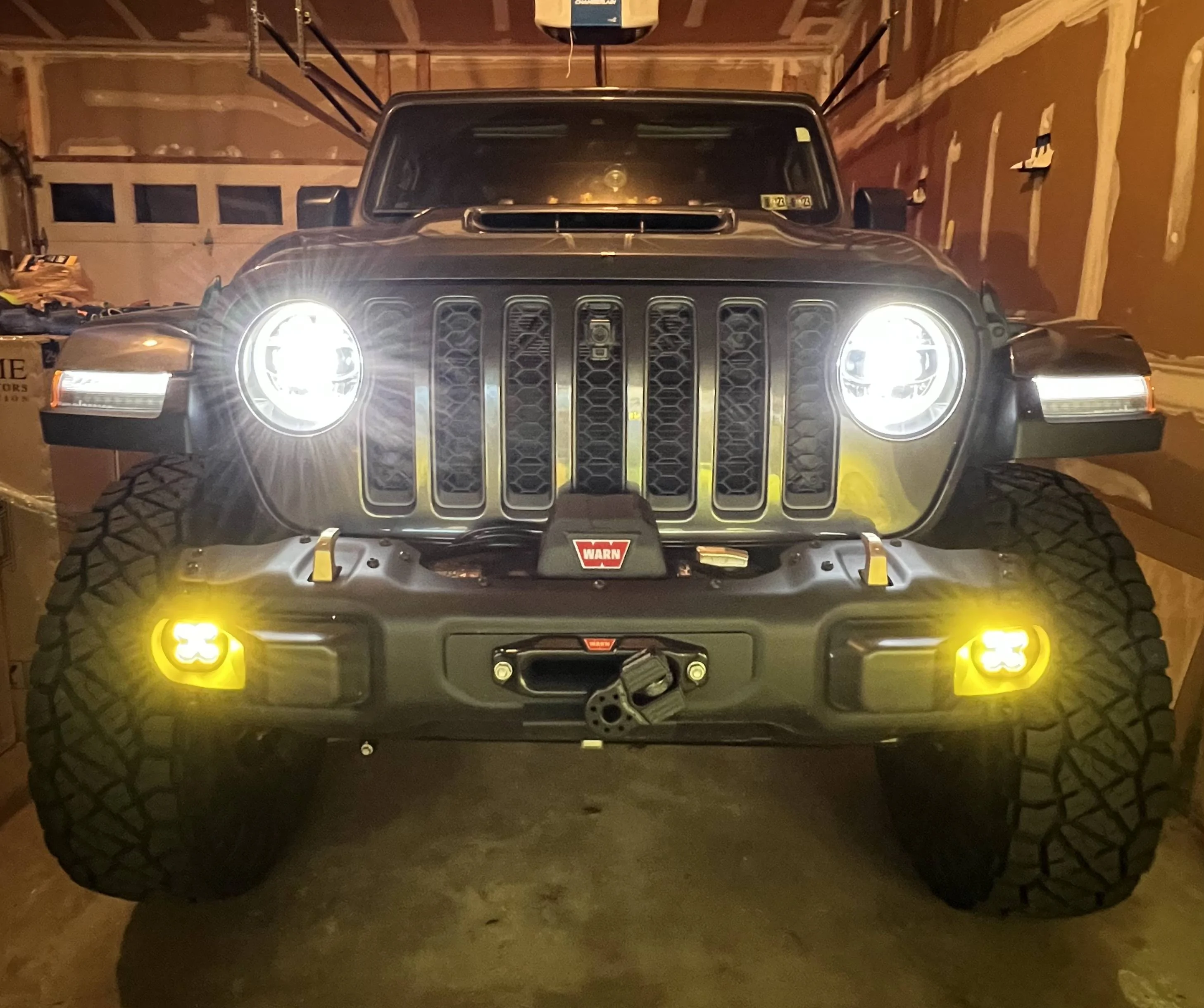

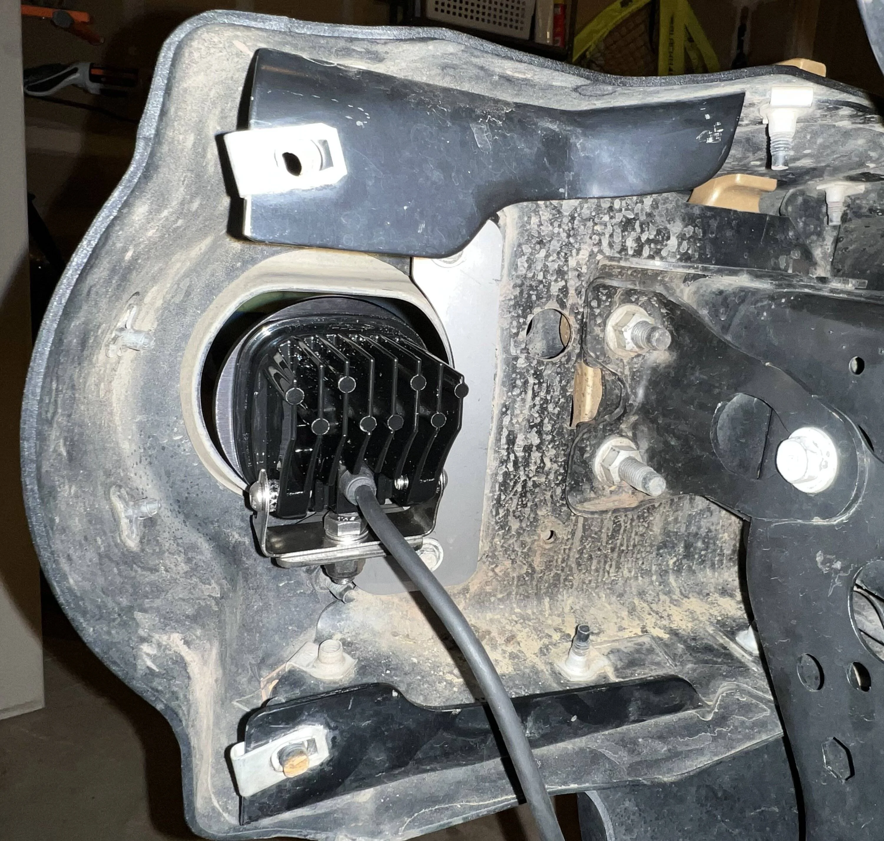

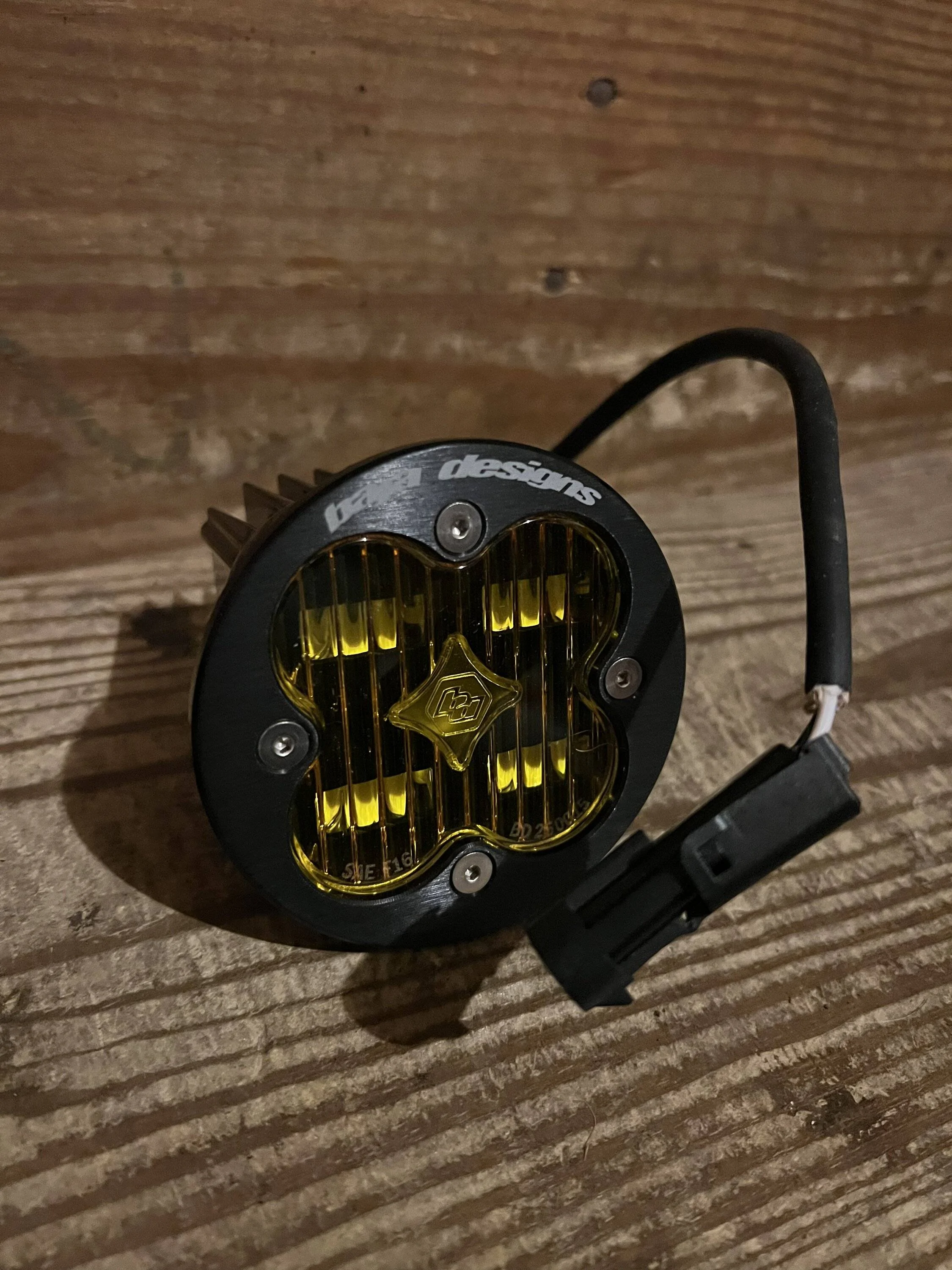

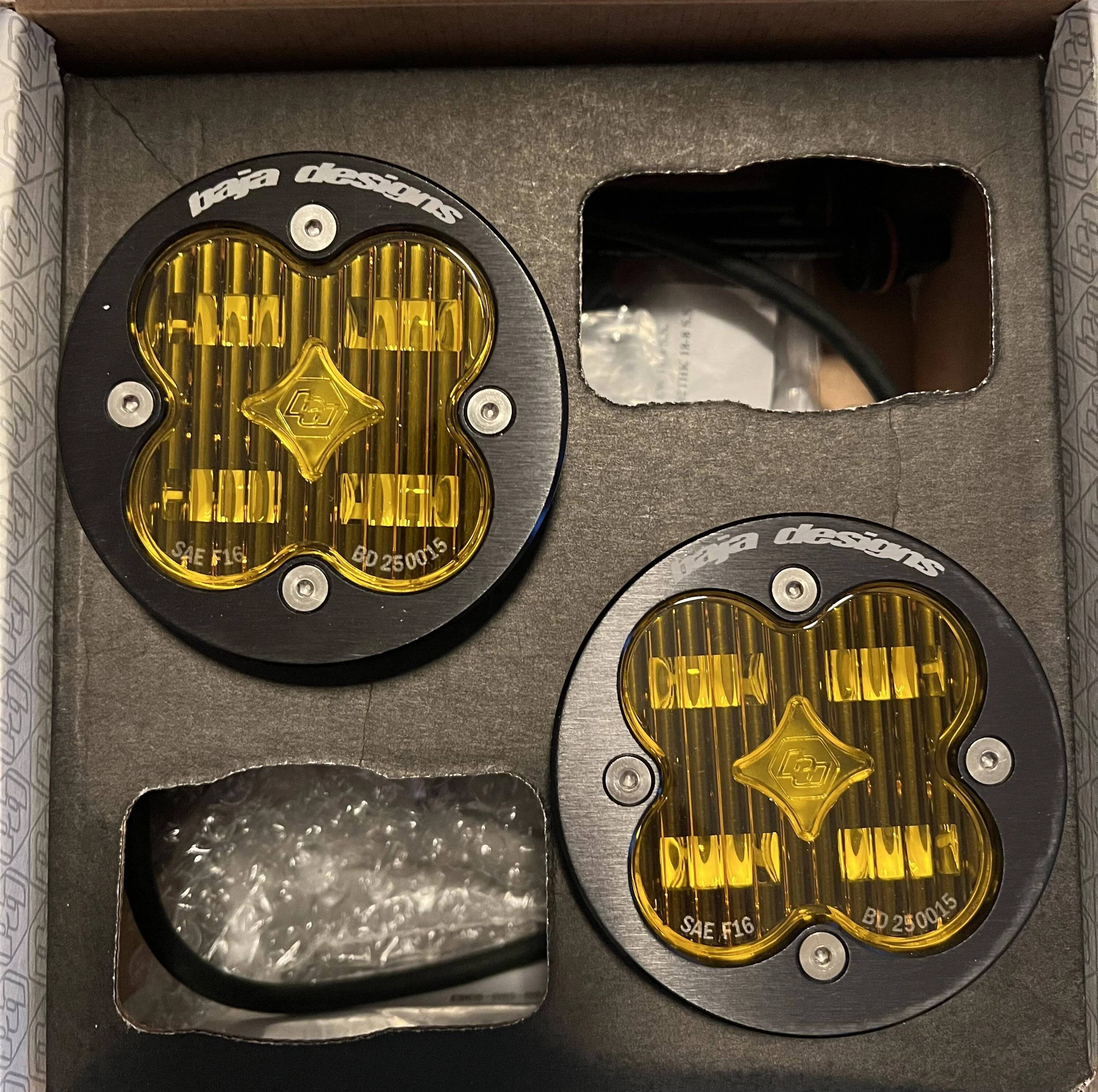

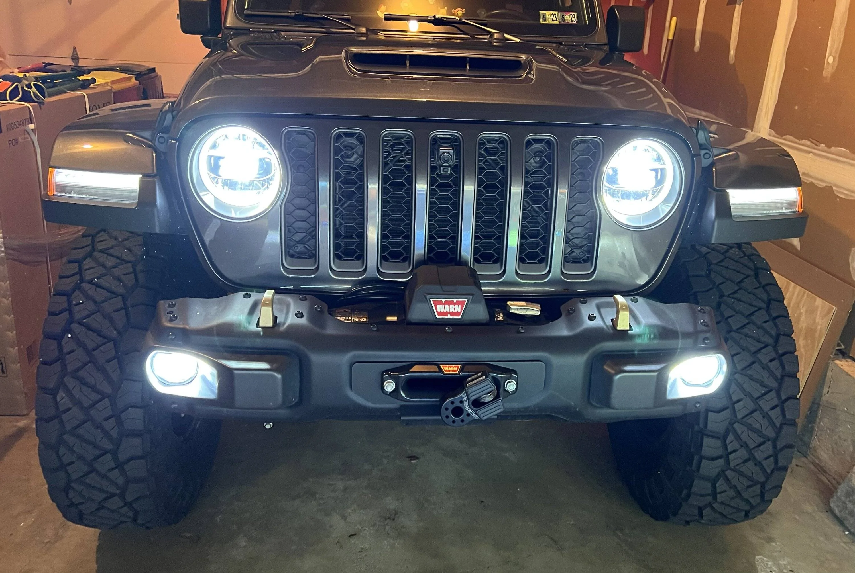

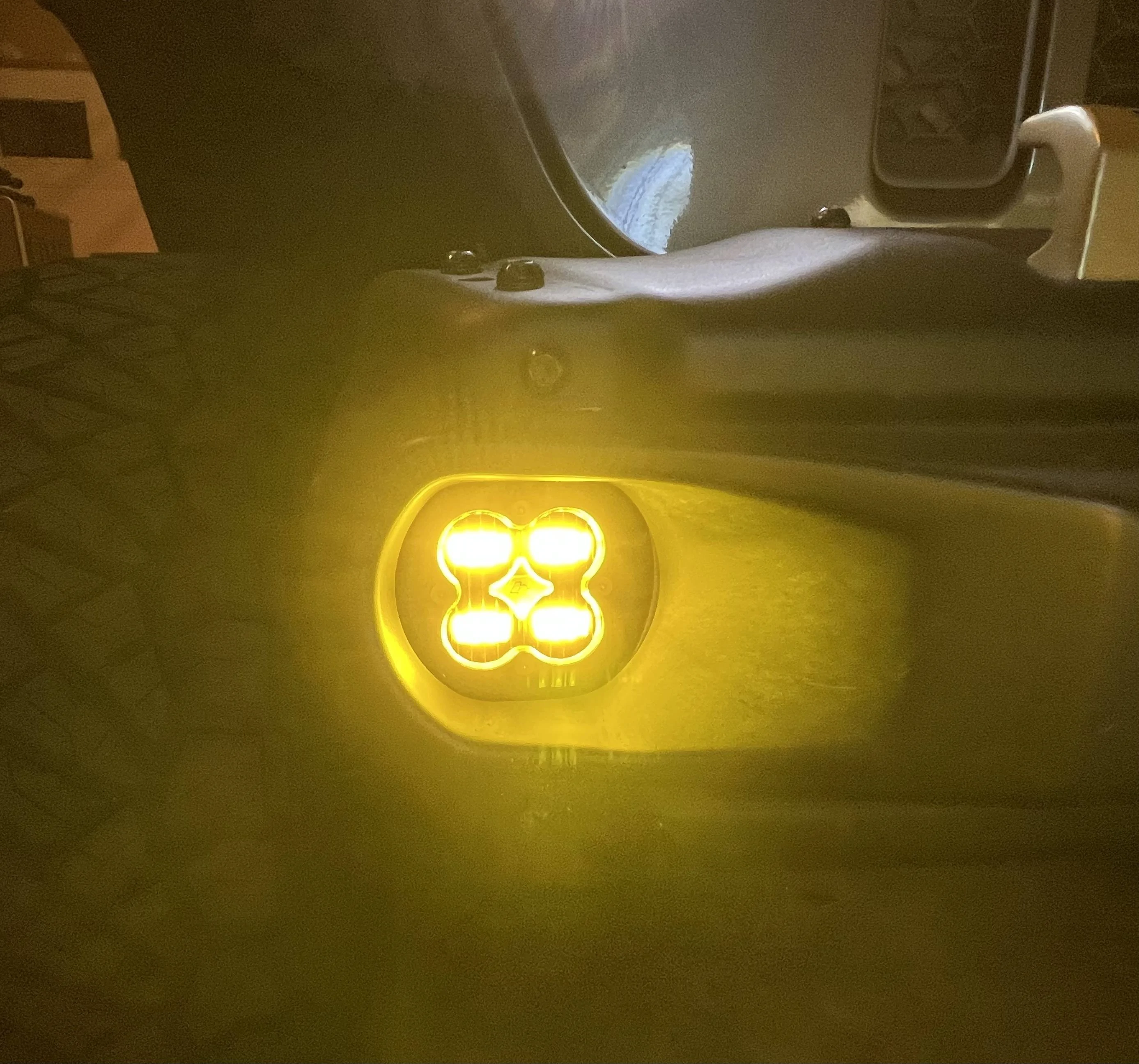

Installed the @Baja Designs squadron amber fog light pocket kit tonight. Super easy to install, took about 30 minutes start to finish for the pair. Basically plug and play, and came with new metal mounting brackets that replace the plastic ones. I think it looks way better with the amber, and these are definitely much brighter than the stock ones too, however not blinding when you look into them (good for oncoming motorists). A pair of Baja LP6s are now in order for the front bumper to match.
Before:
Jeep Wrangler JL Matt's 392 Build 44A511A8-2E40-4603-9910-3811D3B1CE3B
Jeep Wrangler JL Matt's 392 Build 9AC2E865-BECB-4A33-9D94-081CD3B6D99E
Unpacking:
Jeep Wrangler JL Matt's 392 Build 80B545F7-E593-4841-83D5-7B6F67441841
Jeep Wrangler JL Matt's 392 Build E057EE81-9C6A-457F-B763-89CDEB5CD8F6
Installed:
Jeep Wrangler JL Matt's 392 Build 8A79C79B-0B3E-42A7-BE2B-5847C35C6944
Jeep Wrangler JL Matt's 392 Build C545C6BA-D648-4F7C-9CF5-5205D35FFF33
Jeep Wrangler JL Matt's 392 Build CB099124-FD0A-4AA3-9B54-D466569461FB
Jeep Wrangler JL Matt's 392 Build 11A755A6-3F00-4C9A-82CF-9EF2BD267E95

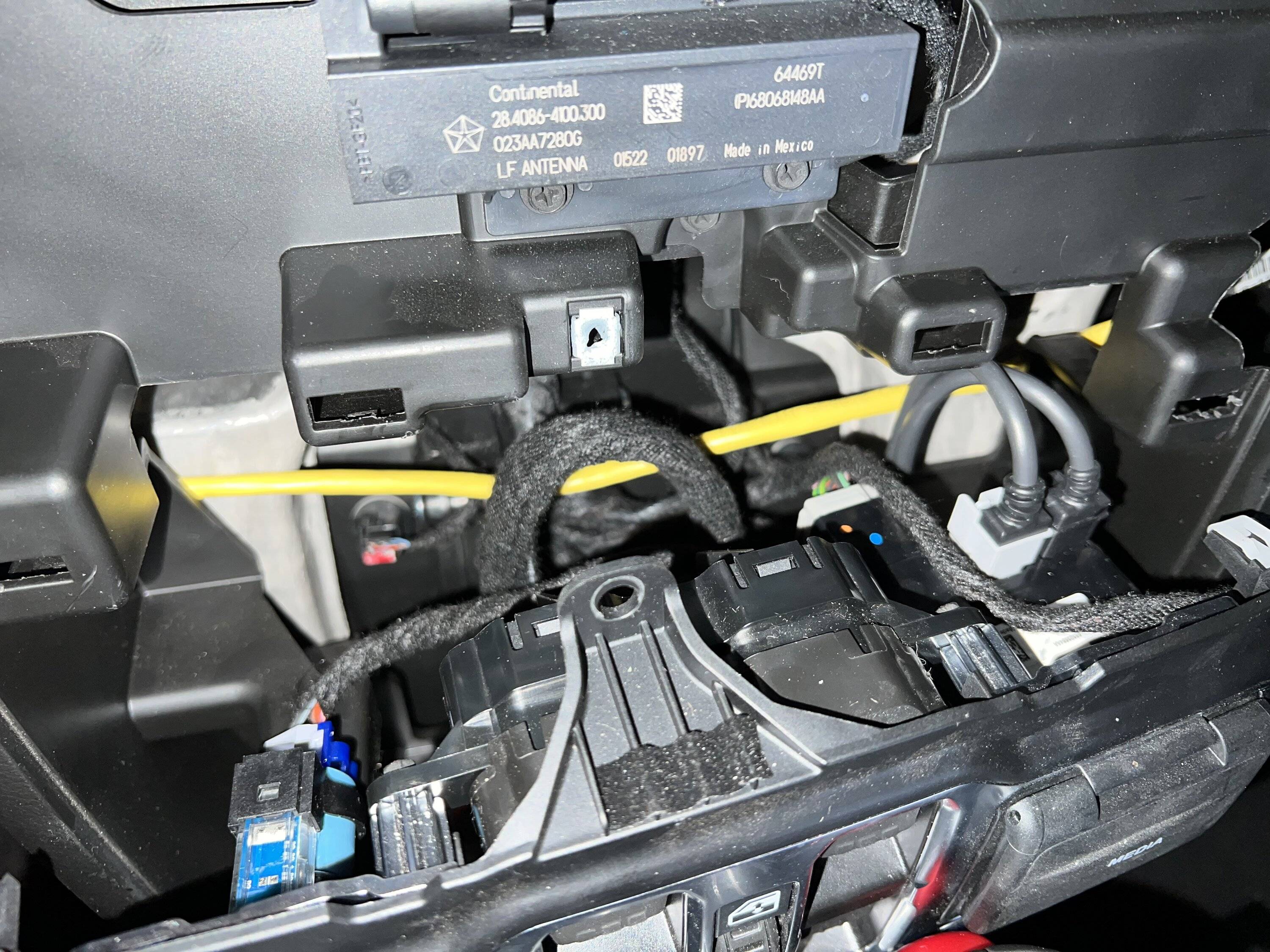

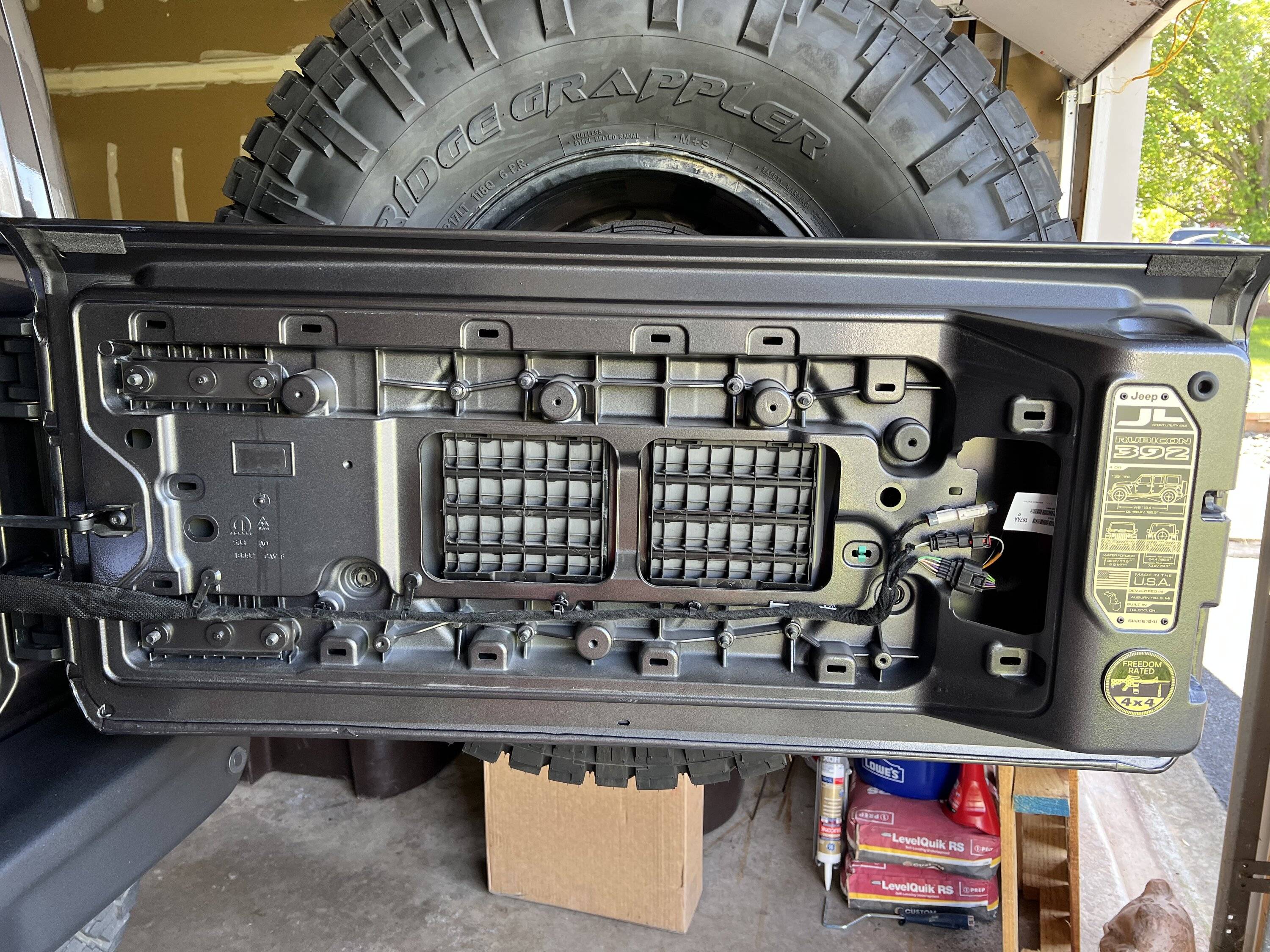

Does anyone have any solutions to cover up this space?
Jeep Wrangler JL Matt's 392 Build 355662F1-4D6B-4DFF-A805-DD0E541021AD
Before:
Unpacking:
Installed:
Looks great! Keep an eye out for the release of the new Squadron SAE coming out on March 1st. With this new version, we will be holding a free SAE upgrade allowing all customers with this version to send them in and get them switched out. More details will be released once the light hits the market.
https://www.bajadesigns.com/next-generation-squadron-sae/
Best,
Brandon

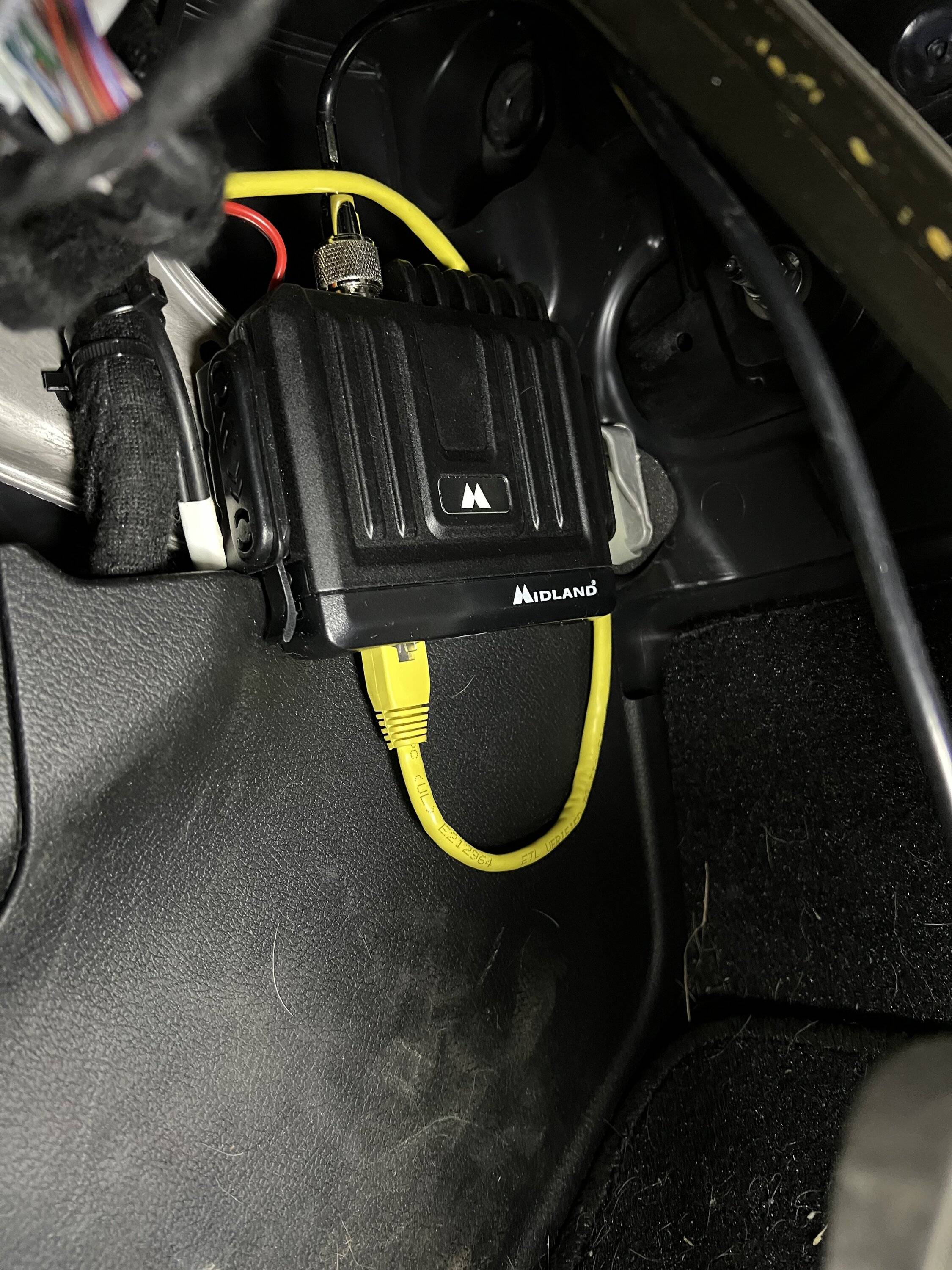

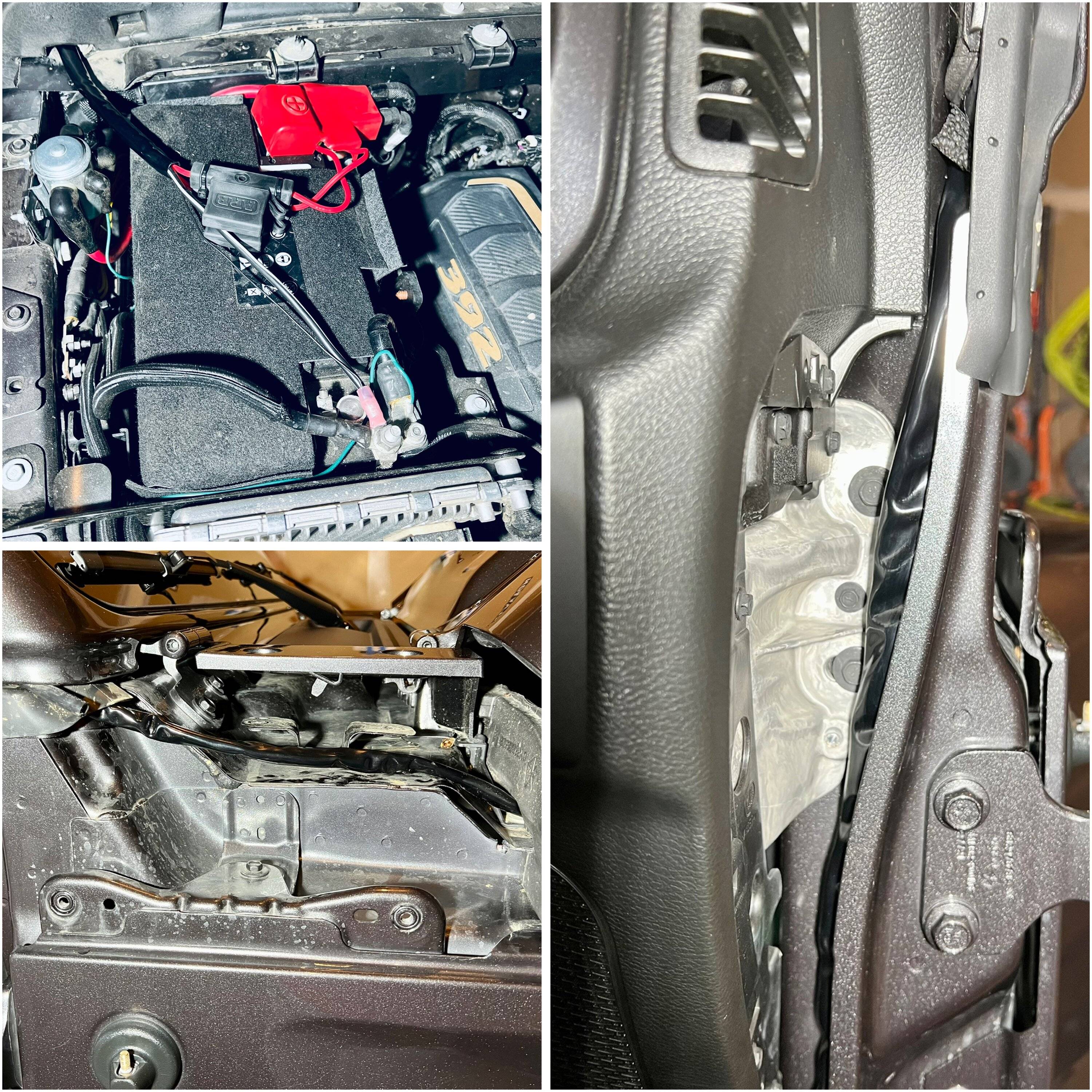

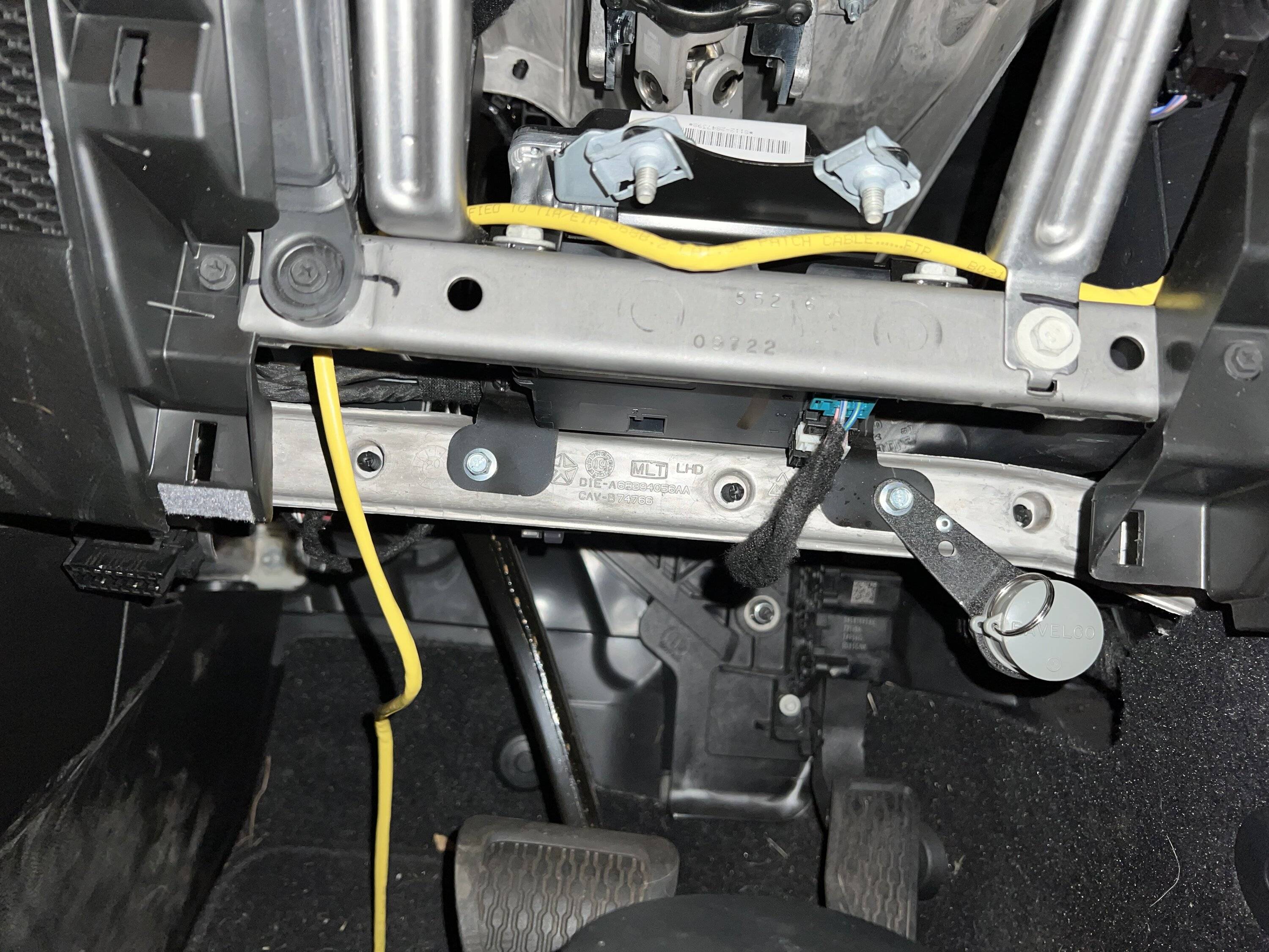

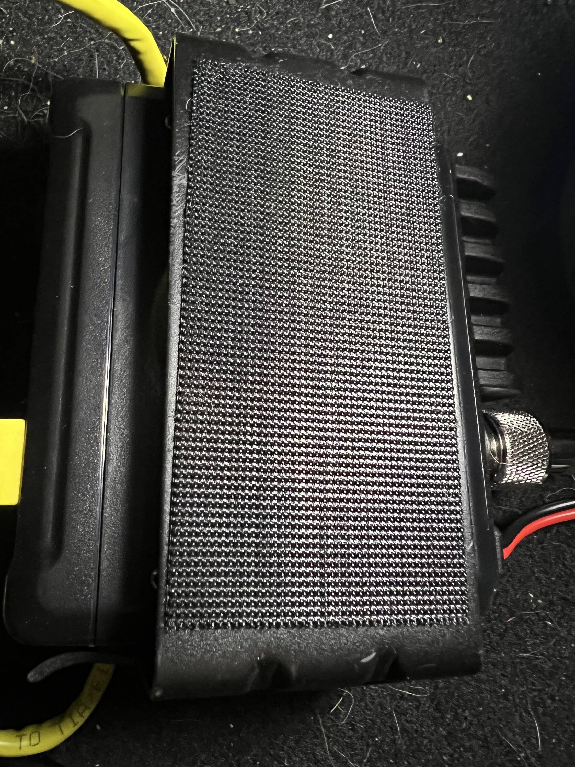

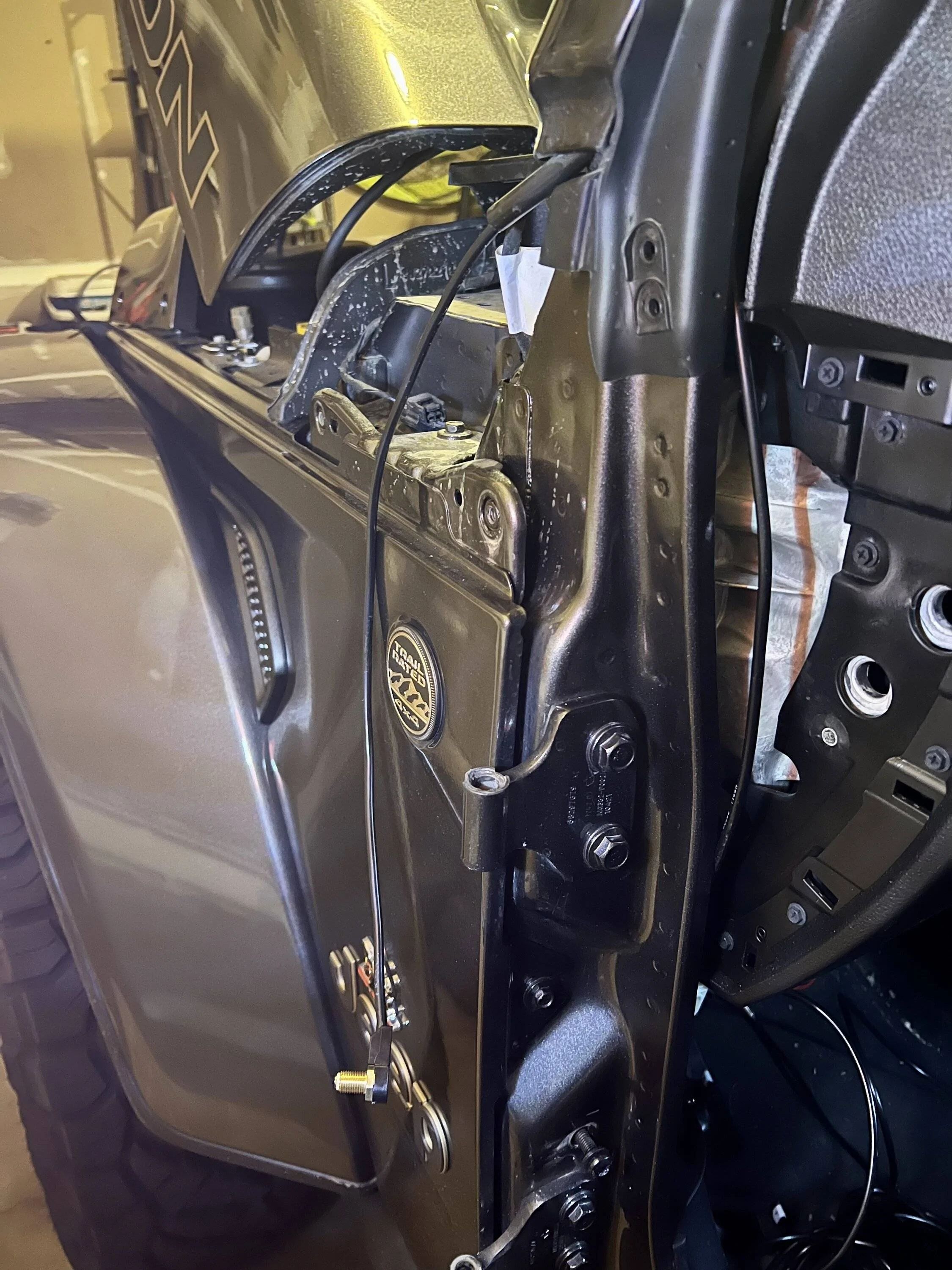

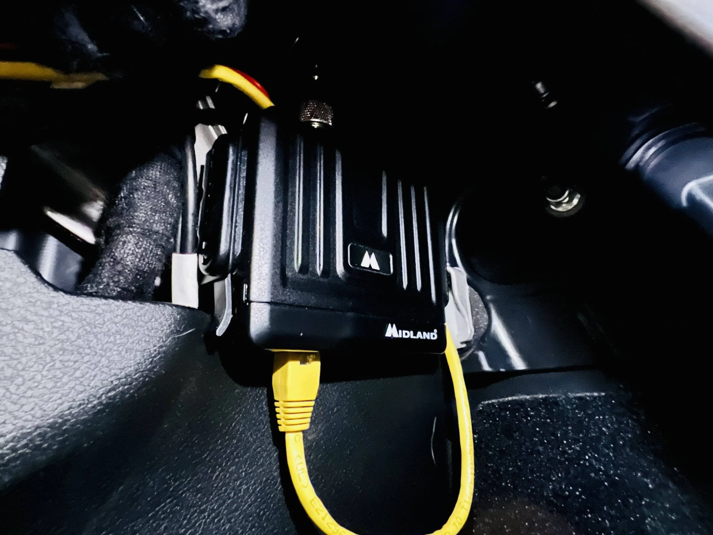

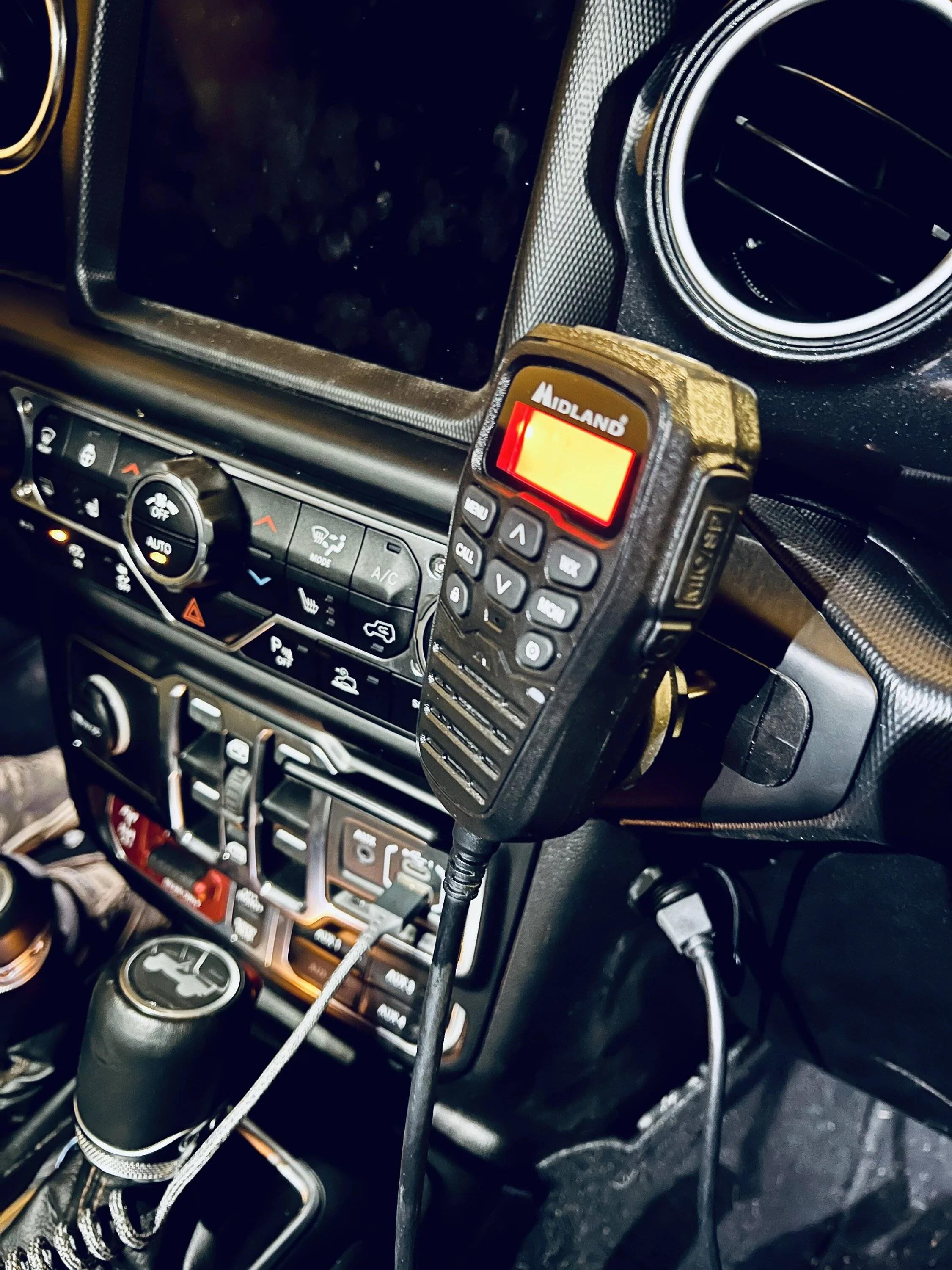

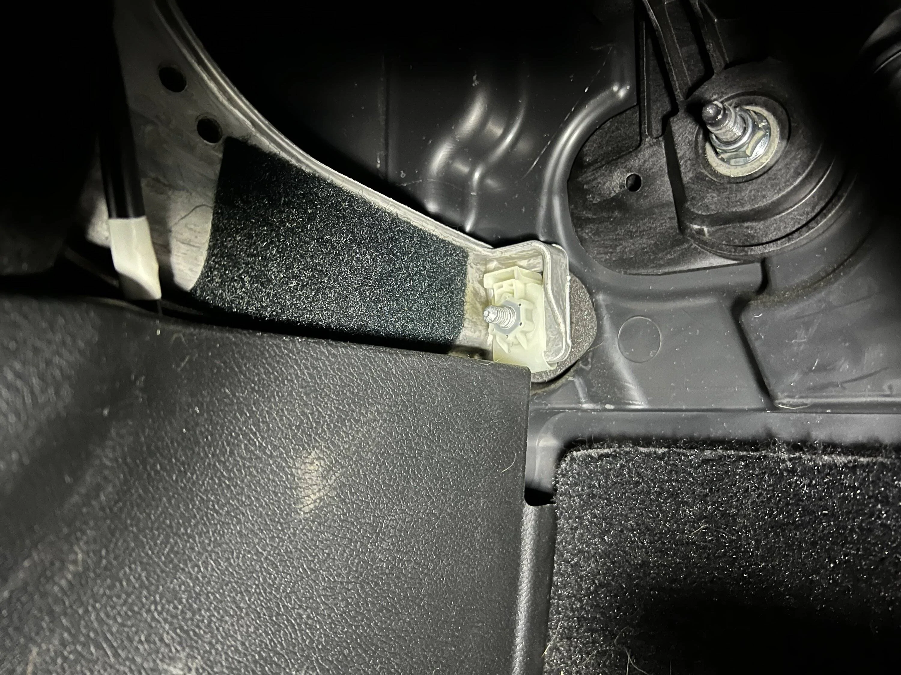

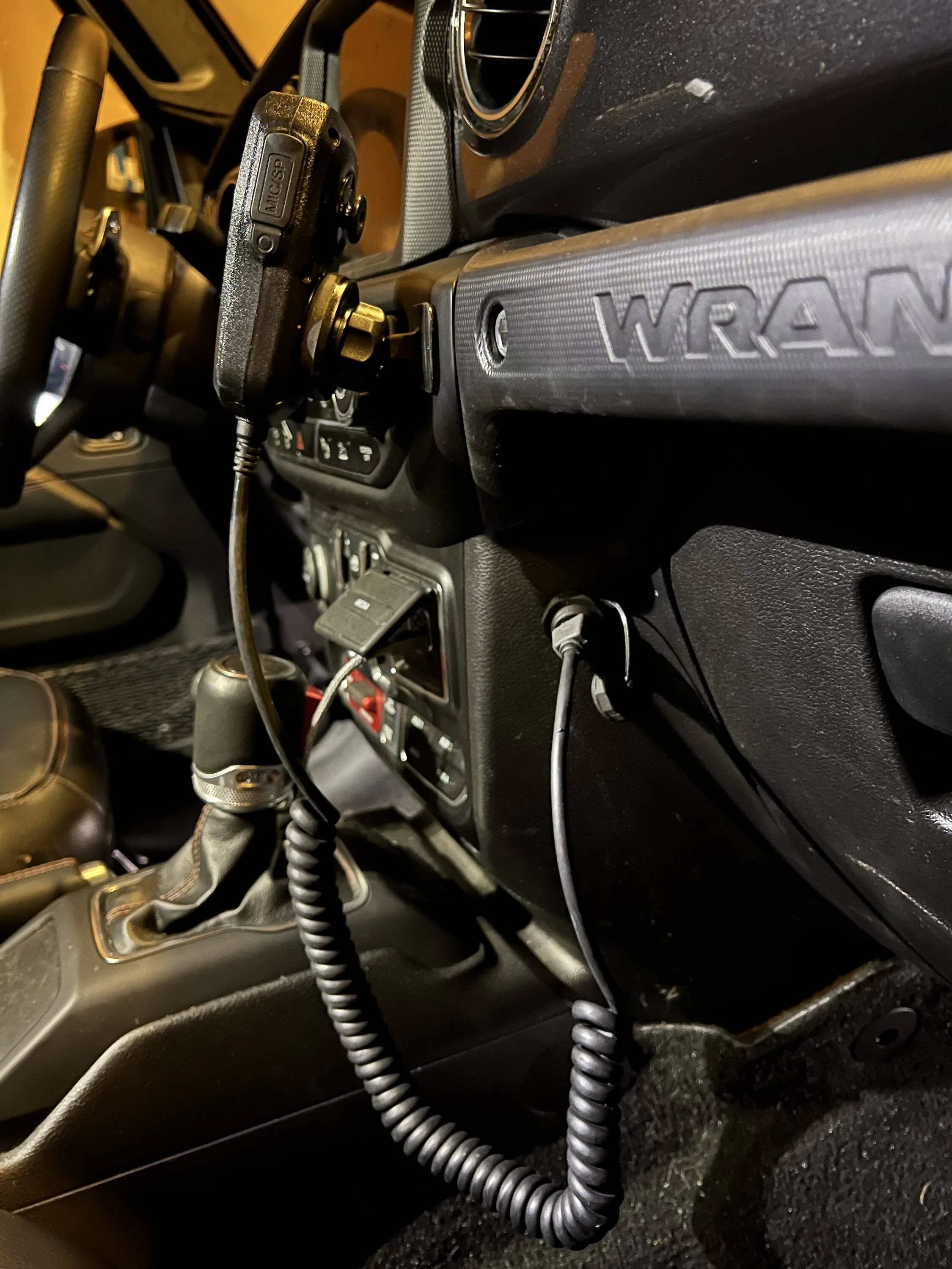

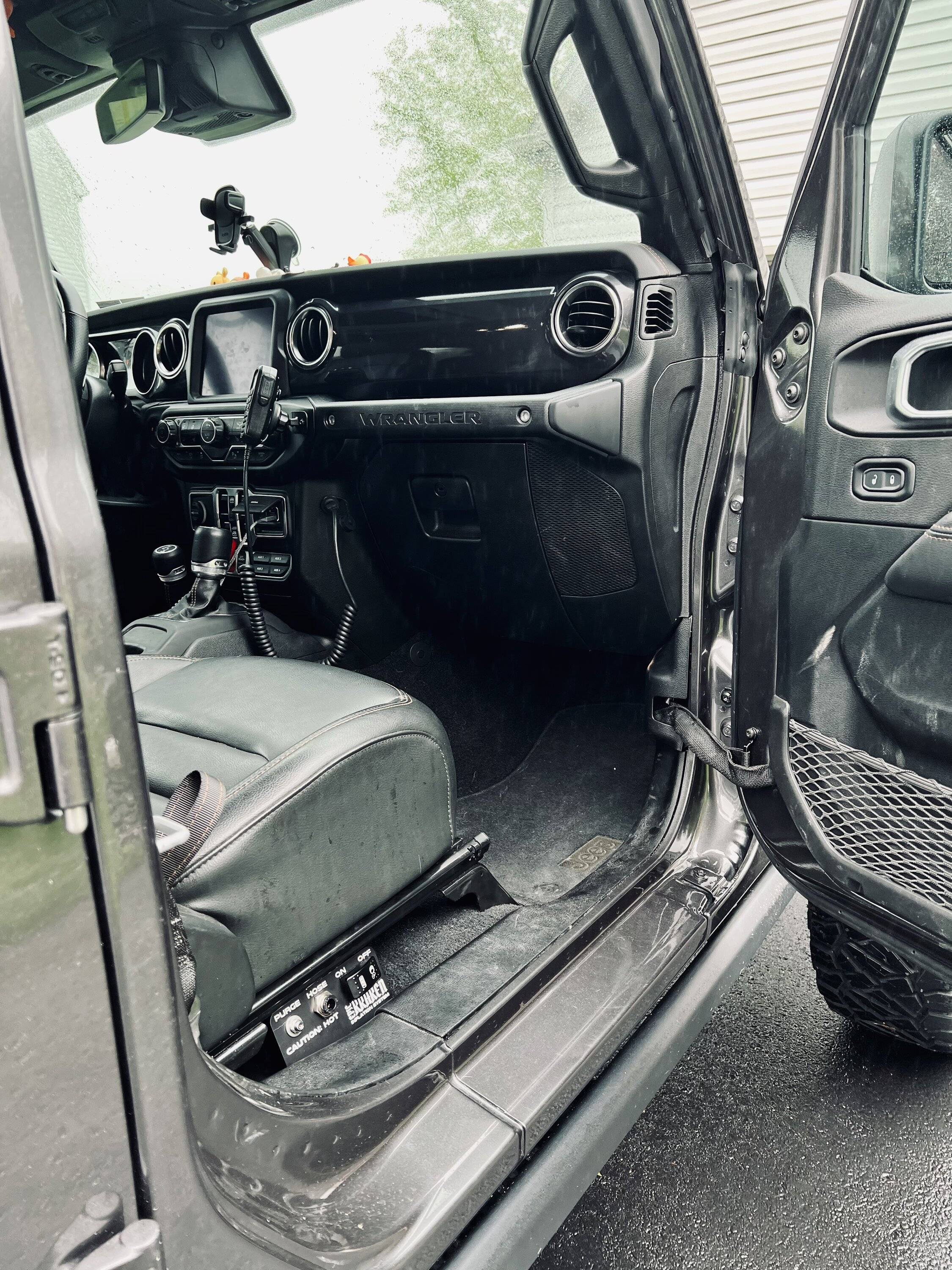

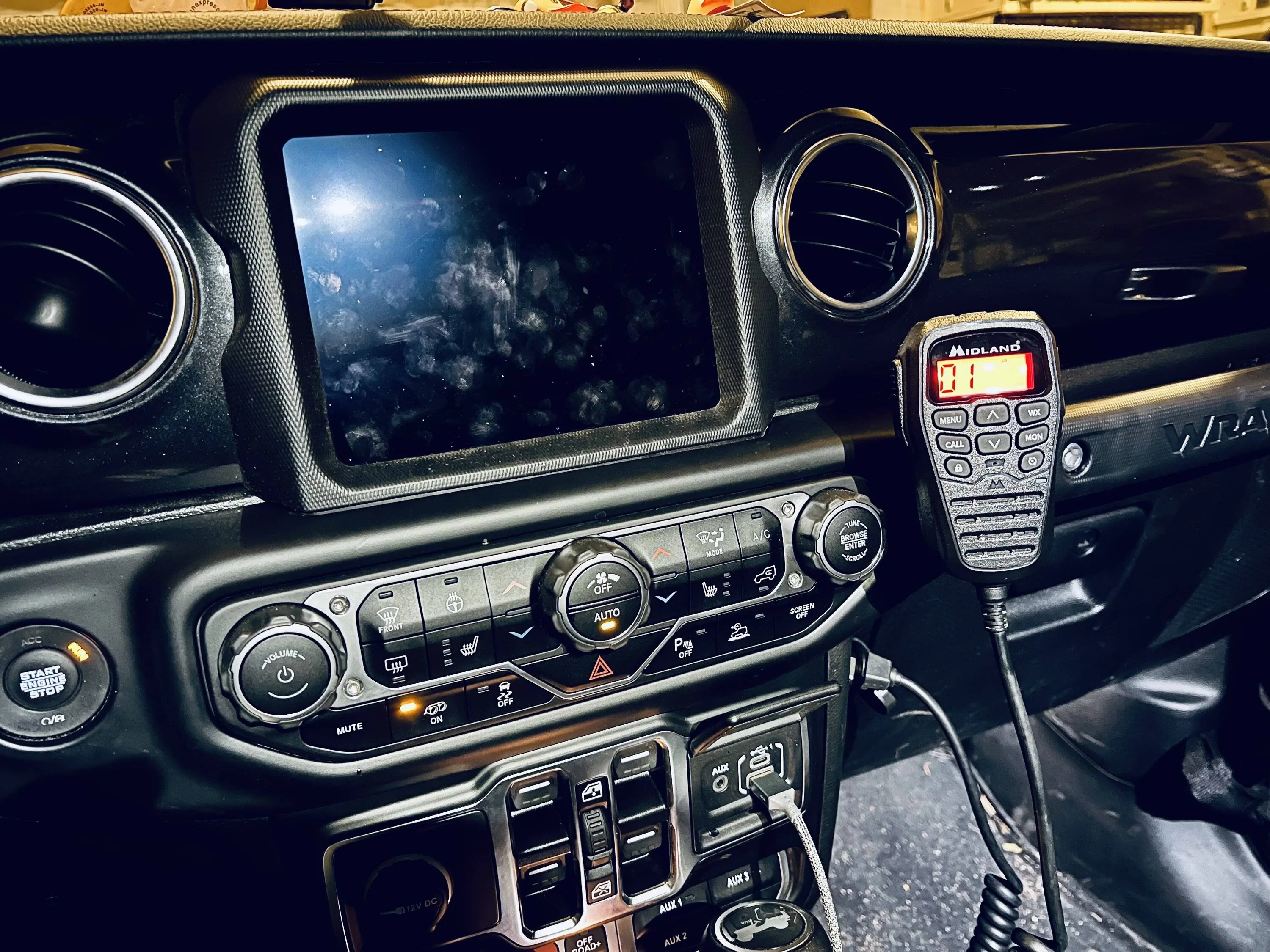

Part one of my Midland MXT 275 install is complete. I got the unit mounted and power and mic cables run. Next weekend I’ll run the antenna cable and mount the antenna. I’m still waiting for the antenna cowl mount to arrive.
I decided to mount the unit deep in the driver footwell using Velcro to stick it to a steel brace. It is completely hidden away. I ran the cables under the steering column and tapped into the 12V DC outlet in the front console for power. I must credit a member on the 392 forum for the idea of the mic pass thru connector. It was pretty easy to access behind the trim by removing the glove box so I could find a good spot to drill the hole for the mic connector. In all I’m pretty happy with how it’s turning out so far.
Unboxing:
Jeep Wrangler JL Matt's 392 Build EADC0DAB-CEFC-4D82-AB98-B77DDEDBCFDE
Running mic cables:
Jeep Wrangler JL Matt's 392 Build EBC5DFE2-07D9-46CC-896F-4BFA79756D6F
Jeep Wrangler JL Matt's 392 Build A1033390-A755-4FD3-A8B6-C0E84D321B6A
Jeep Wrangler JL Matt's 392 Build 99FC9D94-A490-4846-A470-B6EDFC535672

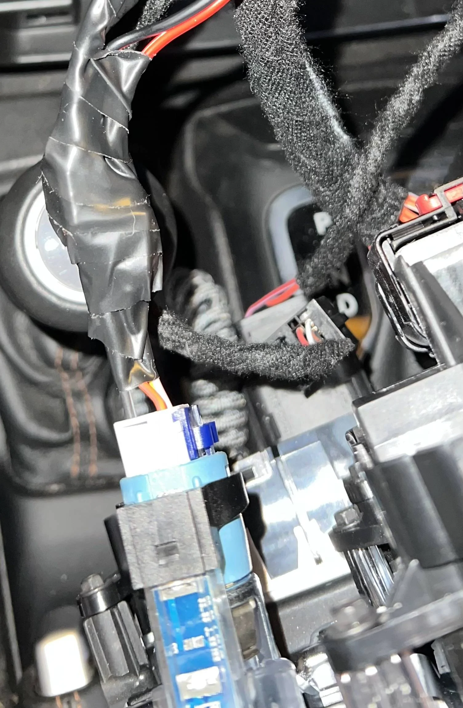

Connecting power:
Jeep Wrangler JL Matt's 392 Build A7939059-04BE-40A1-ADB2-20594D8D0C4B
Jeep Wrangler JL Matt's 392 Build 1EF0B8CD-63B7-4D16-A07A-DEBAD246E5E3
Mounting the unit:
Jeep Wrangler JL Matt's 392 Build F363F299-F80C-4941-8E60-395A4058DB93
Jeep Wrangler JL Matt's 392 Build 09714753-6629-4B9C-B3B6-46A228ADD71E
Jeep Wrangler JL Matt's 392 Build B2D111A8-3A52-4206-BD96-AB6050828AF6
Mic mounted:
Jeep Wrangler JL Matt's 392 Build 29033102-C374-4258-992A-00D387596857

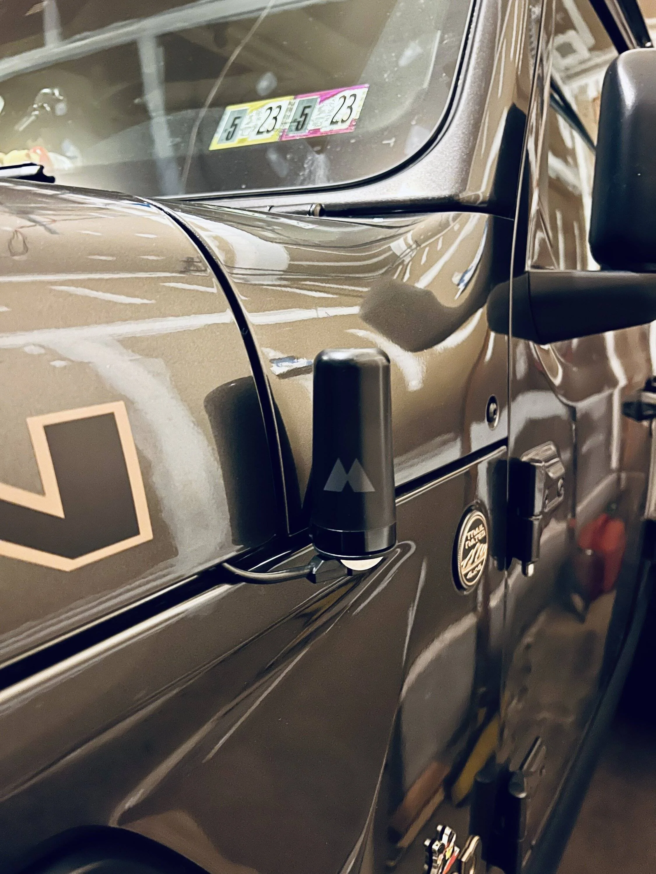

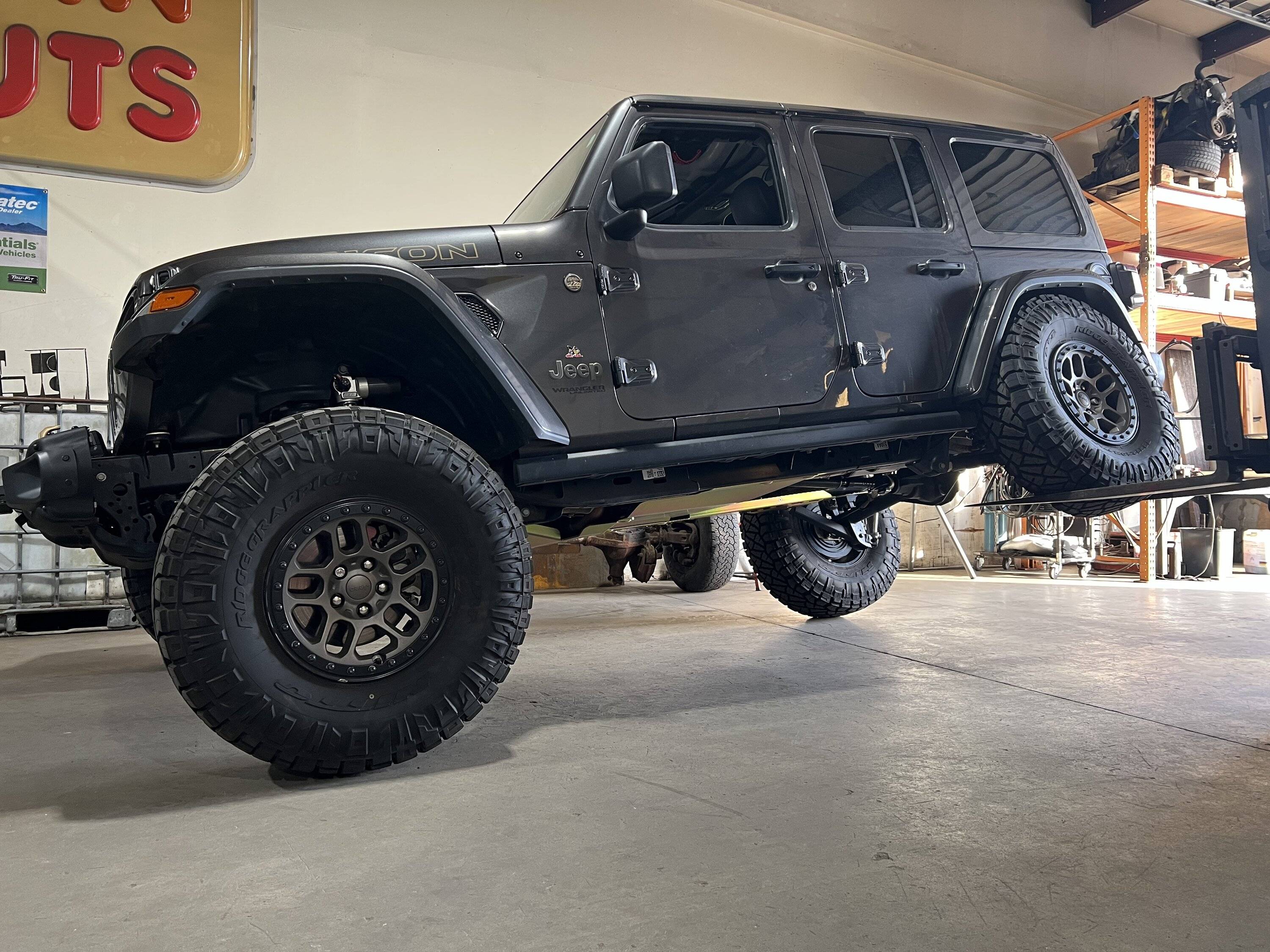

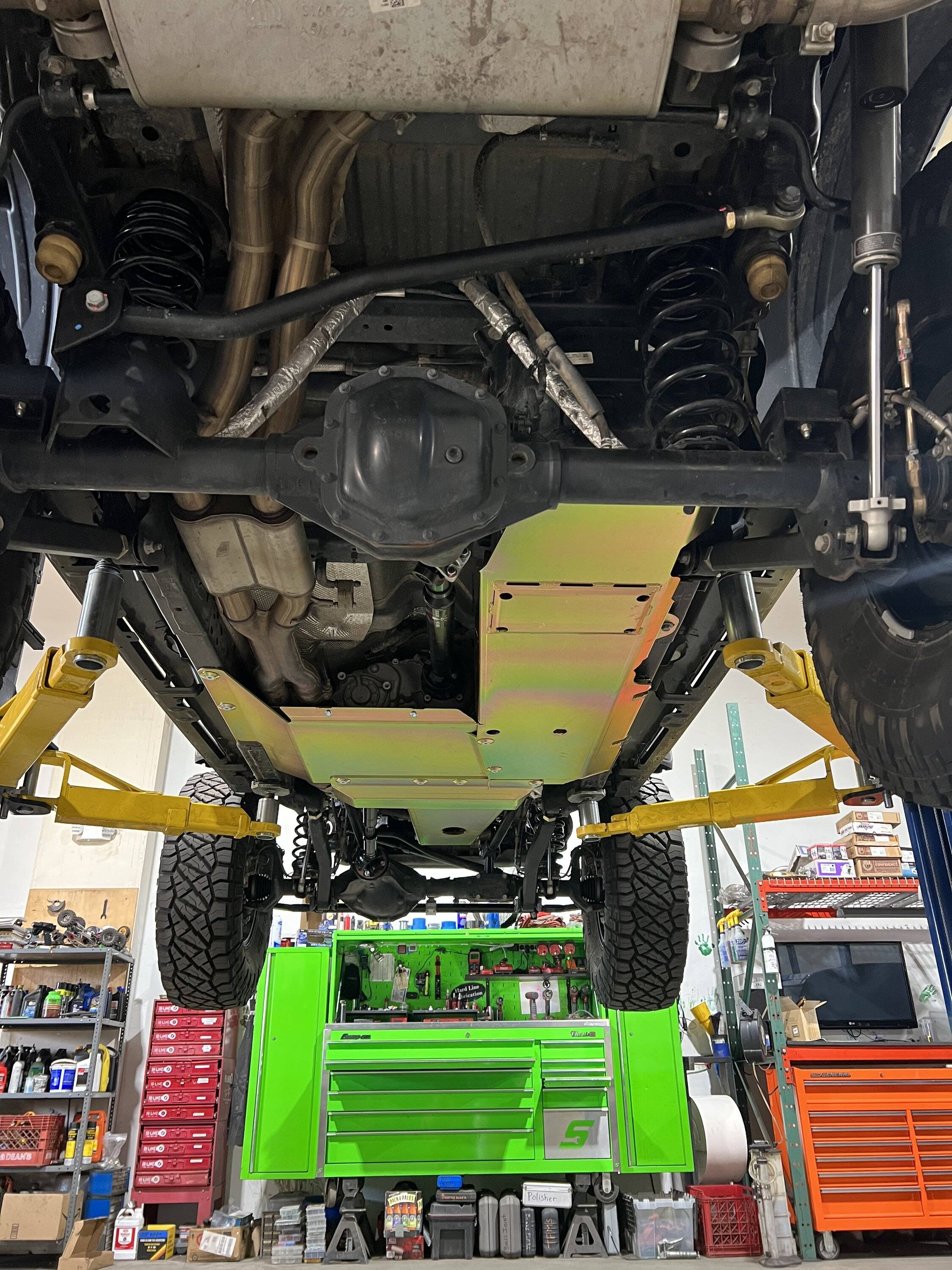

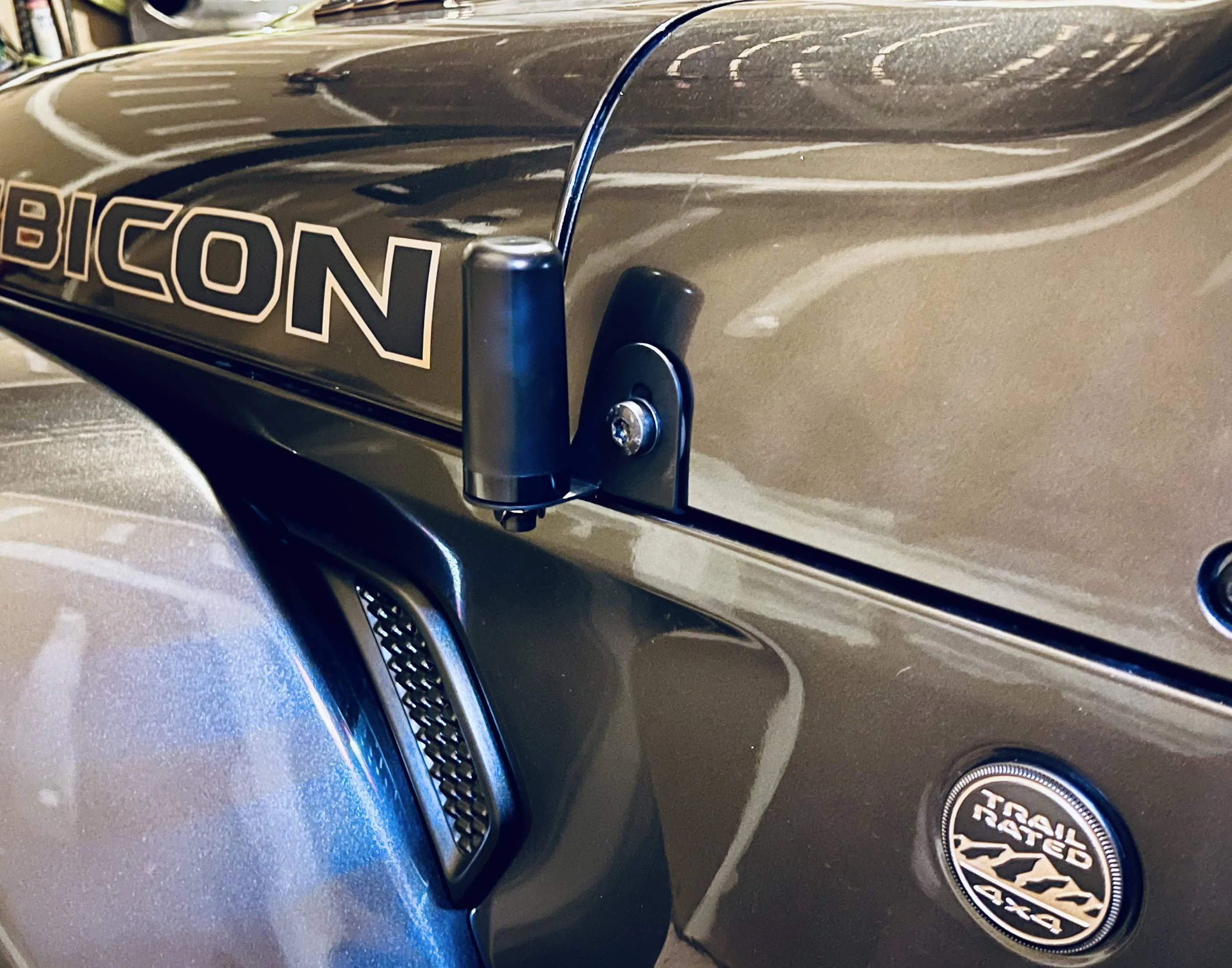

Had busy week between the Metalcloak skid install (installed by the shop not me) and midland install. Not to mention I’m a CPA and working like 80 hour weeks right now. But was able to sneak away for a few hours tonight to mount the midland antenna and finish the midland install.

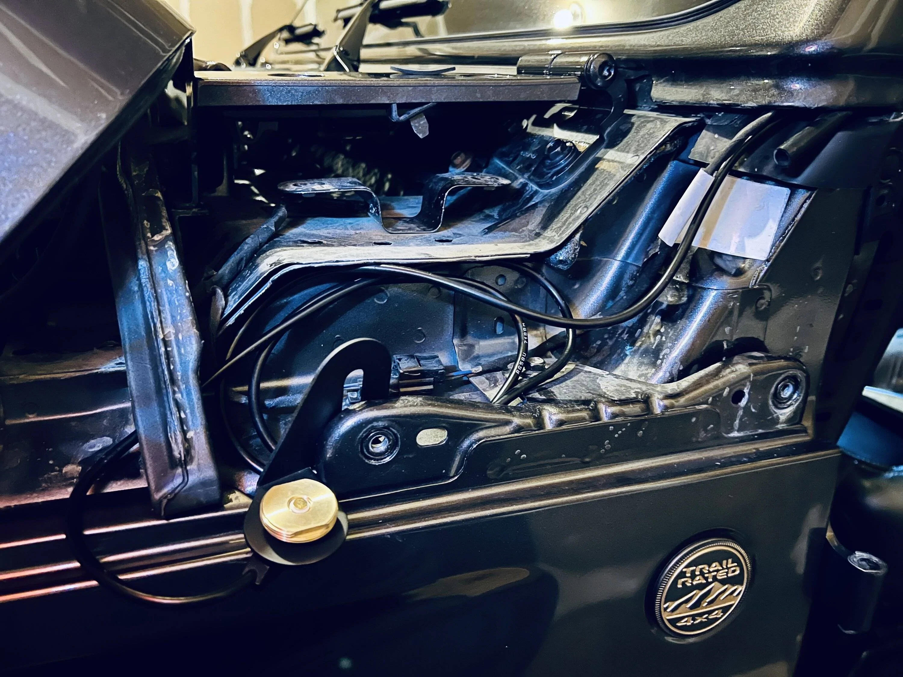

I ran the antenna cable under the windshield. There was just enough room to fit the head of the antenna wire through.

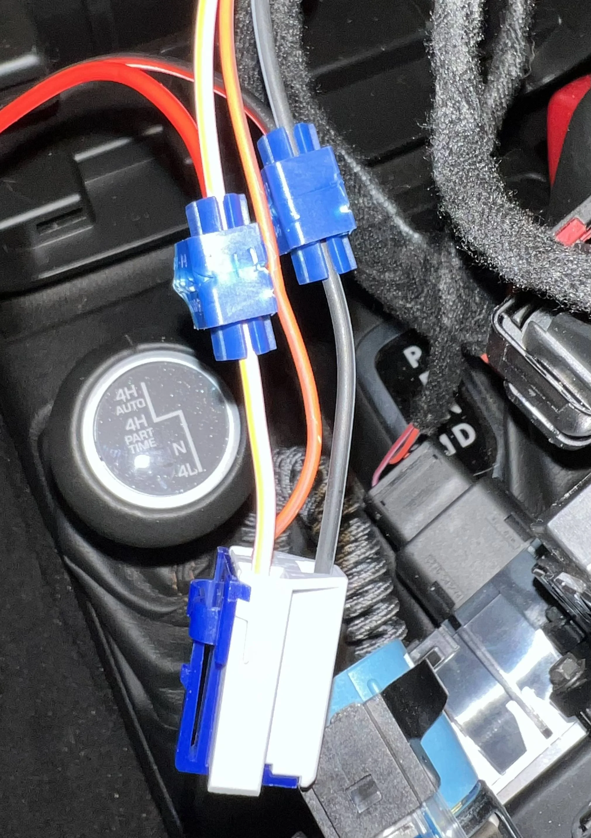

I wasn’t a fan of the T tap connectors for the power, so replaced them with a much more reliable lever connector (I forgot to take pics of that part of the install process but I’ll put a link below to them). They were real easy to work with.
https://a.co/d/cE5jivo
Jeep Wrangler JL Matt's 392 Build F1684088-7F07-406C-910C-E805B84DBB99
Jeep Wrangler JL Matt's 392 Build E3ABC546-EFB1-474A-A03A-139EAA126BA0
Jeep Wrangler JL Matt's 392 Build A2AECC21-F271-4ED6-AD3C-1FF30329C5A2
Jeep Wrangler JL Matt's 392 Build F75E7E5F-E93E-431E-BC59-A68B97134466
Jeep Wrangler JL Matt's 392 Build 3B9F3B85-CC23-44B3-810C-0CF168F0BACC
Jeep Wrangler JL Matt's 392 Build 3E97AD8E-3FD9-494B-AA68-41A39E4D859E
Jeep Wrangler JL Matt's 392 Build 653ACB94-13F9-4A78-85A1-DDA899CE6DC4
Jeep Wrangler JL Matt's 392 Build 61102047-6013-4DC7-943C-D196335E67EE

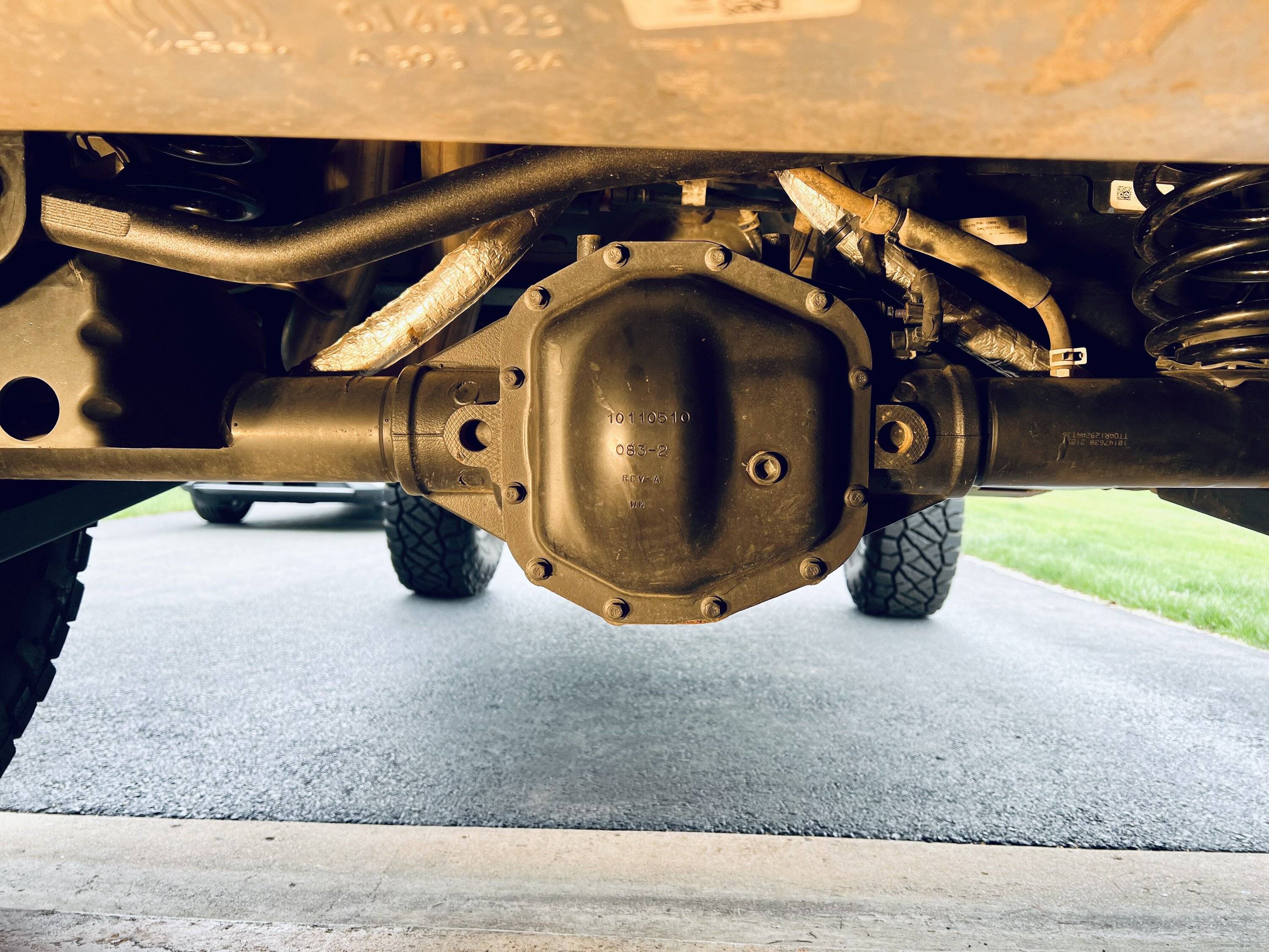

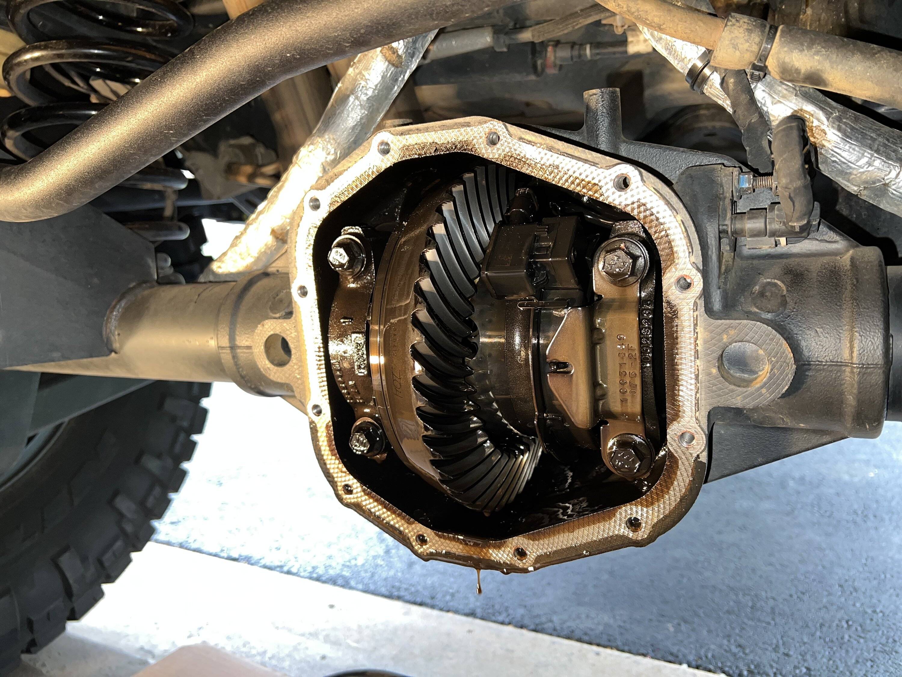

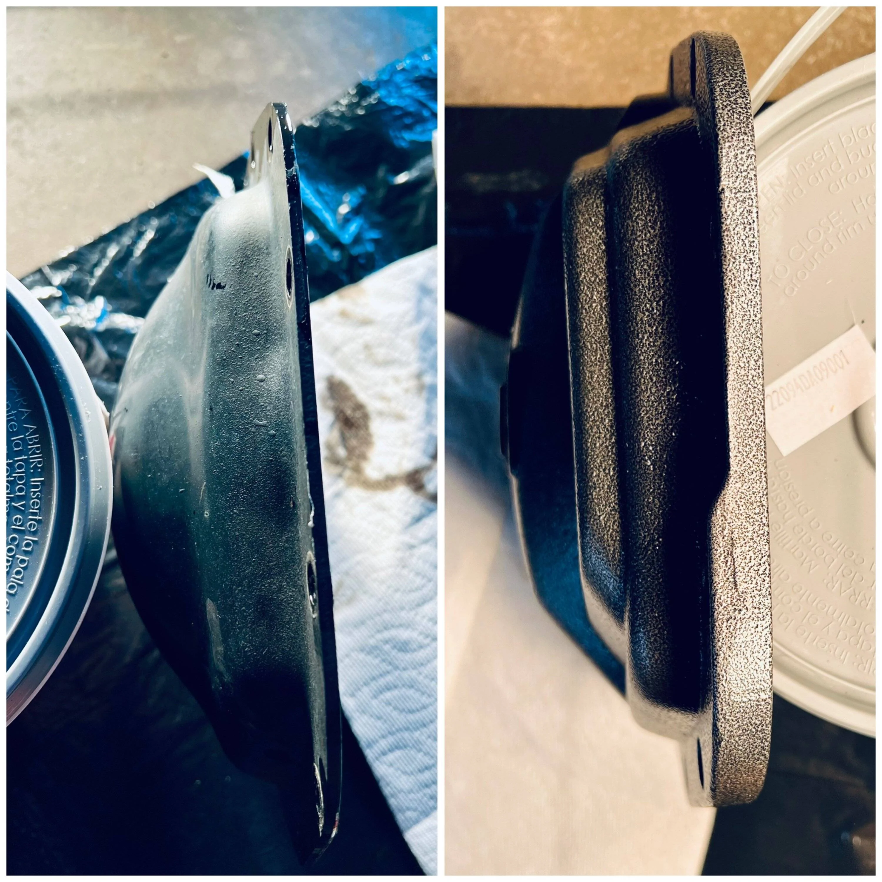

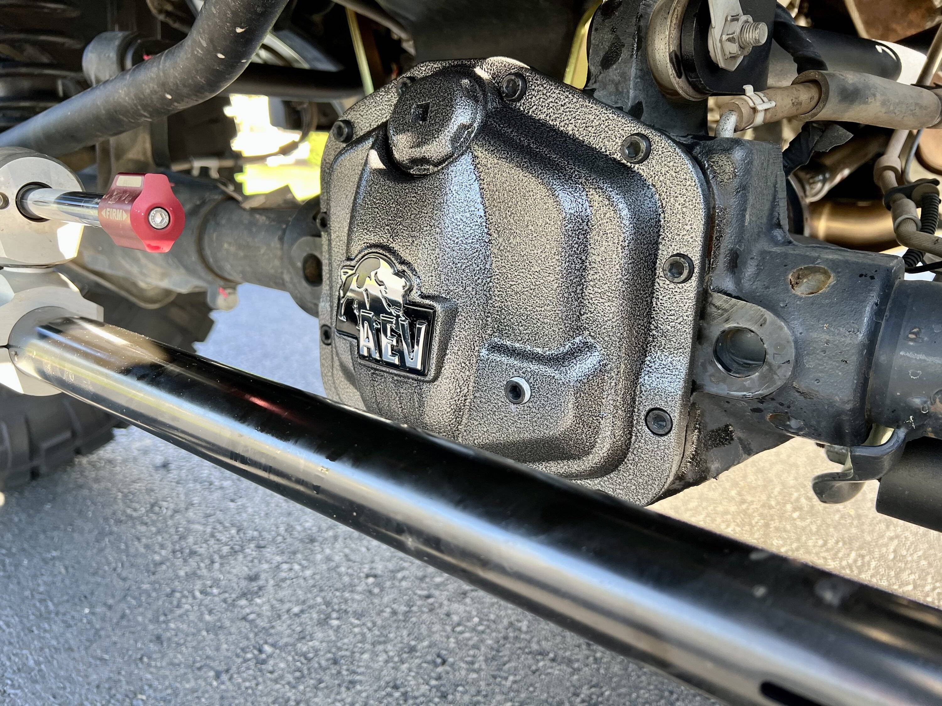

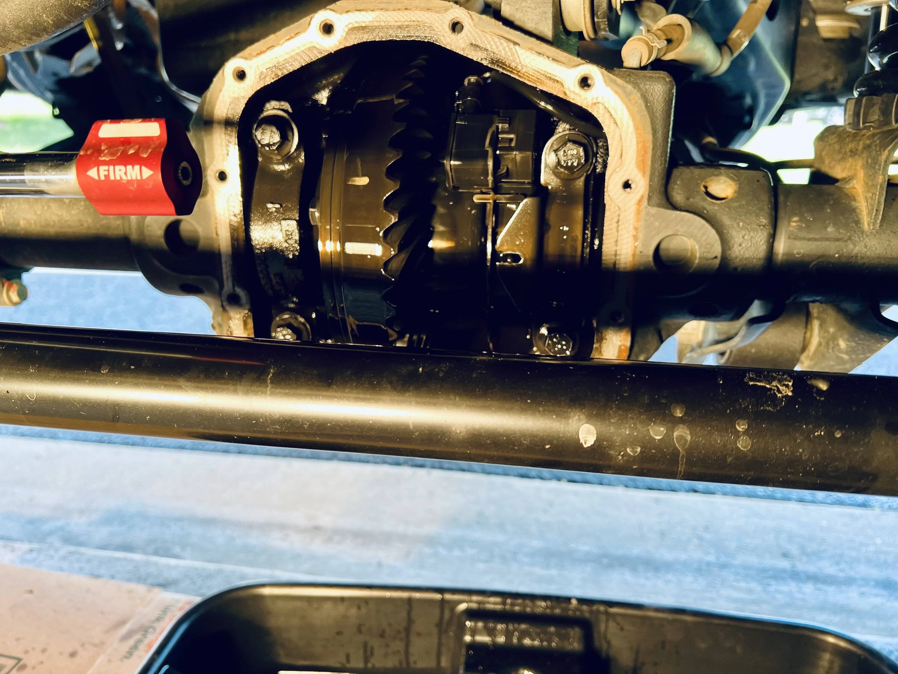

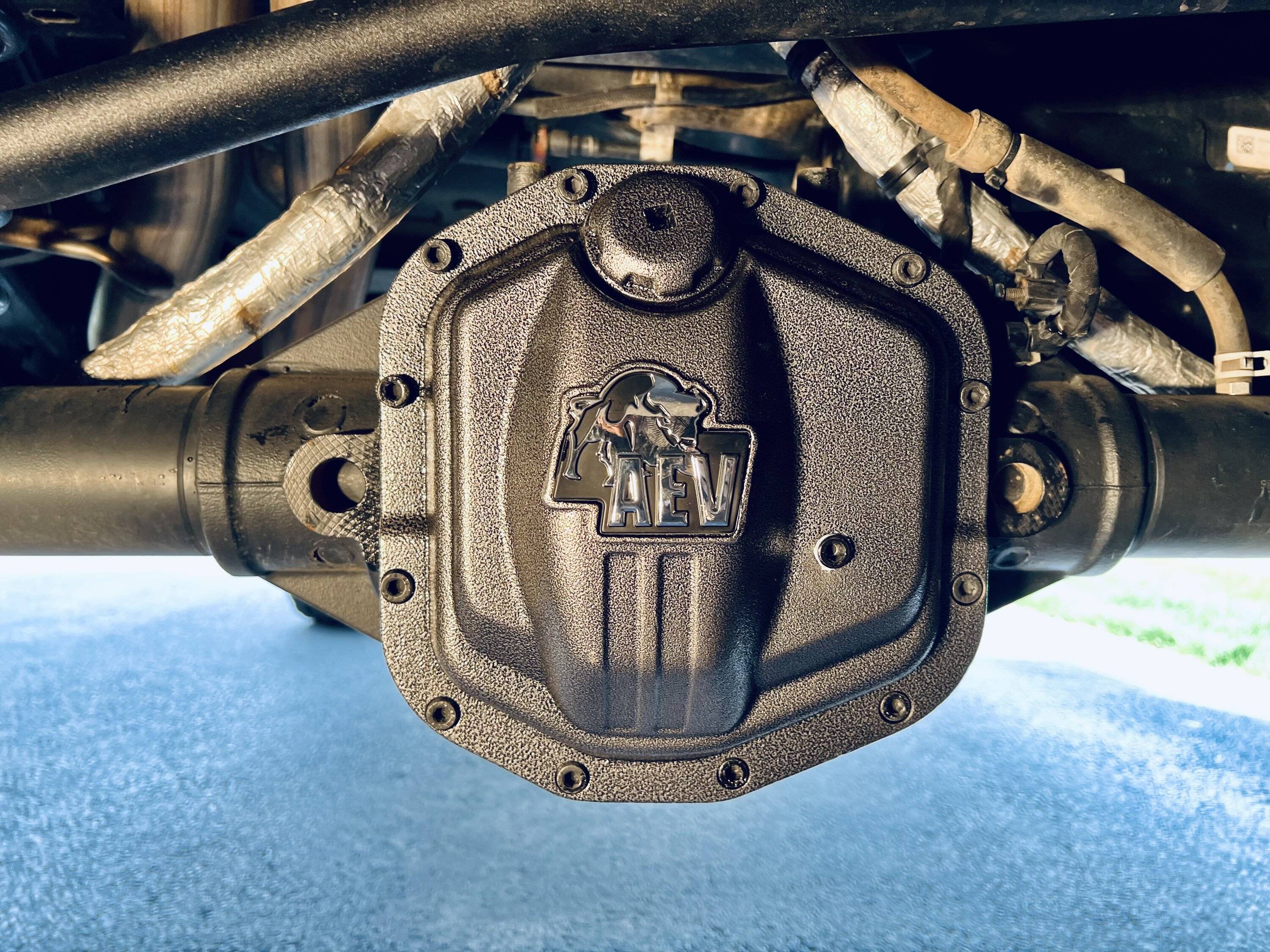

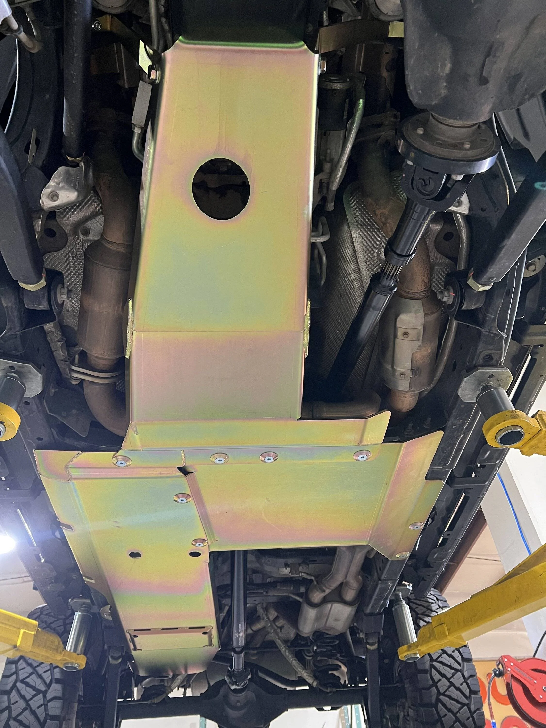

Installed the front and rear AEV diff covers today to add some protection ahead of my first wheeling trip of the season this weekend. These things are solid, and the tin can stock ones don’t compare.
Jeep Wrangler JL Matt's 392 Build B6787318-51C8-4971-84A8-C583379458C4
Back was very easy and took about 30 minutes start to finish. Ring gear looked flawless and saw no evidence of large metal chunks or flakes in the stock oil or around the diff housing.
Jeep Wrangler JL Matt's 392 Build 2A302724-1119-49D8-A31F-ED9EC7493DA6
Jeep Wrangler JL Matt's 392 Build 9E3DF37E-6989-464F-A3C9-3F55A84D1782
Jeep Wrangler JL Matt's 392 Build 67F9B1F5-7D2C-4429-8C72-2DB7D2B55857
Jeep Wrangler JL Matt's 392 Build 1408B5E7-C3F0-4318-9CE7-82B8D472E18B
A little tight maneuvering in the front with the tie rod and steering stabilizer but with a little help from my wife we got it in place and bolted it up without issue. Gears and stock oil in the front were also clean of metal shavings and chunks and looked flawless.
Jeep Wrangler JL Matt's 392 Build D6A1B17D-2270-4BBD-8F86-B6684E230105
Jeep Wrangler JL Matt's 392 Build 798EF331-61EB-4689-8C14-8E1FA9929326
Jeep Wrangler JL Matt's 392 Build 8279C35D-8663-4542-8A92-373E2E05C56D
While the stock oil I removed was free from metal shavings or chunks, the oil was thick, almost sludge like. I’m glad I changed it out. For new gear oil, I used Royal Purple 75W90 in the front and 75W140 in the rear.

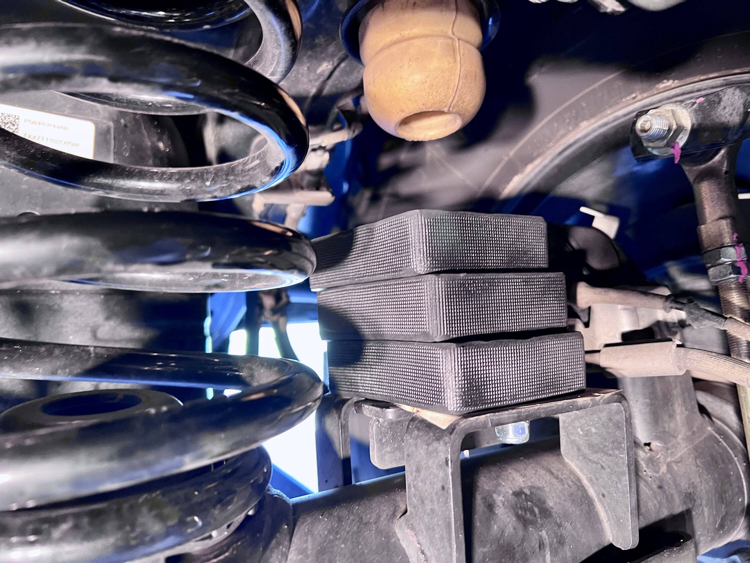

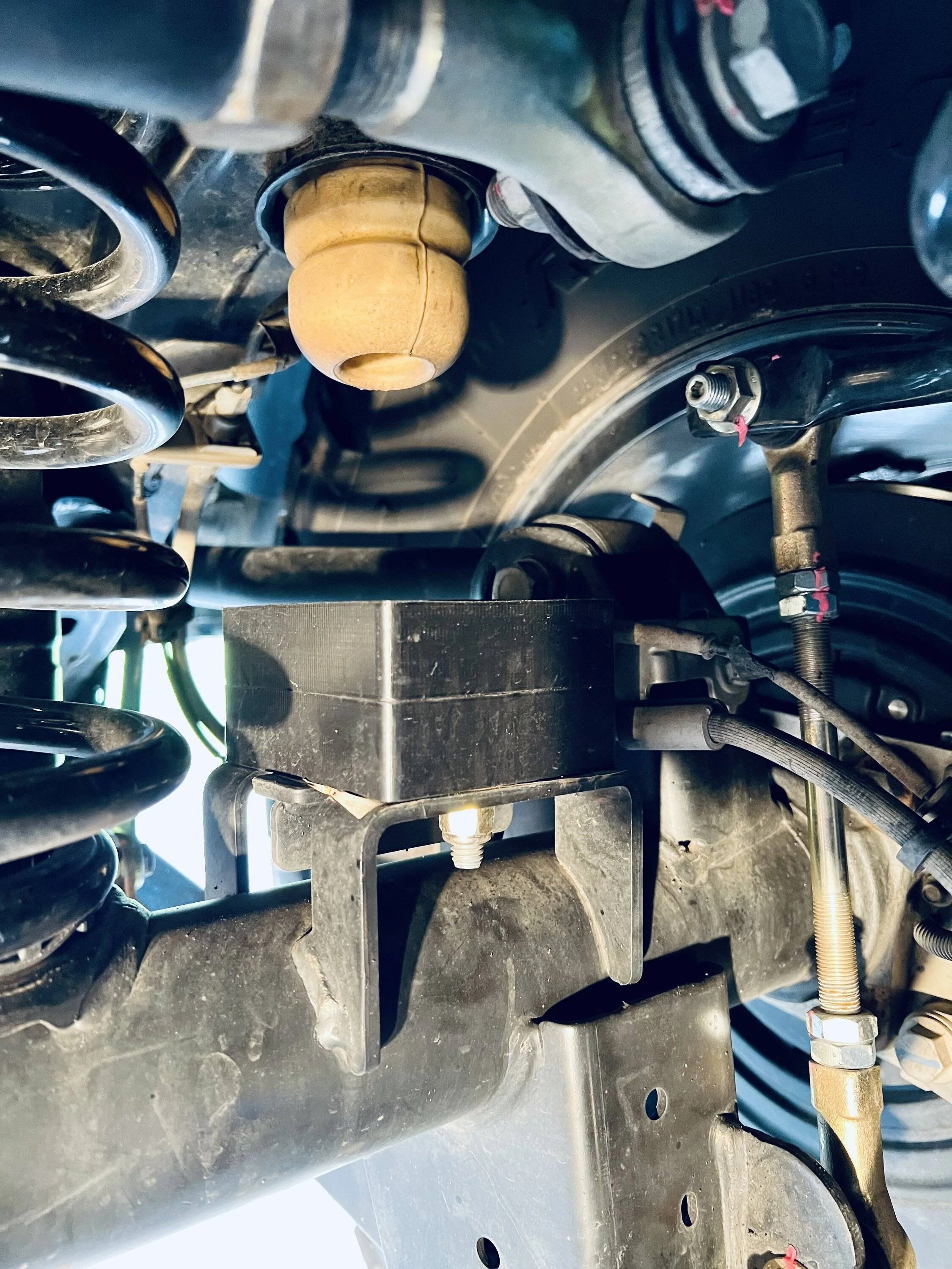

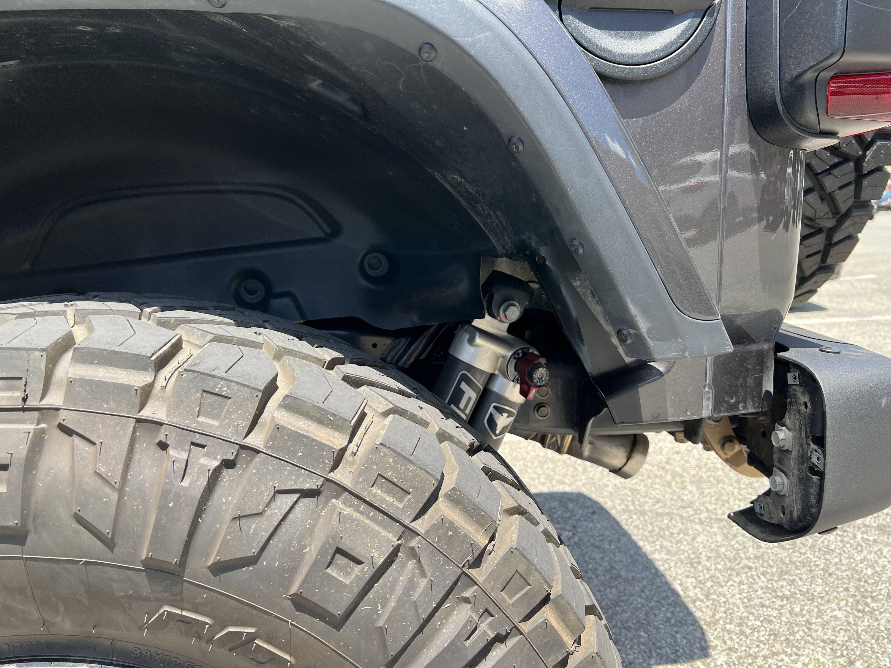

I also replaced the Clayton 2x1” rear bump stop pads with 3x1” Metalcloak pads on either side to keep the rear tire from running into the frame, as it was at full flex when we put it on the forklift at the shop. If I’m still running into the frame I have another inch for each side I can throw on when on the trails this weekend. I like the Metalcloak bump stops better than the Clayton ones as the Metalcloak ones are softer and seem like they would absorb impact better.
Jeep Wrangler JL Matt's 392 Build 8D3BA31A-5E1A-49E5-834E-F3E1B1306463
Jeep Wrangler JL Matt's 392 Build D11DE9F4-C4A0-4FC6-94B6-D627EE4C4ABB

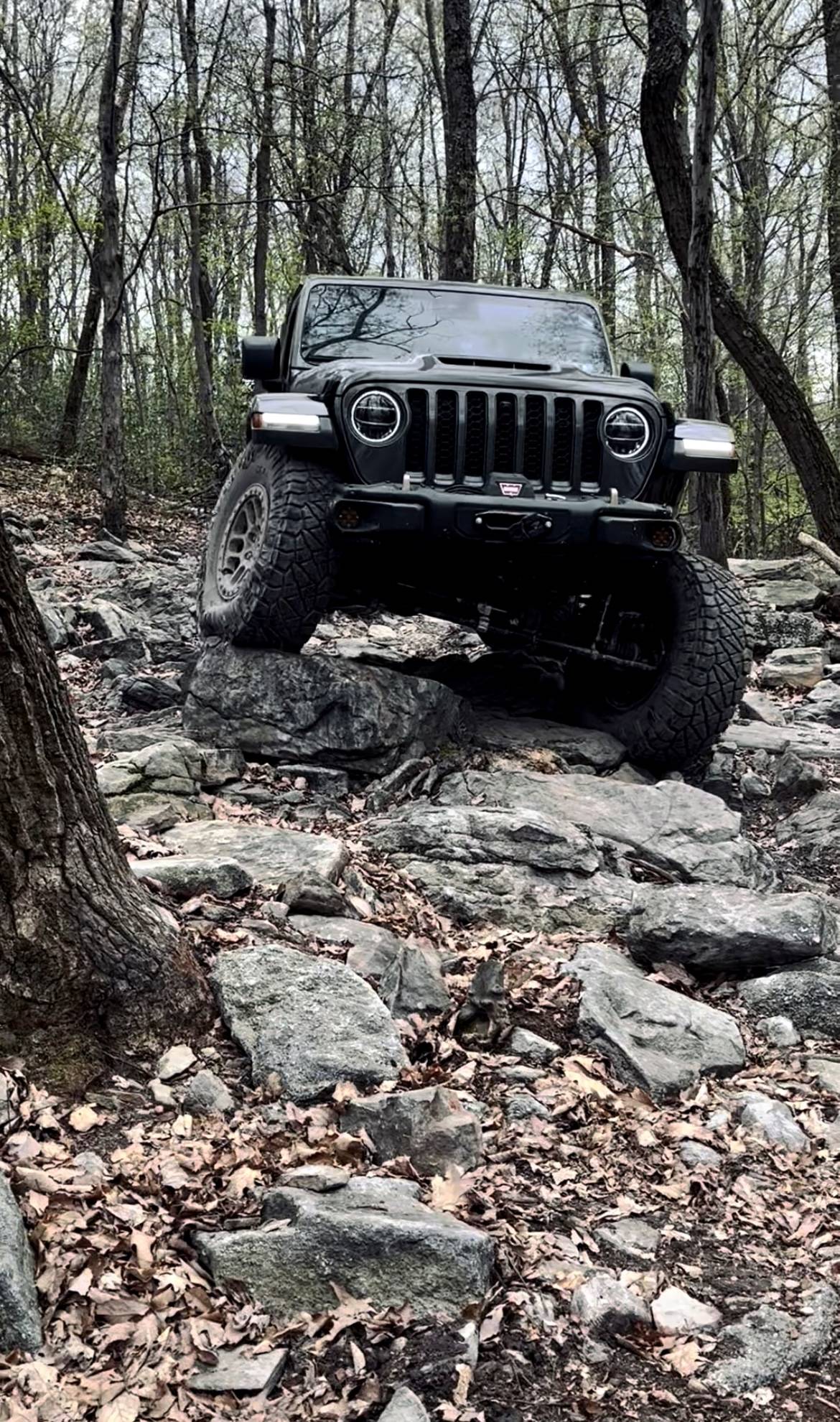

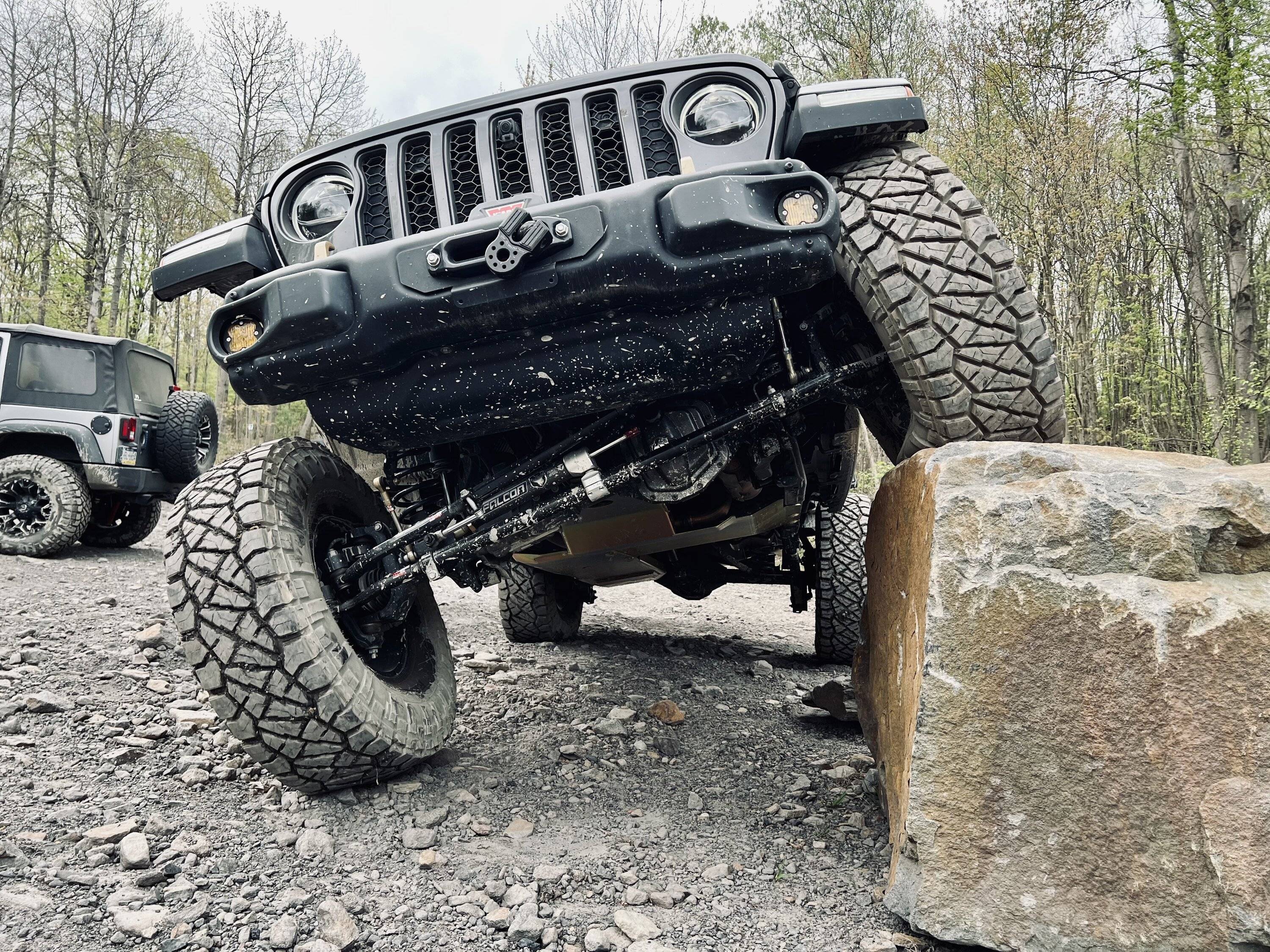

Great day of wheeling at AOAA. Got to test the new suspension and tires out finally and other than a tad bit of rub on the back, it ran flawless, and took everything I threw at it in stride. Even got to conquer my first black trails. Got way too off camber and came a little too close to flipping the Jeep on The Pit trail, but survived. Looking forward to the next event in 2 weeks!
Jeep Wrangler JL Matt's 392 Build 1D0FDFD7-687B-4FE6-94B0-18A0CD77E7DE
Jeep Wrangler JL Matt's 392 Build 402354AC-5229-49CE-B743-D9B209F67DE4
Jeep Wrangler JL Matt's 392 Build BF363117-3607-47BC-8443-4C4ABDF7F6B4
Jeep Wrangler JL Matt's 392 Build 25BC0C91-D27D-4B8C-8939-FA4A146120AC
Jeep Wrangler JL Matt's 392 Build 0A143D24-6698-4A6F-8F50-E77AD8B1EFF9
Jeep Wrangler JL Matt's 392 Build 5210A2F8-BDE5-44CB-AD97-EA9C1CD263C2
Jeep Wrangler JL Matt's 392 Build 3592C6BD-E4C7-411A-BC79-C45ACB8AD49B
Jeep Wrangler JL Matt's 392 Build 0C909739-7EEC-46EF-A328-1CF73CB11493
Jeep Wrangler JL Matt's 392 Build 6FEB5F92-5CF2-4F3D-B959-6EDD173AB230

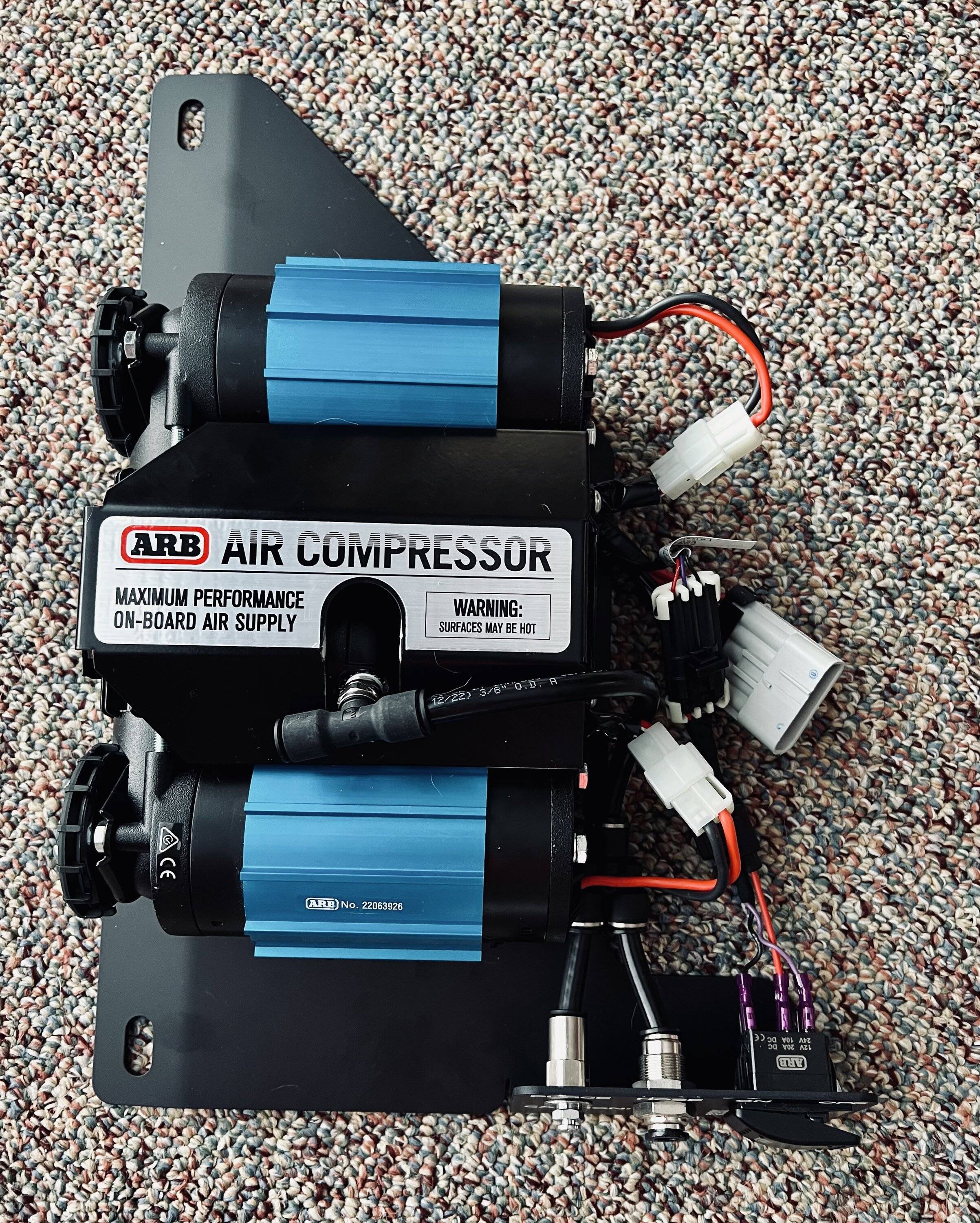

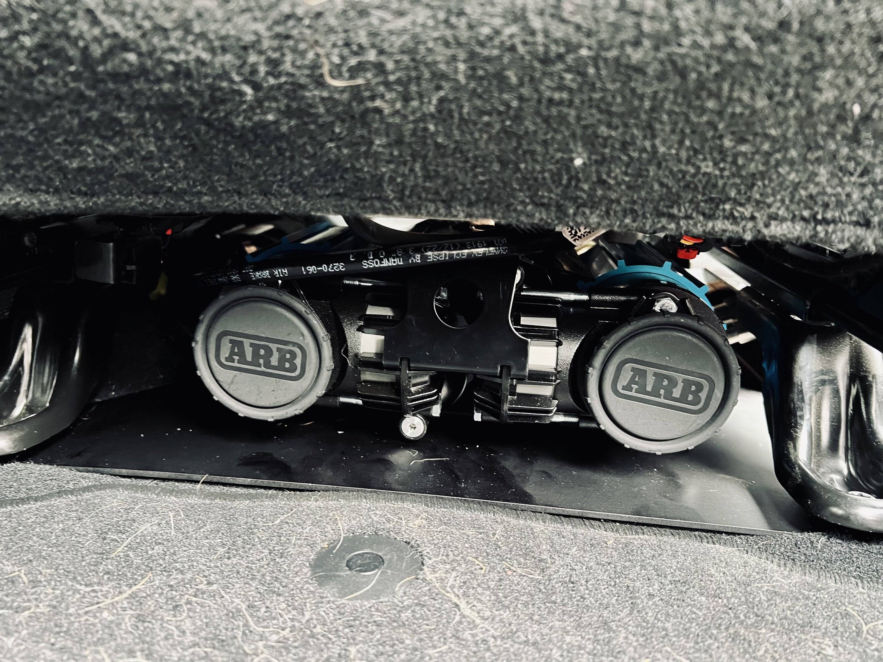

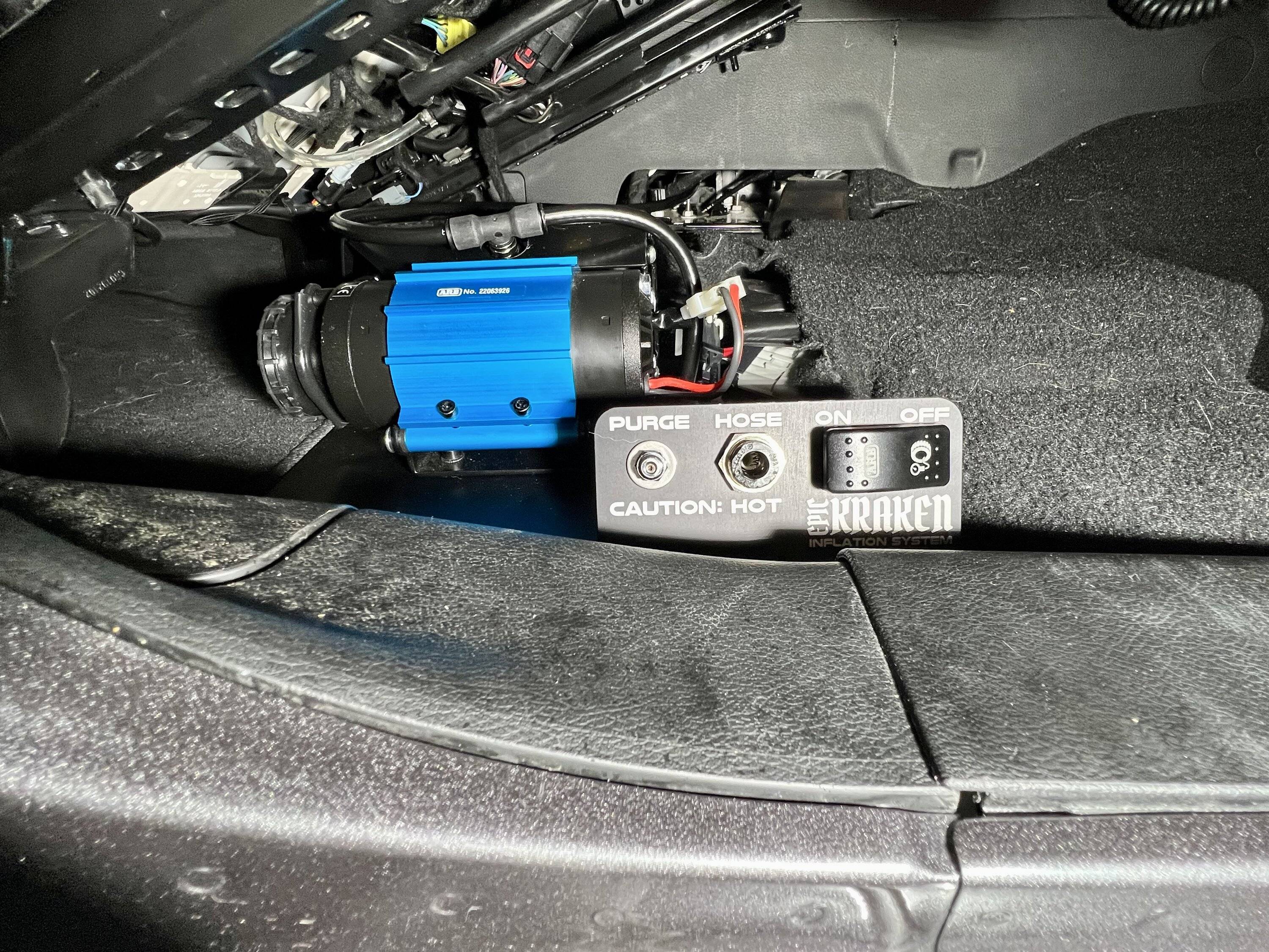

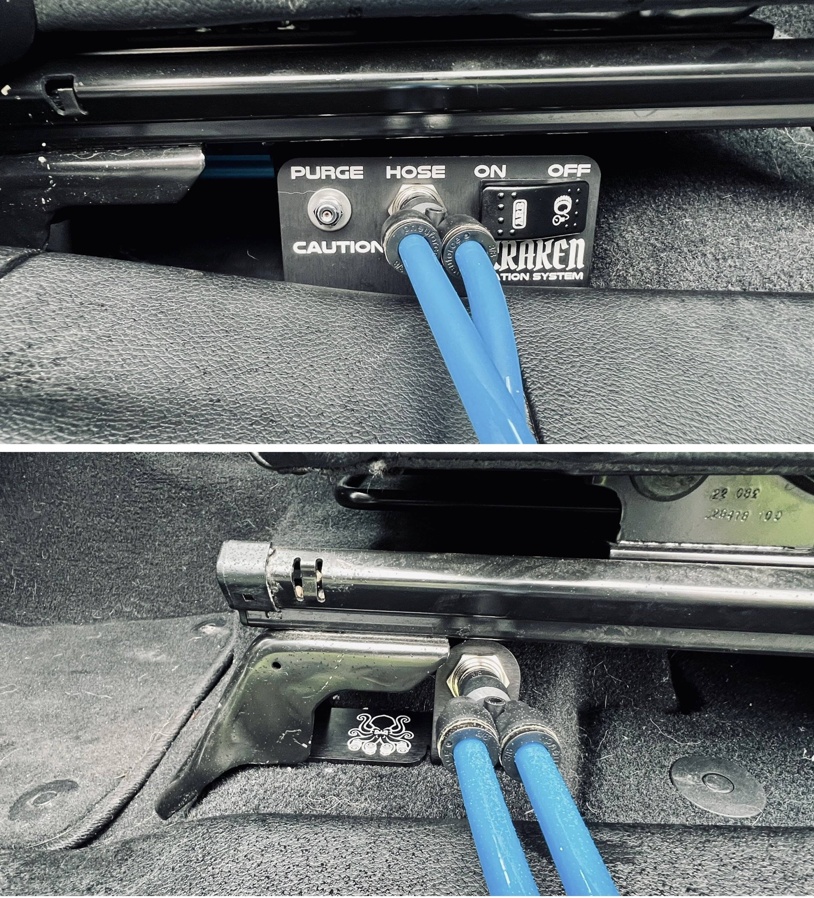

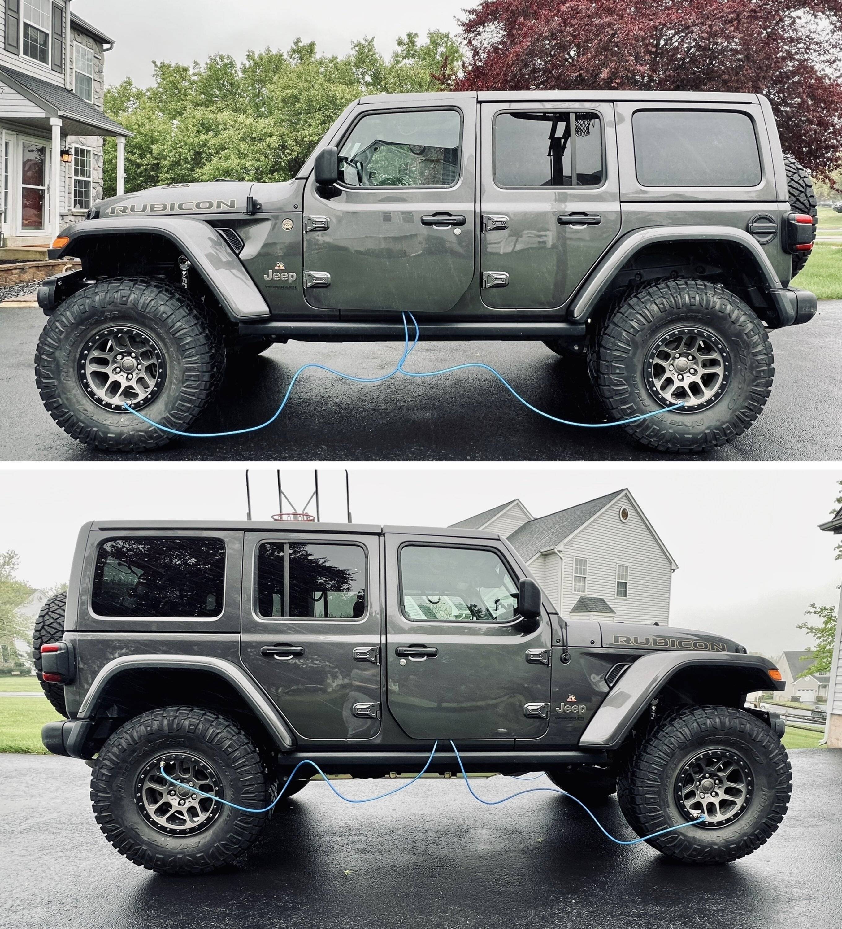

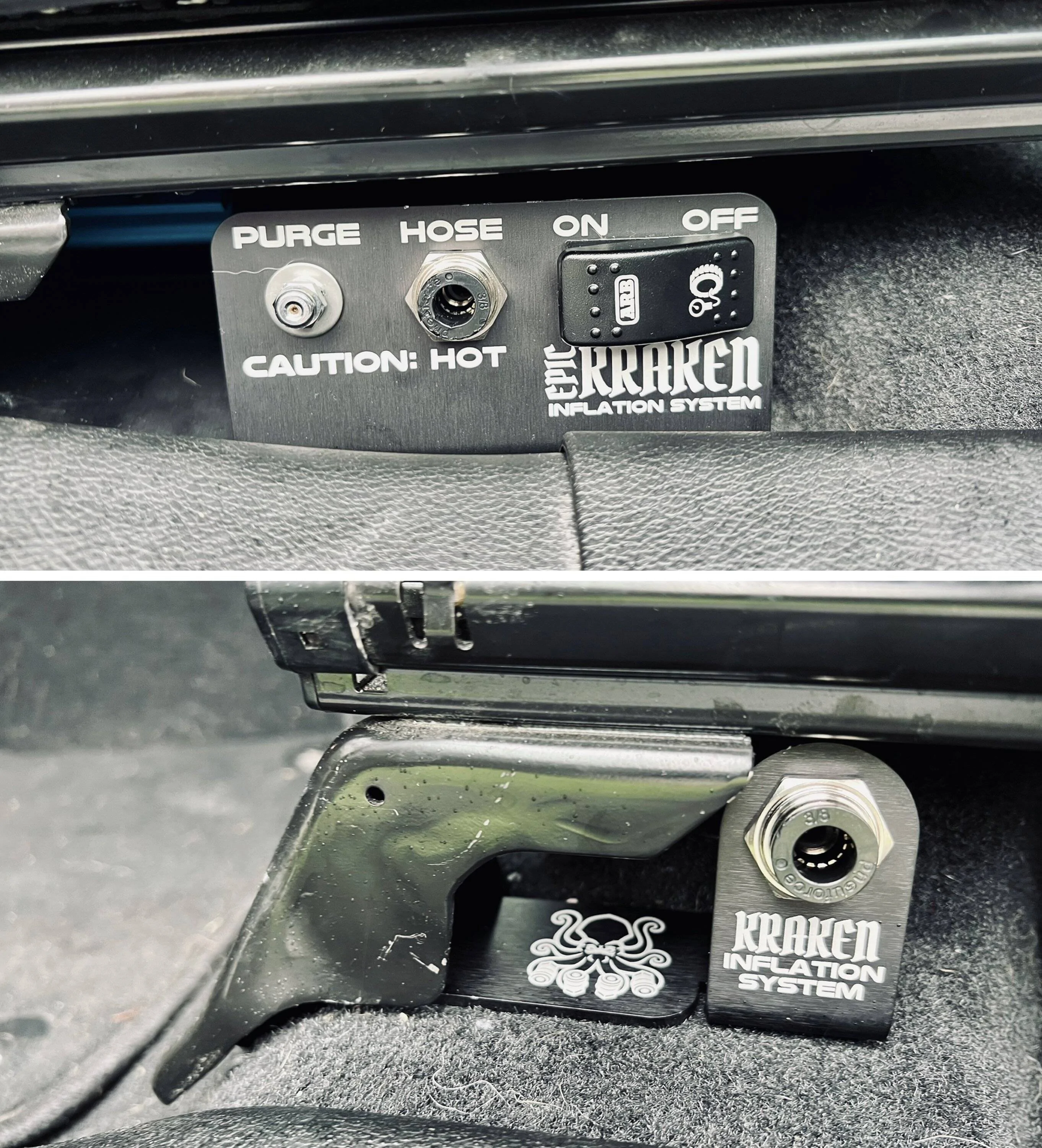

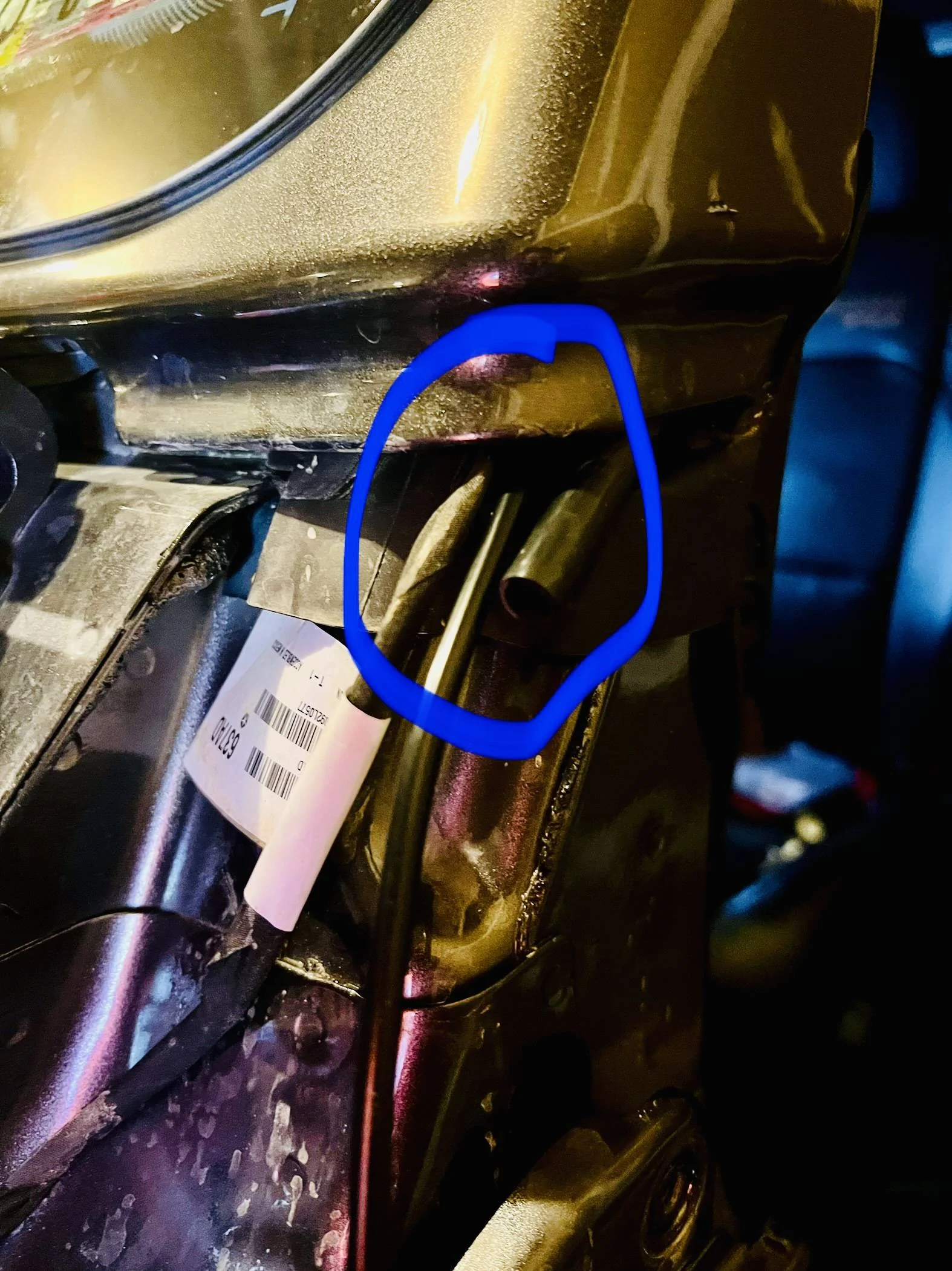

ARB Twin + Epic Kraken install today. No more waiting in line for the air stations!
Install was pretty easy. The ARB supplied power harness is not very long, there was BARLEY enough cable. Supposedly will fill up all four of my 38s together from 15 to 35 psi in about 6-7 minutes, we’ll see next weekend after the Recovery for a Cause event at AOAA.

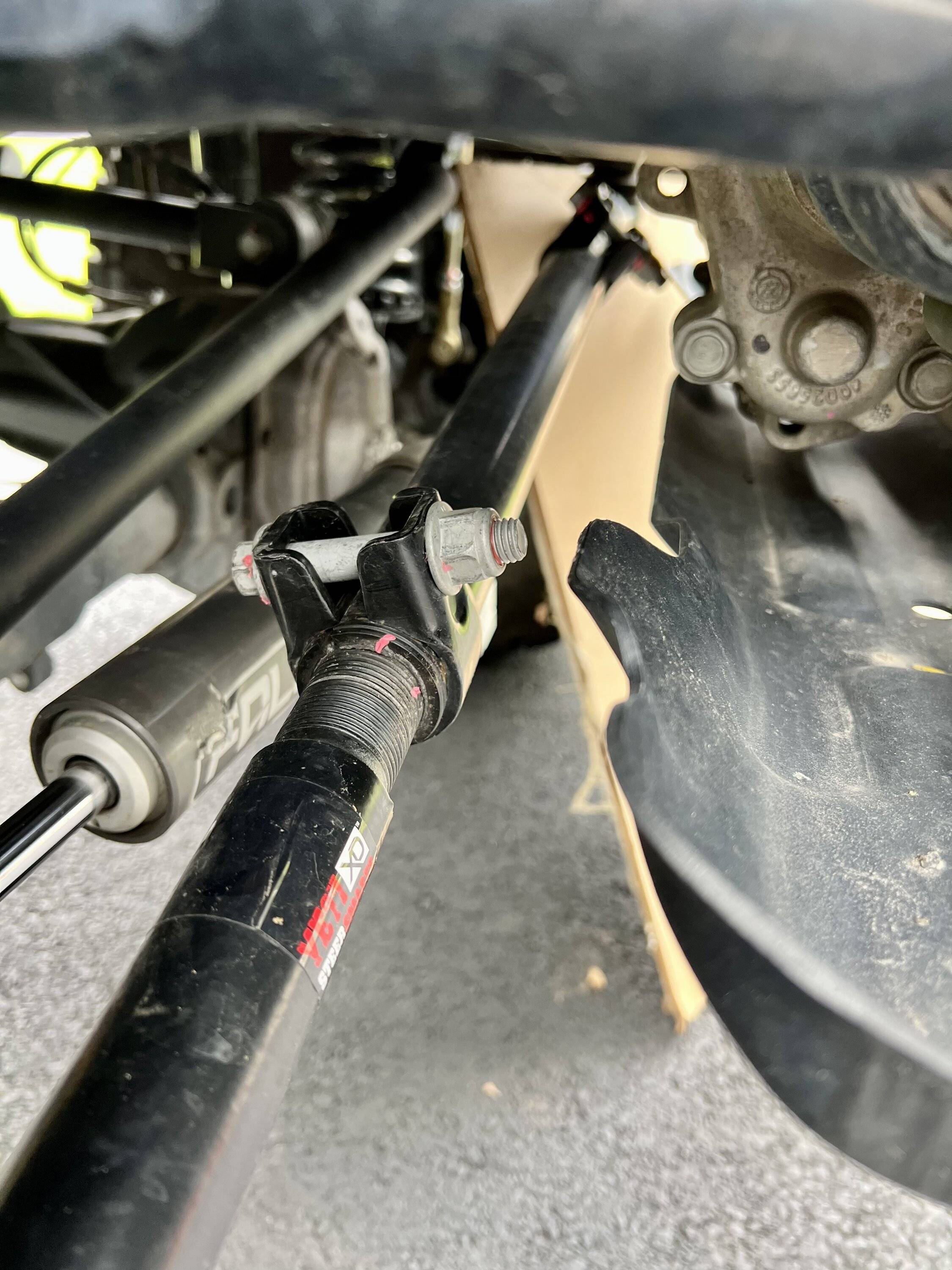

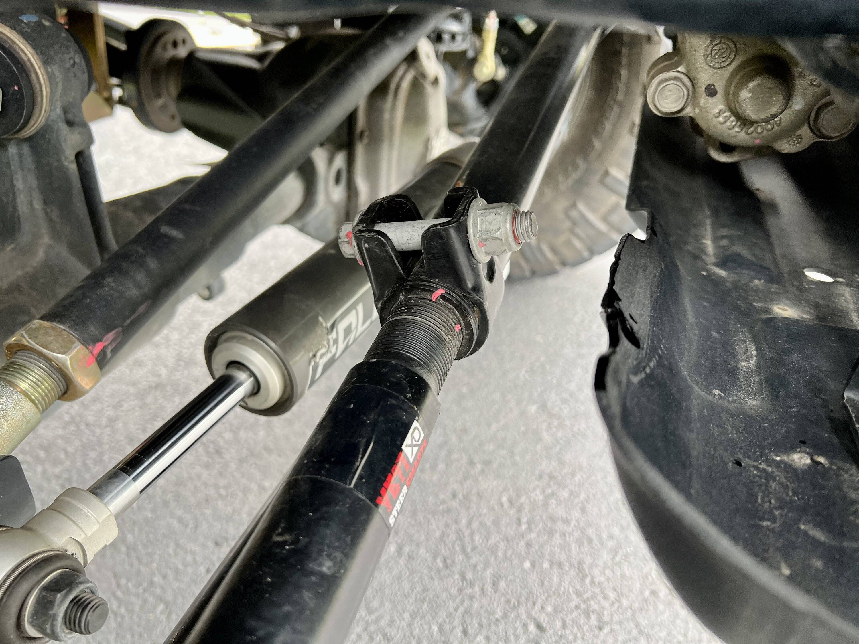

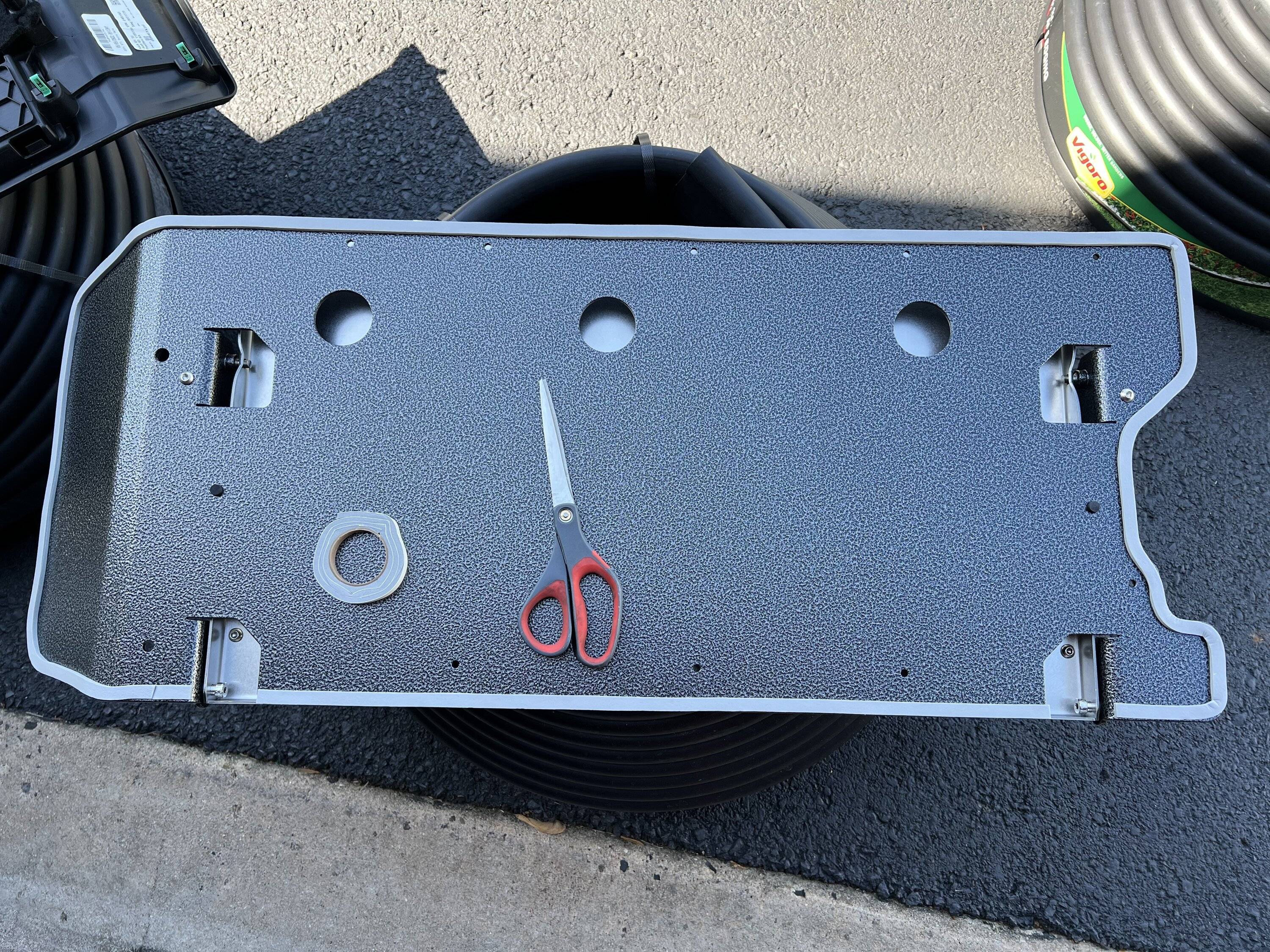

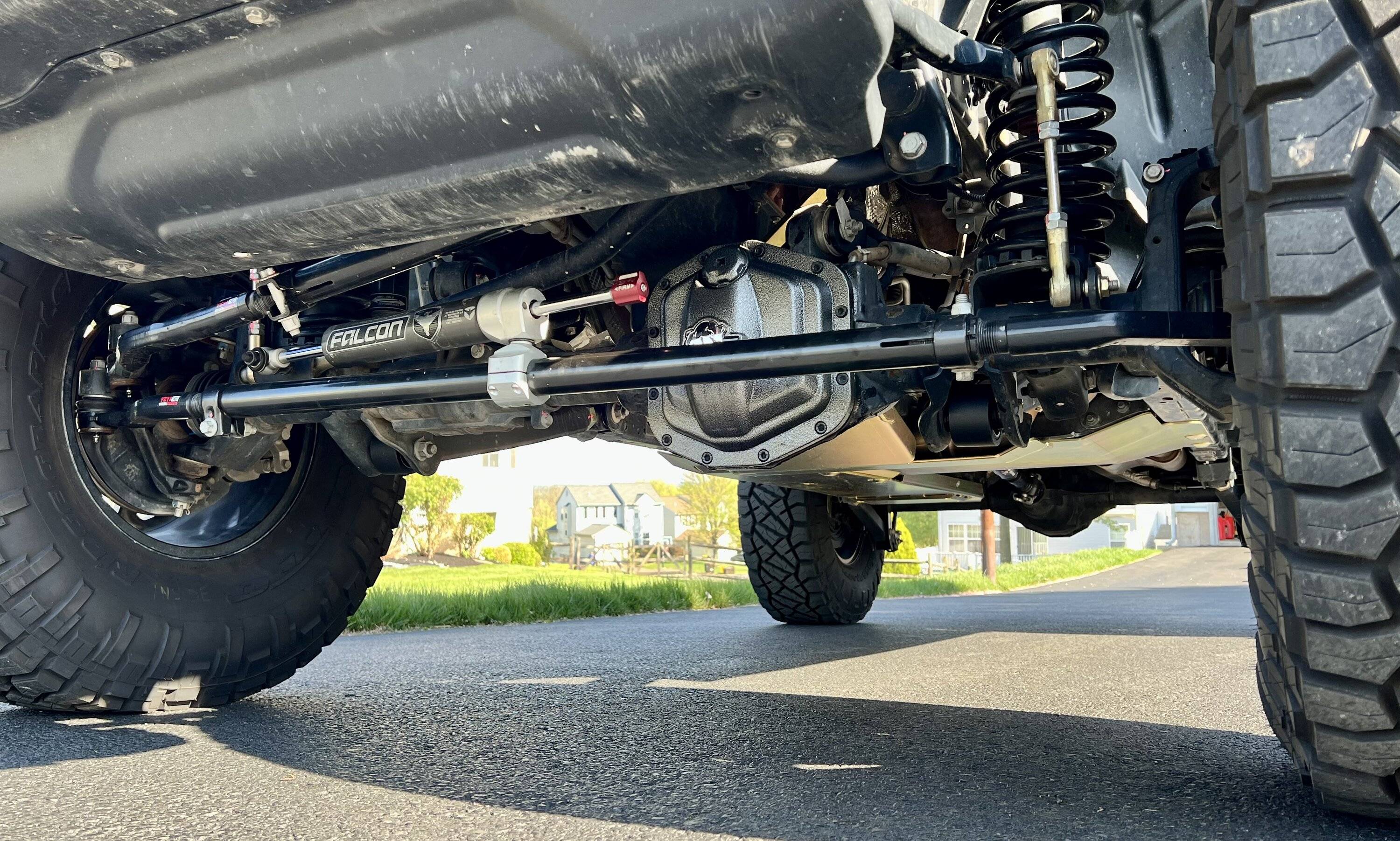

In preparation for the next off-roading event tomorrow, did a little trimming of the factory skid plate to keep the drag link bracket from running into the skid plate, which happened on a few occasions on trails 2 weeks ago.
Jeep Wrangler JL Matt's 392 Build 3985945A-905A-4A43-B669-509121D589C7
Jeep Wrangler JL Matt's 392 Build CB982865-4446-4651-9923-FD8166BE5F02

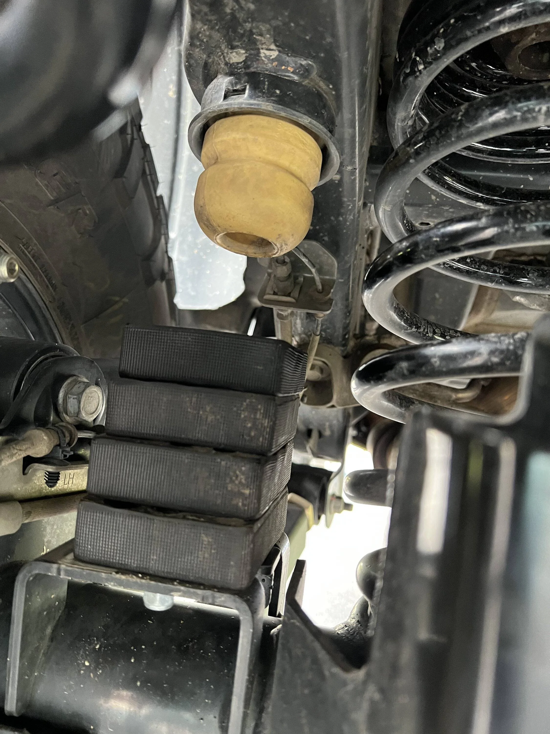

Also added an extra inch of bump to keep the tires out of the rear wheel wells, had some rubbing last time out. Talking to my local shop about trimming the pinch seam of the tub behind the fender liner, but for tomorrow the extra bump will have to do.
Jeep Wrangler JL Matt's 392 Build 6277CB23-E9D3-4EA0-9A48-A31914EC5FFC

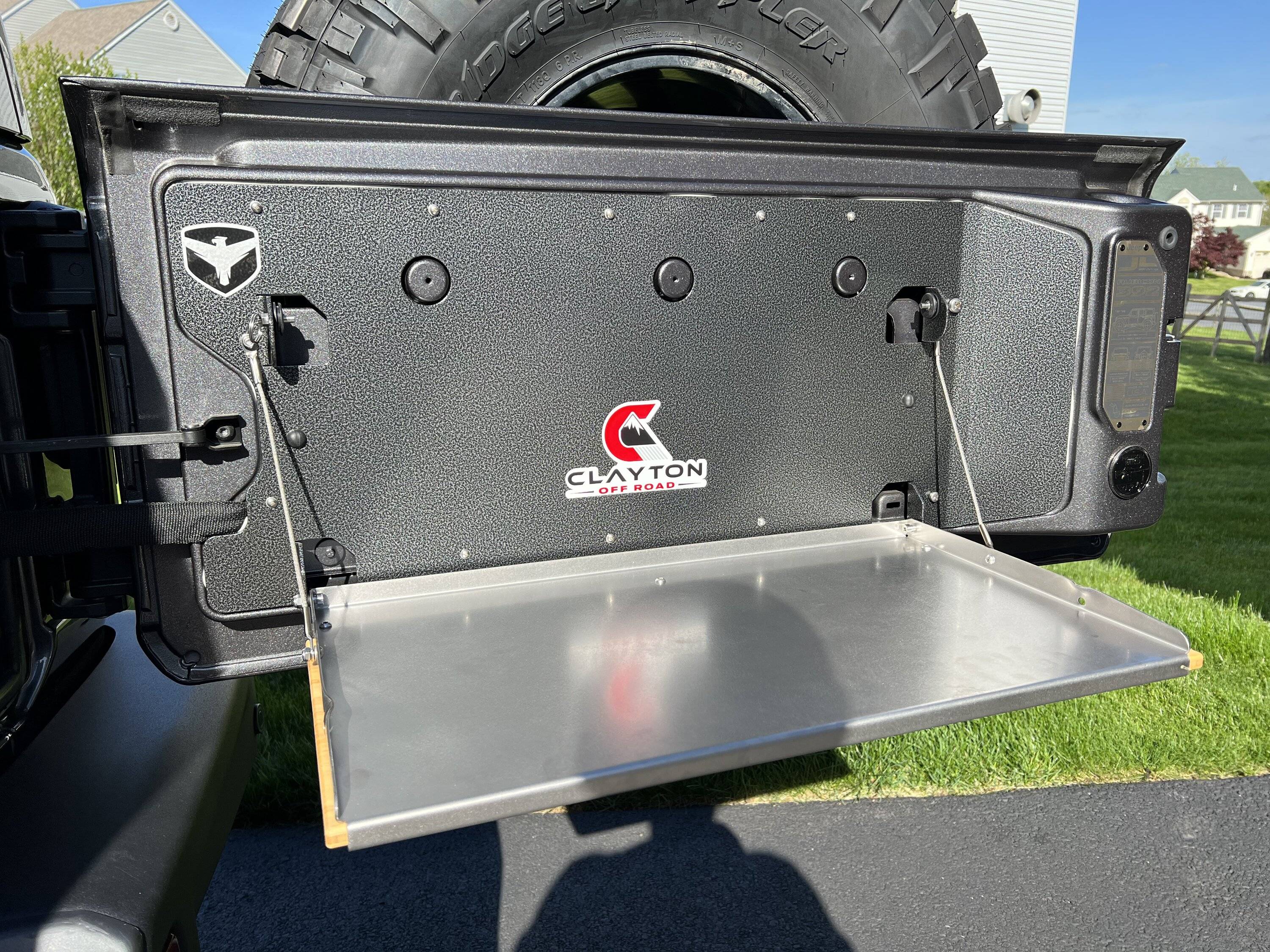

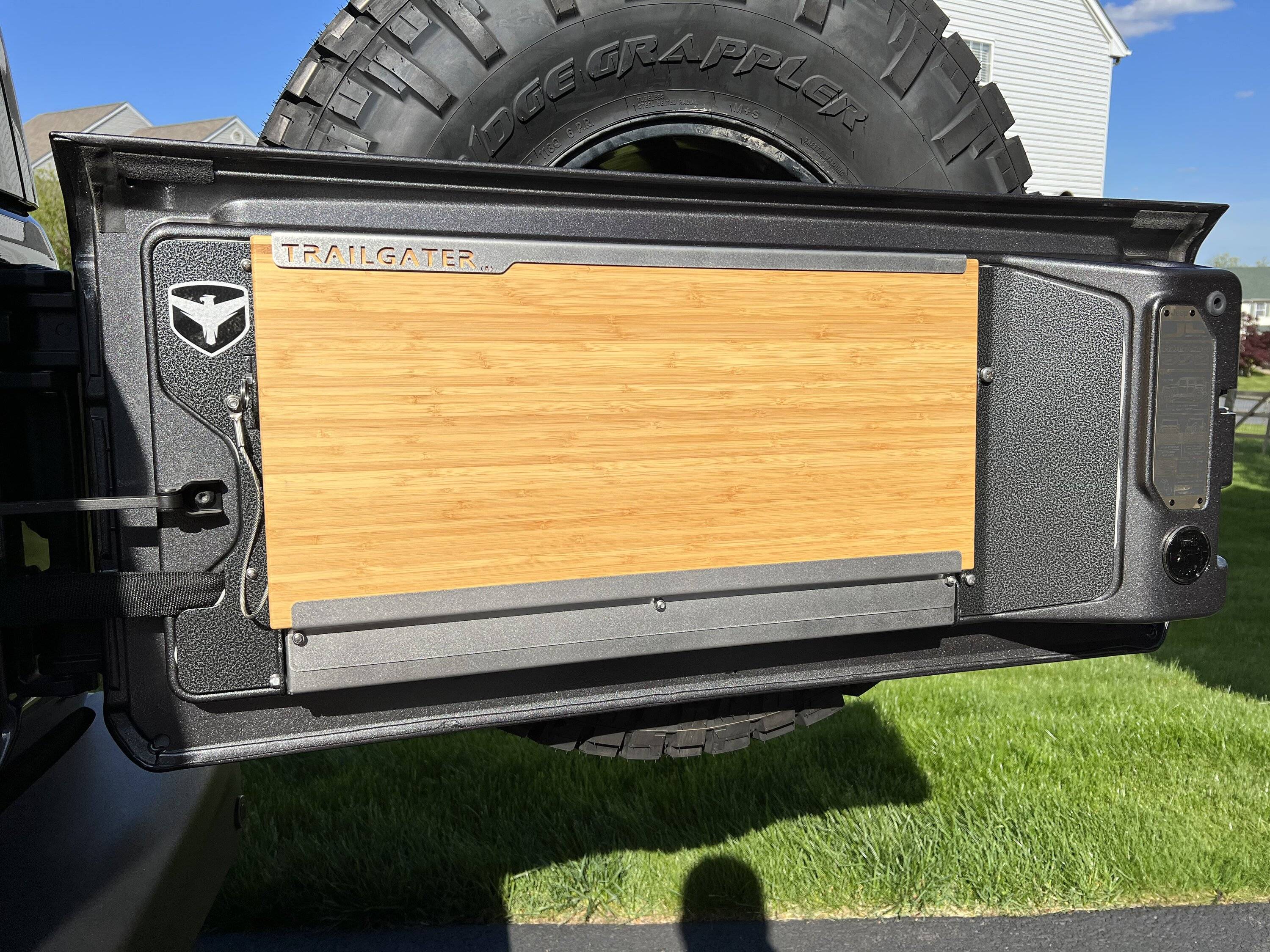

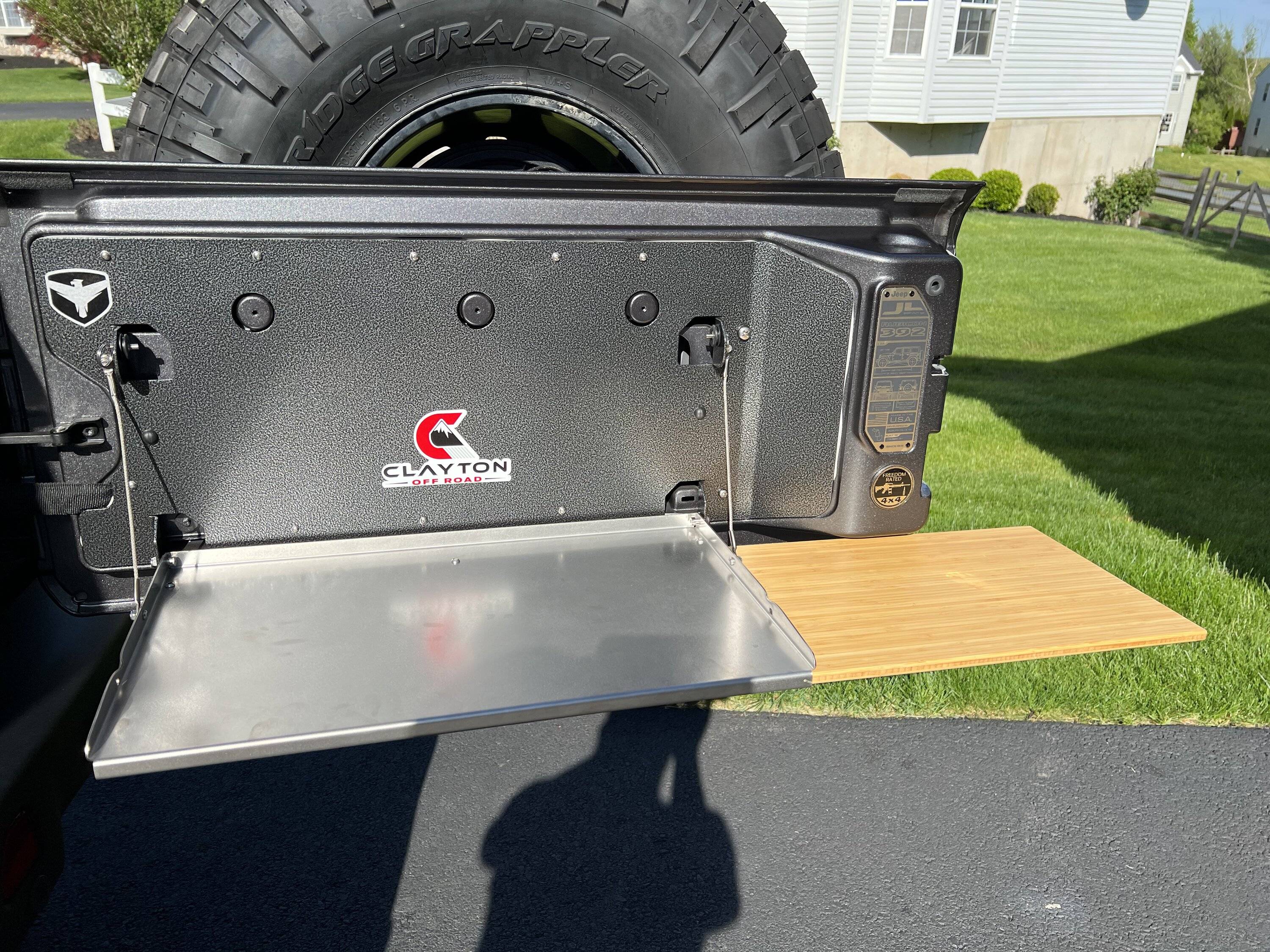

Installed the Outback Adventures Trailgater tailgate table this afternoon. Took all of about 10 minutes. Looks real good and the Hammertone Grey matches real well with the Granite Crystal.
The bamboo cutting board is raw, I want to get some food grade bamboo cutting board oil for it to give it a darker stain and seal it. Has anyone else done that? If so which oil did you use?

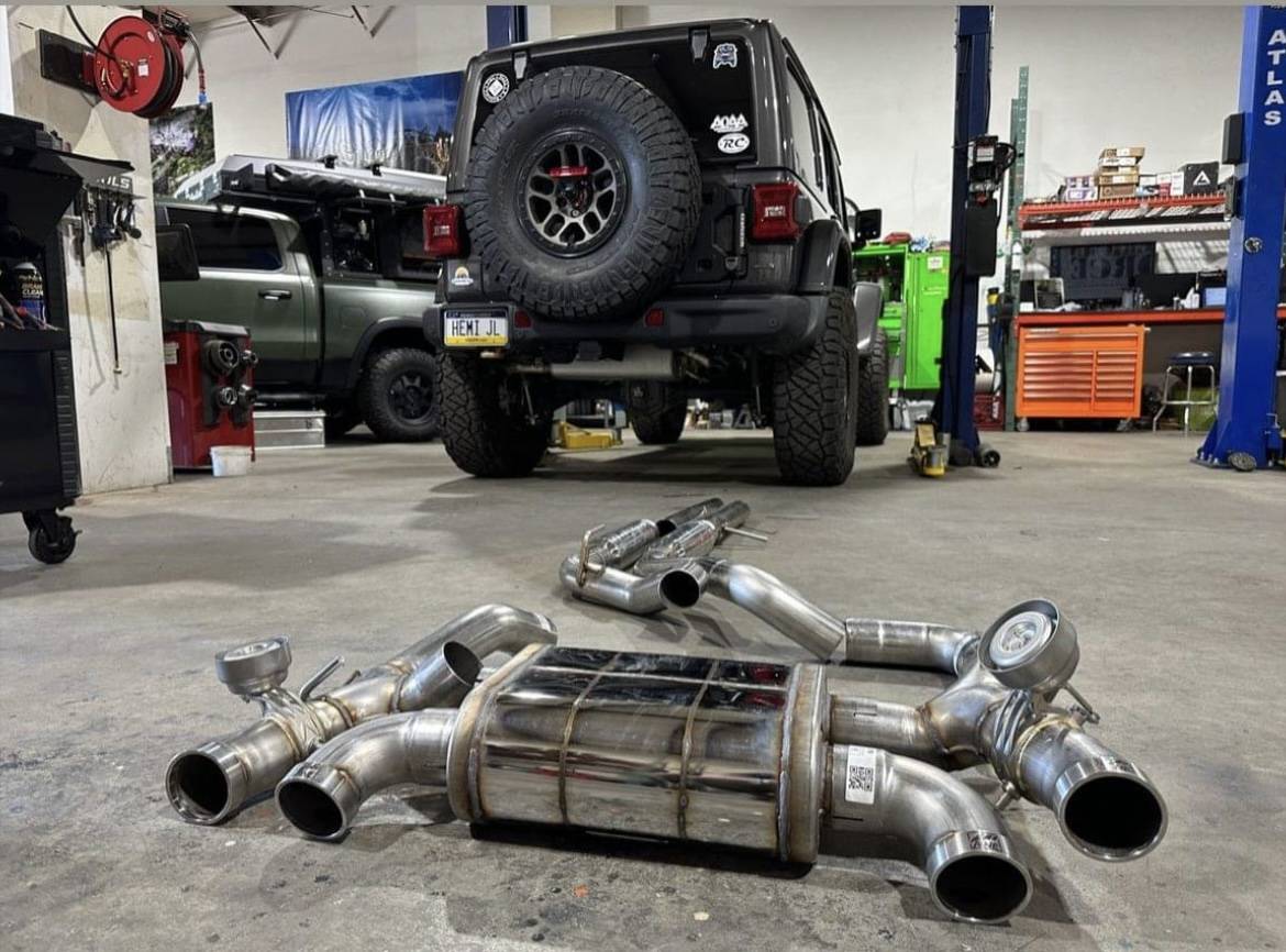

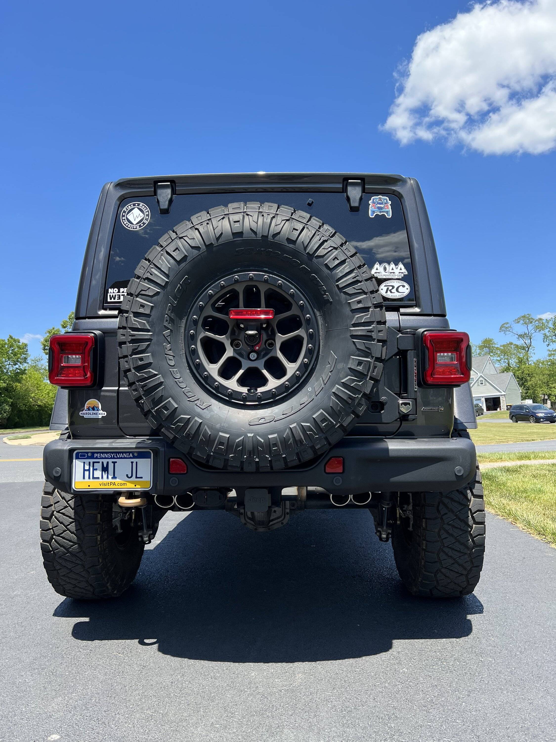

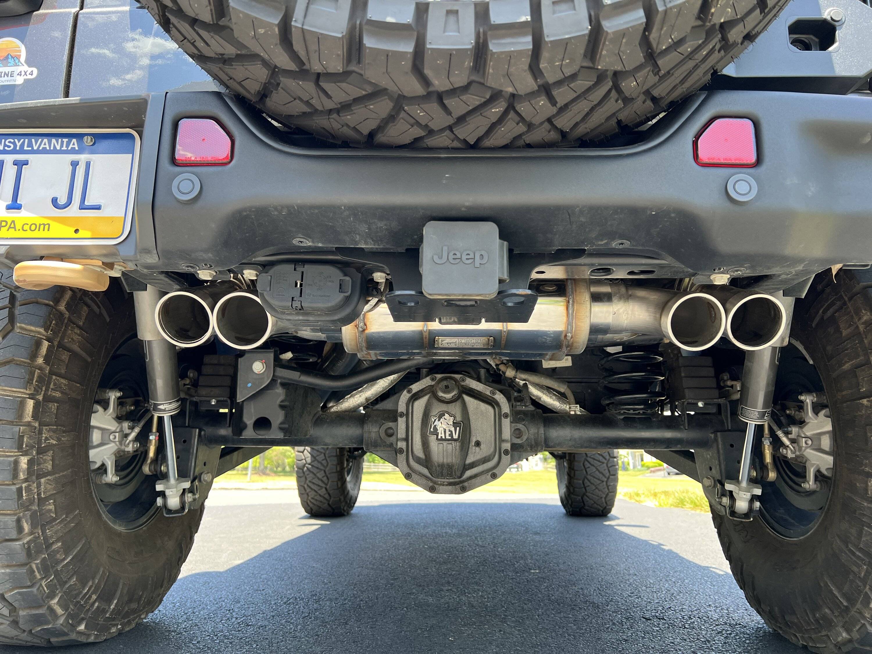

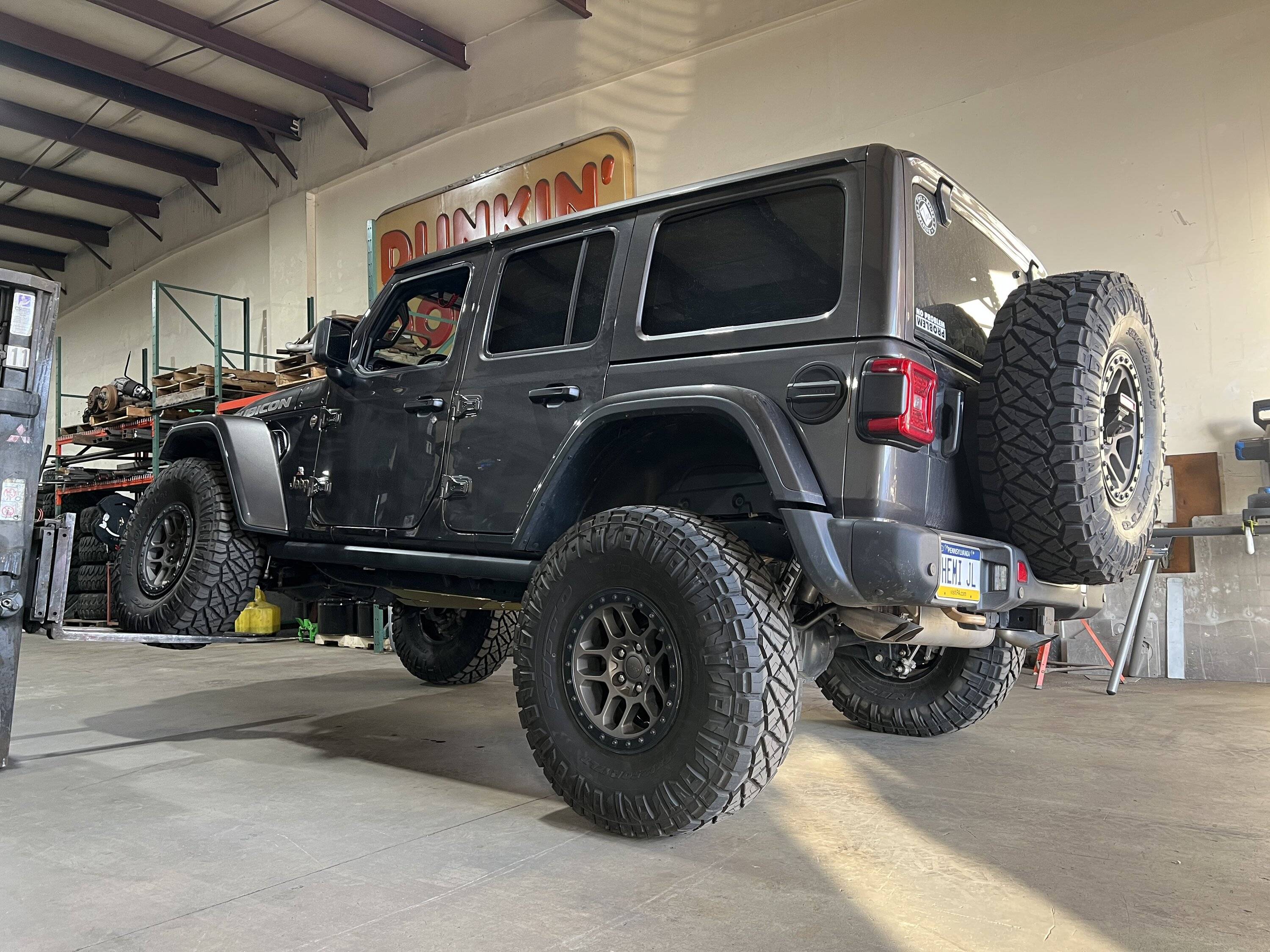

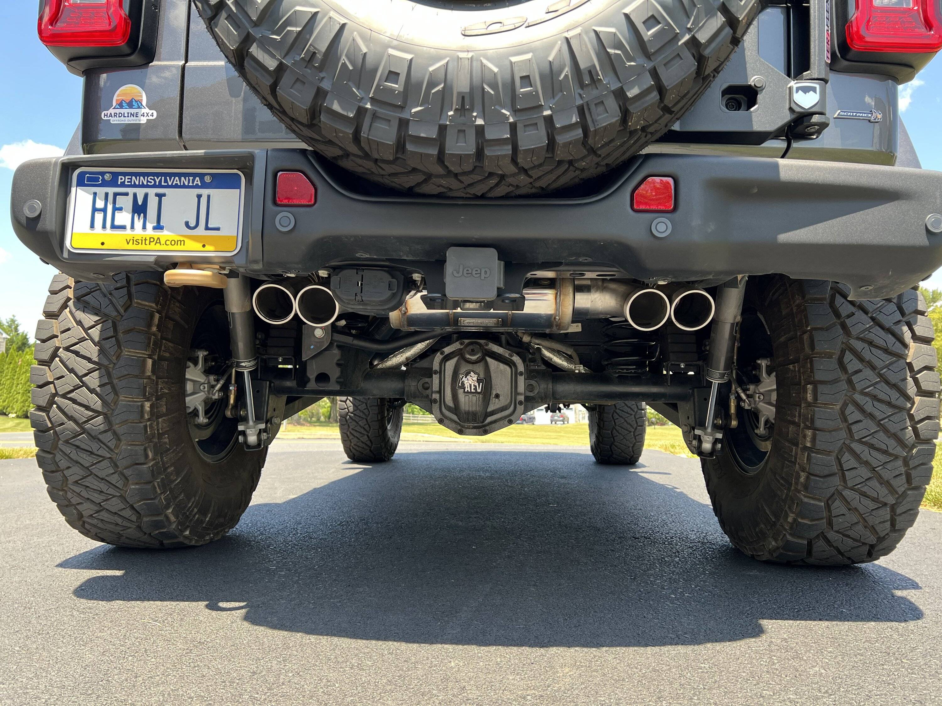

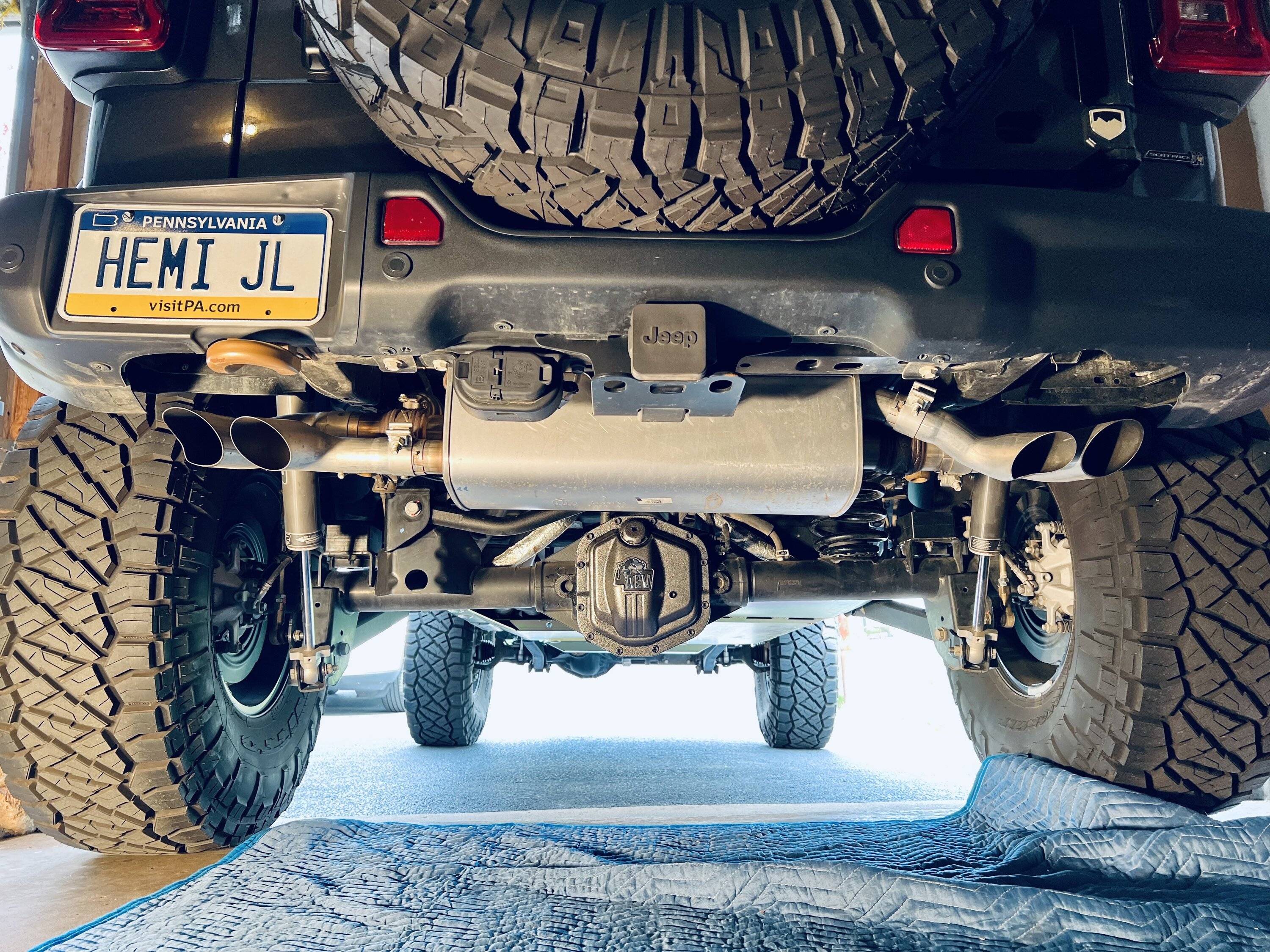

Oh my god. This AWE exhaust has the PERFECT sound! Looks great, nice and tucked. I drove the whole way home from the shop grinning ear to ear listening to the new tone. None of the videos online do it justice. If you’re on the fence, get it!
Jeep Wrangler JL Matt's 392 Build 82C883AE-5012-46F5-857E-04F1E58B80D1
Jeep Wrangler JL Matt's 392 Build E7D26B9A-AE5E-4186-BD59-B21B5AB9D4F3
Jeep Wrangler JL Matt's 392 Build 229C519F-EBC6-4708-BA6F-548DA4C09522
Jeep Wrangler JL Matt's 392 Build C190AC26-AC4C-4804-87D9-D409C88BC22F
Also had some of the rear pinch seam of the tub trimmed to keep the 38s from rubbing. So much more clearance now. Unfortunately I forgot to take a before picture but we removed about an inch and a half of steel from the tub.
Jeep Wrangler JL Matt's 392 Build 18268C41-9331-4CD7-9F02-A5C86CAA4172
