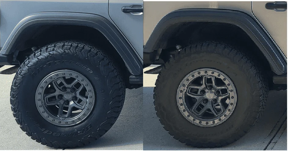

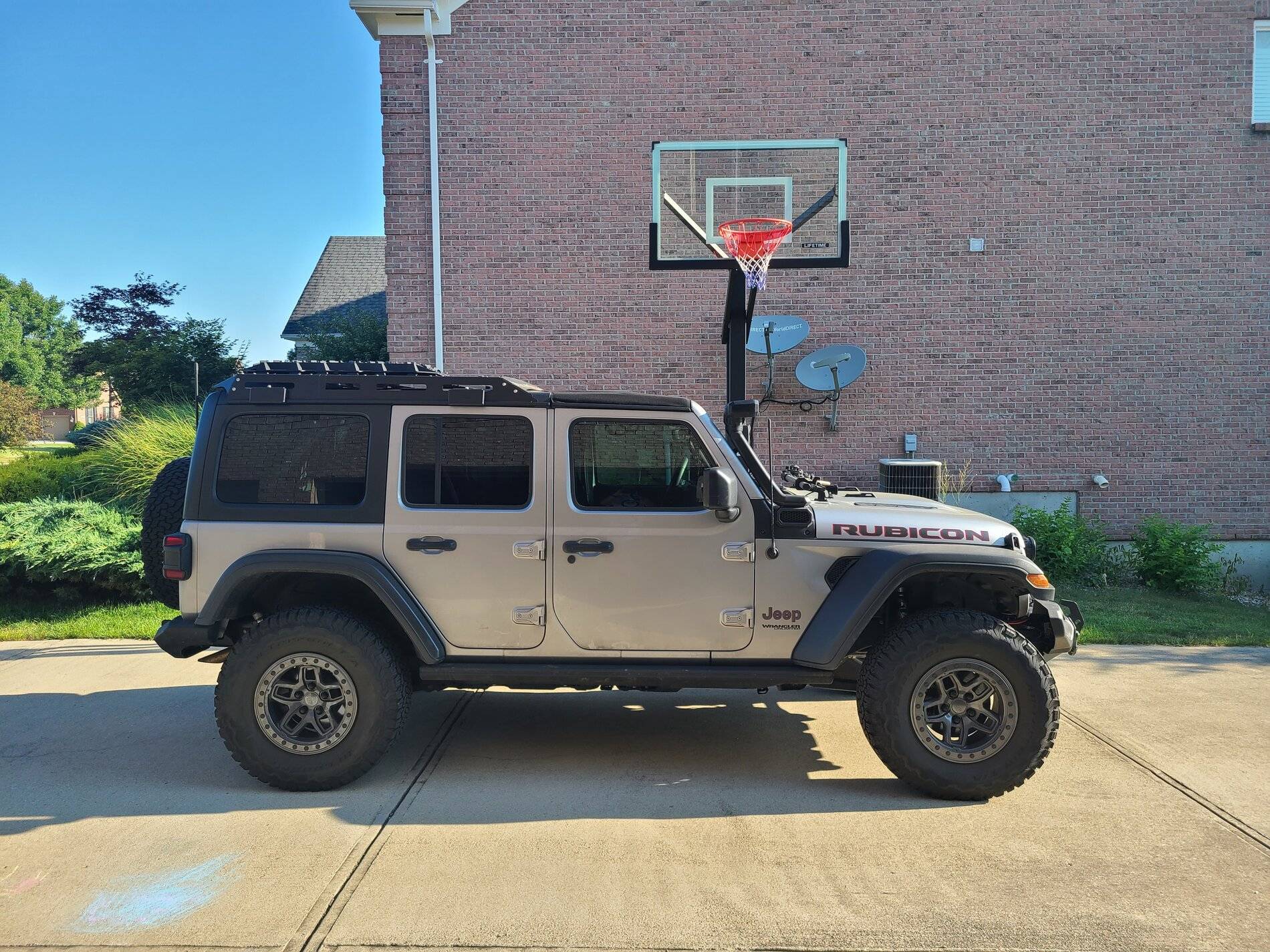

Here are the quick results, for reference, the top picture is with 315 KO2 load C and the bottom picture is the new 37 KO2 load C. I have Dynatrac 2" lift but with all the gears you can see in the picture, it is about 1.5" lift at most.
I set the tire size to 35 using Flashcal and it is spot on with highway speed, previously I have it set to 33.5 with my 315 KO2 tires. So essentially this is a "true 35" tire but you get to claim you are going "37".
The ride is exactly the same with my 315 KO2, and I can't tell the difference between these and the OEM 33 KO2. They handle highway and crappy town road very well, plush ride but not soft. I had about 8000 miles on OEM 33 KO2, 25000 miles on 315 KO2, btw I still have 11/32" tread on the outgoing 315 KO2. These tires do last a long time.
I do have 4.88 gears so I see 8th gear all the time, in fact I saw 8th gear too much, it is comical to have 45 mph and 8th gear. Because the weight saving, I think my mpg will take minimal hit by going "37".
Oh I love these tires don't have white lettering, I can't deal with white lettering even if they are facing inward, so kind of bonus point for me.

More thoughts on my way home:
I generally found the narrower wheel width, the fattier tires look. 315 KO2 on my OEM Rubi wheels look like it is having a boner, but once I put on AEV Borah (8.5" width) it looks much normal. Now these 37 tires look even slimmer than 35, but could also be the perception of height/width ratio.
These tires ride so nice and quiet you will forget you are in a big box with a sail attached (my old JK used to do that with KM2). Discount Tire inflated them to 37 psi, I did not ask them to air down since I am sure these poor folks were told to just follow door jam sticker. Surprisingly, my Jeep is not wandering around like it supposes to be with high psi.

Slightly different angles, but you can definitely see the 37's fill the gap more than the 315's. For me, I think these are the "perfect" tire both in size and weight. Can wait for the wheels to come in so that I can get these guys mounted and installed.

I agree this is a better tire for several reasons
First, it is for the 35 too small 37 too big folks, it is also crazy light while still maintain the KO2 all-around profile.
Second, a heavy and true to size 37 opens a big can of worms, axle, steering, tire carrier, etc. With this tire most people can run with stock setup.
Third, thank you Ford!
