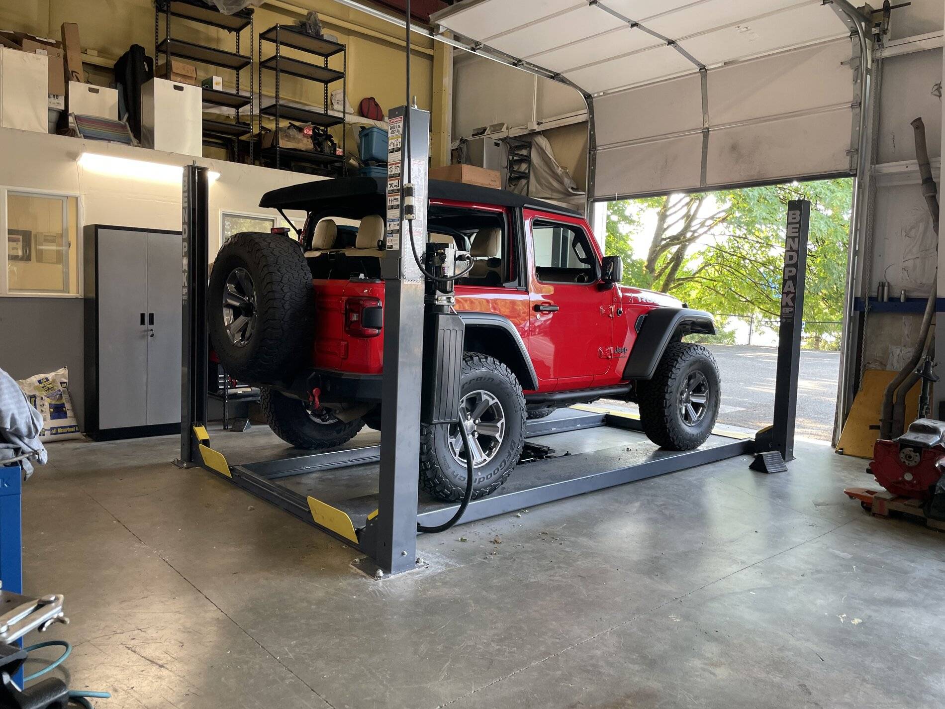

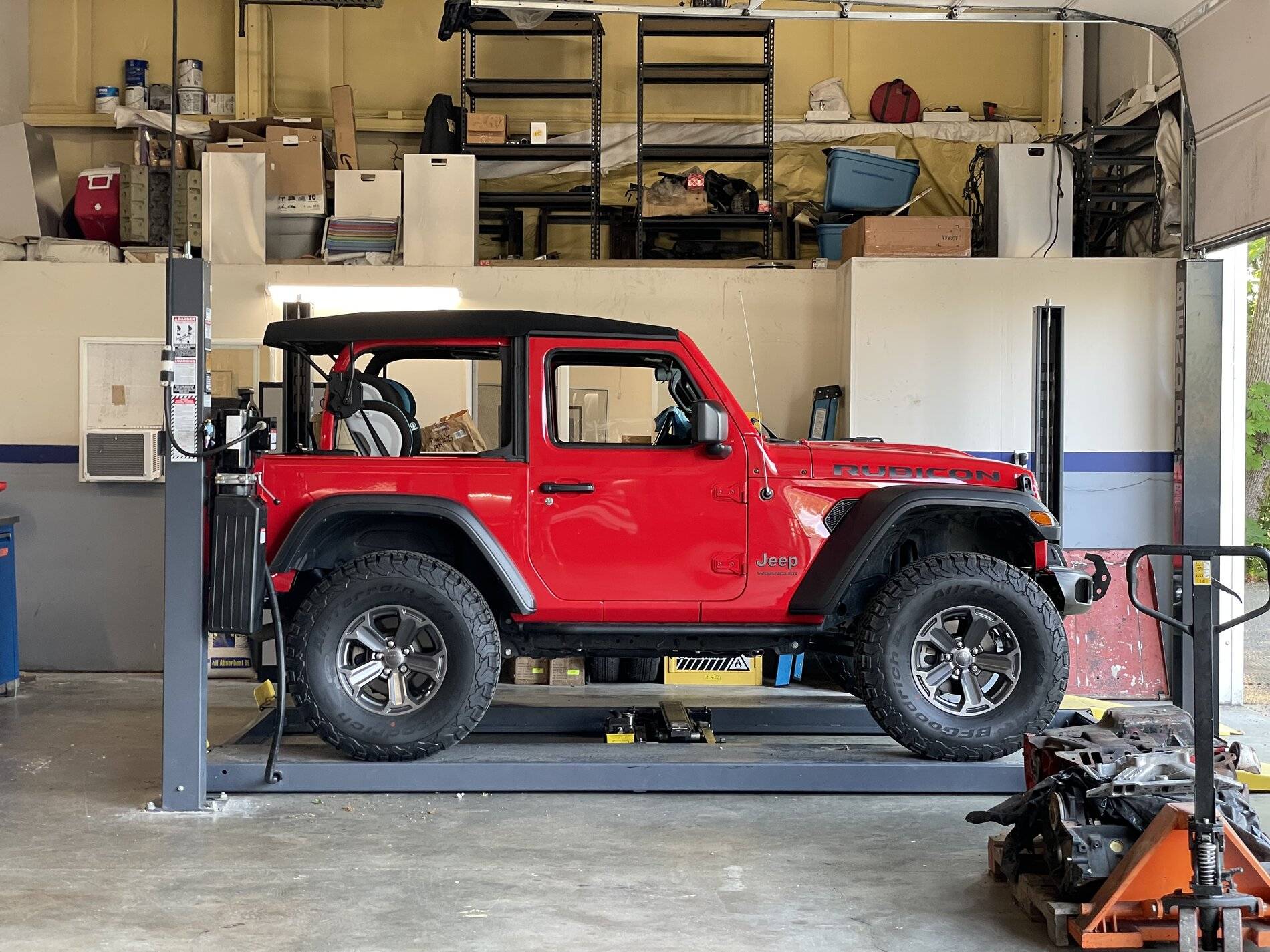

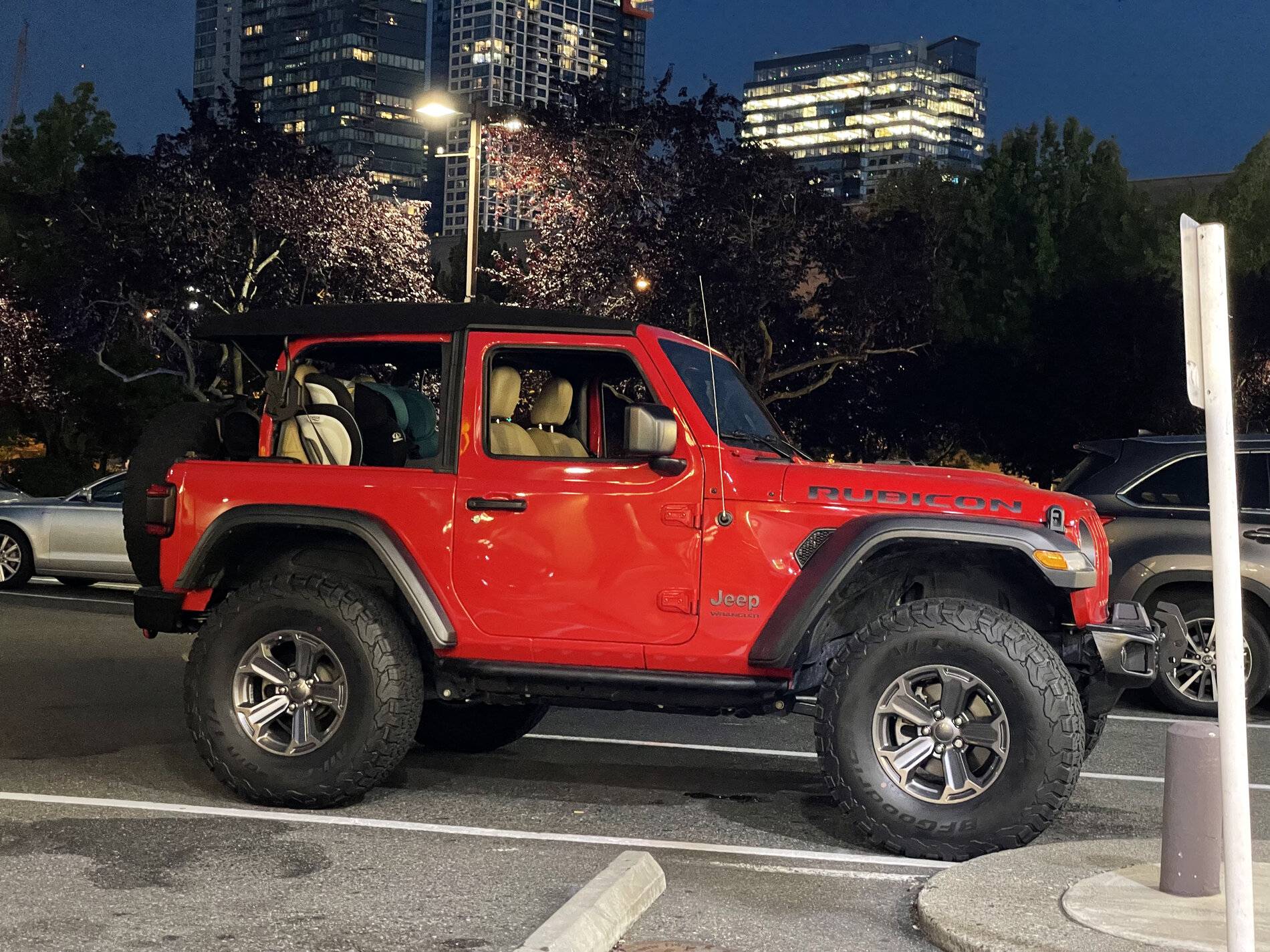

Just installed the AEV 2" spacer lift yesterday. Some pics to give an idea what these KO2 37s look like with a small lift.
It's one step up from the recently announced Xtreme Recon factory package (35s and 1.5" lift). Honestly would have been a good chance for Jeep to leapfrog the Bronco by offering there choice of 35s or 37s.

looks amazing
I'm unfortunately stuck waiting now.....all 37 tires are back-ordered or price gouged right now (tire rack has the d-rated for close to $600 a tire)......apparently there is a big tire/rubber shortage

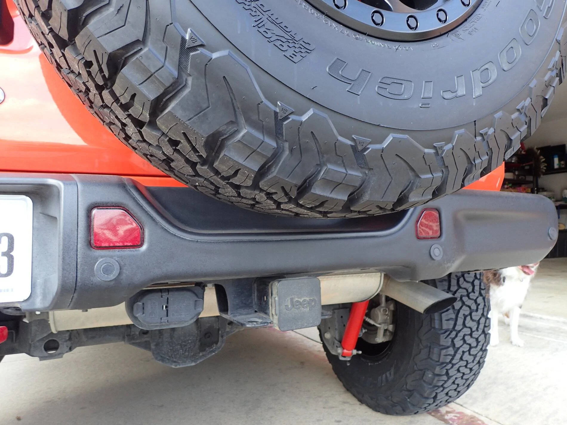

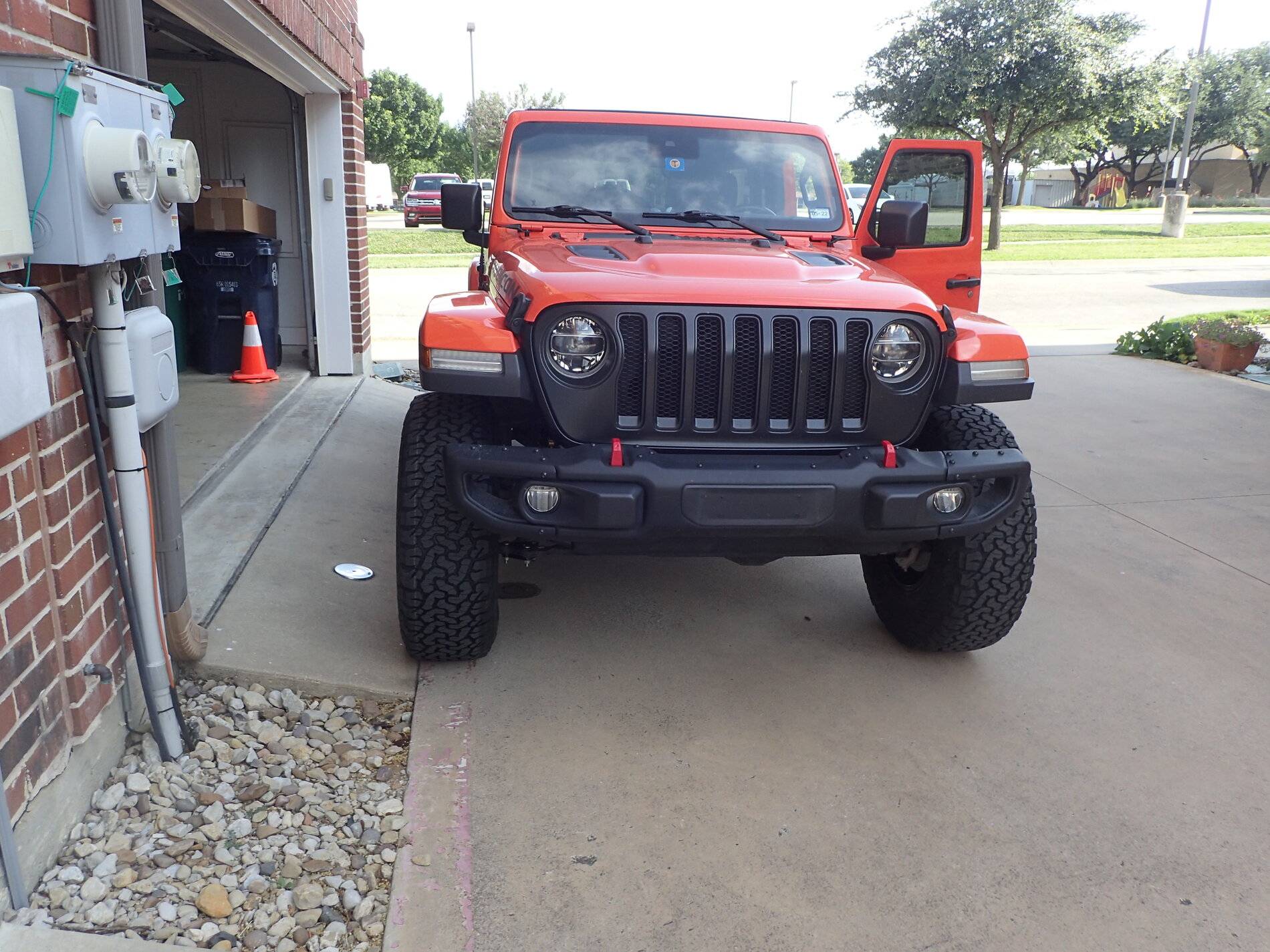

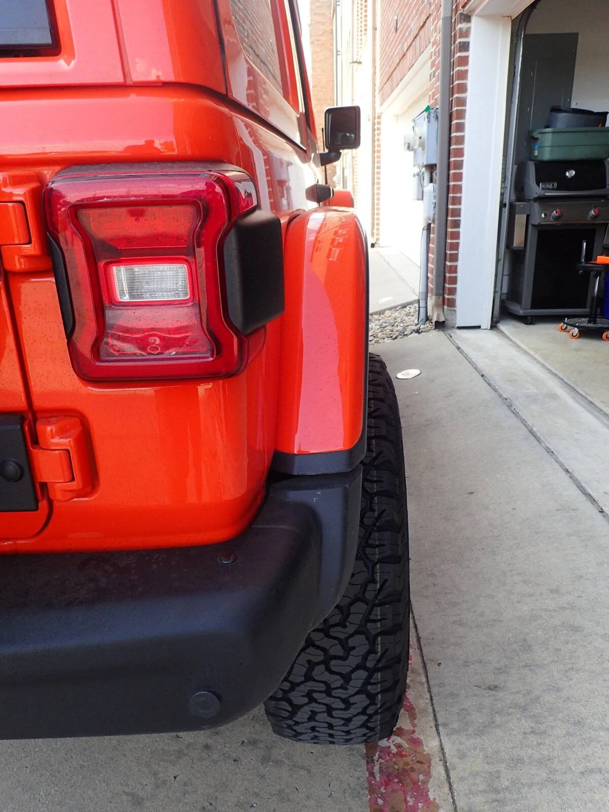

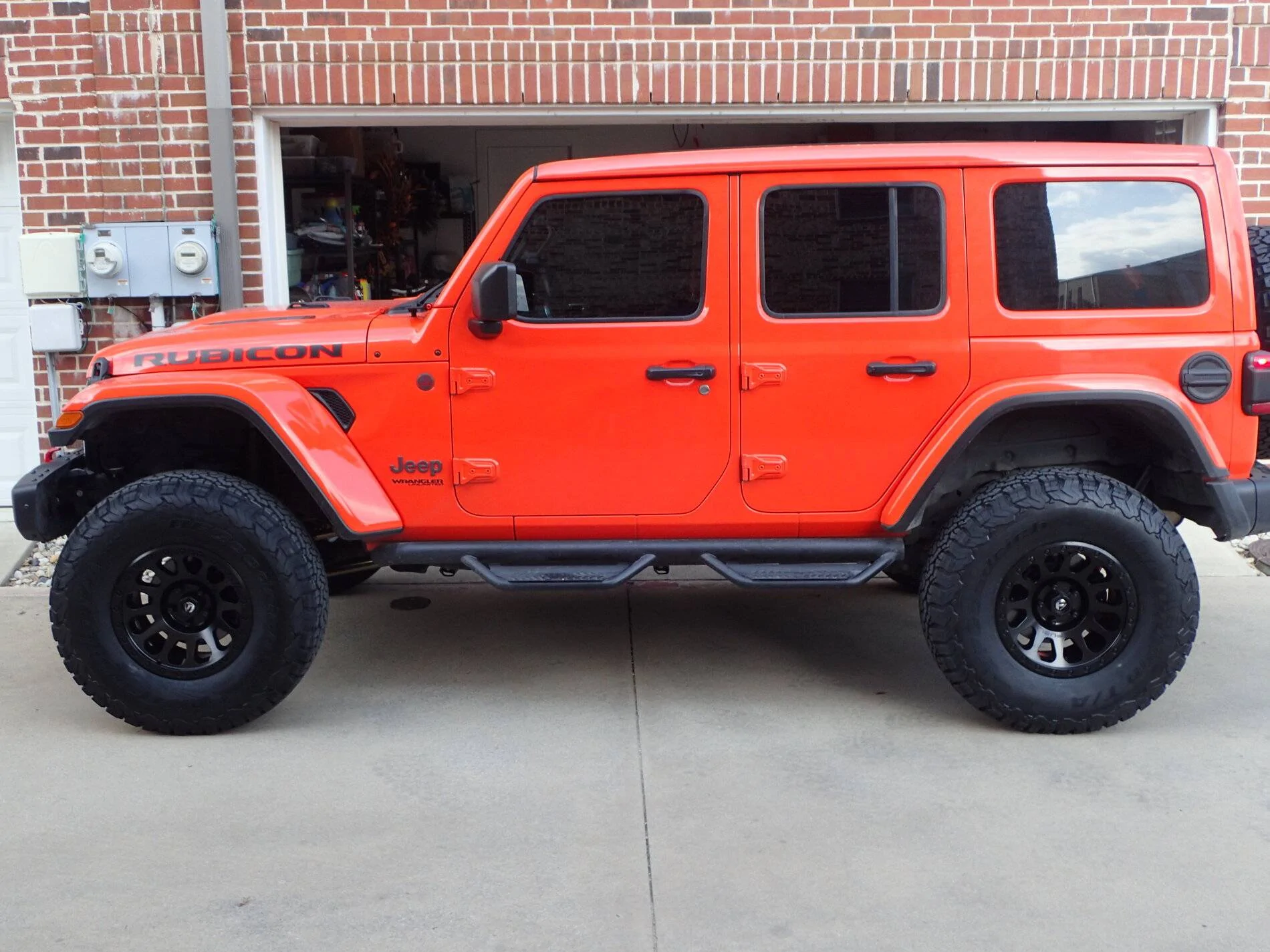

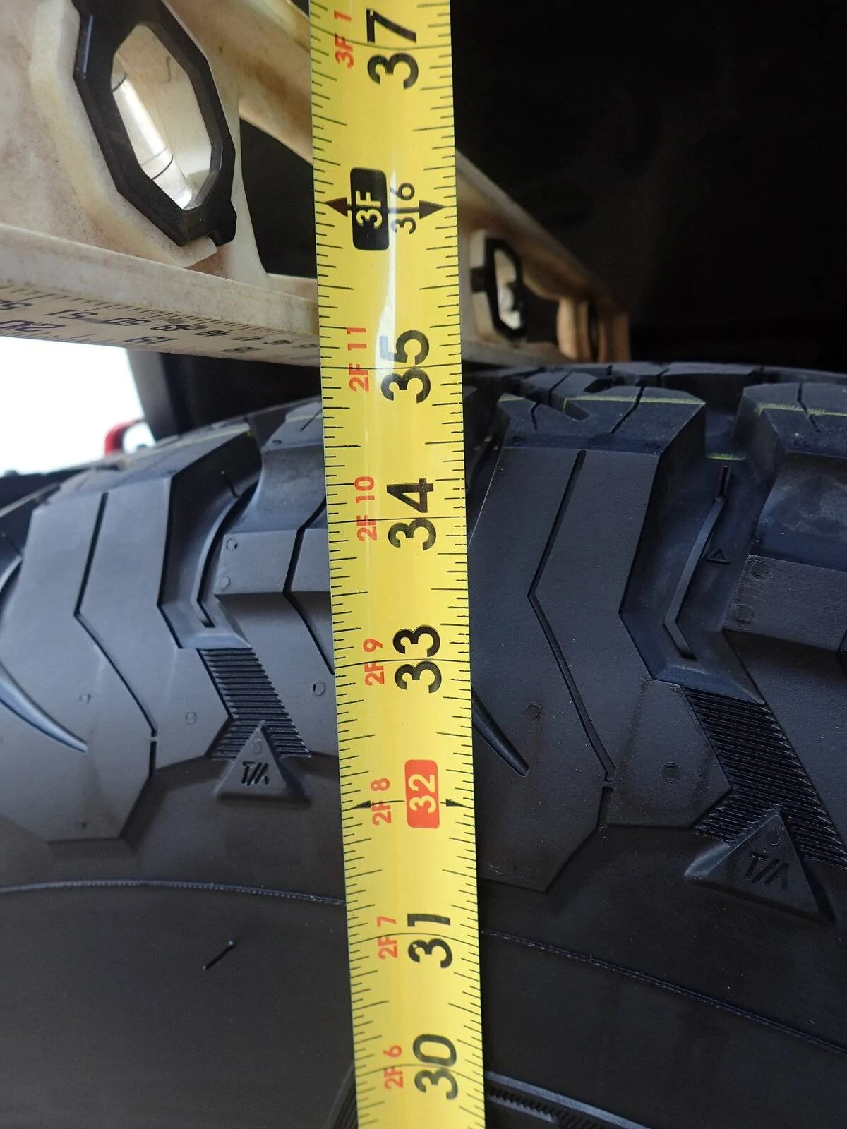

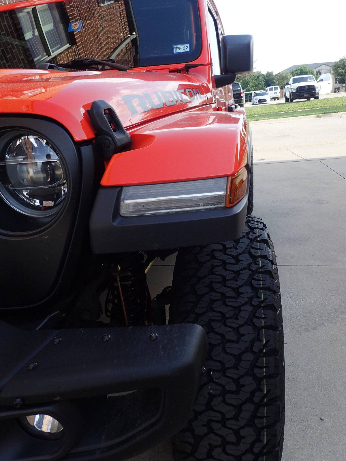

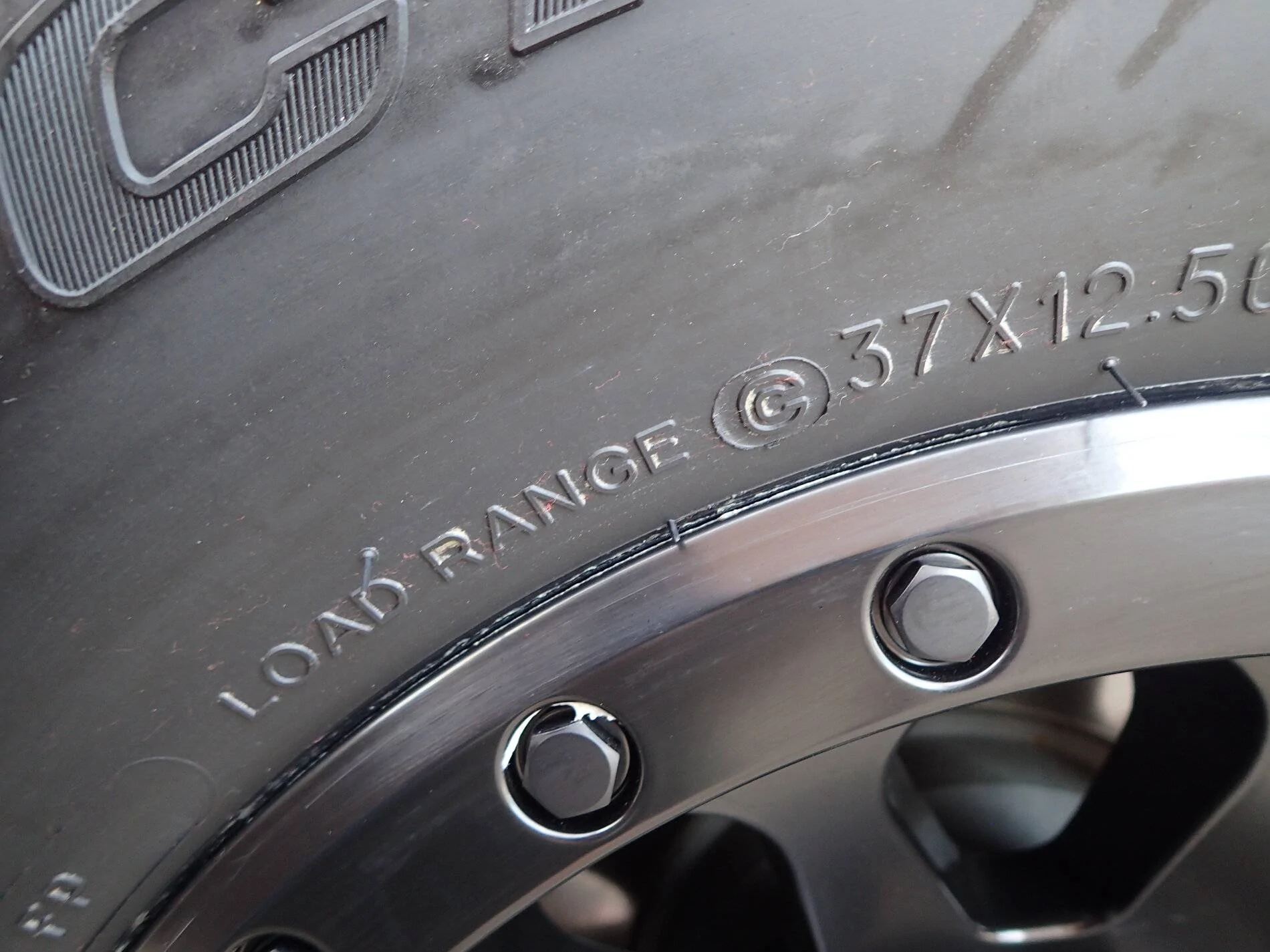

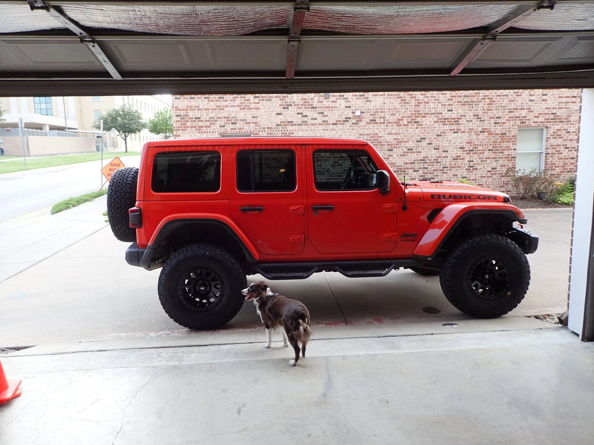

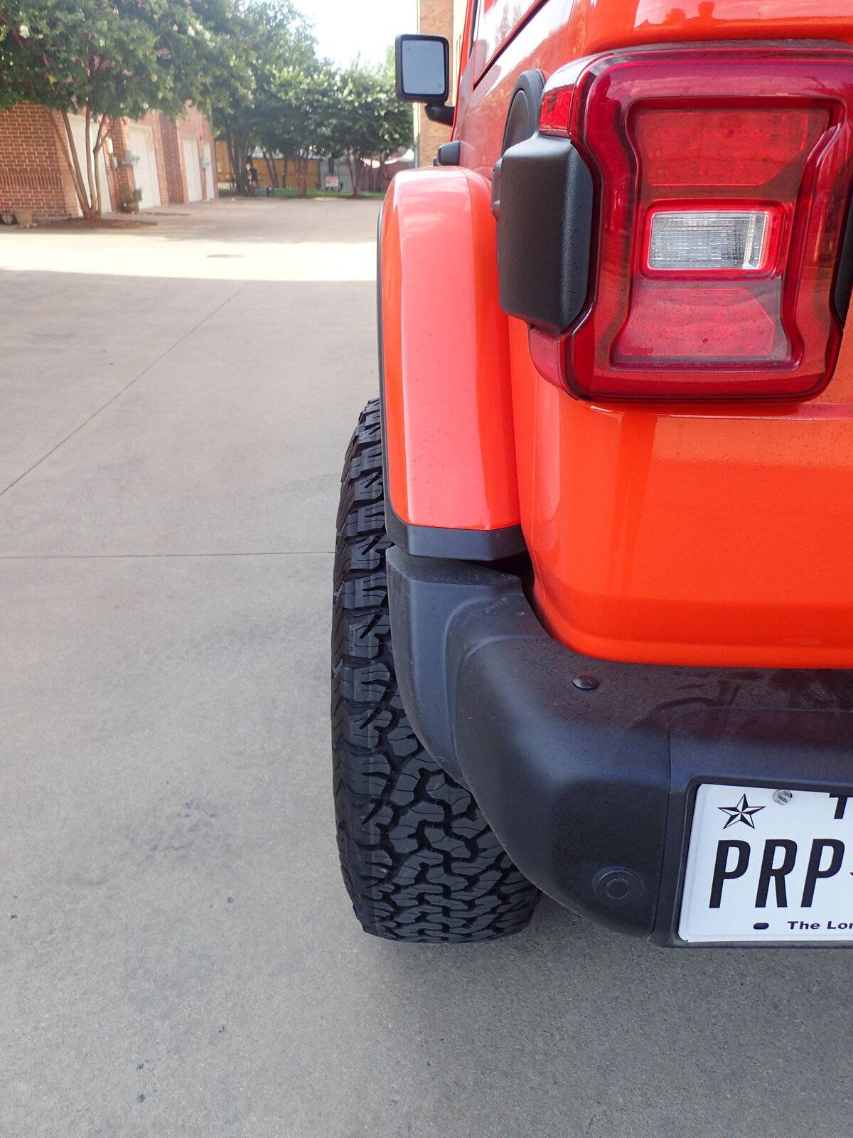

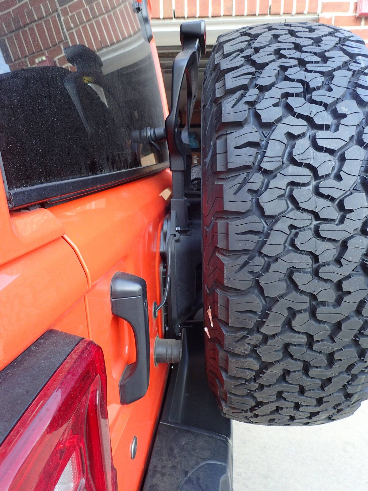

FInally have them mounted on a lifted Jeep. I am running them at 32 PSI and to be honest, they drive just like the stockers. As you can see, I barely got 35 1/4 mounted on 17x9 wheels. I used a level on top to make sure I was measuring square off the tallest point of the tire. I mounted the spare on a quadratec spare relocation kit which moved the spare a few inches up. It was cheap so I figured I would give it a try. I do need longer rubber stops though. Hit me up if you have any questions.

jlang what lift do you have? And what’s your wheel offset? Think these would be ok to run on a Rubicon with aftermarket wheels (4.5 backspacing, -12 offset) WITHOUT a lift? Just temporarily until I figure out what lift to go with…

Metalcloak True Dual 2.5 lift. Fuel Vector wheel offset is -12 with 4.53 BS. These absolutely will fit on a Rubicon without a lift with minor rubbing if any as a temp solution. Check out this video of a dude running a slightly larger Nitto with no lift:

These definitely look smaller than other 37‘s but I still think they’re going to be the right fit for my 392. Thanks for posting pictures.

Thanks for the video! He has 37” Trail Grapplers, so these KO2s will definitely be ok without a lift for a while. My Vision wheels have the same specs as your Vectors, so your setup shows me exactly how much “poke” I’ll have. Thanks so much!
