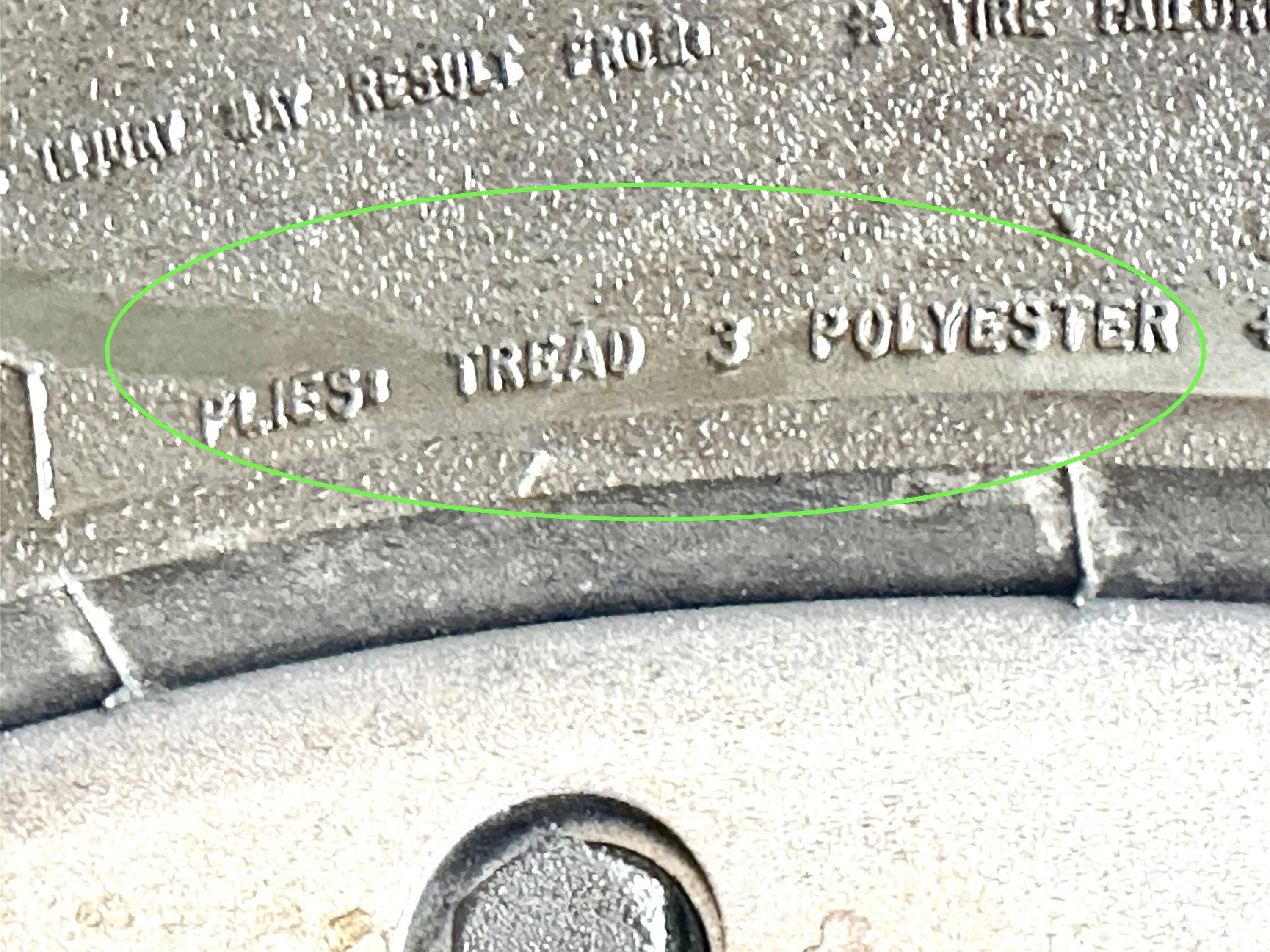

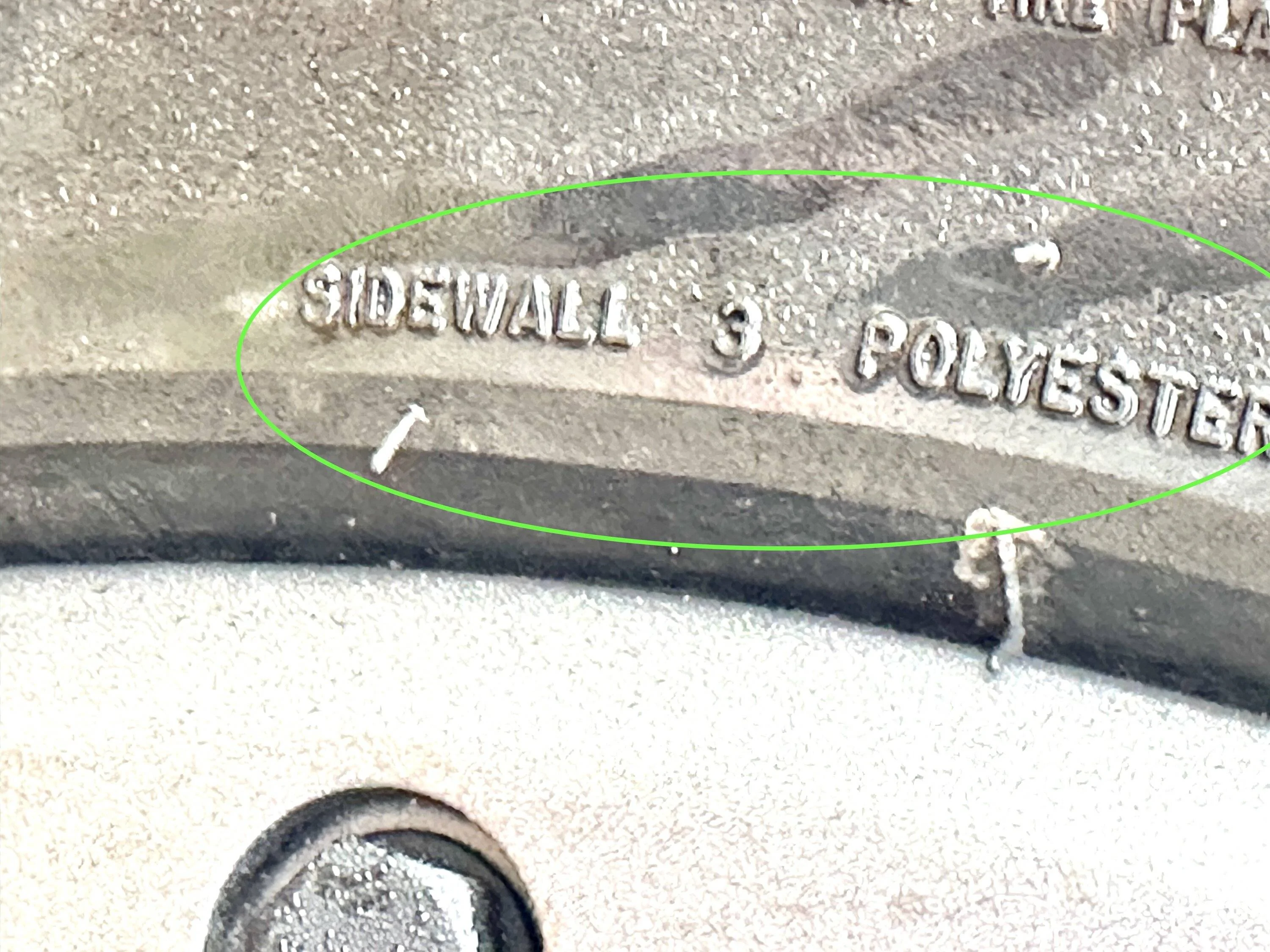

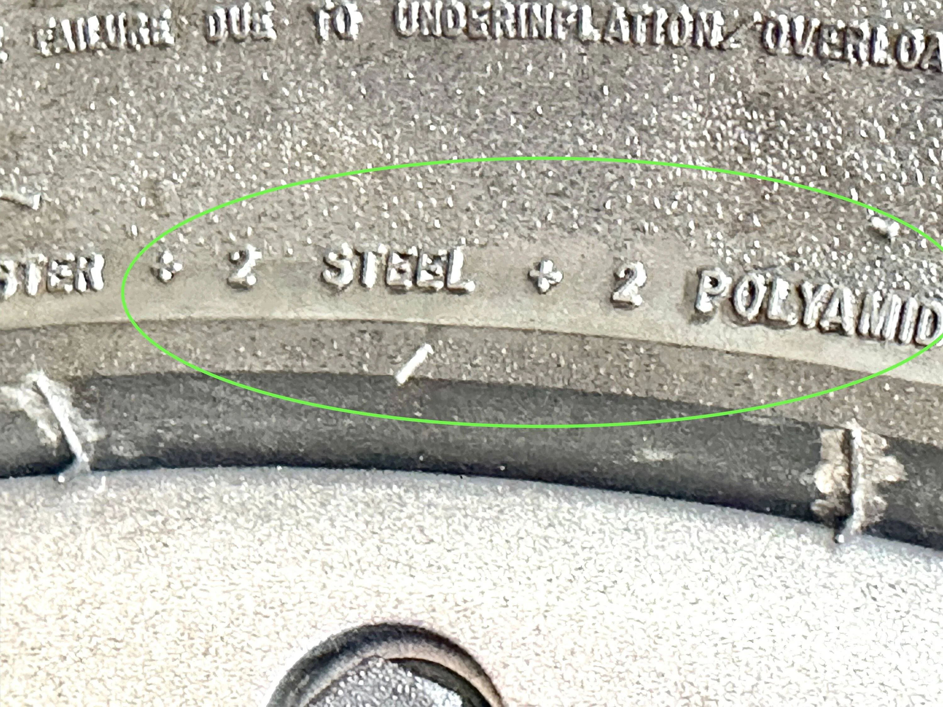

Post a pic of the sidewalls that say 8 ply tread and 6 ply sidewalls. I have never seen a Duratrac that has that many true layers, most I've seen is 3 ply sidewall. The only tires that have that many layers are bias ply tires. There isn't a radial tire out there that I know of that has more than 3 plies in the sidewall.
YOU are correct and I stand corrected.
3 things, I did not have on my glasses and my tire was dirty and finally, the print was so small I could make it out so I guessed at, I apologize for my oversight.
Here are max magnified pics for your viewing.
Jeep Wrangler JL KM3 37x12.5 Load Range C! IMG_5905
Jeep Wrangler JL KM3 37x12.5 Load Range C! IMG_5906
Jeep Wrangler JL KM3 37x12.5 Load Range C! IMG_5907
