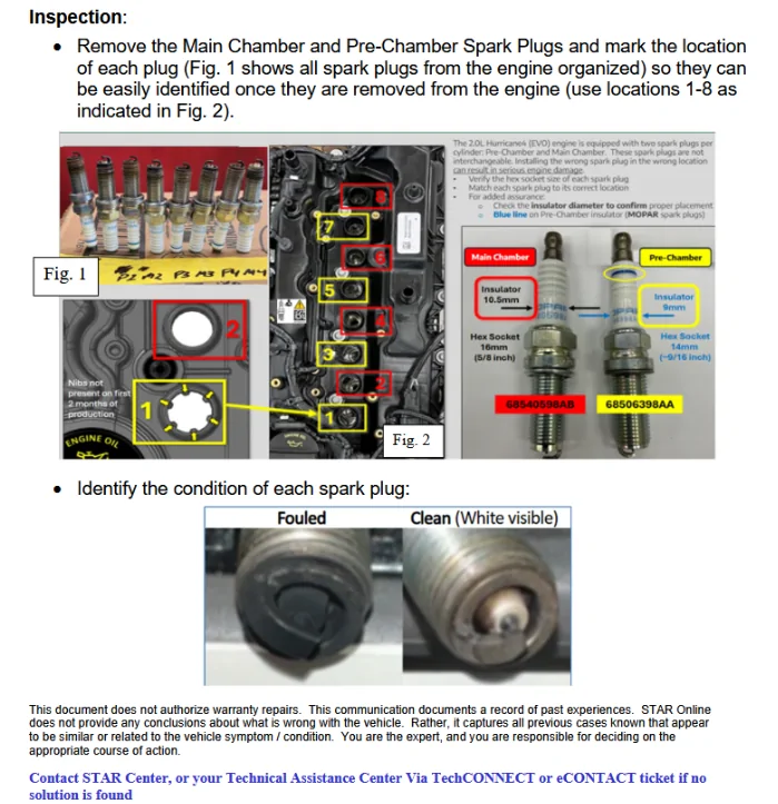

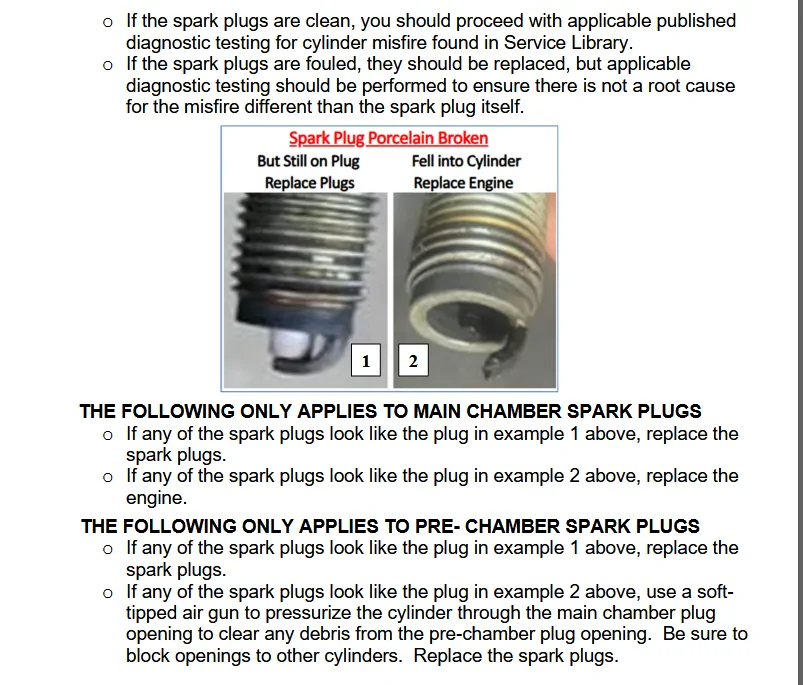

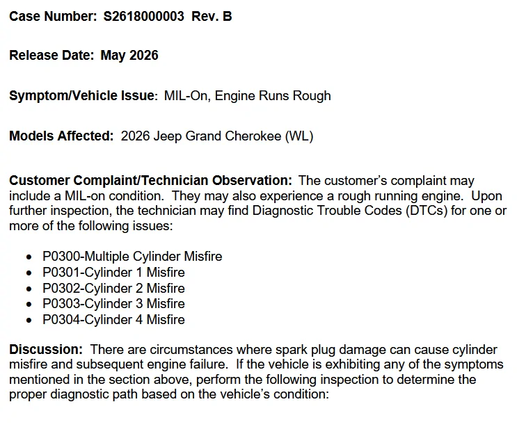

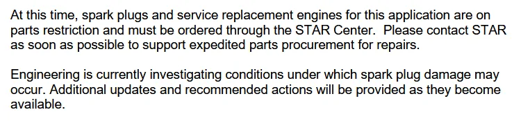

Well, the engine has been in the field for a few months now and we've already got a bulletin about destroyed plugs. I wonder if some are getting installed incorrectly at the factory, lmfao.
Jeep Wrangler JL New Jeep 2.0T Hurricane 4 has complex tech [Engineering Explained] 1779511844631-zm
Holy shit. I wonder if those on this thread that insisted it wasn't really an issue will pipe up.

8 spark plugs, two different types, and if you stick them in the wrong hole it destroys the engine
