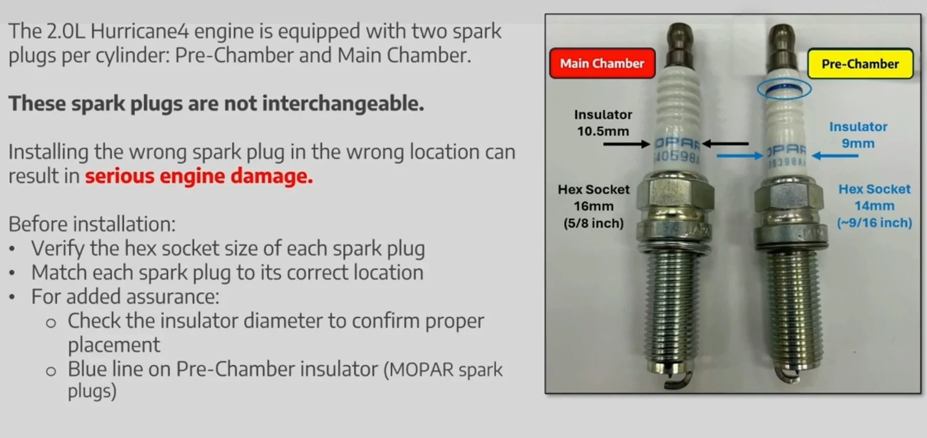

8 spark plugs, two different types, and if you stick them in the wrong hold it destroys the engine
Probably won’t fit, different size hex and socket for pre and main chamber.

If that was the case, they wouldn't need to put this in giant red warning text:
They do it for people that don’t pay attention to what they’re doing.
Is it really that hard to follow the instructions?
The engineers did everything except the one simple thing that should have been done: a different thread pitch for each plug.
