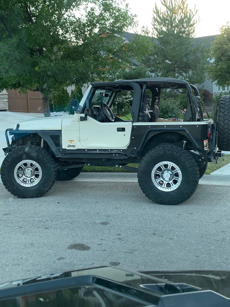

I have an X, it already has most everything you would need. The only upgrade I am doing is better shocks. the 35" tires, for me, are perfect.
You must have the 4 door as it comes with 35’s, the 2 door I ordered comes with 33’s. I spent my day going to tire shops. Schwab, Frontier, Big O and Discount. All basically gave me the same information, except Schwab definitely sounded much more knowledgeable. In essence Schwab told me I can easily swap out for 35’s and use the upgraded wheels I unfortunately ordered. He recommended a 3” spring lift. Without the lift, with substantial articulation, the 35 will destroy something, I forgot what. He said the width of the tire (I assumed all 35’s are the same width), will determine the turning radius of the wrangler. The Schwab guy told me with a high quality tire and spring lift, “it should ride very close to stock.” He recommended A/T to reduce tire noise.
Because I am also concerned about wide tires throwing rocks and chipping the paint, he told me Schwab can either install fender extensions, or modify the fenders so that issue becomes moot.
I also learned Schwab can install bumpers and complete “most” exterior modifications. Everything Schwab does is under warranty. I thought Schwab only did tires and wheels!
I was notified today my Wrangler is in production que, so I have some time to decide, but after today, I am leaning toward 35’s and probably different wheels. Sadly I blew a grand on the attached.

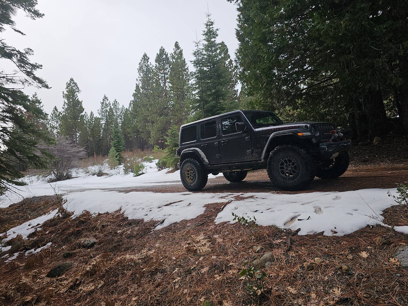

No need to regear for 35s, especially in a Rubicon for rock crawling. The 4-1 low range is plenty coupled with the 4.7-1 first gear of our awesome 8 speed auto. The combined 77-1 crawl ratio is more than enough grunt even in 38s in my experience. I wouldn't listen to les Schwab when it comes to Jeeps. Odds are they don't know the difference between a JK sport and a JL Rubicon. You won't need a lift for 35s either.
COMBAT DOG
Jul 17, 2024
63
56
Idaho
2021 Raptor 37 2023 F150 Lariat Polaris Ranger XP
im Getting a two door, does the same apply to both 2 and 4 doors? For clarification he said I made need a lift so it doesn’t rub during extreme left and right turns.
Zandcwhite
Zach
Sep 4, 2019
8,290
14,179
Patterson, ca
2019 jlur
The 2dr has lightly more clearance in the rear fenders as far as I understand. You should be fine. You definitely won't need 3". The XR package in the 4 doors is only 1.5" taller and comes with 35s. Our 2019 JLUR cleared 37s no problem with 2" of lift and our 2022 clears 39s with 3.5" The JL tire clearance is massive compared to all previous generations.

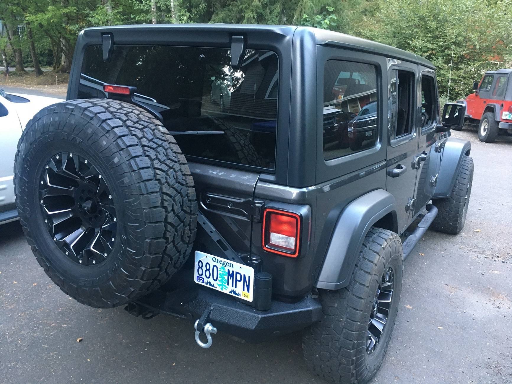

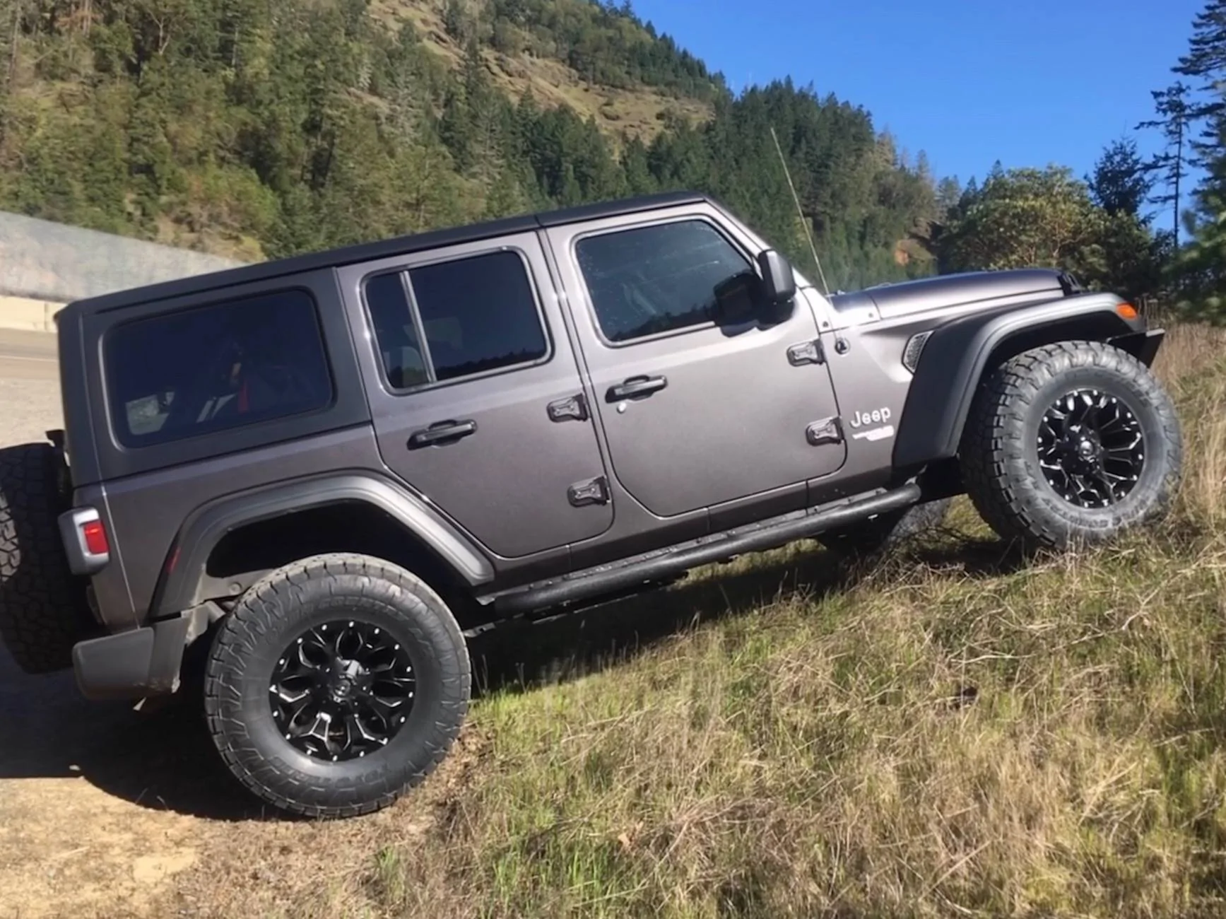

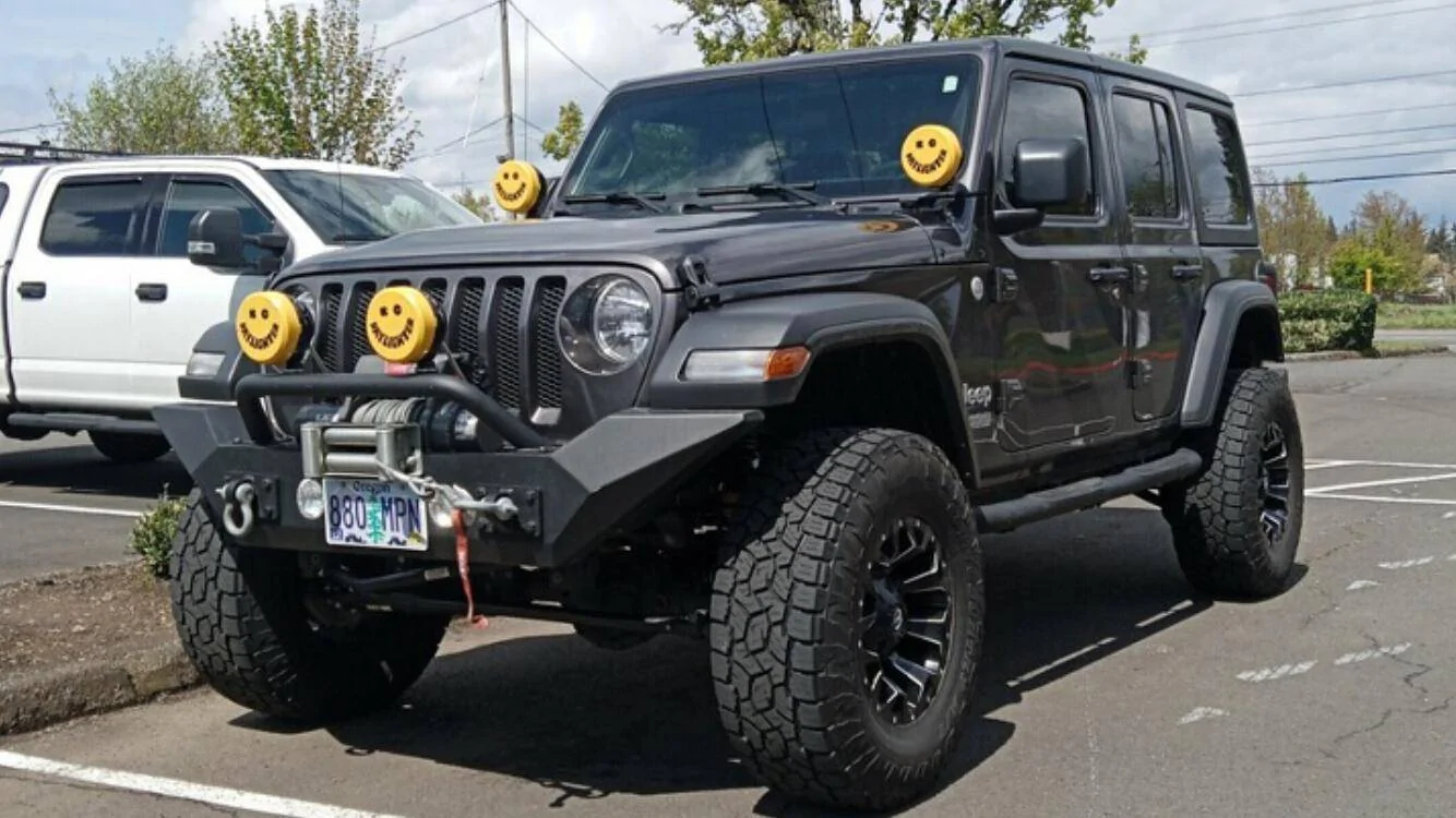

How in the world did you learn this stuff??? To put it in perspective, in my world “assembly required” are the two worst words in the English language.
Don’t feel bad Combat Dog, I’m not a mechanic either, I understand a LITTLE bit more than you do, but I don’t have the mechanical skills, inclination or Patience to do much wrench twisting on the Jeep or the Boats. I did the simple bolt on stuff, Bumpers, winch, nerf bars( I guess they call them “Rock Sliders” now and lights, but I had the lift done by a shop.
I’m not too fR behind you age wise, I will be 59 in about a month
Jeep Wrangler JL NEW GUY SEEKS ADVICE IMG_2834
Jeep Wrangler JL NEW GUY SEEKS ADVICE IMG_2232
Jeep Wrangler JL NEW GUY SEEKS ADVICE IMG_1509
Jeep Wrangler JL NEW GUY SEEKS ADVICE IMG_2177
Yeah, I’m a Schwab fan too, to a point, pretty much just Tires/Wheels, I don’t have them do much else, there’s usually better options for other things. Schwab isn’t always the cheapest on tires and wheels, but they are EVERYWHERE out west, and their Customer Service is second to None. They have gone Above and Beyond for me so many times over the last 40 years, that the tires that came off my wrangler, and are now on my Wife’s Expedition, are some of the few tires here that aren’t from Schwab, and with the Jeep, the Expedition, the F350, two boats, a tandem axle open utility trailer and the enclosed trailer, there’s a lot of tires parked at my house
