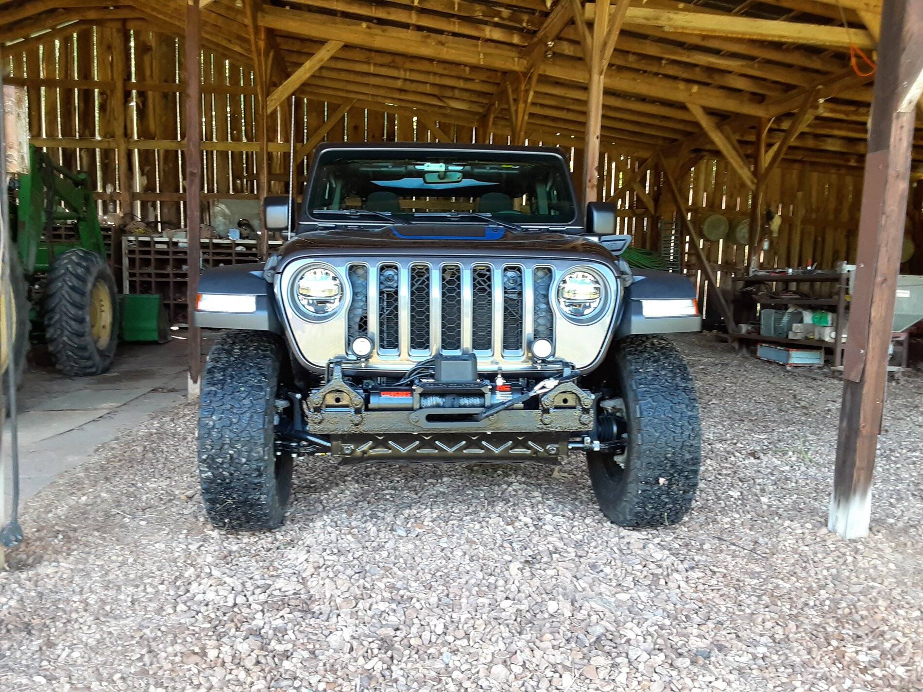

I put a winch in a plastic bumper on a JK. I bought a generic winch plate from harbor freight and welded it in. Then I spaced the roller fairlead out with 1” black iron pipe. It took me two days with a welder, torch, and porta band. It turned out great and was strong too. The best part was that I didn’t have a heavy bumper. Fun project.

Bumper I wanted was on backorder. Took less than an hour to remove the plastic bumper. Couple of afternoons welding some 3" angle, drilling a few holes and slapping on some bedliner for paint and I saved $500.
