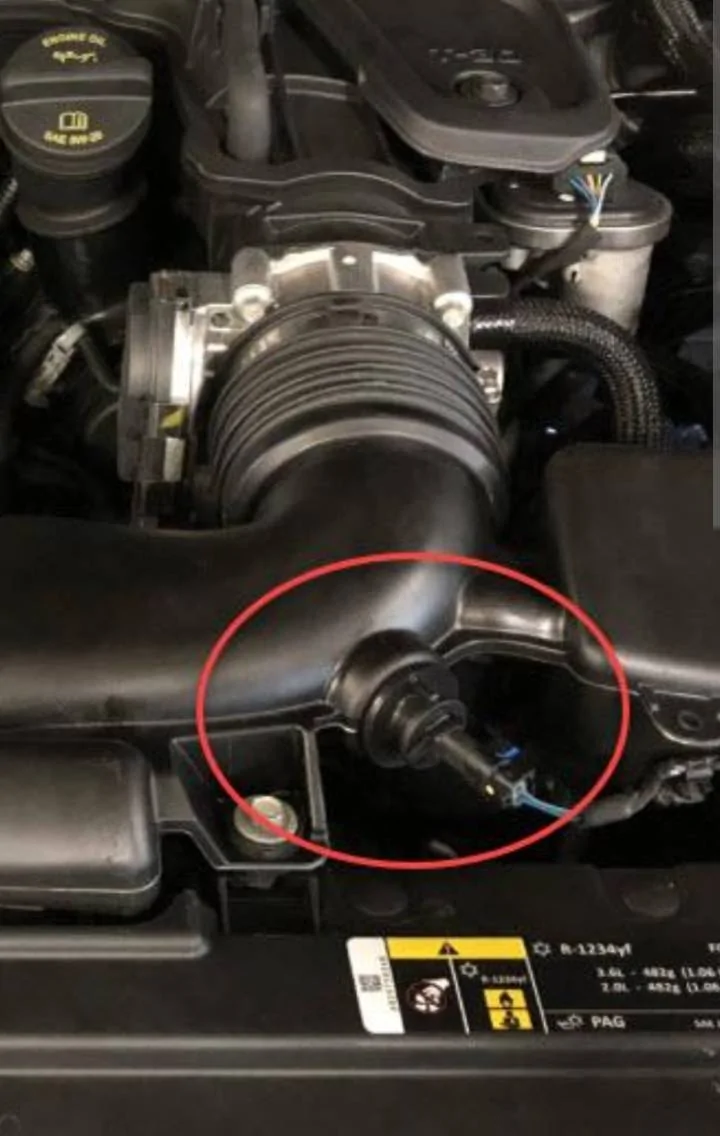

Unplug the ambient air temperature sensor. It's behind the grill, won't harm the vehicle's function but will throw a light.

To answer your question. You could unplug your Mass Air Flow Sensor. I'm pretty sure that will throw a check engine light. Not sure if it will do it right away, maybe cause the engine to stall, or run poorly. Of course, this is all done at your own risk. I've never heard of anyone causing engine damage by leaving it unplugged. People make this common mistake when they forget to plug it back in after an intake installation.

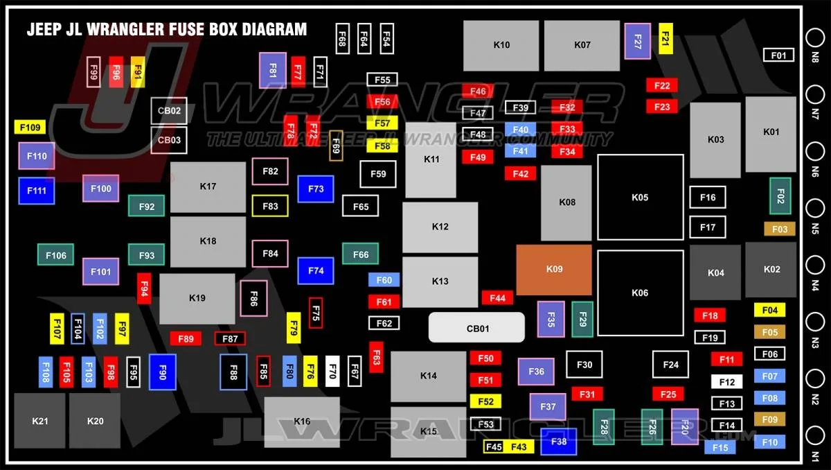

If you want to prevent them from starting the vehicle. You can see this fuse box diagram.
**I am not sure if this diagram is the same for an ECO-DIESEL**
F02 - Starter Relay. Will prevent them from cranking the engine over entirely.
F04 - Fuel Pump fuse. This will allow the engine to start normally until the fuel clears the lines. The engine will stall after a few seconds (maybe enough time to pull out of the garage). They can attempt to start it again, but it will just crank the engine over without being able to start it. Mimicking as if it was out of fuel.
(You can pull one or the other / or both)
*Again, do at your own risk.

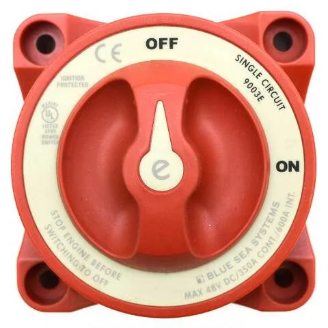

Install one of these blue sea switches. Kid will think it has a dead battery.
