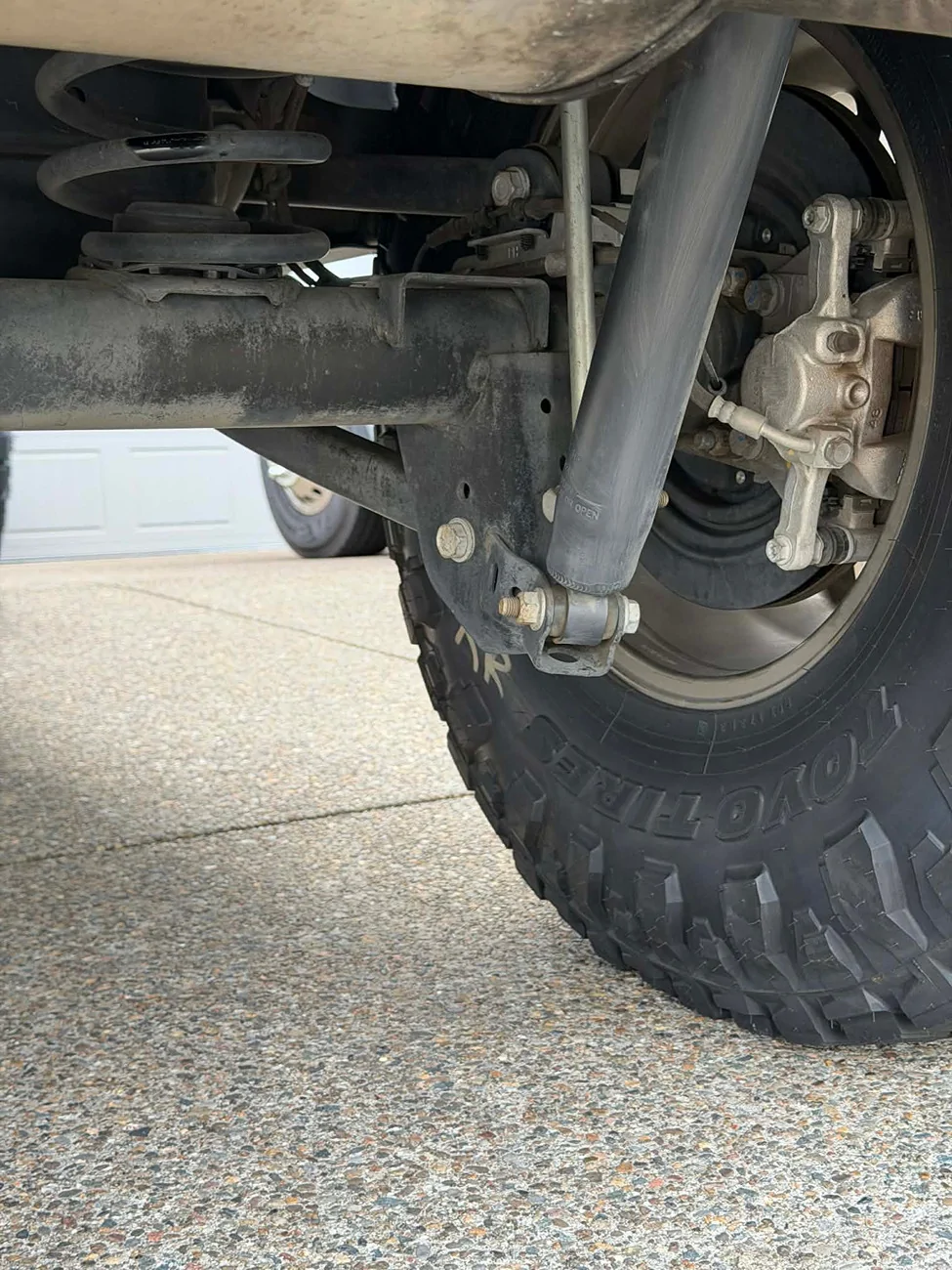

I was able to track down the previous owner, and he confirmed that it is a 2" Mopar lift he had installed @ 500 miles.

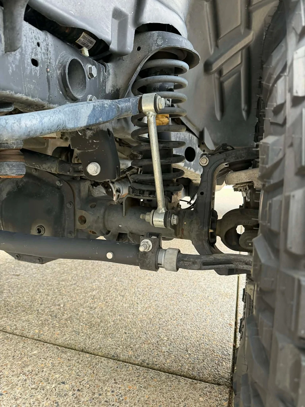

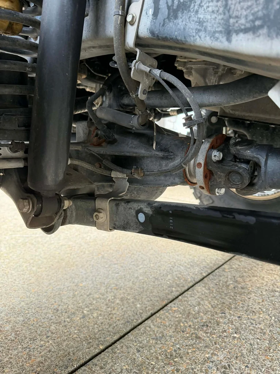

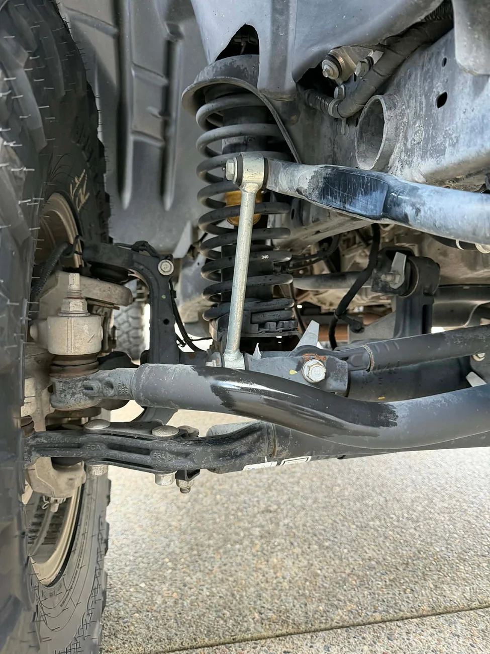

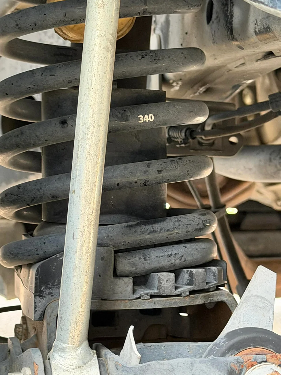

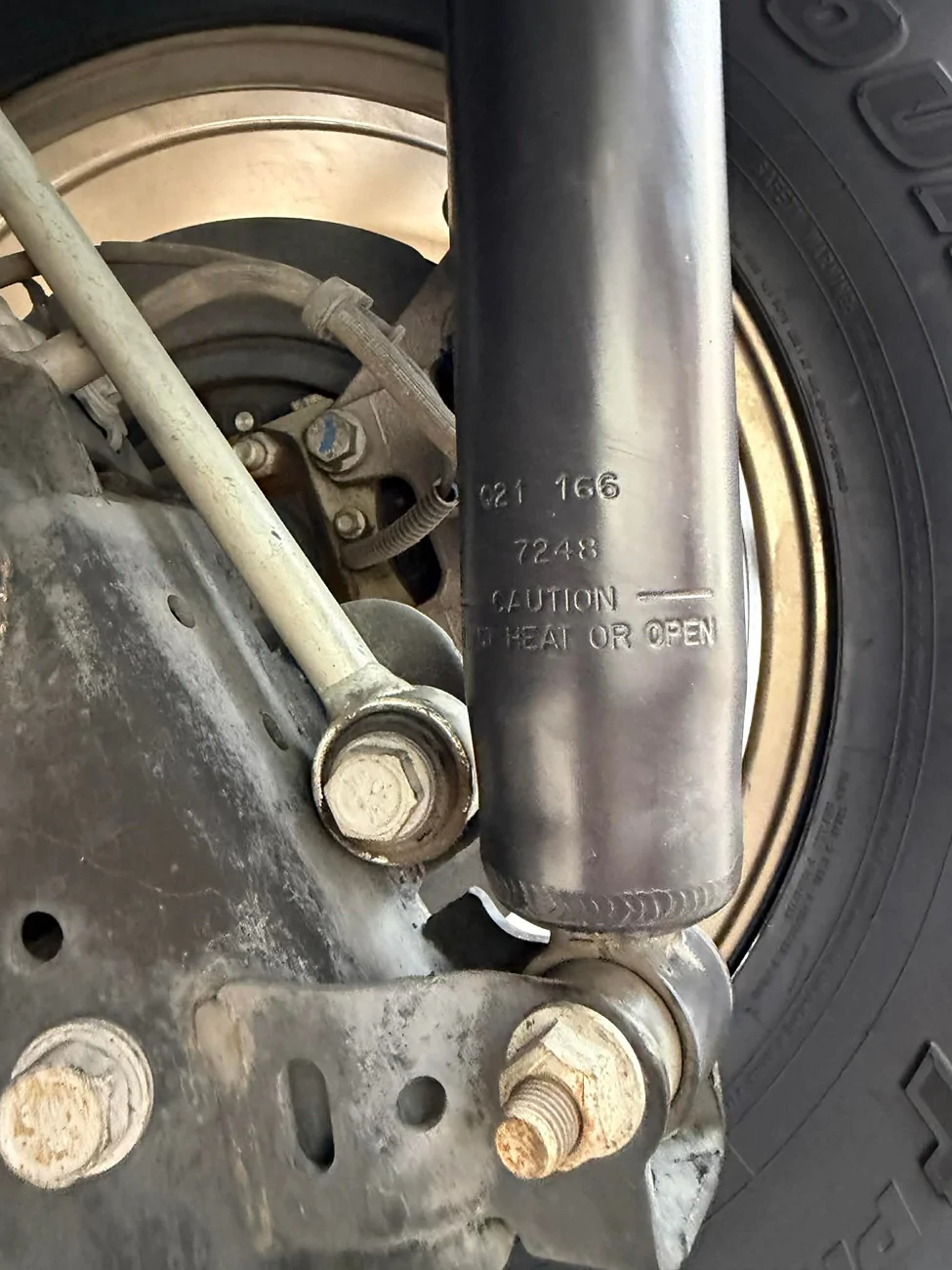

Here are some better pictures
Jeep Wrangler JL Need help identyfing lift! 1764780518584-g8
Jeep Wrangler JL Need help identyfing lift! 1764780407590-7j
Jeep Wrangler JL Need help identyfing lift! 1764780425612-0
Jeep Wrangler JL Need help identyfing lift! 1764780396981-ss
Jeep Wrangler JL Need help identyfing lift! 1764780385532-b8
Jeep Wrangler JL Need help identyfing lift! 1764780375841-4l

if you look at his alignment numbers they are great so my guess is those may be mopar lower control arms....he still needs to say what measurement he got from the diagram listed above but as far as numbers it should drive good

He replied, original owner says it is the Mopar lift.
The spring numbers clued me in, especially since we couldn't actually see a spacer. But the shocks threw me off. EDIT: After seeing the pictures of the spring number markings, that isn't Mopar.
He is missing the rear bump stop extension pad from the Mopar kit.
He also has too much front bump.
Maybe those are cheap replacement shocks? I believe that kit would have come with silver Fox shocks.
EDIT:
I still don't think that is the Mopar lift kit.

The front has wayyyyyy too much bump stop and the rear has zero additional.
He replied, it is the Mopar lift.
I am stumped to be honest. I did see those markings on some BDC coils in my search.
I'm a total noob at this stuff, so please bear with me... LOL
Is the thing safe to drive at least? It drives pretty nice and there are no loud thuds/noices for the most part... One particiular spot in a road here makes it clunk like a seam in the road... kinda of weird. But nothing major

Drive the crap out of it, the alignment sheet shows pretty good numbers, and the thud/clunk you’re hearing is probably the front bump stops hitting, you could probably get away with an inch less maybe a bit more…… But if it drives sweet, don’t worry over it, and enjoy it….

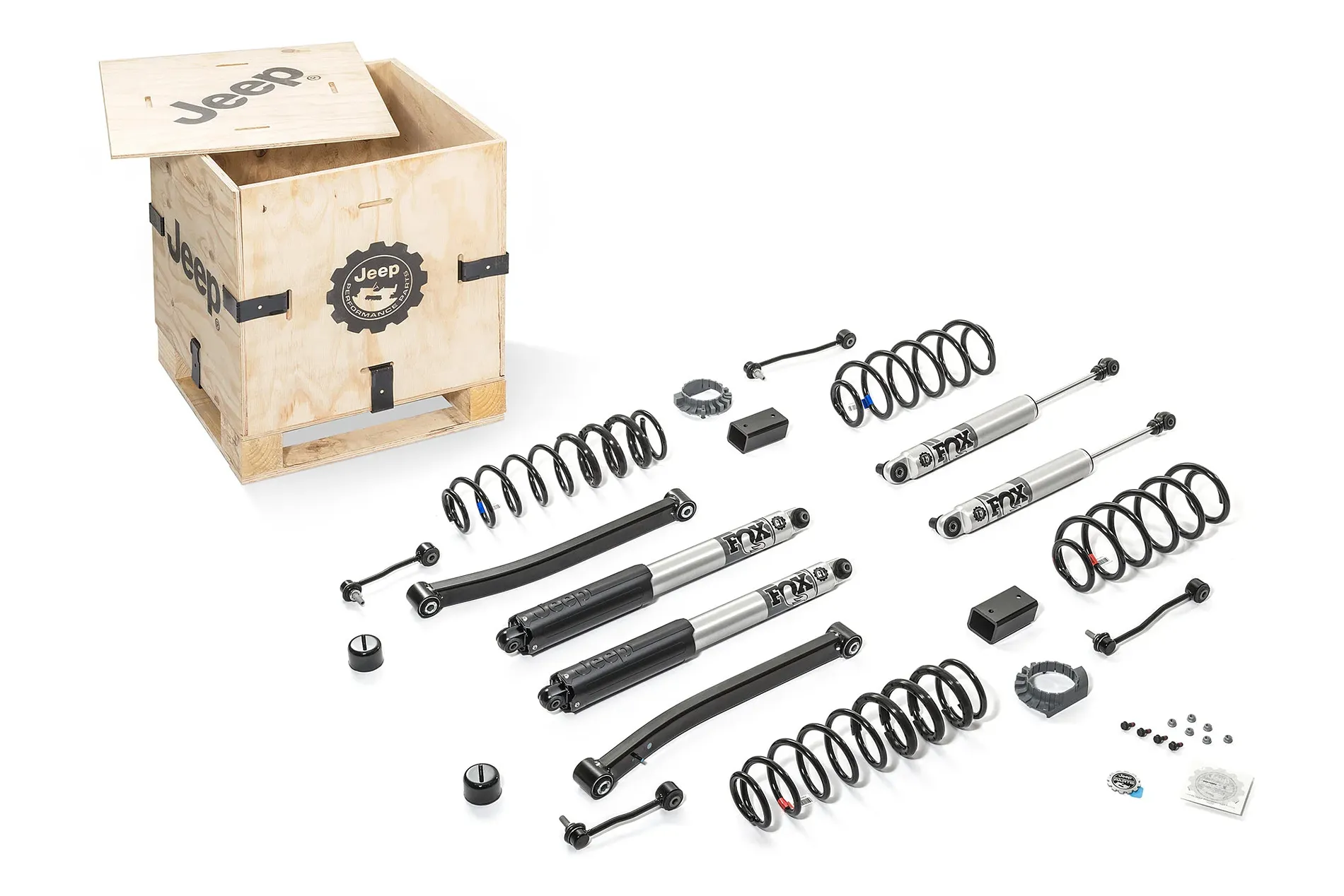

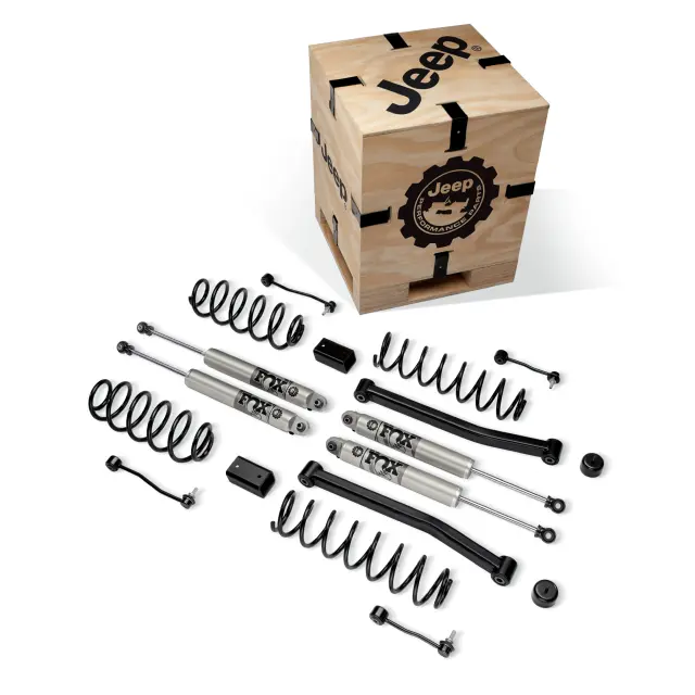

Jeep Wrangler JL Need help identyfing lift! e9d41c2dc2c635b4afd1981be7b67cf
Jeep Wrangler JL Need help identyfing lift! Mopar_Lift_Kit_Jeep_Wrangler_JL_2
Jeep Wrangler JL Need help identyfing lift! Mopar_Lift_Kit_Jeep_Wrangler_JL_Layout
There have been multiple versions of the kit over the years, but generally this is how it looks.
I've seen silver sway bar end links before as well.
Bilstein Shocks are in the newest kits.
Aonarch
Mike Hawk
Oct 20, 2021
903
1,591
North GA / MT
'25 JLUR '41, '24 F-150 V8 4x4, '22 Mach 1 6MT
Motorsports Engineer
I am putting my money on that being a big dick suspension....some of the old guys will know bid dick suspensions dude put out some good designs back the day...now it turned to BDS but my guess is that is a BDS
Yeah those aren't Mopar sway bar end links.
The spring markings aren't OEM Mopar either.
I don't see the Mopar rear bump extension.
The front bump stop definitely isn't the Mopar one.
Shocks, no idea. Look cheap since they aren't even branded.
It is hard to tell, but I don't think that is the front Mopar lift spring isolator either.
The part number for the Mopar lift LCAs is 68322798AA .

ditto or just needs to take a torq wrench and tighten every bolt to spec....the numbers are good so would expect it to drive fine..in reality unless doing offroading the bumpstops are not going to hurt anything just limit up travel..hitting that speed bump at 60 might kiss it tho....
