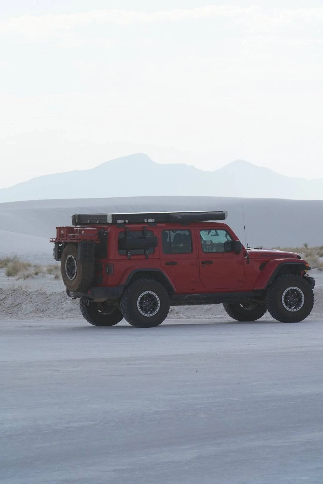

Metal cloak is just springs to change between 2.5" and 3.5" lifts. I had the Dynatrac Endurosport 2" on my last rig and it's a fantastic budget kit as well. I believe you should be good with sport or rubi axles. IMO 2.5" looks right with 35" tires, 3.5" is a little tall unless you are going to load it down heavy (I just swapped 4.5" springs in the rear to compensate on mine, I'm very heavy though)
Metal cloak is a great kit, I don't have experience with the others listed.

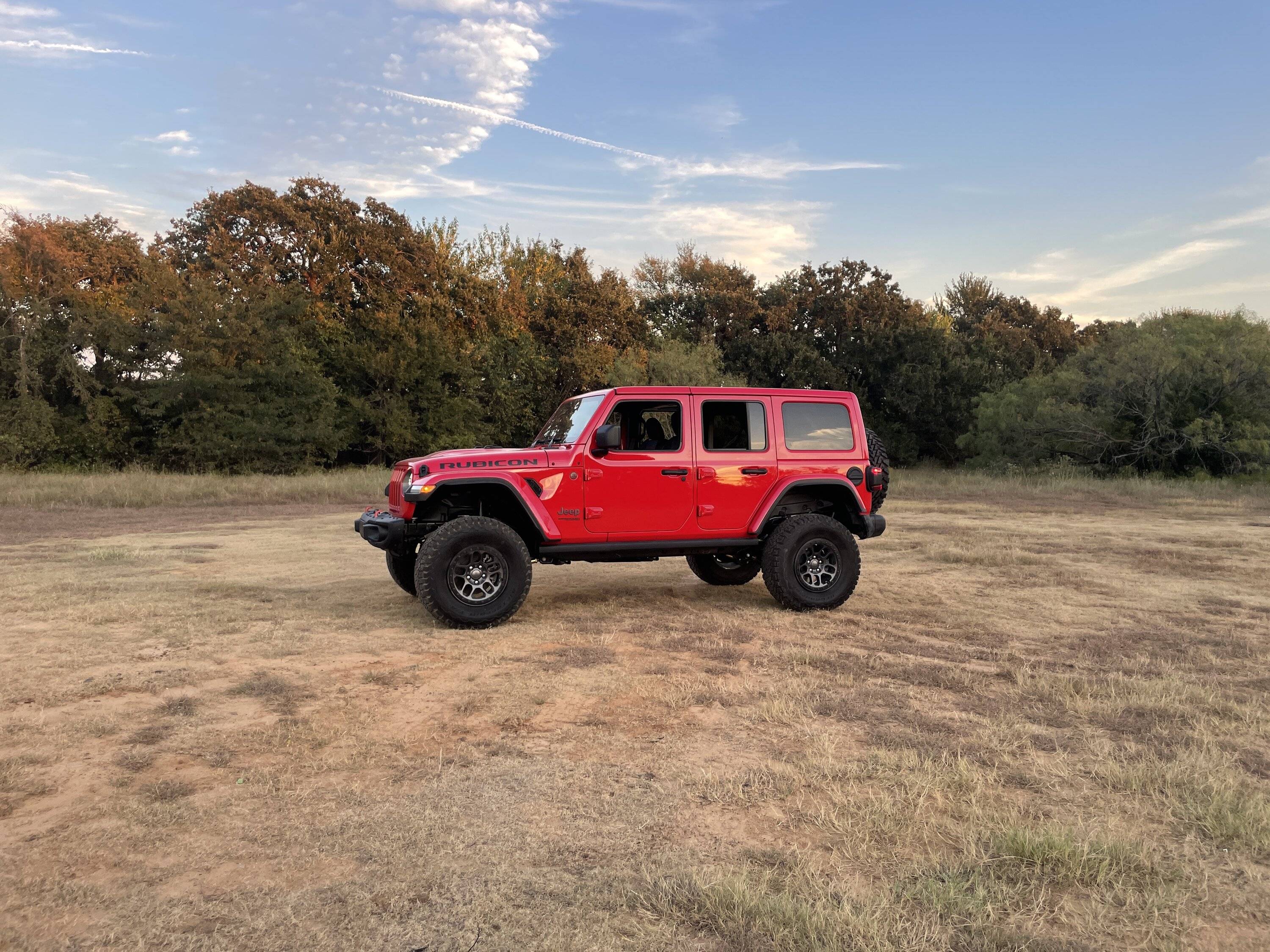

Current rig on 37" Yokos and 3.5" MC GC lift
Note the squat on 3.5" GC, this is why I popped 4.5" springs in to compensate, I'm very heavy though, you likely will not have this issue.

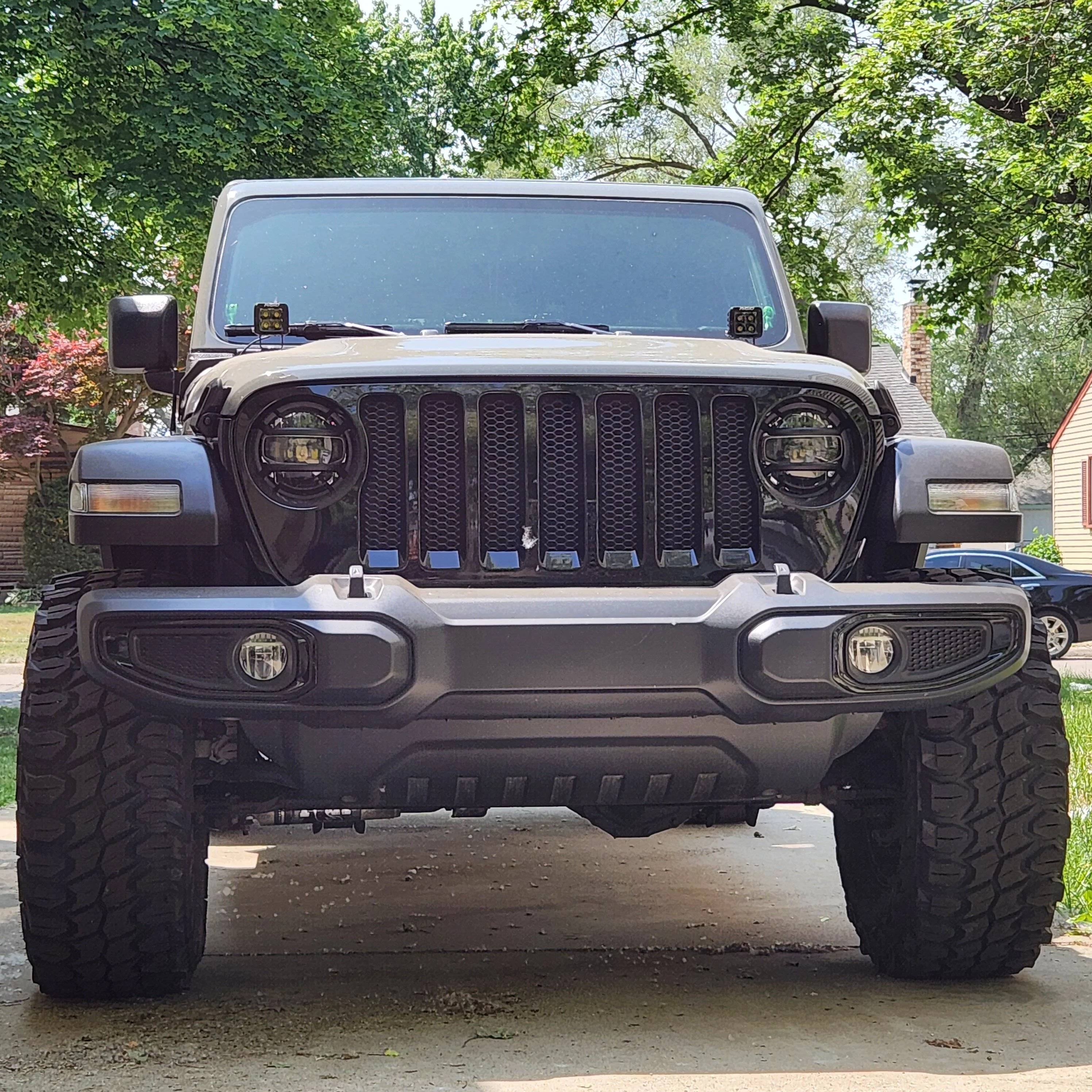

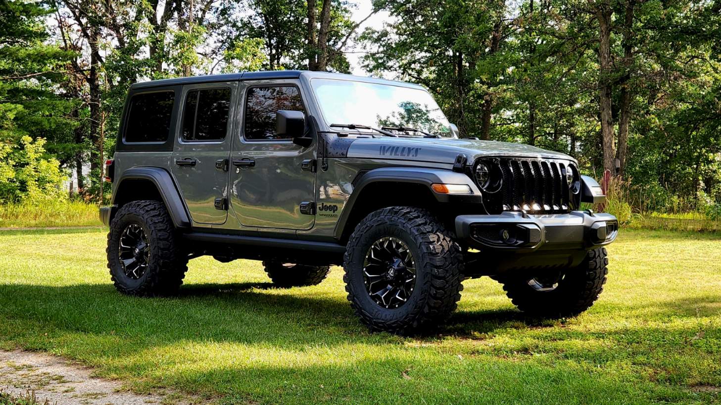

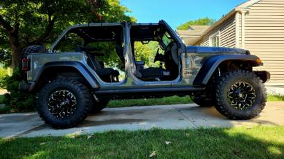

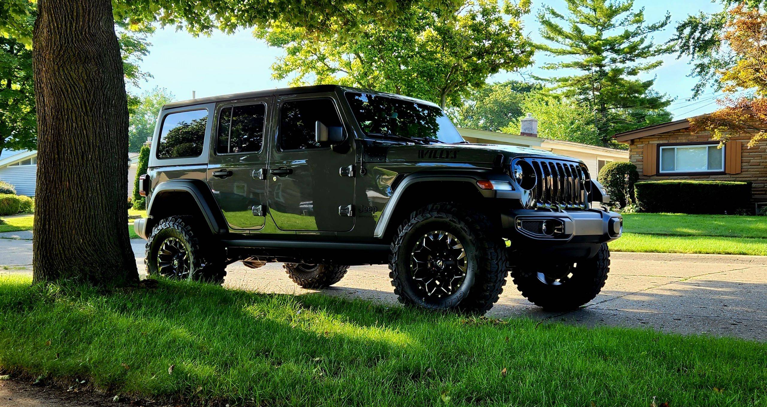

Just for reference.. I have a 3 inch zone lift.. upgraded to the fox performance series shocks.. I have 35 inch mud tires on fuel Assault wheels with -12 offset. This is how she sits.. She's also my daily

What’s the height measurement on that ?
About 20 1/4 inches to bottom of rock rail below front door hinges.. about 40 inches at the center of the front fender.. 60 3/4 inches from ground to top of mirror
Due to variations in tire diameter, pressure, etc. I recommend comparing lift height either shock eye to eye or spring perch to bucket.
