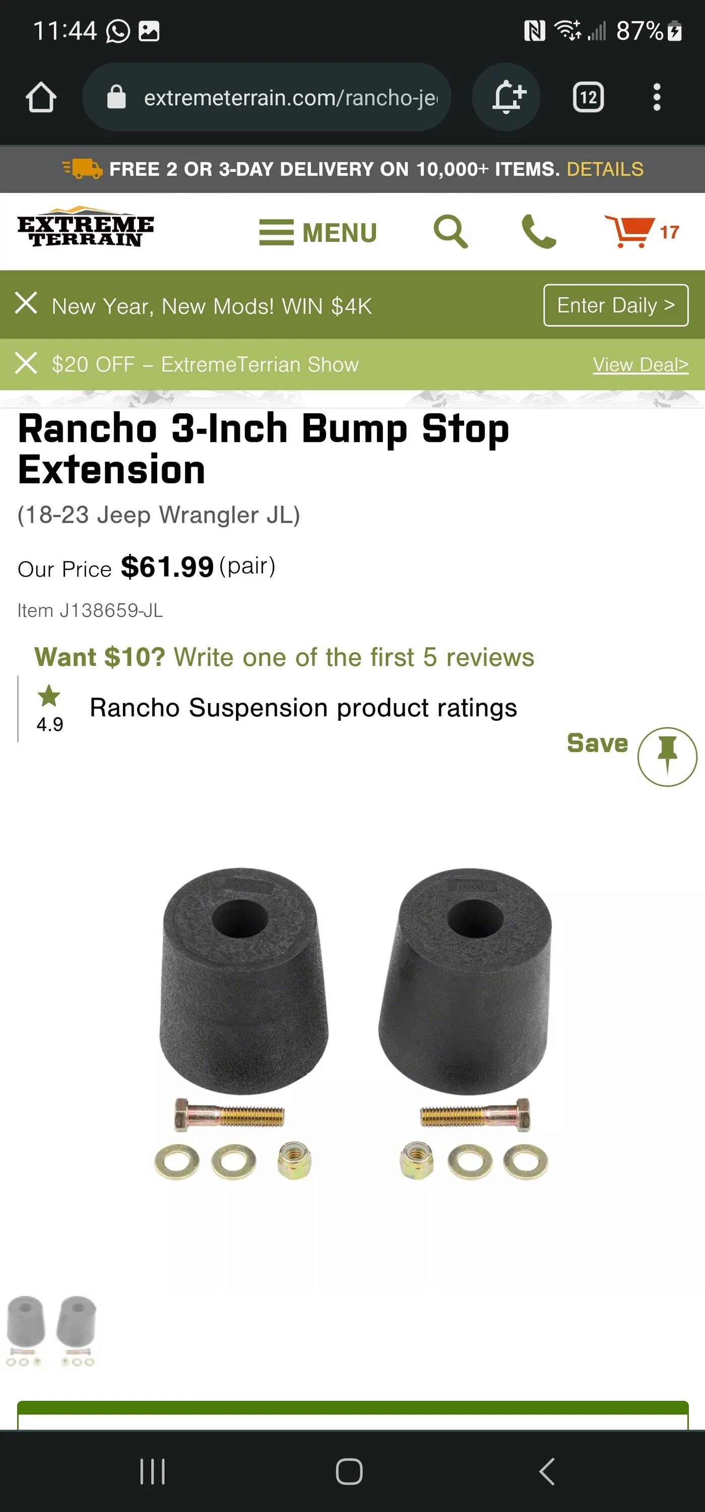

Something like this?

I was thinking these were bump stop extensions but can't tell. The rectangular ones look like the extensions for the rear.

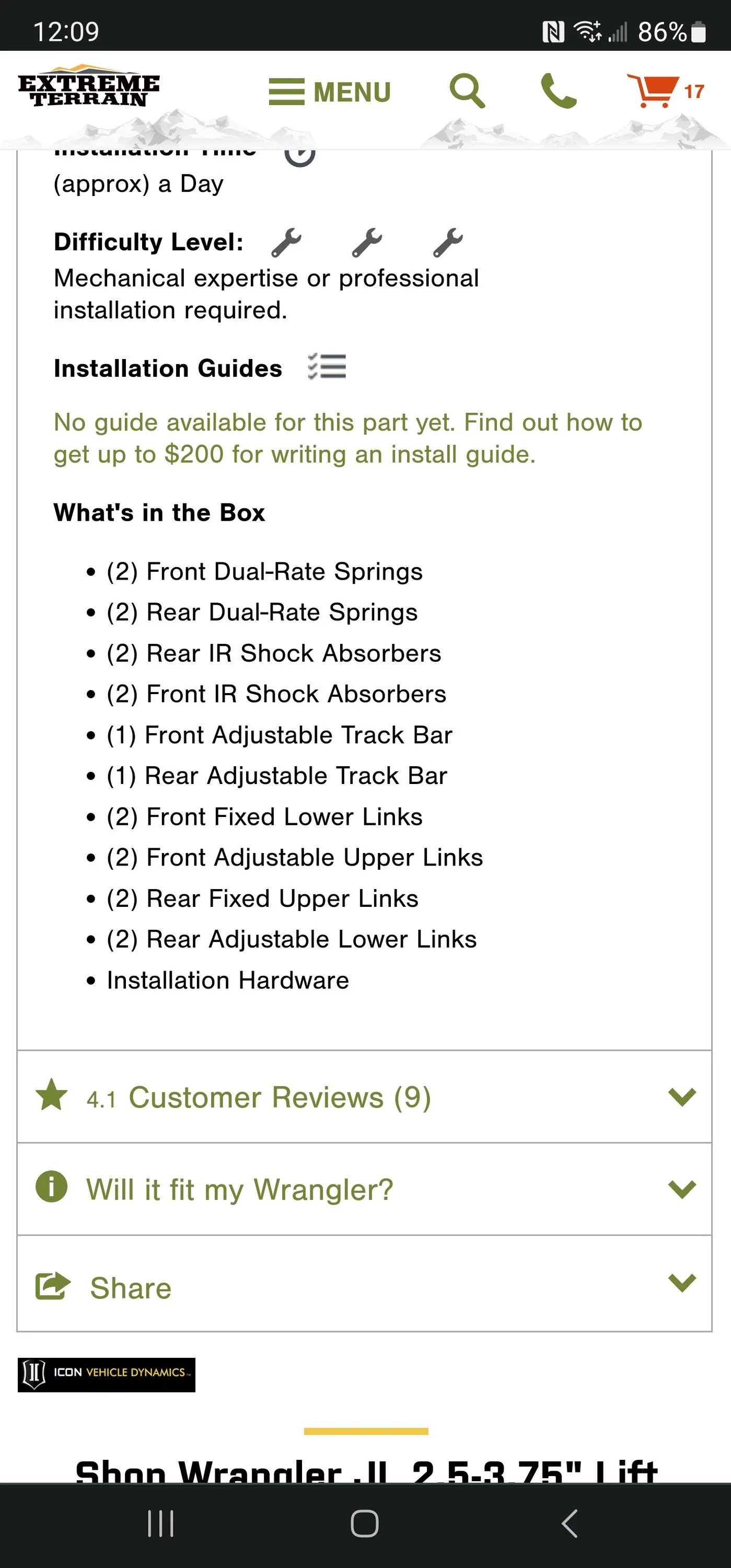

Actually I just noticed your kit include the upper links front and back which I did not do. Just the fixed lowers on the front to keep caster the same. Hard to compare ride difference since I installed it at 42 miles on mine but compared to others I have driven and the short time I drove mine, I see no difference on road. Very good manners and no wandering. Off road, particularly on the stutter bumps, this seems far superior to stock with the dual rate springs. Glad I went with the stage three to get the adjustable track bars. Front and back were out considerably (to me) after going up. I was on the fence on whether I would need them but glad I got them. I also got mine from XT. Call them up and they may entertain a discount over retail. They did for me although I bought several other items on the same order. Worth asking the question!
