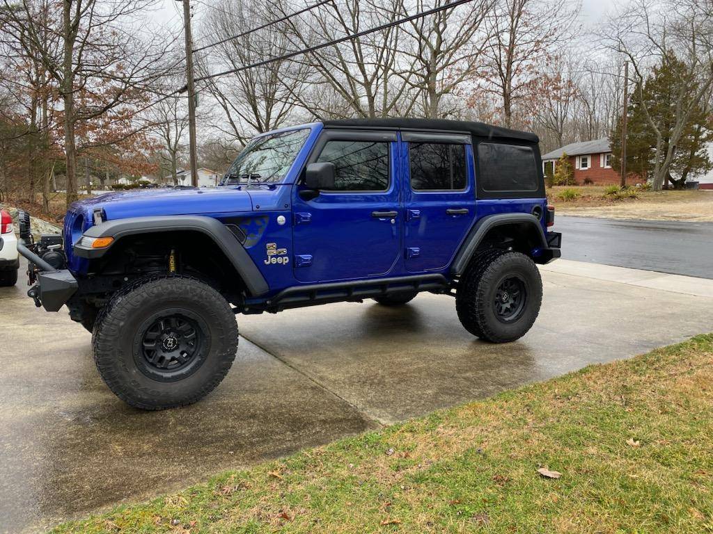

It all depends on what lift you go with for the height you will get. I have an AEV 2.5” on my 19 Sport S that netted almost 4.5” and I could definitely run 37”s if I want. I run 35”s and don’t plan on going bigger than that. I am loaded other than a hardtop. Metal front and rear bumpers, winch and frame mounted rock sliders and still netted almost 4.5”. This lift came with Bilstein shocks and I like the ride as a daily driver. This is with rubicon fenders as well.

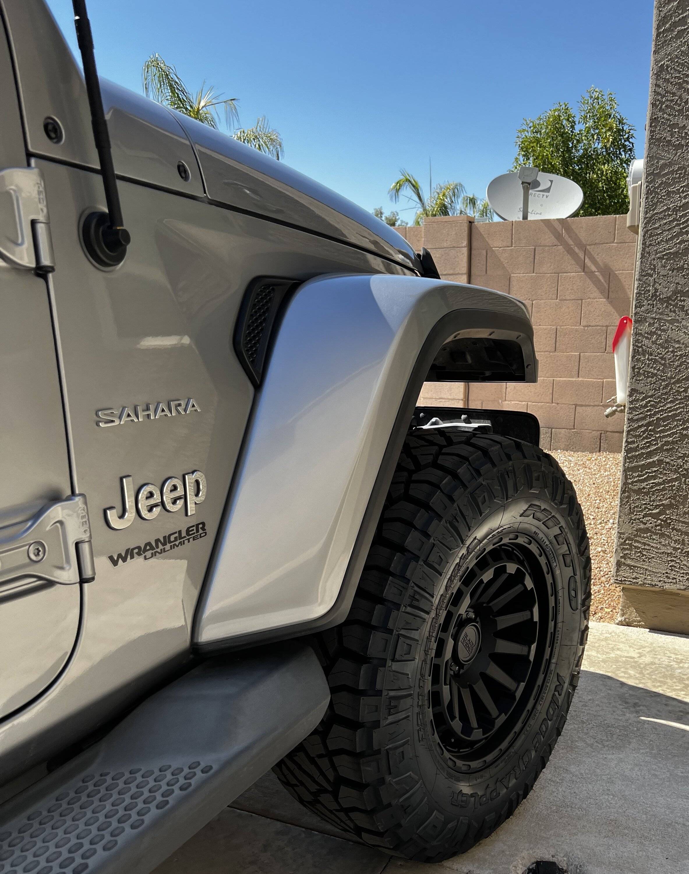

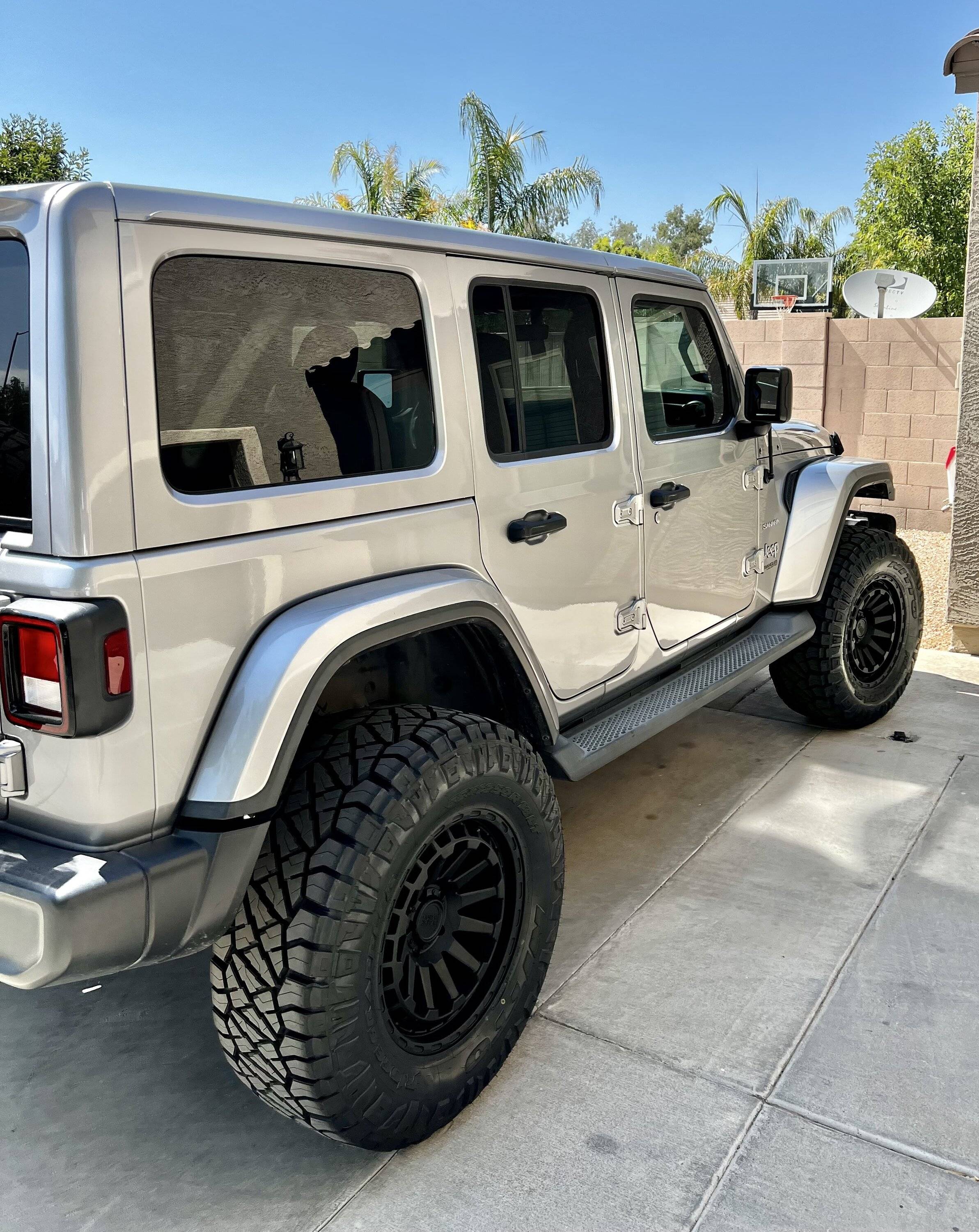

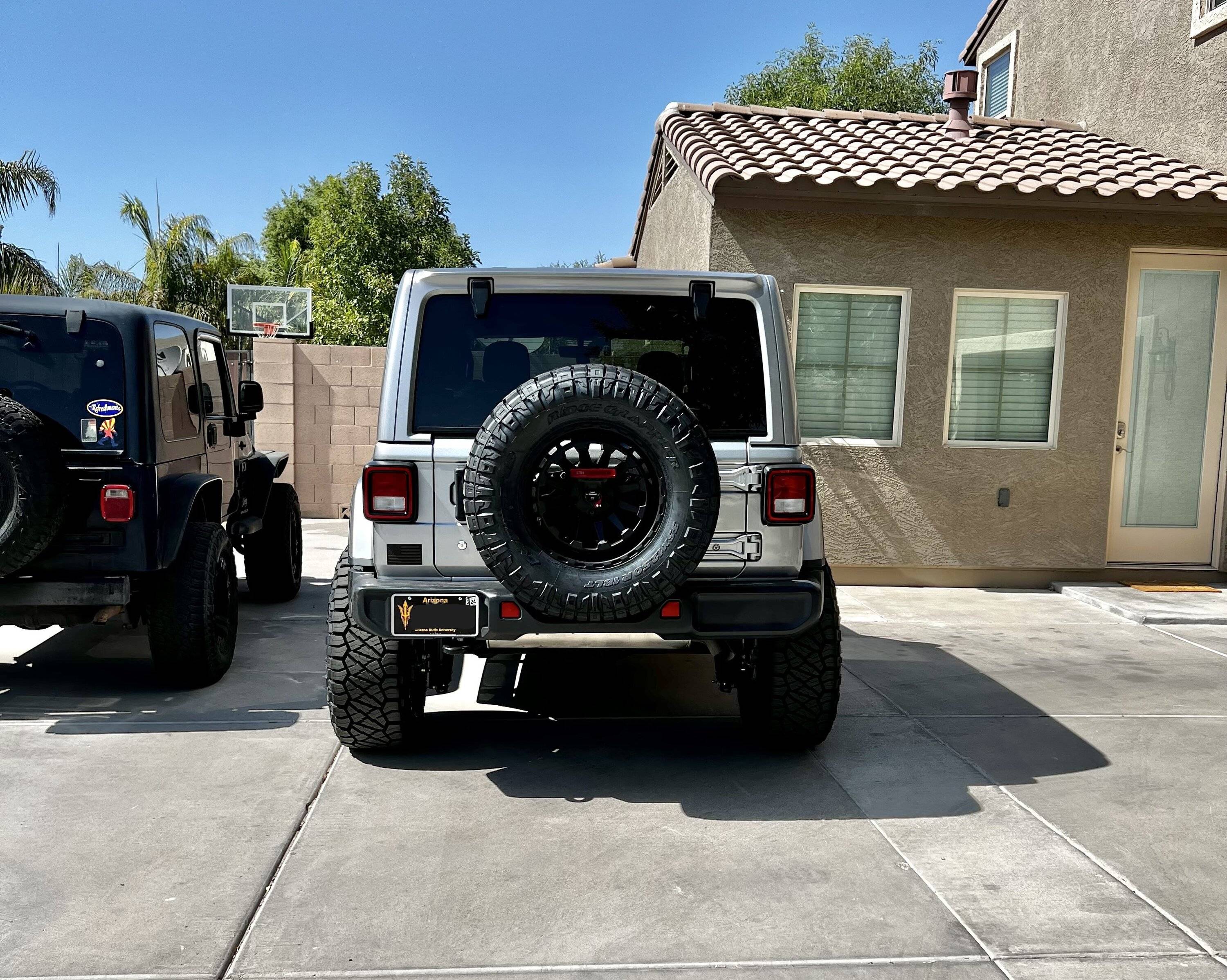

I just had the JKS J Konnect 2.5" lift installed, upgraded to the new Fox 2.5 perfomance series shocks, upgraded the drag link & tie rod w/Synergy, Fox TS steering stabilizer. Runs 35's with ease, no modifications needed. Ride is great!
