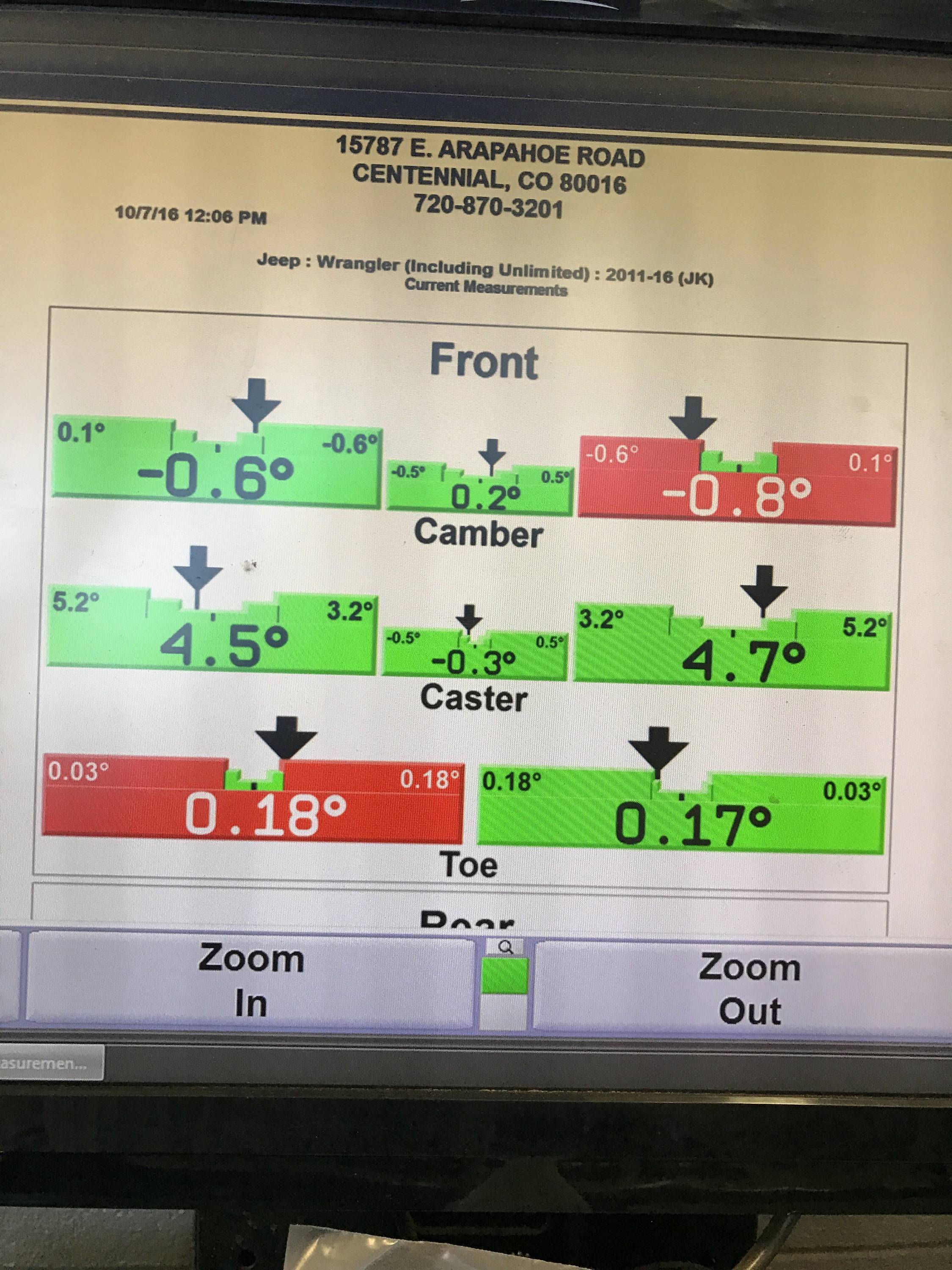

Unless you get something like the attached photo, I would call BS on the “alignment”. Otherwise you leave there not knowing your specs. And with what you are doing your caster number will be low and you should do longer LCAs but without the readout you won’t know.
