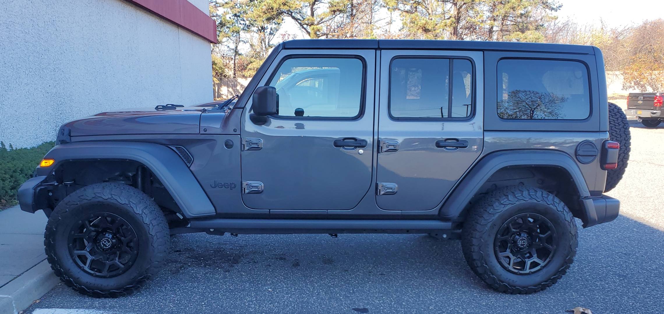

Neighbor and I tackled last night (rear) and this morning (front). Only broke up because life gets in the way. Used jack stands and jack and while I won't say it was easy, it wasn't too difficult. My neighbor was the lead and I played helper. Does not appear as if I picked up a full 1.50" however it does look noticeably higher. On to the next thing!

With spacers you picked up exactly what you put in.
