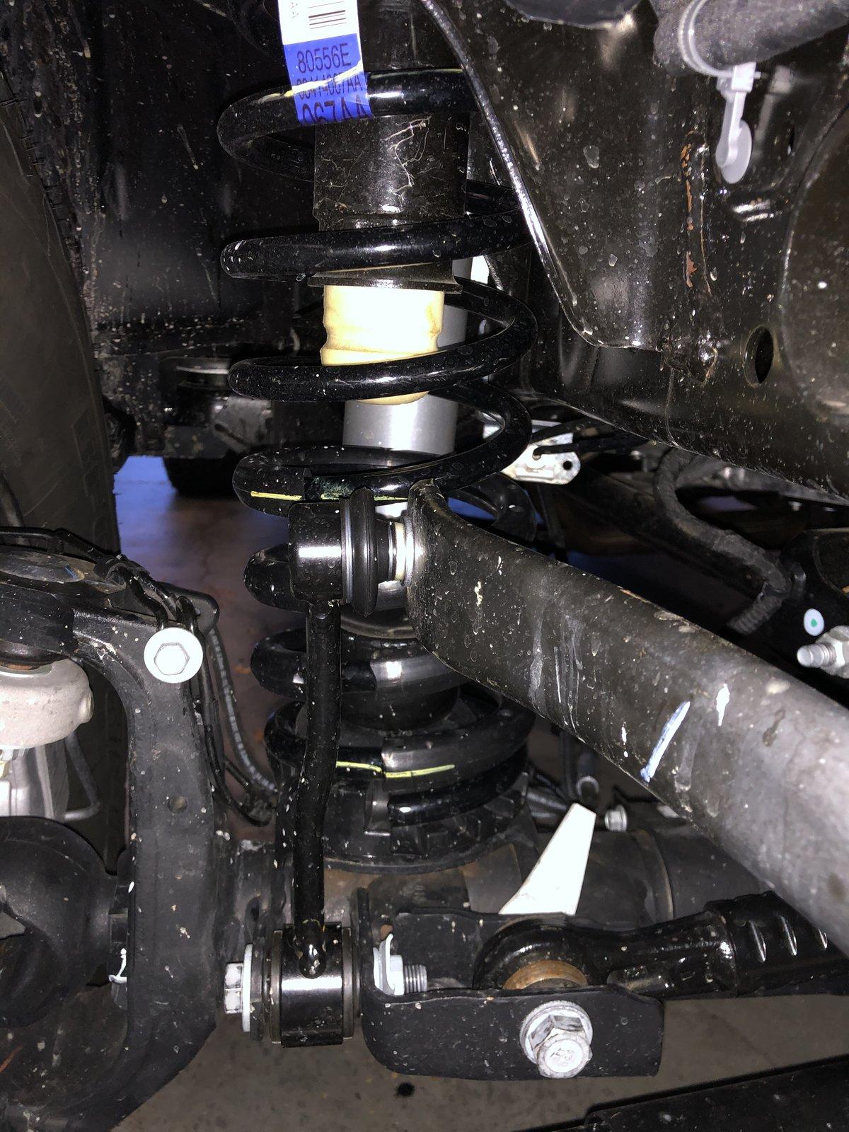

Was just thinking..... I installed a Mopar lift and was scheduling an alignment but do I really need to? Lower Arms are fixed, can’t adjust caster. Solid axle can’t adjust camber. It has less than 500 miles so toe is good. I adjusted the drag link to center the steering wheel.
What am I missing? Thanks
