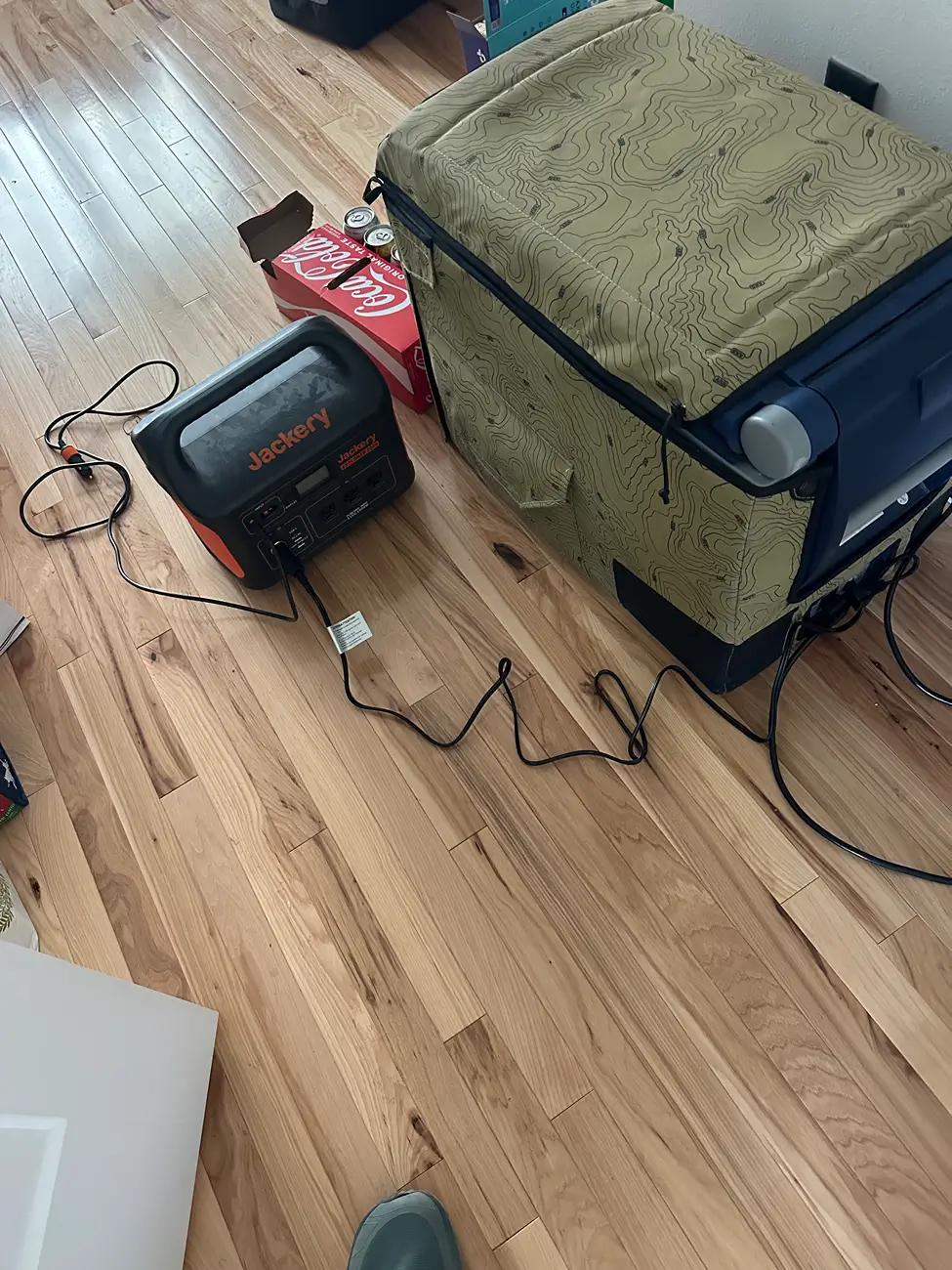

this my rock solid fridge set up.I have an ARB50 and 1000W jackery.... i plug my jackery into the 12V port in the back of my jeep and plug my ARB into the jackery...jackery will run the ARB for about 4 days without a charge and the jackery charges up while just driving around....just driving around keeps jackery at 100%. if I am parked for longer than that I can throw my solar panel out or just plug the the jackery into 120V to keep it full..when at home the ARB is plugged into 120V and I have been running it that way for about 12 years 24/7 without issues..
