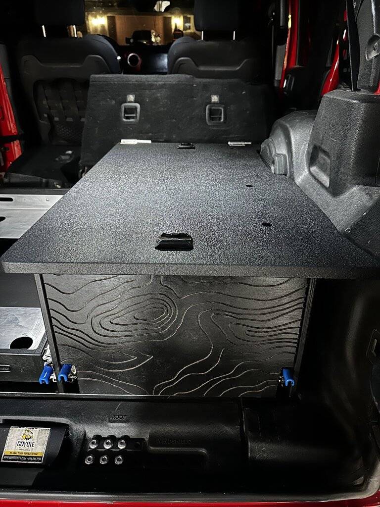

It almost has a "plastic" quality to it. It's roughly textured, but "smooth", if that makes any sense. It's not "gritty" or "sandy" like Rustoleum bed liner.
Here's a shot with the L-track mounts reinstalled.
And that's it! My final phase on this project is to coat the sleeping platform with Raptor as well to wrap it all up. I'll probably need 2-3 cans for the coverage.
