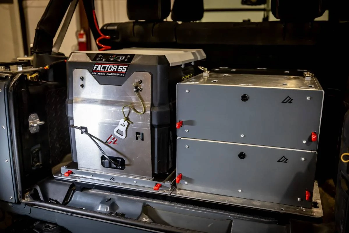

Hi folks! I just picked up my first powered cooler/fridge (SetPower RV45). I also have a 4 door with a soft top.
I'm trying to figure out the best way to use and access the fridge without needing to undo the entire rear soft top tailgate bar and peel up the rear window panel every time I want to grab a drink. What a PITA!
I currently have a DIY deck system I built & posted on the forums a while back. I'm in the redesign stages now. Ideally I will have 1 drawer on the right, and the fridge on the left.
From the "floor" of my current 1/2" plywood base, the RV45 fridge is about 1/3" too tall to clear the bottom of the soft top. That also assumes the fridge sits perfectly flush with the floor of the deck, so in reality I'm about 1/2" short.
  • Deck to tailgate bar: 17"
  • Fridge height: 17.3"
My next best idea is to have the fridge slide FORWARDS over the left-hand rear seat (40% from the 60/40 split). Then all I would need to do is fold down the seat, slide, and grab a drink. I would likely just leave the seat folded down during a trip.
Removing the seats isn't an option for me as the Jeep is also a DD and I have a kids who frequently rides with me.
Prebuilt Option from American Adventure Labs: I was looking at AAL's MASS platform as it would be one of the thinnest base platform options (rather than a DIY plywood base) coupled with one of their sliders, but it appears from their photos that I'll still be too tall. I'm thinking the base plate sits on risers.
Photo is the exact AAL set up and fridge combination I'm referring to.
