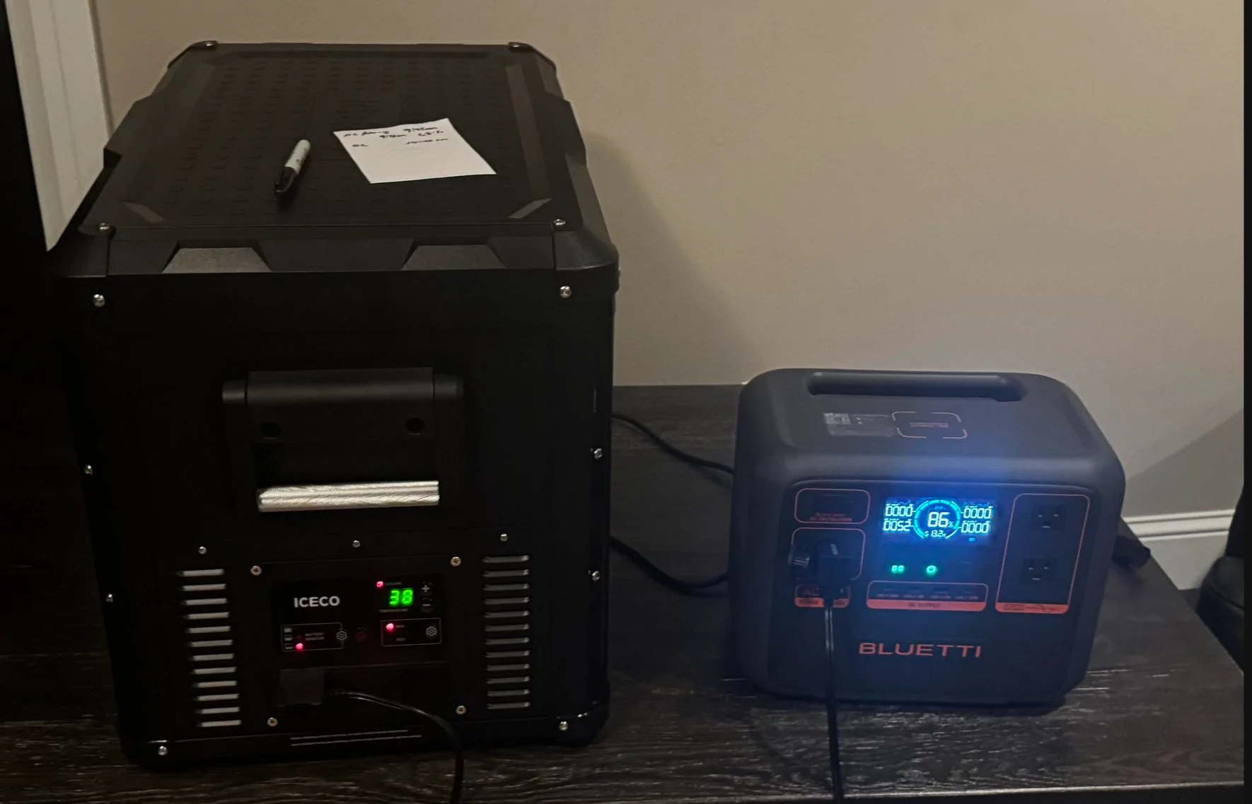

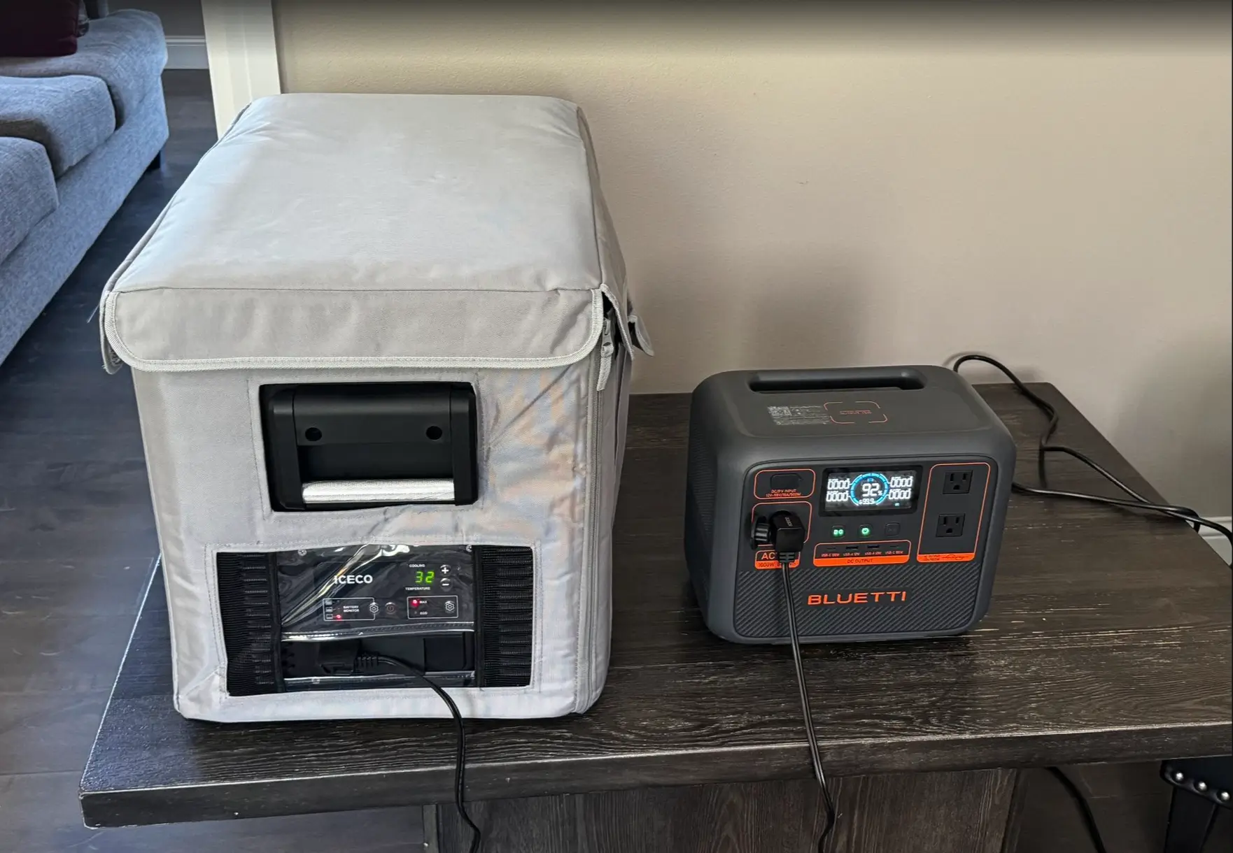

Over the weekend I tested the difference in power usage between AC & DC and DC with and without insulated jacket for fridge.
This was done indoors with a temperature range of 72-74F. The fridge (Iceco VL45 ProS) was set to 34F and would fluctuate between 32F-38F. Power was supplied by a Bluetti AC70P w 1000WH. Each scenario was run for 12 hours starting at 100% charge.
AC only dropped to 63% after 12 hours
DC only dropped to 75% after 12 hours (16% improvement over AC)
DC w insulated jacket dropped to 76% after 12 hours (17% improvement over AC)
I suspect the insulated jacket may have performed better in higher environmental temps.
A bit surprised on the AC only as that would mean it would consume 74% of the battery in a 24-hour period at a relatively mild environmental temp. I may try a friends dometic (was mine) with similar tests to see how it compares as my gut says it had lower power draw.

Nice job. I'd be curious to see how the Dometic compares. Are the two similar sizes?

The AC inverter is not as efficient as the DC side. AC inverter takes power just sitting idle and the DC takes much less when idle. This is a general rule with power stations. I am surprised the insulation did not help more. Did you notice the max watt draw during the test. I have a dometic drawer fridge that usually runs around 26 watt consumption when it is running on DC.

In 'Max' setting it draws 51w at 'Eco' setting it draws 30w - so depends on what I'm running. The above tests were all in Max so I'm trying again in Eco to see the difference.

I'm. It surprised by the insulation. I feel like those things are kind of gimmicky.
Having a heat shield to protect from direct sunlight, which the insulated cover can do, would probably make a difference. But a blanket can do that.

That conversion is usually spec'd to be ~85% efficient, so that's in the expected ballpark. Thanks for doing the tests.
The results of your insulation test, however, are unexpected.
