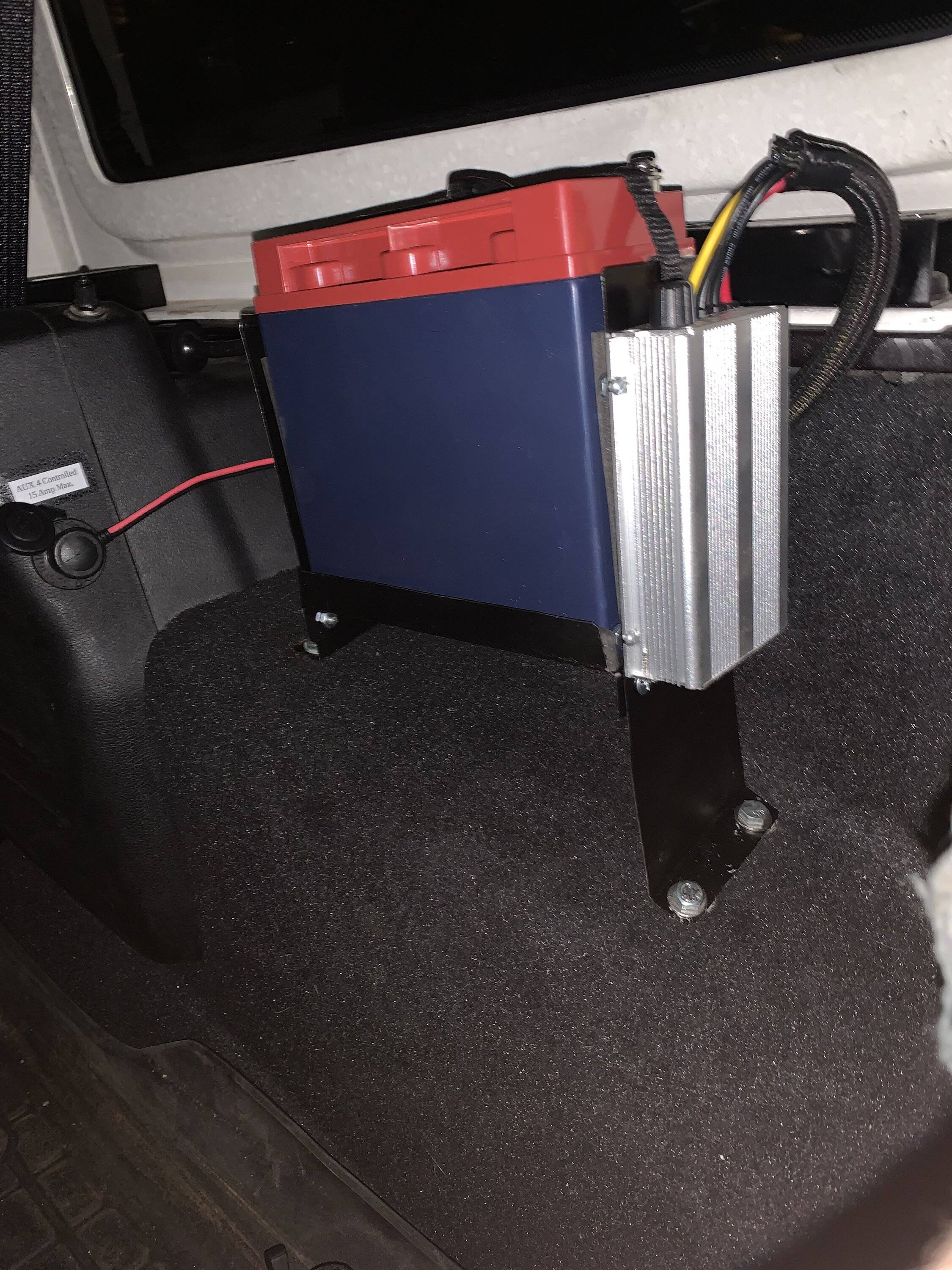

Just finished some power testing of my 50Qt Snomaster fridge which uses the Secop compressor (same as the Dometic & ARB?). In an 8 hour room temperature test set to 37F in ECO mode it used about 0.6 Amp-hours per hour.
To simulate hotter ambient (86F) I lowered its set temperature to 21F; it then consumed ~1.0 Amp-hour per hour.
For a 12 hour over-night in camp running off a healthy condition Jeep battery that shouldn't be a problem.
That said, the idea of being in the boondocks with a dead battery doesn't sit well with me, hence a small 23AH LiFePo battery and DC-DC charger. Depending on ambient temperatures it should run my fridge for up to 36 hours.
The charger is set up to run off the Aux 4 switch only when the engine is on. On the fast charge setting it takes about 3hrs to charge a fully depleted battery.
