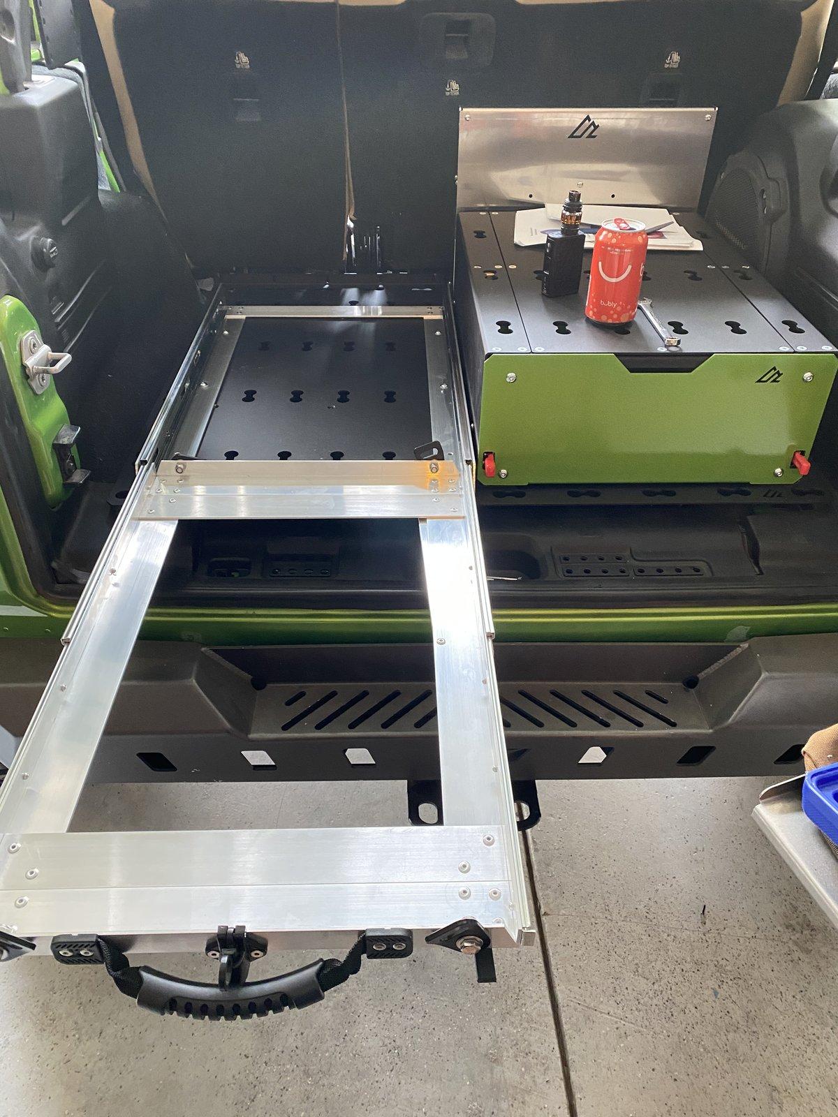

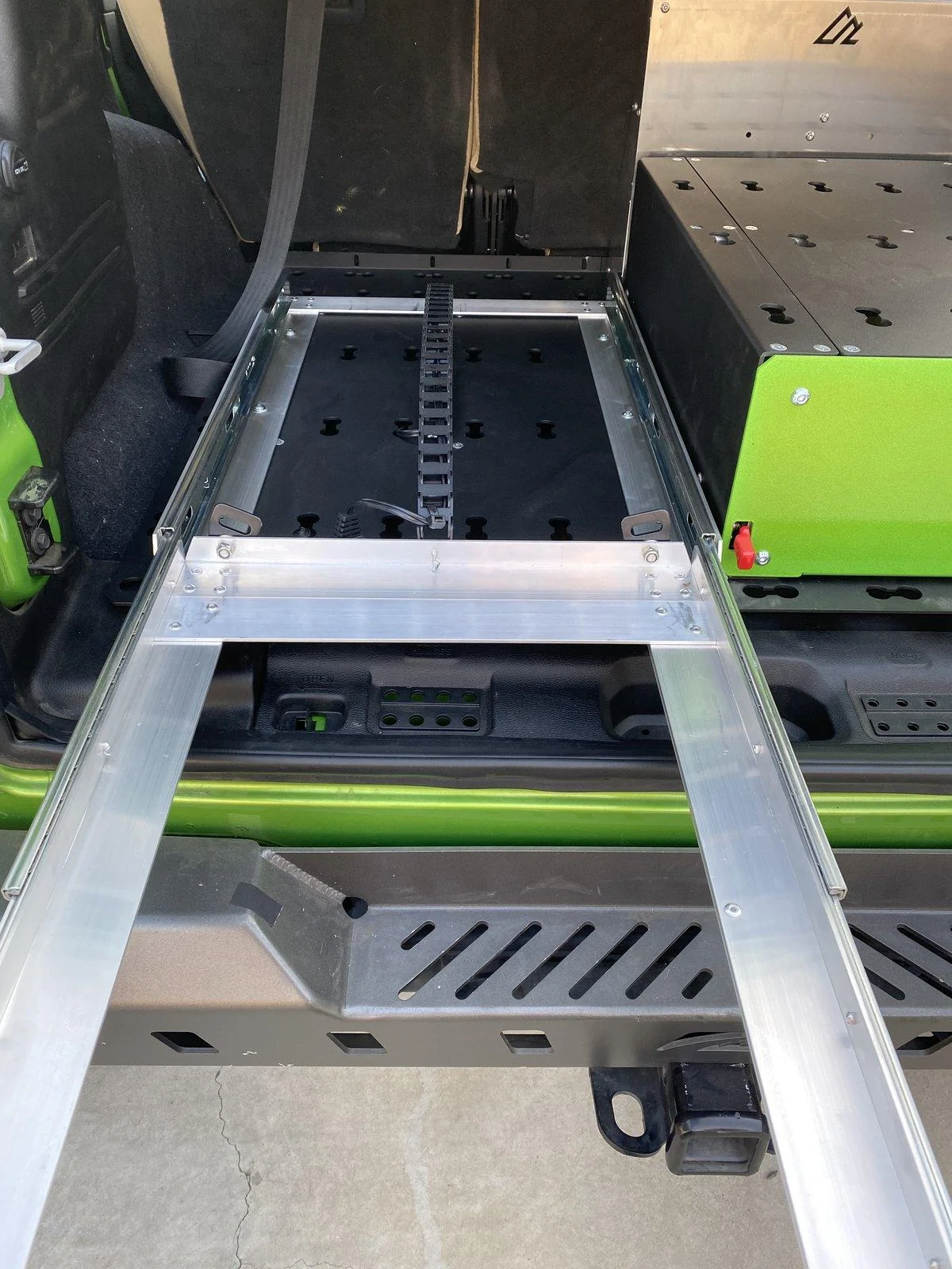

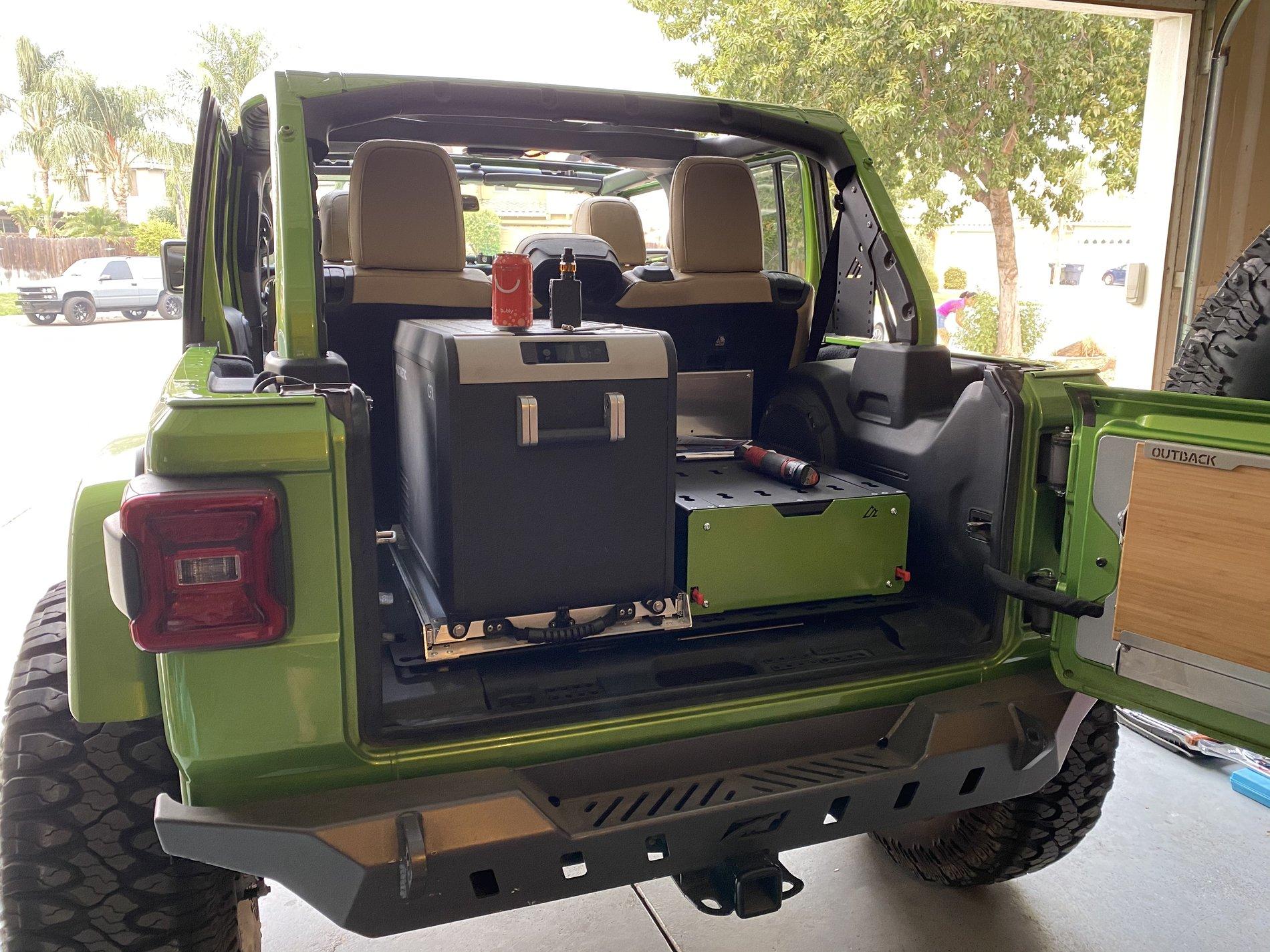

intaalling it right now and this is the mockup. I can move the fridge forward more as well.
I chose to drill and rivnut the slider to the floor.

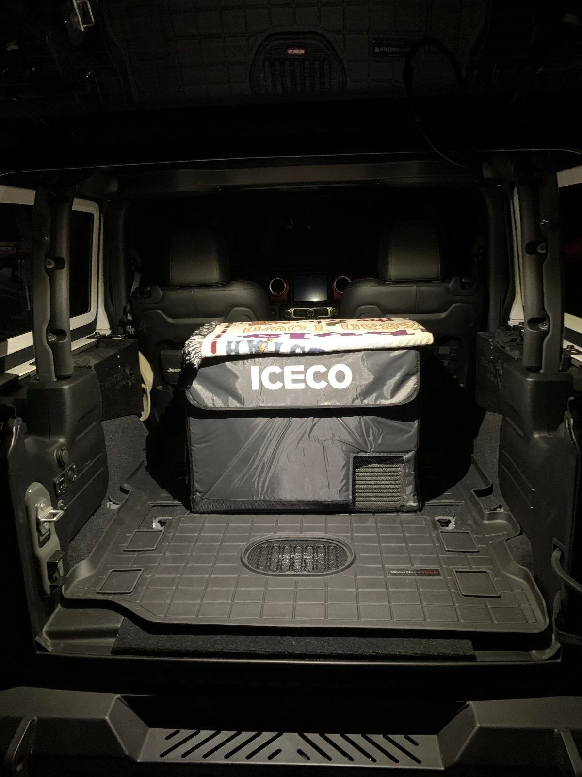

Anyone running ARB Zero 47 Quart or Dometic CFX3 55IM?
I was also looking at these fridges but I ended up buying the Iceco. Same compressor and really quiet. Half the price.

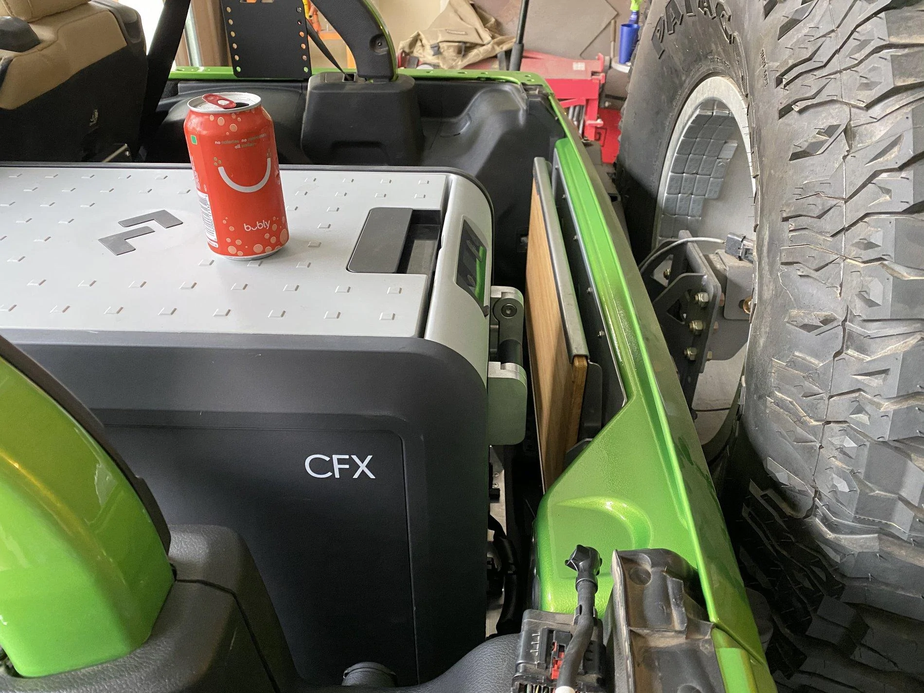

I've been MIA for a while so just wanted to throw this up there with the aam shelf at the highest settings.

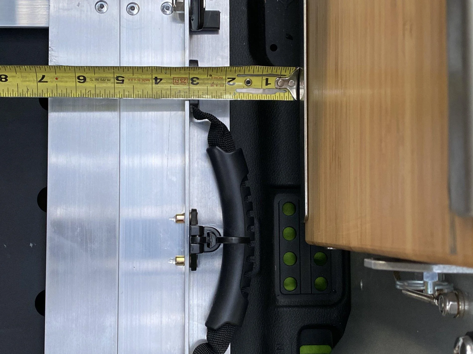

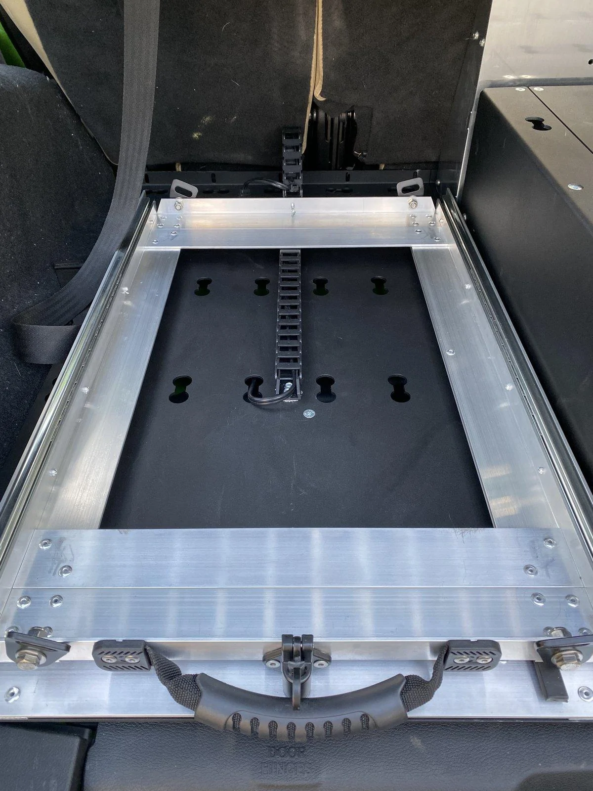

it’s about 1 3/4 gap. Also remember that each dfg slide is different so their arb fridge mount won’t be the same as the domestic one
also wanted to show something else that I did for the power cable. Used a cable guide to ensure when moving it in and out the cable doesn’t snag or kink.
How Did you get the cable inside the guide? the guide I got from amazon is closed.

I cut the end since I hardwired it into my power distribution block.
you actually cut the wire, got it. i am going to have to get a different guide then so i can get the cable through. thanks

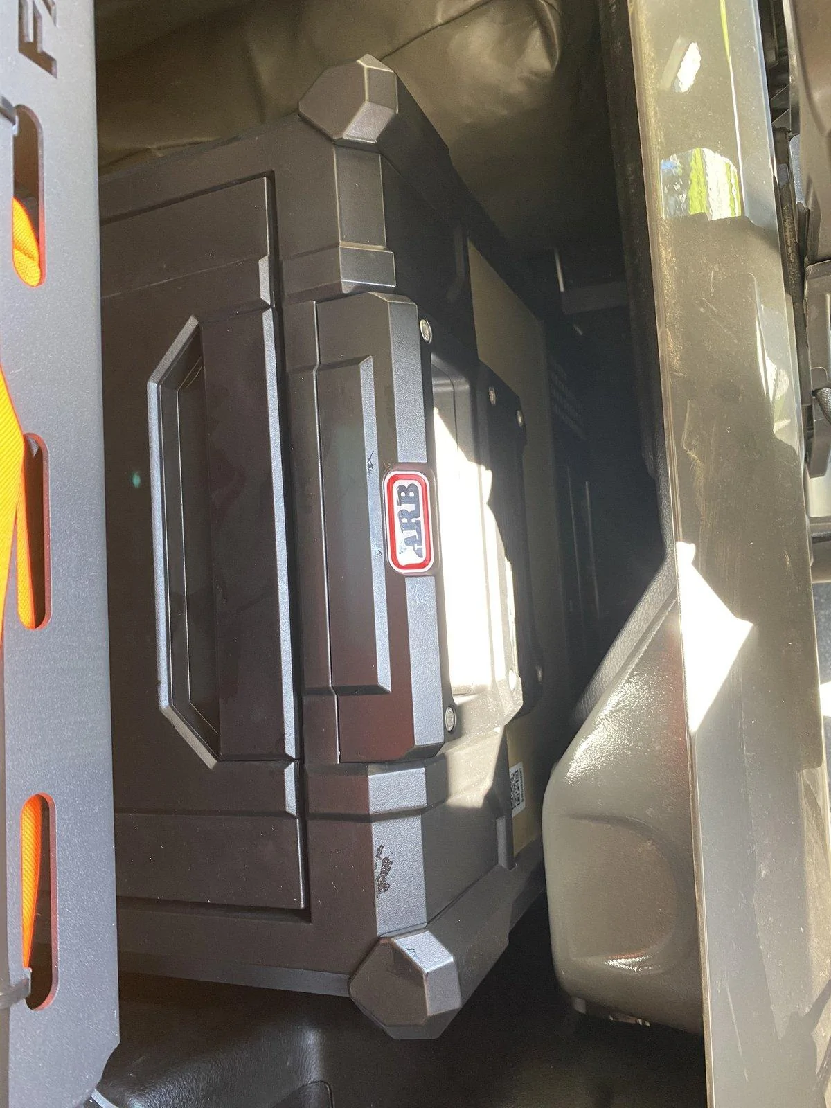

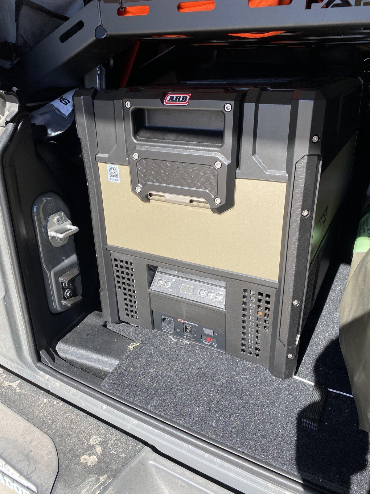

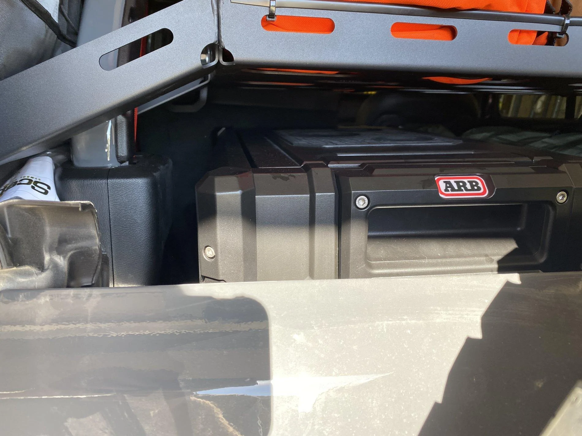

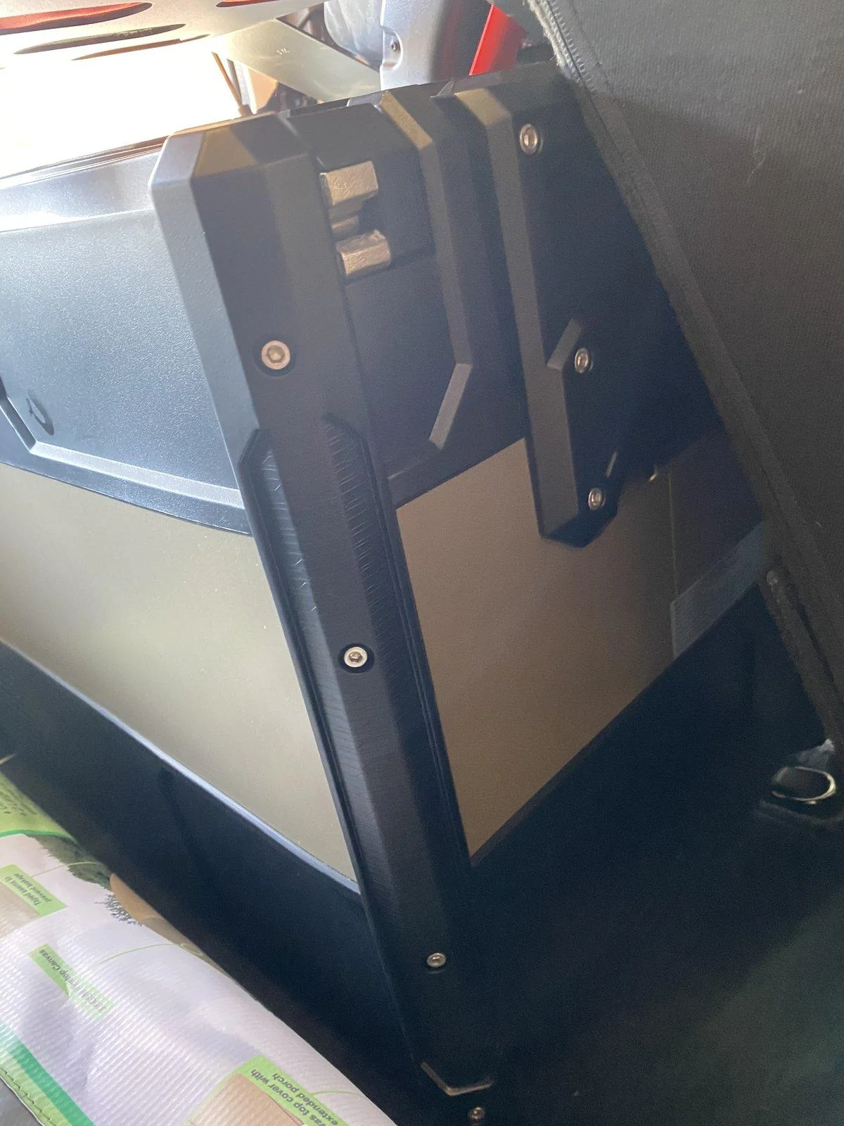

So the ARB is a beautiful fridge. Very impressed with the fit and finish. It looks like it will fit with the rear seats up but barely. I’d be a little concerned about airflow around the compressor. Unfortunately though, I don’t have a good way to power it for multiple days off grid so returning it. Once I get a second battery and some panels I’d definitely buy it or an ARB again. Have no experience with small portable Dometic fridges but the ARB sets the bar high.
What storage rack is this? If you could link it that would be awesome!

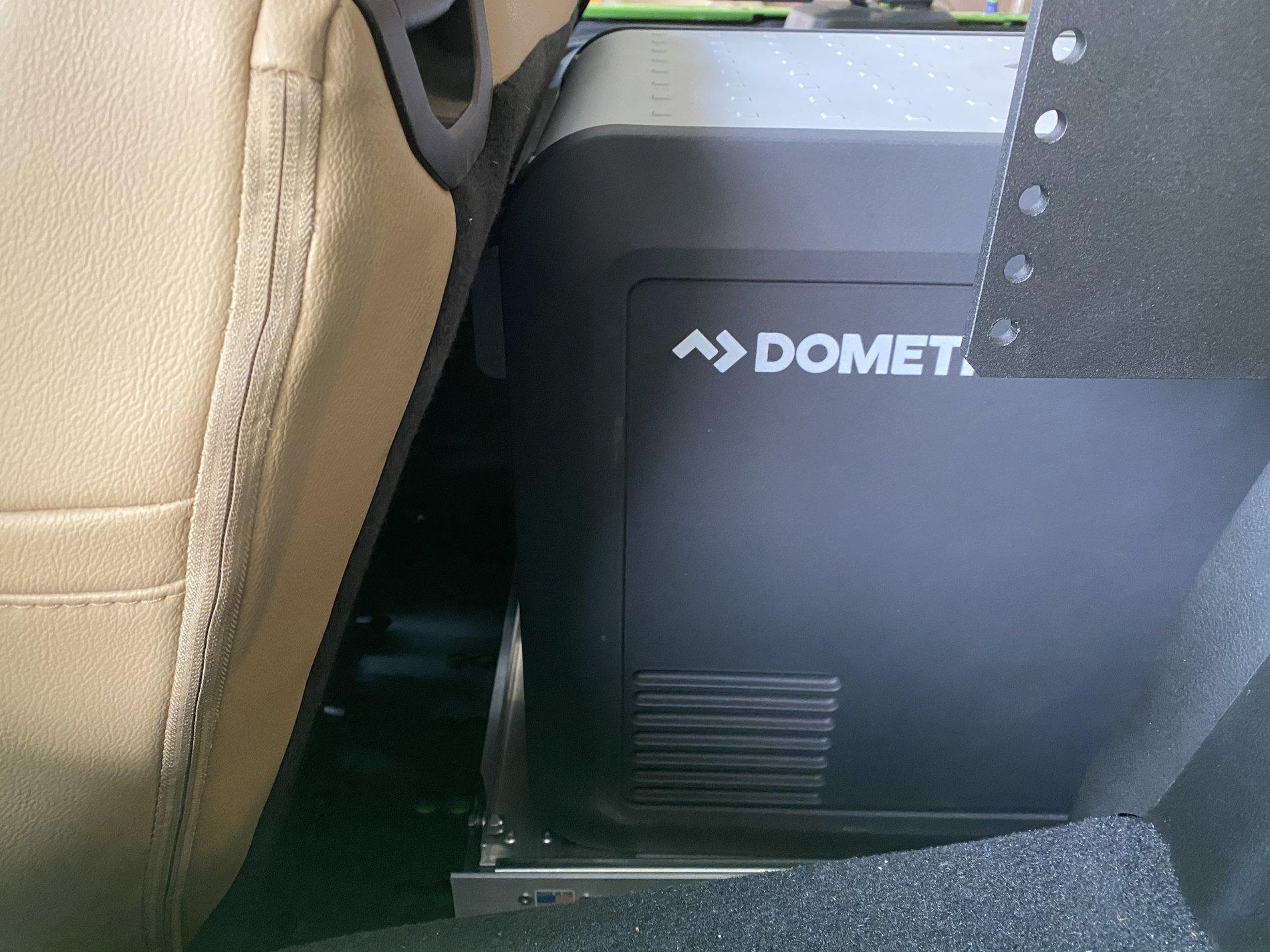

I have the Dometic CFX3-55. Its tight but it makes it.

You will not be able to use a slide with the rear seat up. I also replaced the side grab bars with rip cord grips, otherwise the bar hits the tailgate.
