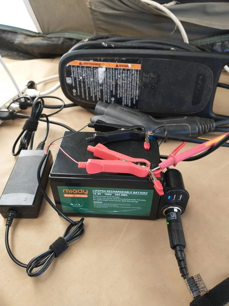

I haven't tested how quickly it heats up. I bought the Miady 12 ah LIFEPO4 for $60 and a LIFEPO4 specific charger for $20. But I also use a generator during the day.
Before I bought the refer, I maximized efficiency with the insulated colman cooler. I made custom insulation blankets with R16 fiberglass roll, a roll of a plastic sheet, duct tape and two straps. One blanket wrapped the sides and was secured with the straps and then a top piece that recessed into the too tall horizontal blanket like a secondary lid and a bottom piece.
I'd get 7 days in the summer out of the ice and longer in the winter. As long as 10 days. Prior to the wrap, I'd need more ice in 3 days. I'd try doing that if a battery is too much right now. I spent about $30 on the materials. But a small LIFEPO4 would be the best. You could charge it with jumper cables to your car, but that will take some longevity out of it.

I charge it with a generator and it will last overnight and into the late morning/early afternoon, depending on the outside temperature.
Find the amp draw of your ARB and multiply it by 24. That equals how many amp hour(ah) battery to get for 24 hours use and will power the refer non stop for that time. Realistically, it will use less ah since a lot of the time the compressor is off.
