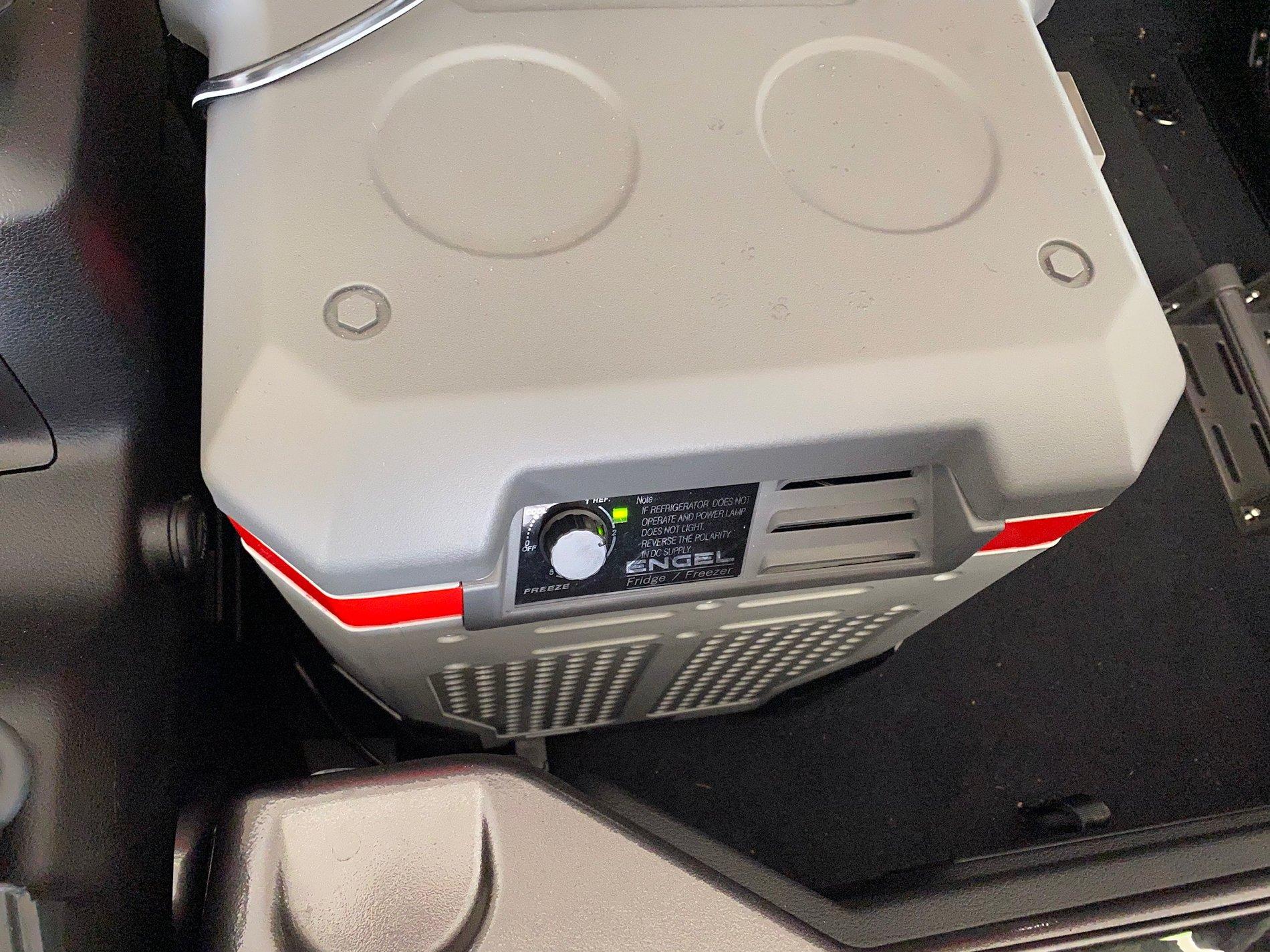

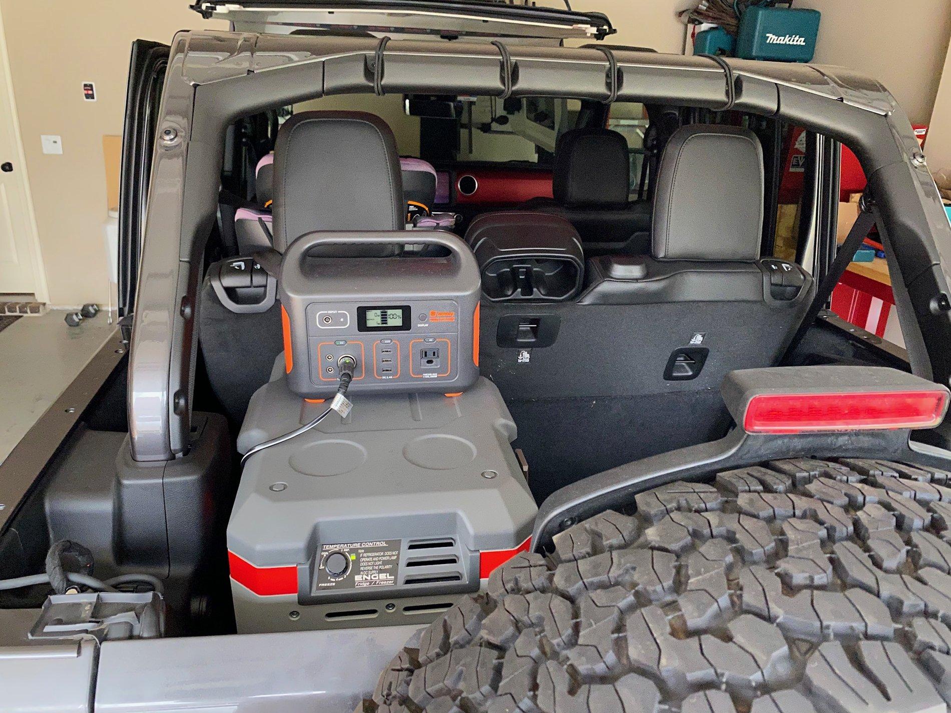

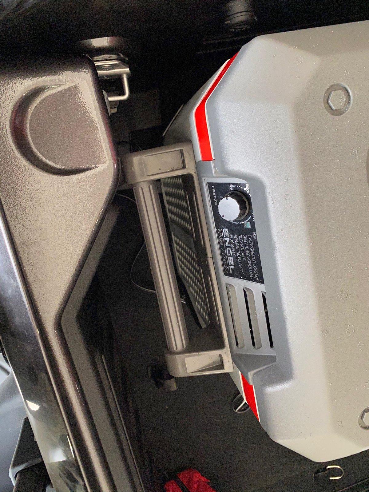

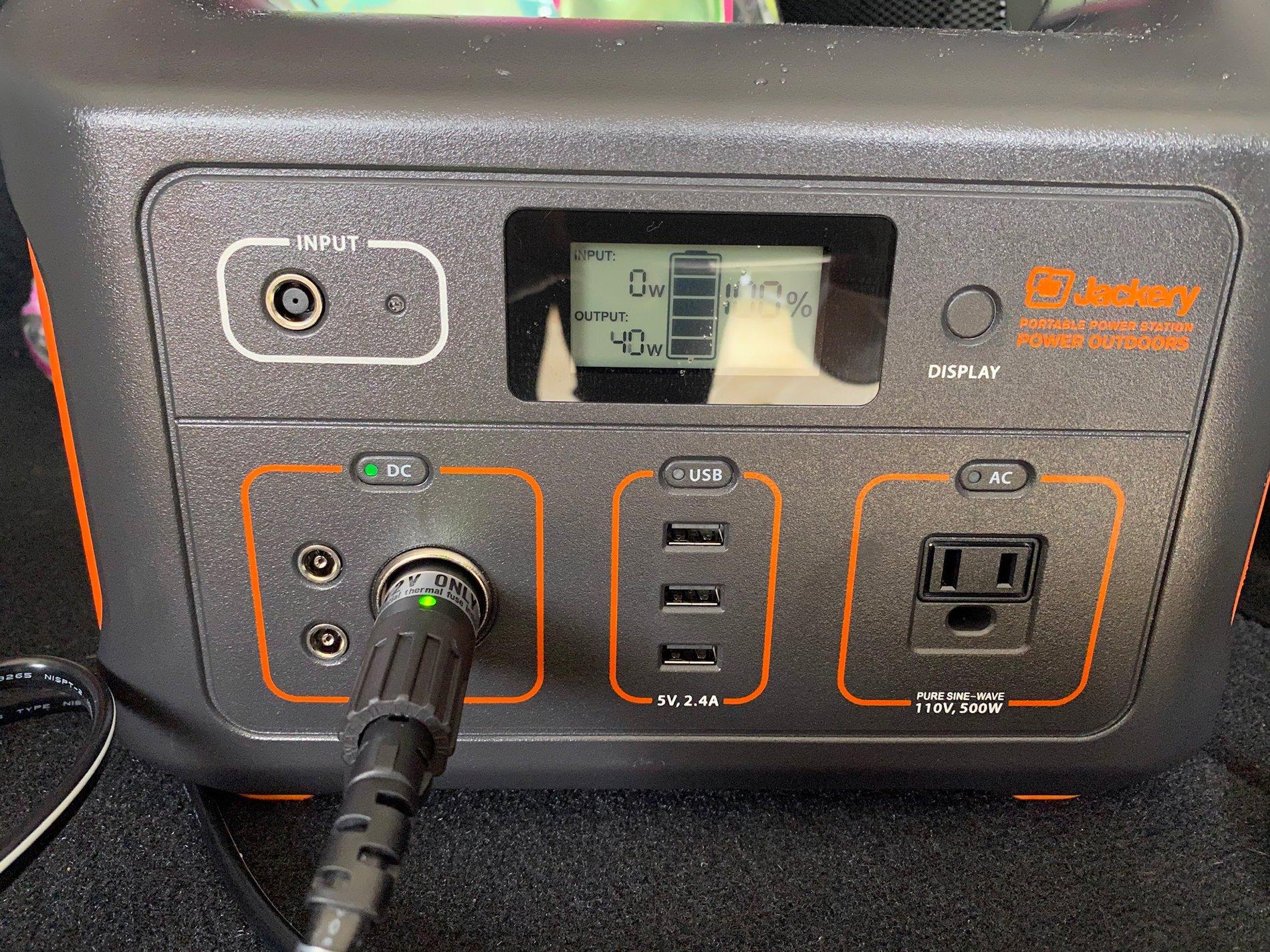

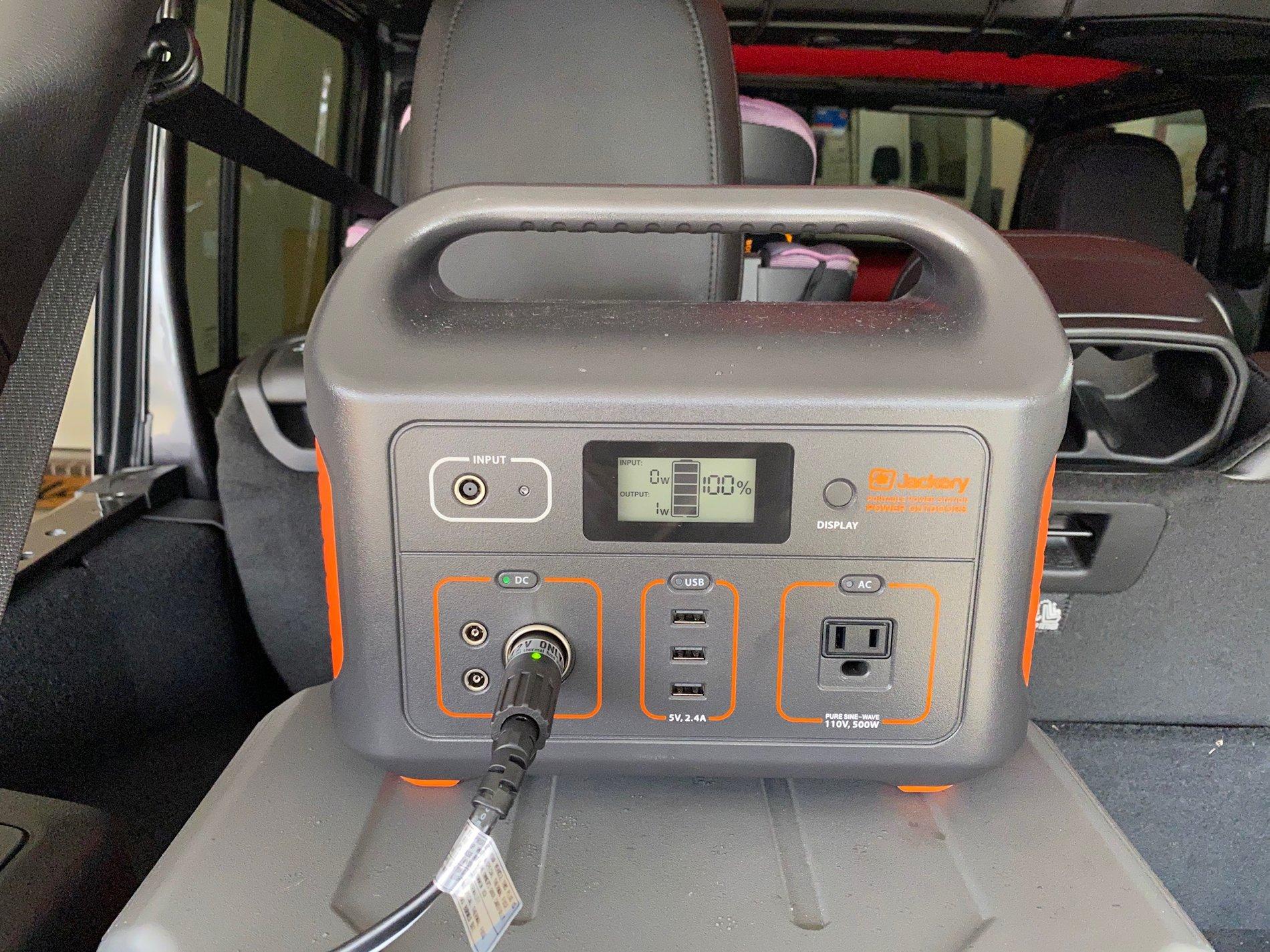

The fridge fits on the driver side, but I had to remove the handles. I included photos of fit with and without handles. Testing out the Jackery 500 as well. I’m going to run it down to 20% to see how many hours it will run the fridge. So far, the fridge draws 1 watt when compressor is off and about 40 watts when compressor is running.

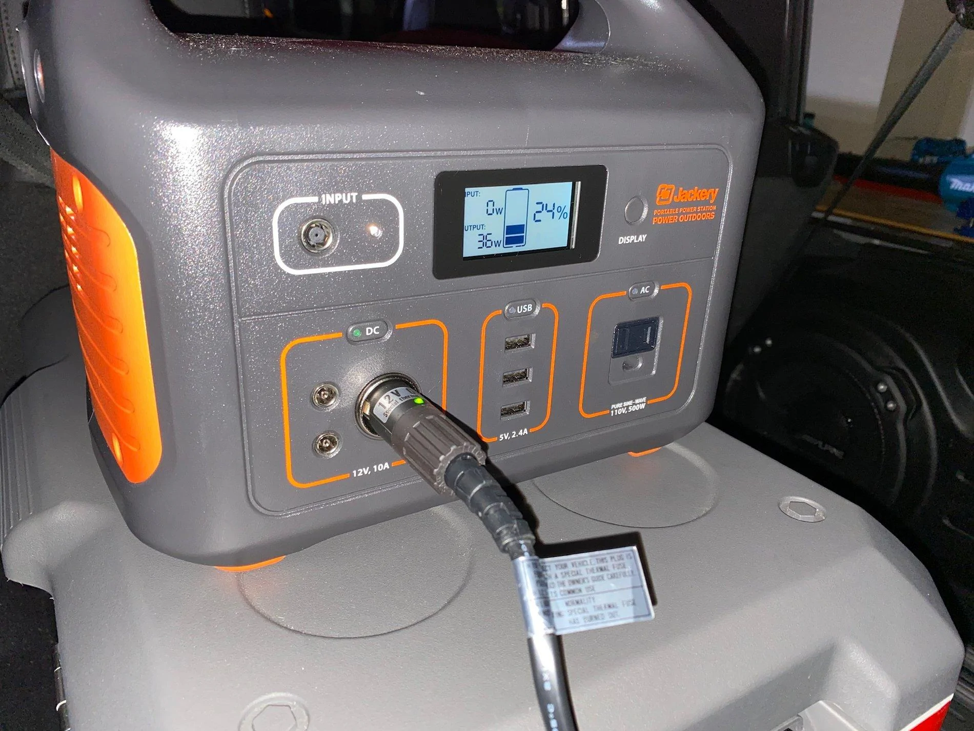

Just wrapped up the Jackery test, but cut it short at 32 hours with 24% battery left. I expect it would have gone another 10 hours if I ran it all the way down. This is perfect for a weekend trip without worrying if the fridge will run down the Jeep’s battery. I’ll have to add the solar panel at some point to extend the output further!
