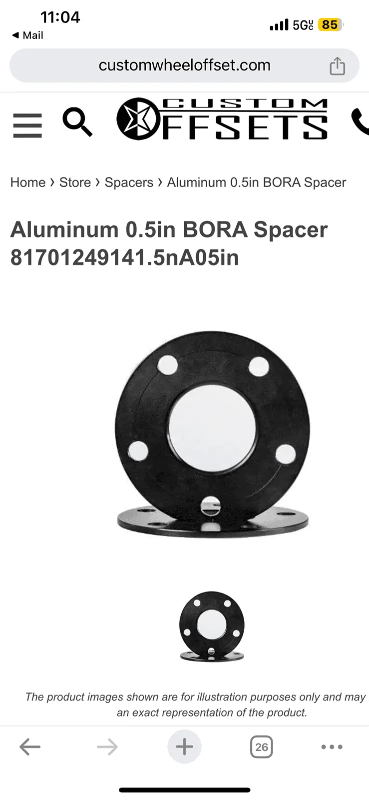

Any idea what the WMS front and rear including the spacers? Also what backspace are you running?
4.5” of back spacing on the rims
I believe the Dana 60 is 72” I have .5” spacers to clear the steering arm so that puts me at 73” in the front.
The 14 bolt is 68” with the 2” spacers puts me at 72” in the rear.

Cool thanks. Didn’t even know you can do .5 inch spacers.

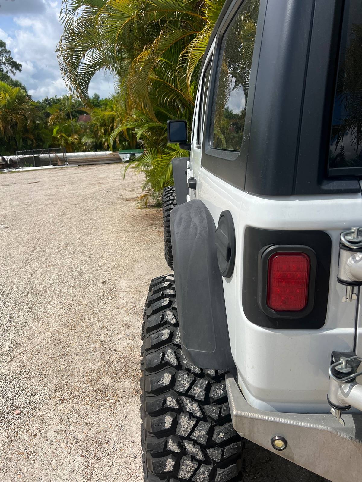

For the stock sport axles with 37s? I felt like they were sufficient could still stop quick if needed
OK thanks for the feedback. I've always been curious about when you should upgrade the non-HD brakes on the Sport, but if you can safely/effectively run 37s on them, I think that's pretty good. Really appreciate it and thanks for sharing your build with us. Enjoy!
Yeah drove to Arizona/utah/Colorado through the mountains and hills and never felt brakes were lacking.
