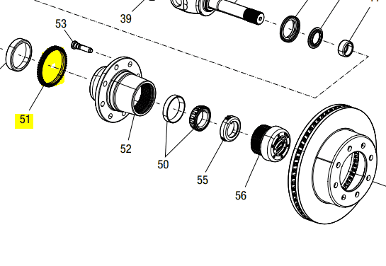

Holy crap... $400... I much rather spend a bit more and buy a mini lathe and fabricate my own tone rings... LOL..
BTW... I am looking at other options... I know Spicer makes front Dana 60 52 tooth Tone rings because how else do they make ready to install Dana 60 Axles for the JL ??..

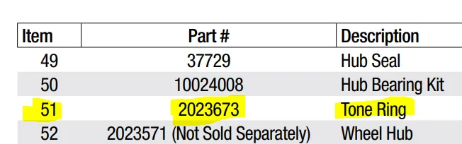

Here... I found this document...
https://spicer.com.co/wp-content/uploads/2021/04/catalogo-tecnico-performance-2021.pdf
Notice Item # 51 on page 38 ... the tone ring..
Page 39 describes it as:
Google shows the "Dana Spicer 2023673" as a 52 tooth tone ring.. for $72 a piece, and Ebay
has them for $62 and free shipping.
https://downtofab.com/products/spicer-2023673
However, these front hub assemblies seem to be completely different from the
2005+ Dana 60 Superduty ... so, yeah.. that idea is a dead end... but I wanted to
post this information anyway so others do not waste time with this alternative.. LOL
