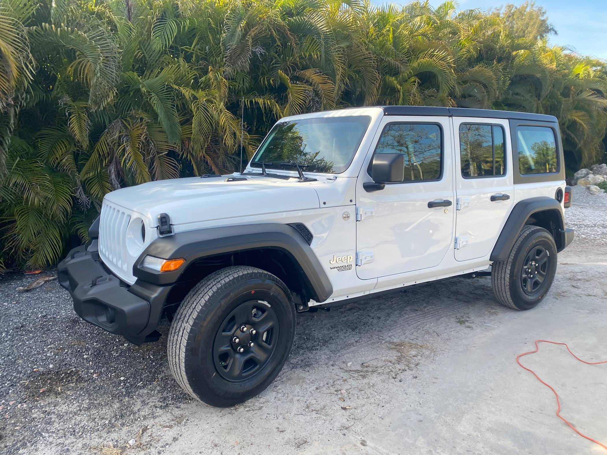

I purchased my jlu 2.0 in February 2021 and it was the only base model that I could find in the state at the time
Jeep Wrangler JL My 2021 JLU build thread 63416407885__C5DA8E56-122F-49EF-AB13-C802CC775529

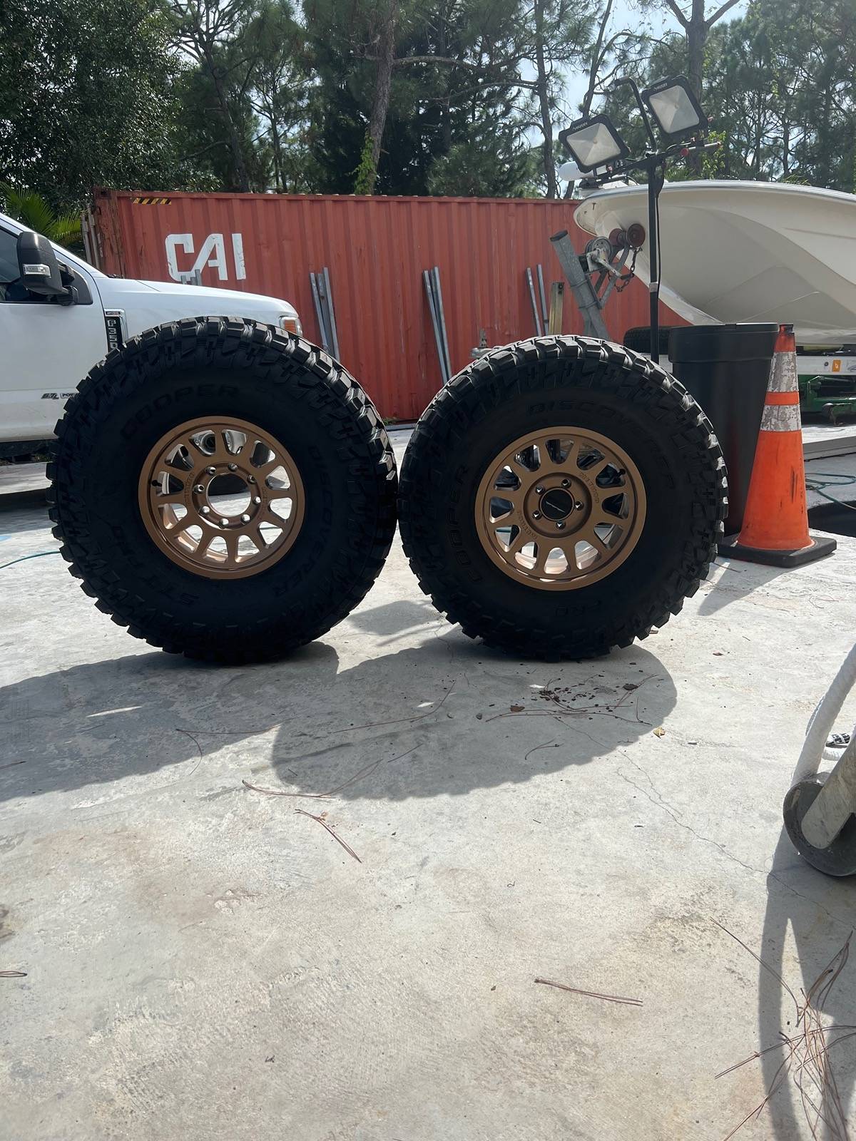

I proceeded to put 500 hundred miles on it and then went to 37/12.50r17 cooper stt pros on method 703 bead grips. Also added the rugged ridge max terrain flares and eBay inner fender liners (max terrain fender fit like garbage and deteriorated in 6 months. I bought them for two jeeps and was not happy about the waste of money they were!) as well as adding the Genright aluminum rocker guards.
Jeep Wrangler JL My 2021 JLU build thread 64116940513__B2C9C443-BD5C-4B45-B6F1-CBA4C5E33F6B

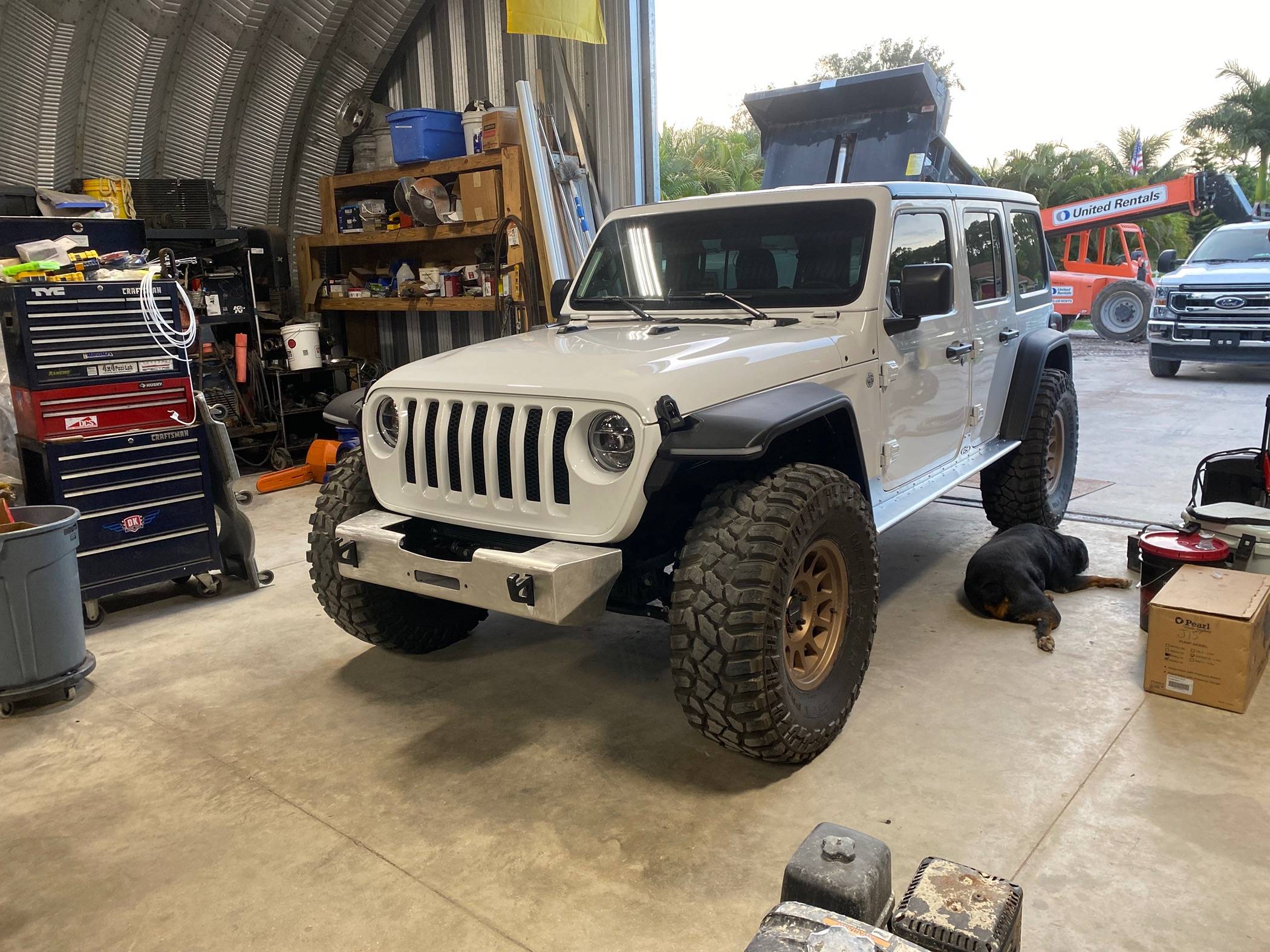

Next up for me was the Nemesis Helix stubby front bumper. Love the look and the fit of this bumper!
Jeep Wrangler JL My 2021 JLU build thread 64246937064__0B762082-40AB-4D04-82FE-00C2E3A1A781

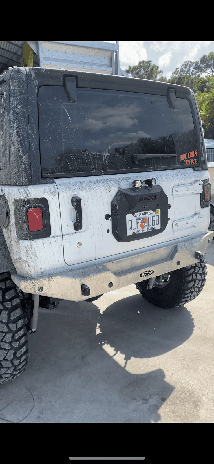

Next addition was the Gen right aluminum rear bumper with their LED back up lights. The rough country spare tire delete with two Baja designs S1 pods. As well as the next venture motor sports flush mount tail lights.

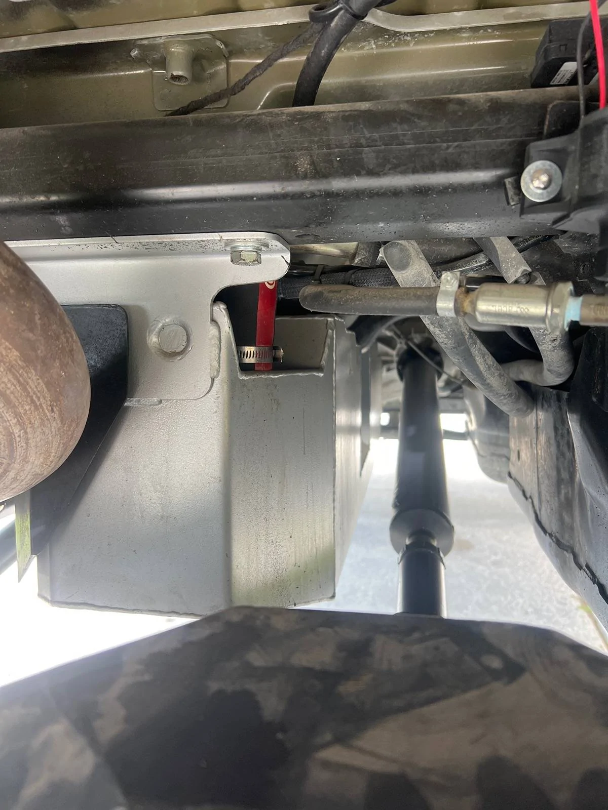

Also added was the long range America fuel tank for an extra 17 gallon capacity
Jeep Wrangler JL My 2021 JLU build thread imag
Jeep Wrangler JL My 2021 JLU build thread 68481248905__831C3BD7-73C7-49C6-816B-AC041909BD05

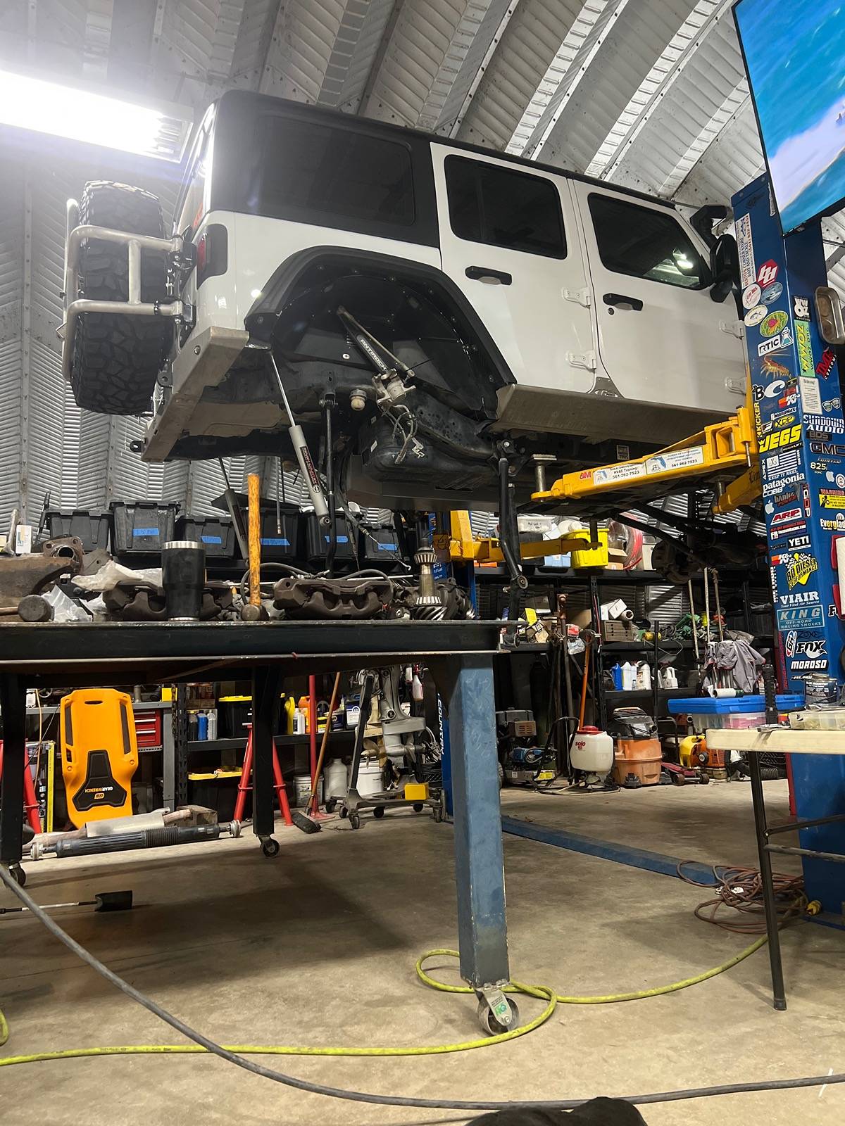

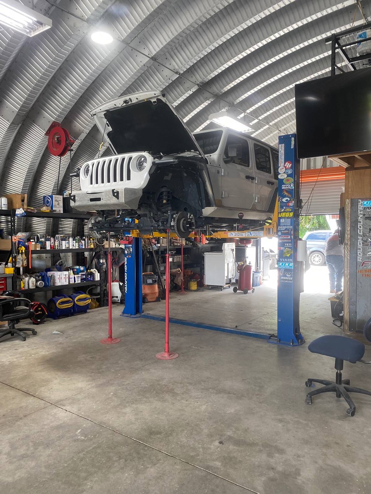

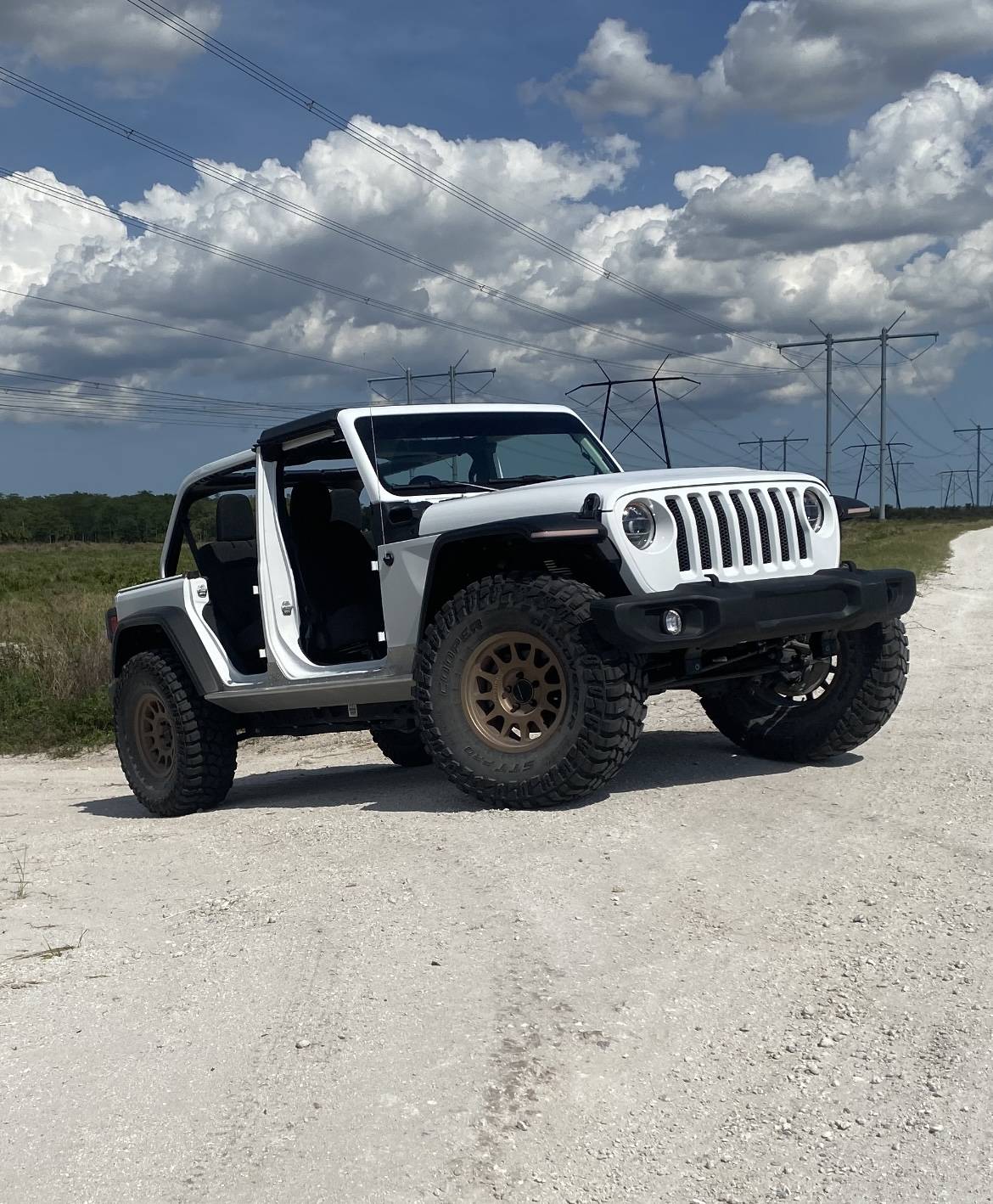

I used the artec jl one ton swap kit for the dana 60 front and gm 14 bolt rear, with the 14 bolt tone ring and modified jk 14 bolt wheel speed sensor bracket. I have arb air lockers front and rear with 5.38 gears. The rear axle flew together the truss kit was stupid simple and just bolted right up. The front axle had a few more pieces and had to be placed in the jeep for fit up to set caster and UCA angles.
In the front end im using reid racing knuckles with skys offroad steer arm, artec one ton aluminum steering links with a PSC hydro assist kit. ( I had two of the psc hoses that came with the kit blow apart as well and one that was way too long. For safety and piece of mind i had them all remade.) The dana 60 front cover is from moto built.
In the rear i have a 14 bolt shave kit from TMR Customs which gains 1.75" of clearance.
Tom Woods for the custom 1350 driveshafts, they got them done insanely fast.

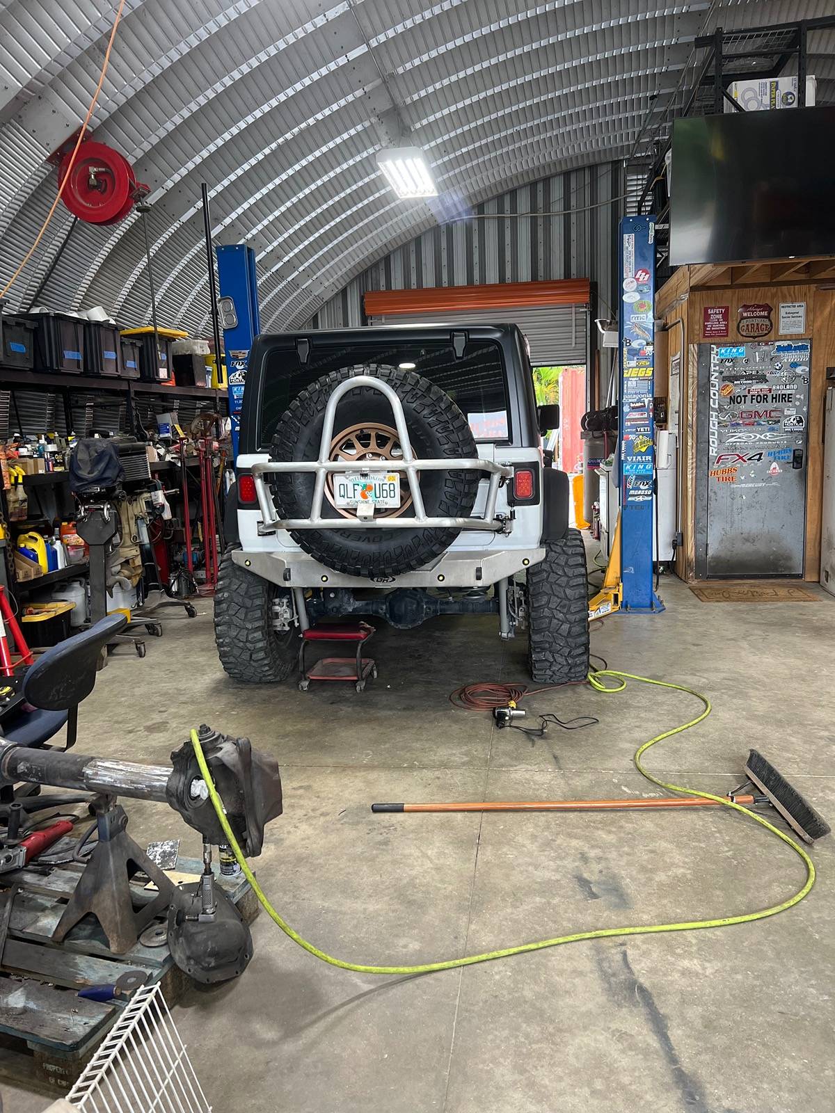

I also upgraded the battery to an optima DH7 size which fits in the factory spot with removing a spacer in the battery tray, as well as removing the aux battery.
Somewhere in the timeline i installed rock jock sway bars front and rear.

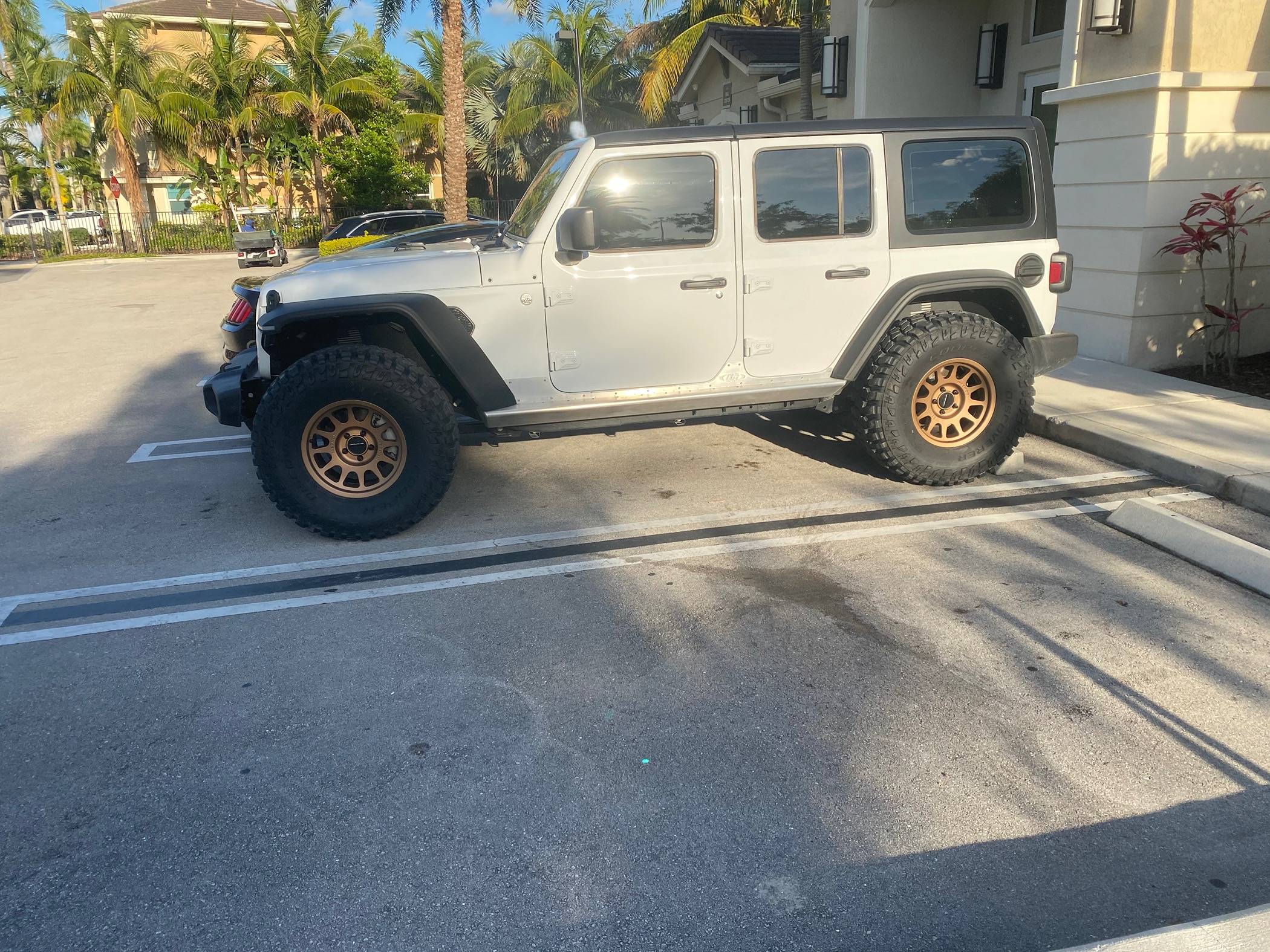

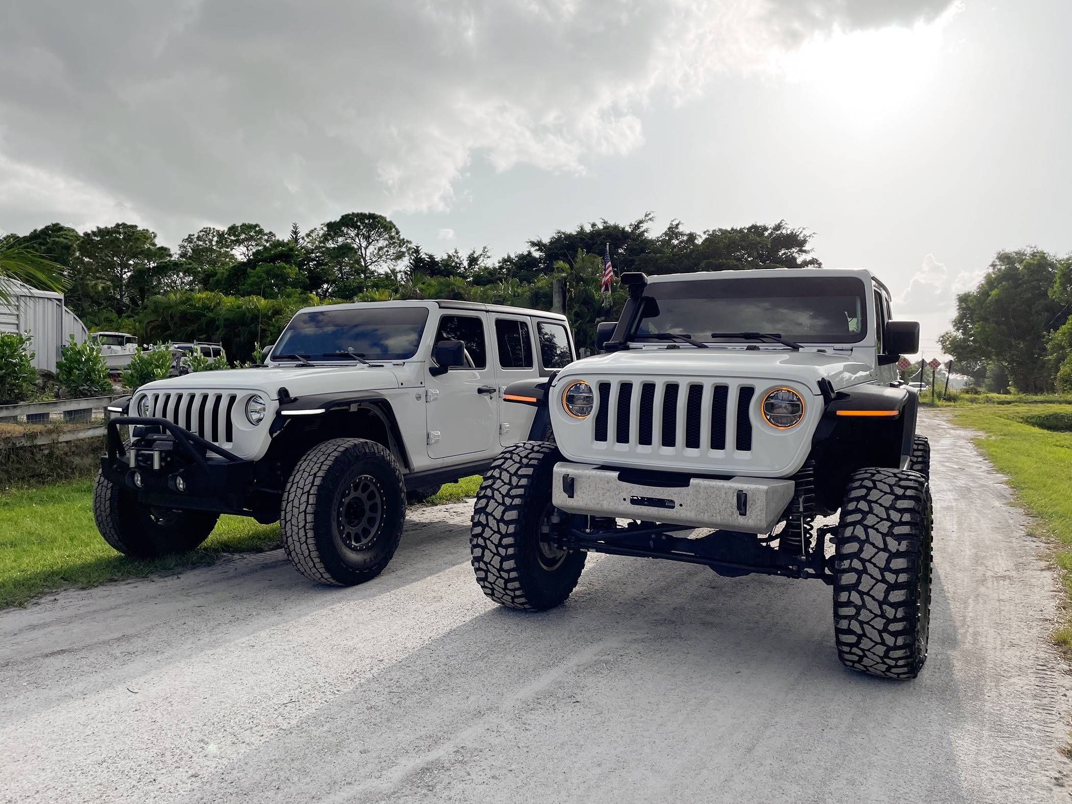

The jump from 37/12.50r17 to 40/12.50r17
Jeep Wrangler JL My 2021 JLU build thread 68479130502__3188C1C2-36DF-4711-B55F-0BE7D148C571
Heres the first time out of the shop and first time home.

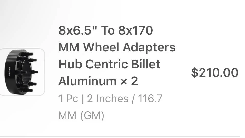

- did you go with 8x170 or 8x6.5 wheel lug pattern?... how did you solve the discrepancy in
wheel pattern (Dana 60 8x170 vs GM 14 Bolt 8x6.5) ??
Rig looking great! Thanks!
I looked for probably a little over 2 hours for them to no avail, I think the name is on the tone ring I’m just going to have to pull the rotor off to find out.
Real slick set up tone ring presses on the outside of the unit bearing, bracket blocks off factory wheel speed sensor hole and holds the jeep one.
I used 2” spacers and they were 8x6.5-8x170

I thought about going to 8x6.5 in the front just for ease of finding a spare wheel and tire anywhere on the trail but for ease of replacement parts and keeping things “factory” I kept the unit bearing knowing I can go just about anywhere and get one.
