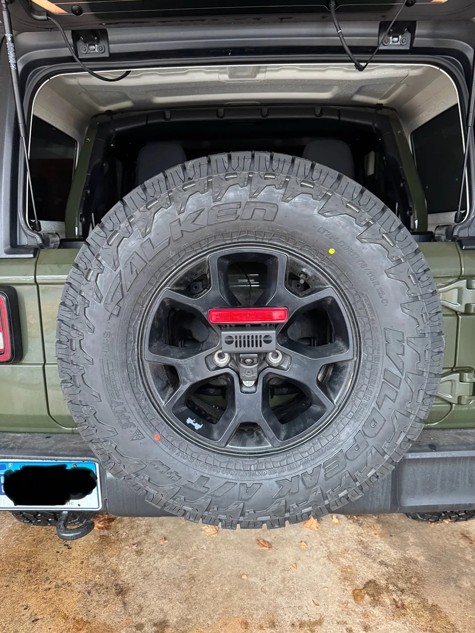

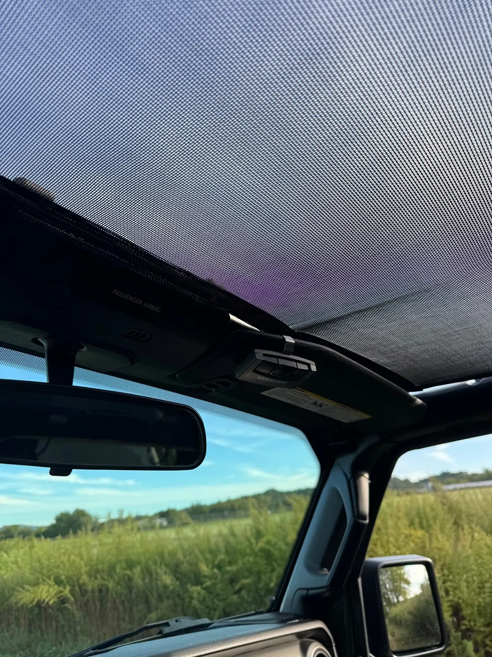

I wouldn’t consider these mods. More like accessories. Picked up a shadeidea sunshade from Amazon so my ghostly white ass deosnt get burnt and got the mopar center mount brake light.
Edit- also got the mopar grab handles.

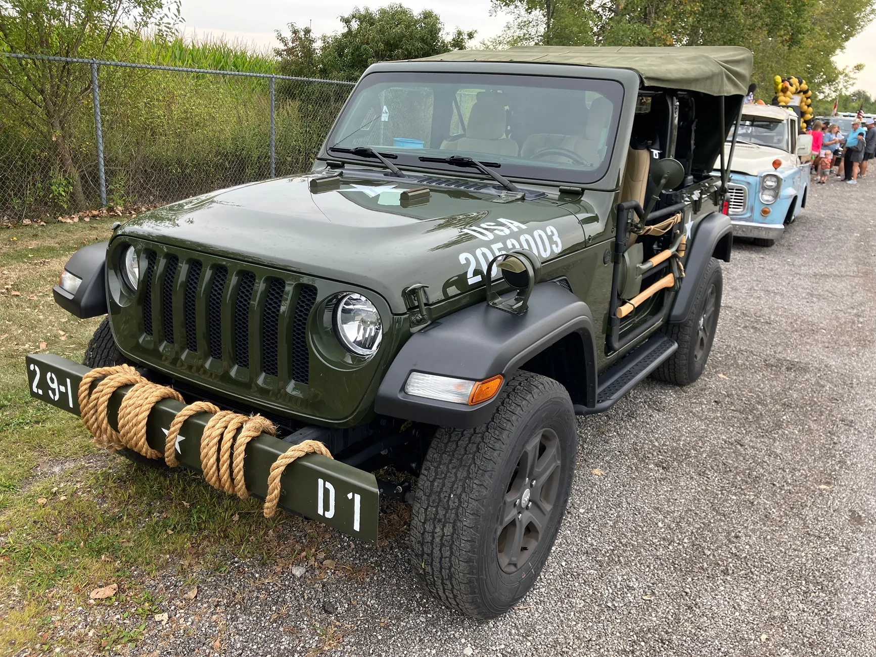

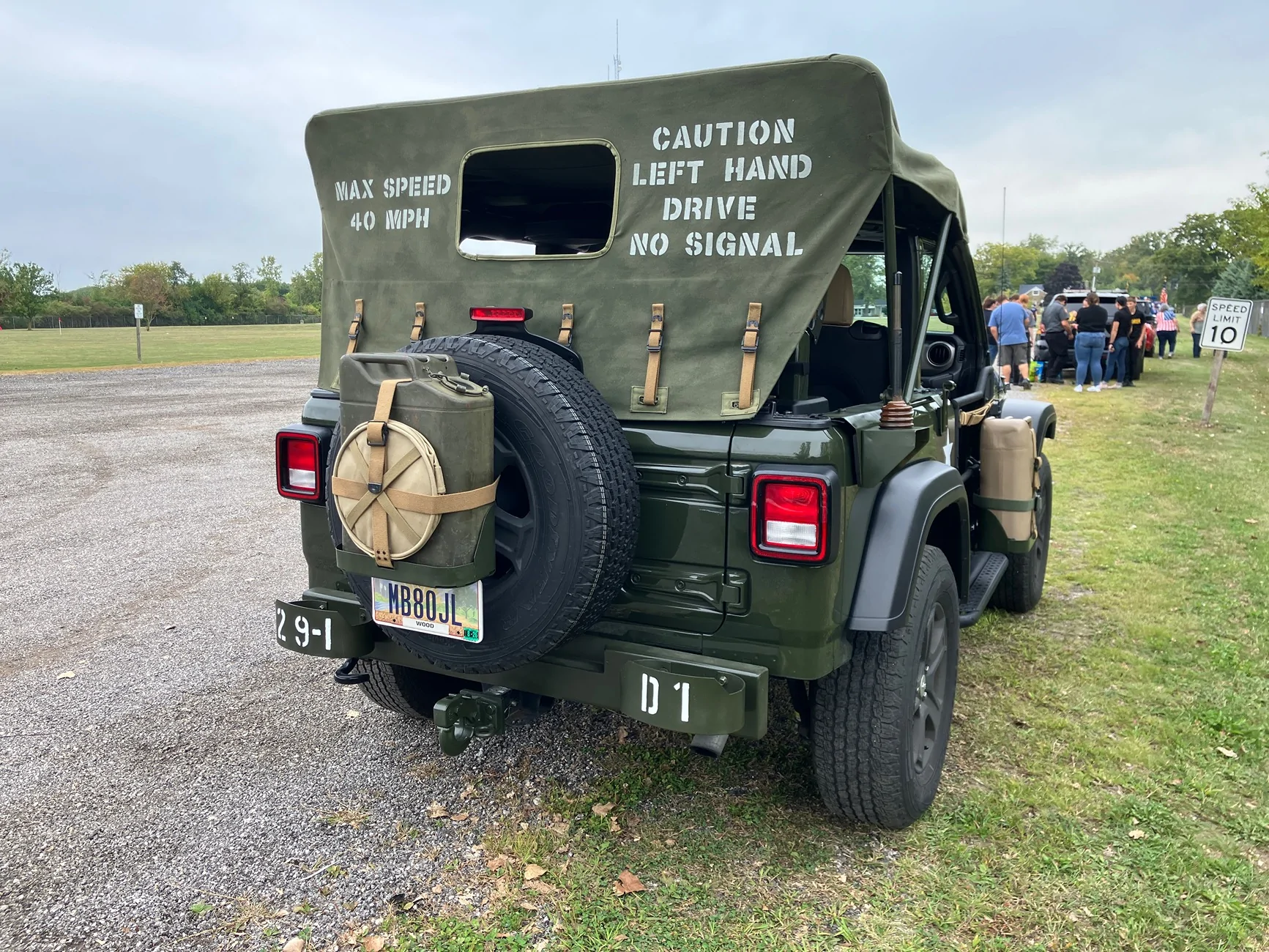

Dig the bumpers and the whole rig, you need some steel wheels in sarge green now.
Swap out the plastic bumpers for an original front bumper and rear bumperettes.
Any significance to the serial number you chose for the hood?
