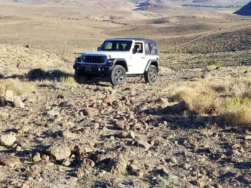

Friend of mine took me for a few rides in her SxS to high desert BLM trails
which we are surrounded with for miles on end and I got hooked.
So I bought me white 2025 Wrangler 2 dr sport last month for my 70 birthday.
So far I got 650 miles on it and pretty much all of it is off-road.
Jeep Wrangler JL Must do MODS for first time owner 11

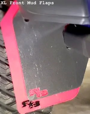

Jeep Wrangler JL Must do MODS for first time owner Mud Flaps

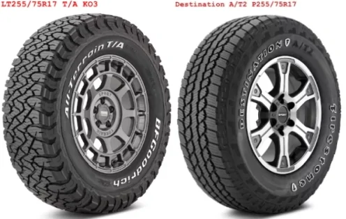

Can't decide on tires yet but have 2 in mind
Jeep Wrangler JL Must do MODS for first time owner Tires

I would pass on both those tires you mentioned, Firestone are total garbage IME, BFG not much better especially these days with so many newer options.

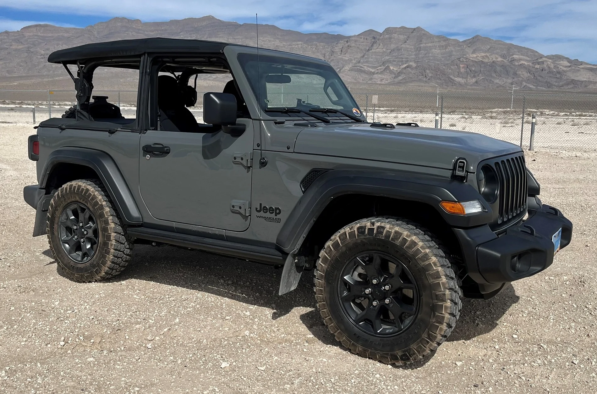

Didn't realize you were a fellow Nevadan until I saw your photo! I also have a 2-door Sport and it does very well in the desert, even in stock configuration. Adding the Antirock swaybar just makes it easier to enjoy a more comfortable ride.
Also important to note that the standard RokBlokz flaps work perfectly, and you might only want the XL size if you plan on installing wider tires and/or wheel spacers. In any case, I hope to see you out on the trails and happy Jeepin'!
Jeep Wrangler JL Must do MODS for first time owner IMG_5592a

Thanks for the advice on RokBlokz flaps 👍

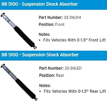

Bilstein are digressive damping, Fox are progressive do a search and read to see what you prefer, I'm leaning towards progressive damping for mine. Yes use them with stock springs as long as buy the 0-1.5" lift Fox or Bilsteins.
Shock tuning info, good reading but I'm just going with Fox 2.0 or Bilstein 5100 non-reservoir nothing fancy, but that's available:

Mickey Thompson Baja Boss AT
265/70r17 or 32x10.50x17 are about 32" tall
https://www.mickeythompsontires.com...NXArXJAHun3hX0use8Oiv0UL4CPpZSGhoCsHkQAvD_BwE
BFG KO3 AT 255/75r17 are about 32" tall:
https://www.americastire.com/buy-tires/bfgoodrich-all-terrain-t-a-ko3/p/157566

Shock
Jeep Wrangler JL Must do MODS for first time owner 01

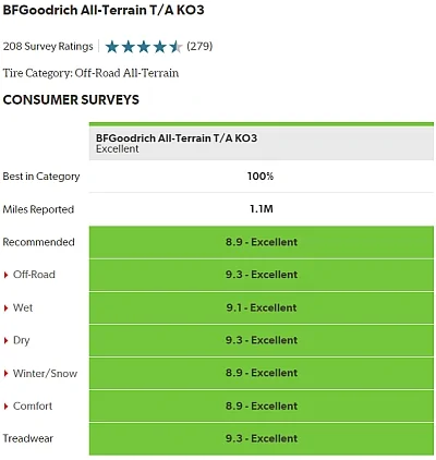

They have a high rating on TireRack
Jeep Wrangler JL Must do MODS for first time owner KO3
BTW, TireRack has a warehouse about 30 min from where I live, and if I drive there to pick them up I'll get $40 off from total price.
