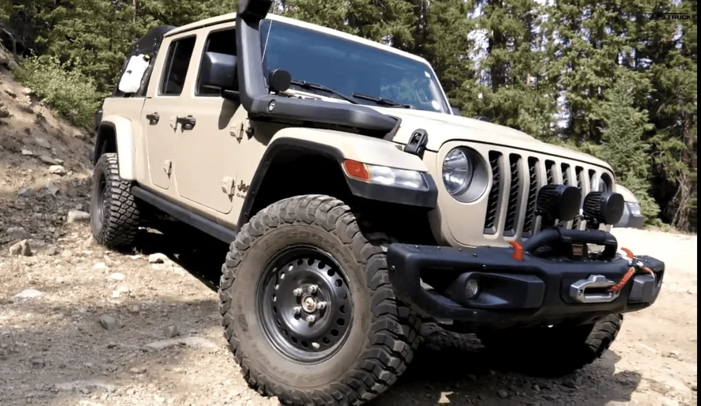

That's so awesome you got to include your daughter in the build! I bet she loves it.
Yeah, it was late nights for about 3 weeks to sew this together. It’s partly hidden in this picture by the B/O light, but my hood number (which follows the format for Jeeps in WWII) contains my daughter’s birthday 05-30-03.

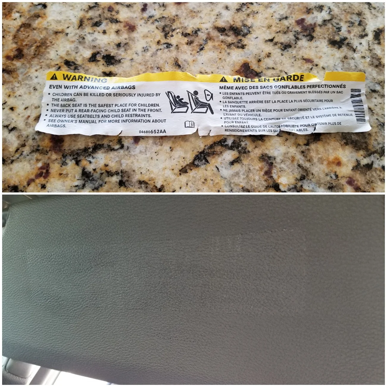

I've posted this in other threads... This is probably my favorite FREE mod. 🙂
Jeep Wrangler JL Must do MODS for first time owner {filename}
Doing this next haha just heat gun and peel?
I used a hair dryer. Peel the sticker slowly at 180° while continuing to apply heat. It will come off. The visor vinyl will "pucker" a little but it will quickly tighten up.
