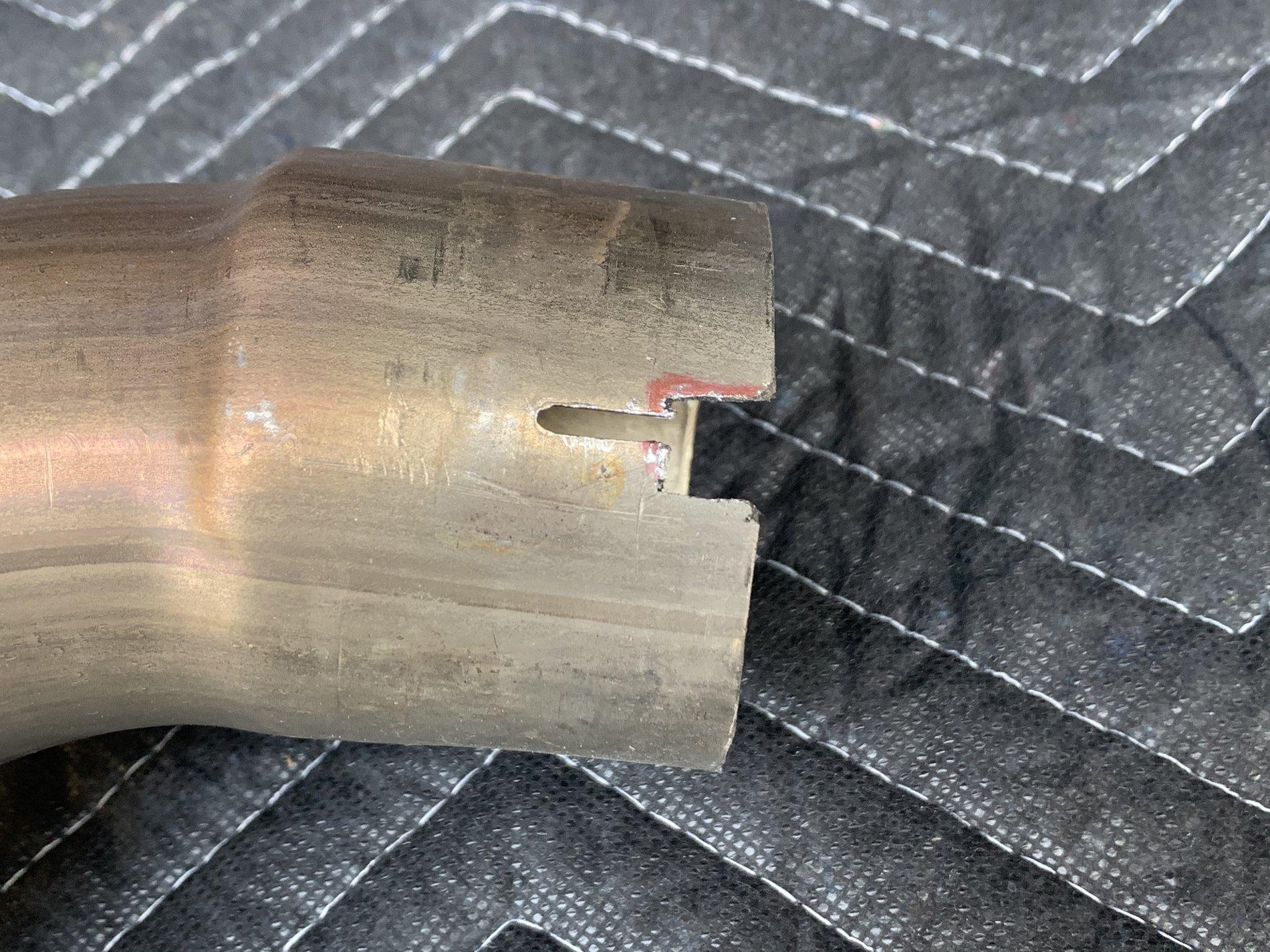

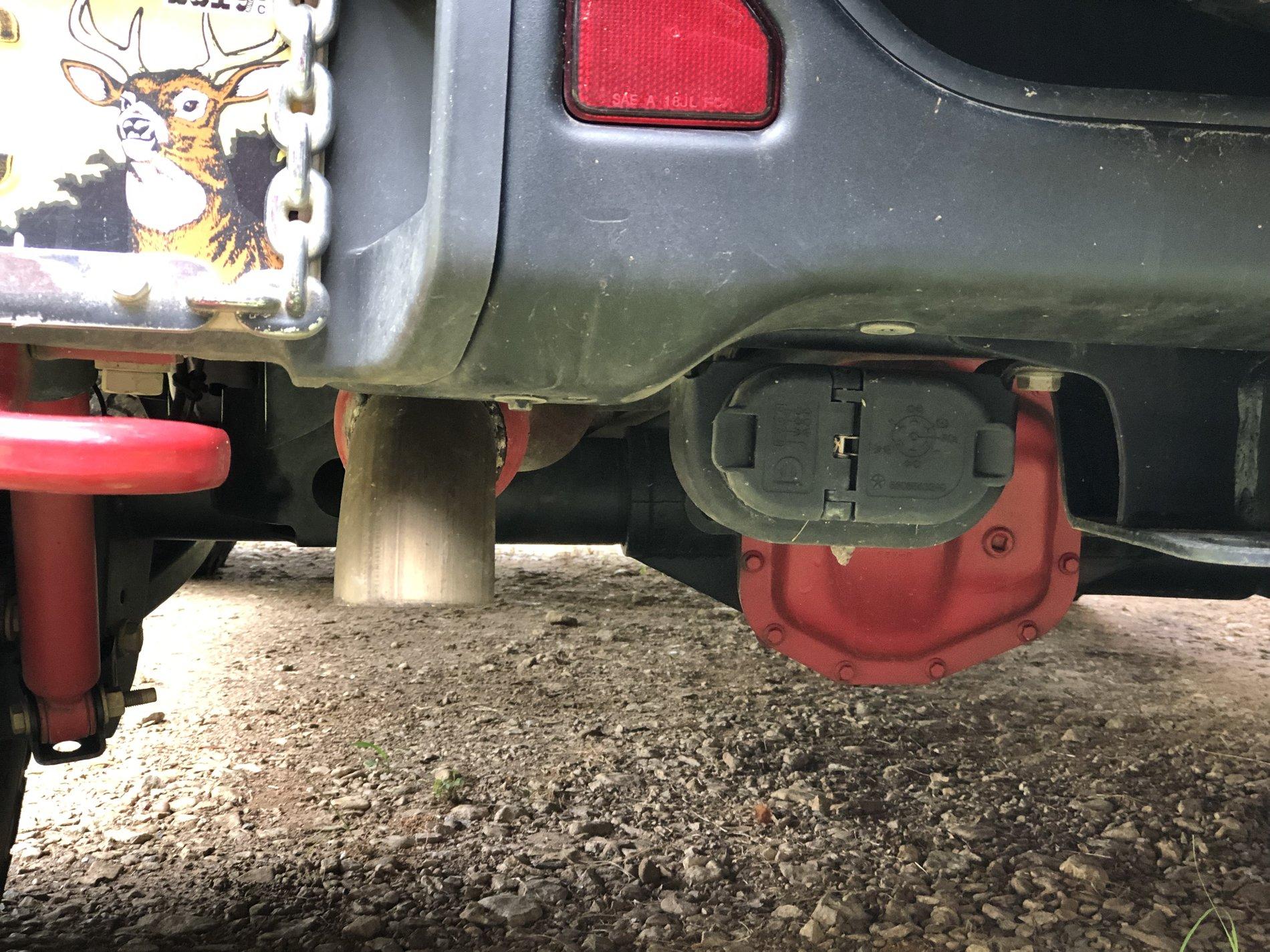

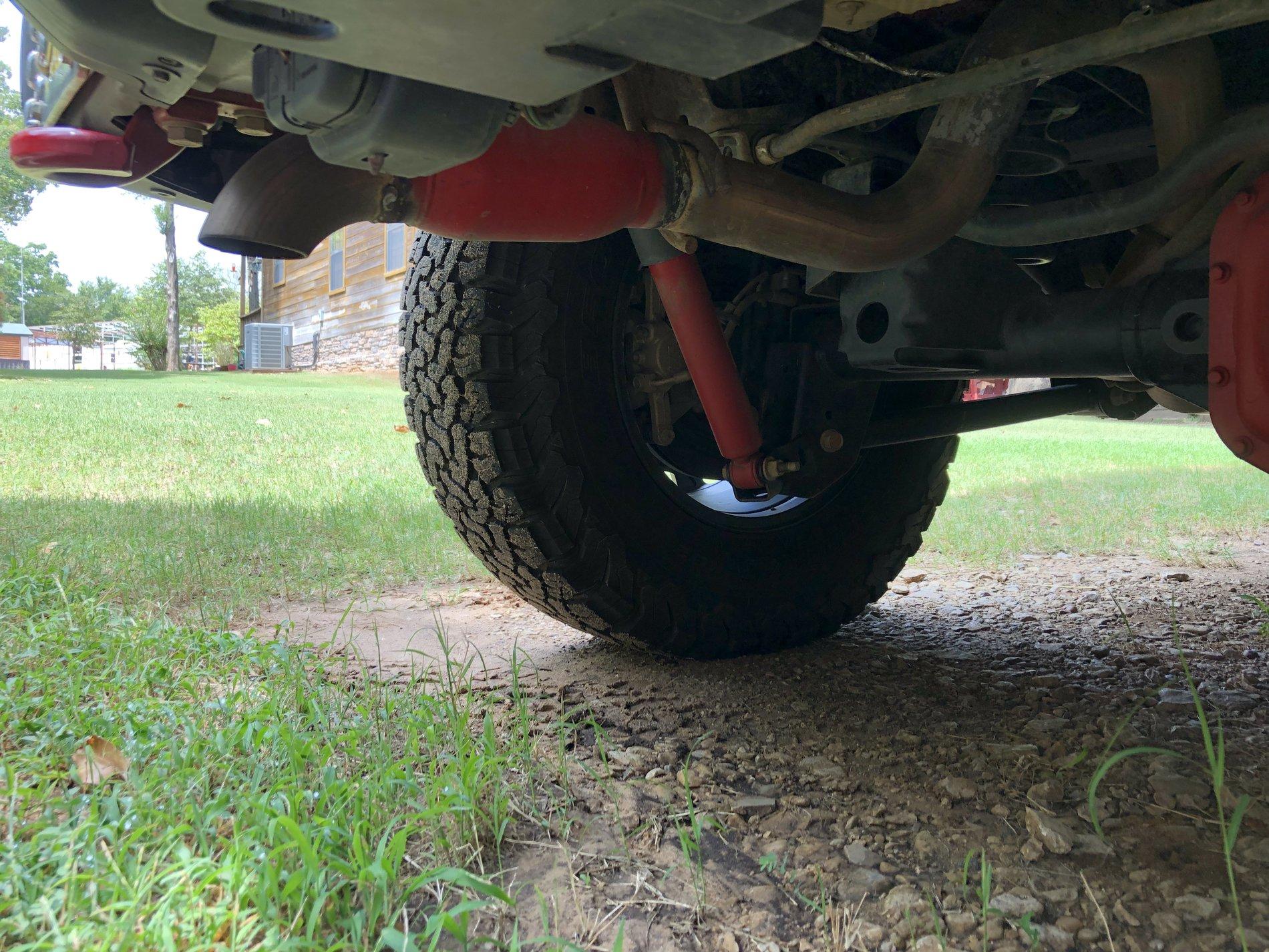

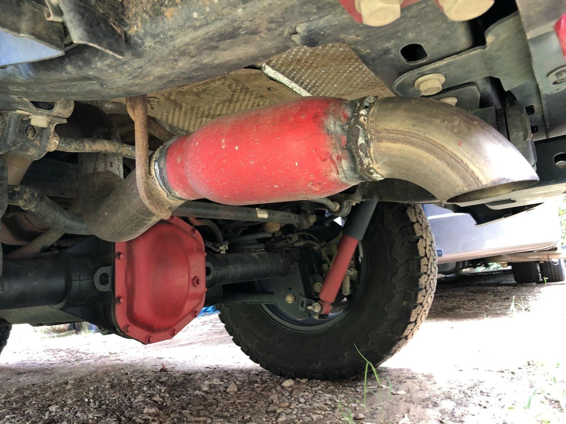

Seemed like it had a bit of a vibration type hum prior to notching and sliding it up that extra 3/4", but it's been awhile so I can't recall 100%, but I do believe it was an improvement.
Well, since the last time . . . Thank you!
Today, I finally got back under my Jeep and removed the Dynomax piece. I made a 3/8” notch and reinstalled it. That made a huge difference in the exhaust note for me. Prior it had a high pitched tinny noise, so to speak, at higher RPM. I may have had an exhaust leak. Now, it’s a nice low mellow tone. It is louder. However, it was the higher pitch that I was not pleased with.
