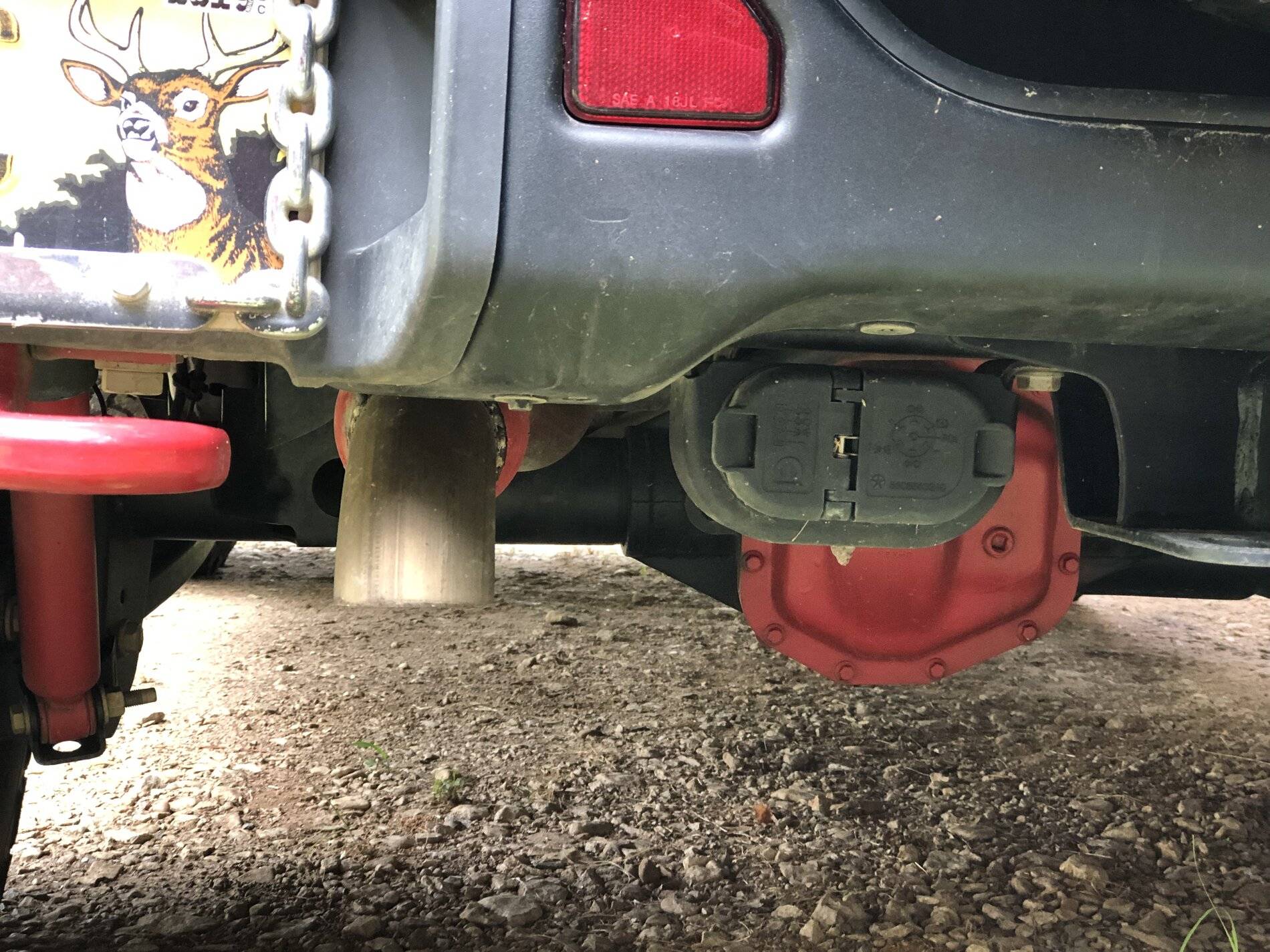

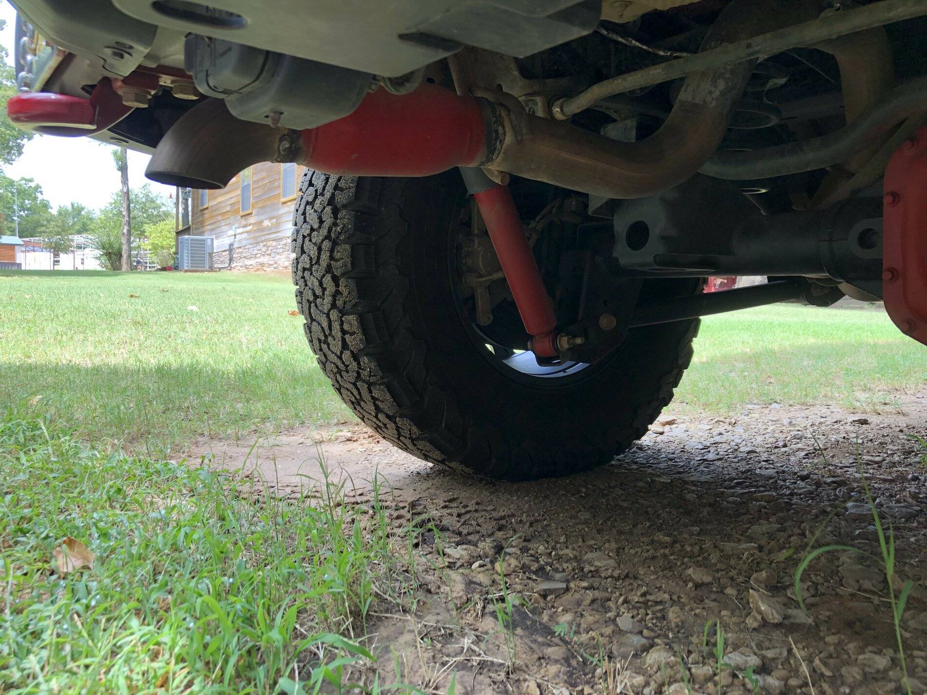

Just suck it up and get the @DynoMax Exhaust muffler delete already :bandit:
It's inexpensive enough that if your tennants complain you can remove it and pass it along to someone else(we could use another one for my wife's Jeep) or weld in another resonator after the factory one.
