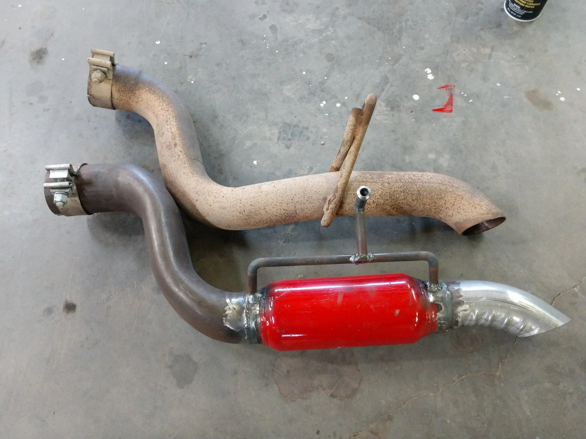

Thanks to @Jimac for the inspiration here. While Jimac modified a Dynomax delete pipe (I believe), I opted to sort of start from scratch. I've been running a Dynomax delete but the goal here was to just slightly mitigate the drone. The irony is that I've been running it long enough I honestly no longer notice the drone, but I decided to proceed with this project for fun.
Before I scrapped my stock muffler I cut off the inlet pipe. Then I grabbed a 12" Cherry Bomb from Amazon. I actually paid $20 via AWD (Amazon Warehouse Deals). For the turn down at the end I sourced a Nickson 45 elbow at O'Reilly and cut it up. You can buy proper turn downs but they're surprisingly expensive and this Nickson 45 was sub-$7.
Cherry Bomb via Amazon:
https://smile.amazon.com/Cherry-Bomb-87522-Glasspack-Muffler/dp/B003E5P7EW
Nickson 45:
https://www.oreillyauto.com/detail/...720295382/nickson-exhaust-pipe/548755/4538077

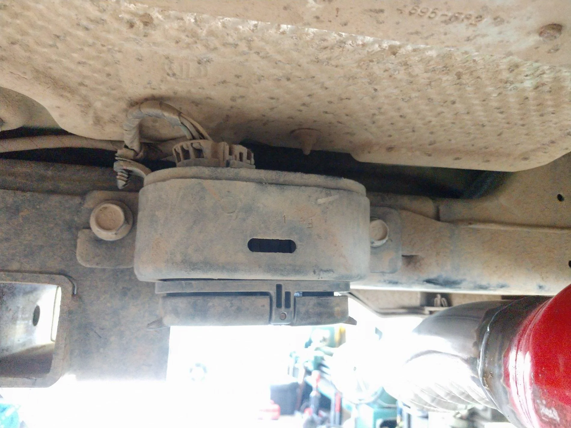

One advantage of a proper delete pipe is that it steps to the drivers side slightly, making room for the trailer wiring. My concoction is more straight back and wanted to interfere, but I simply relocated the trailer plugs (I've seen other users do this, too). I utilized one of the existing hitch bolts and then created a second hole of my own.

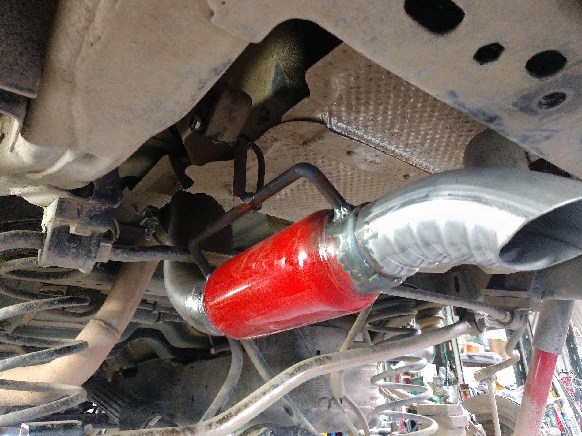

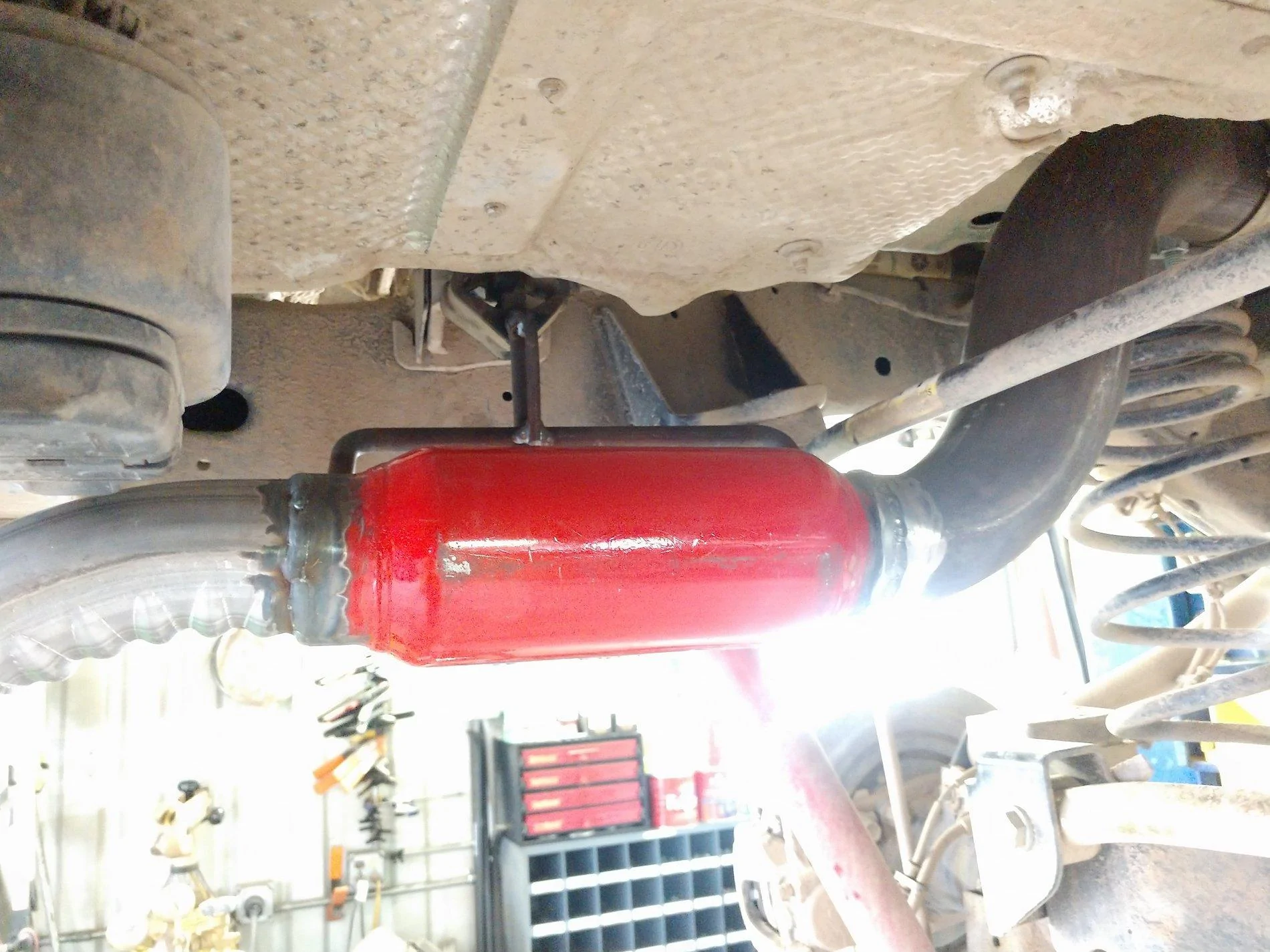

I was concerned about welding directly to the body of the glasspack for fear of potentially accelerating the eventual demise of the packing, so I opted to "bridge" over for my exhaust hanger. The portion of my hanger which engages the rubber hanger at the frame is a 1/2" button head cap screw with the head turned down.

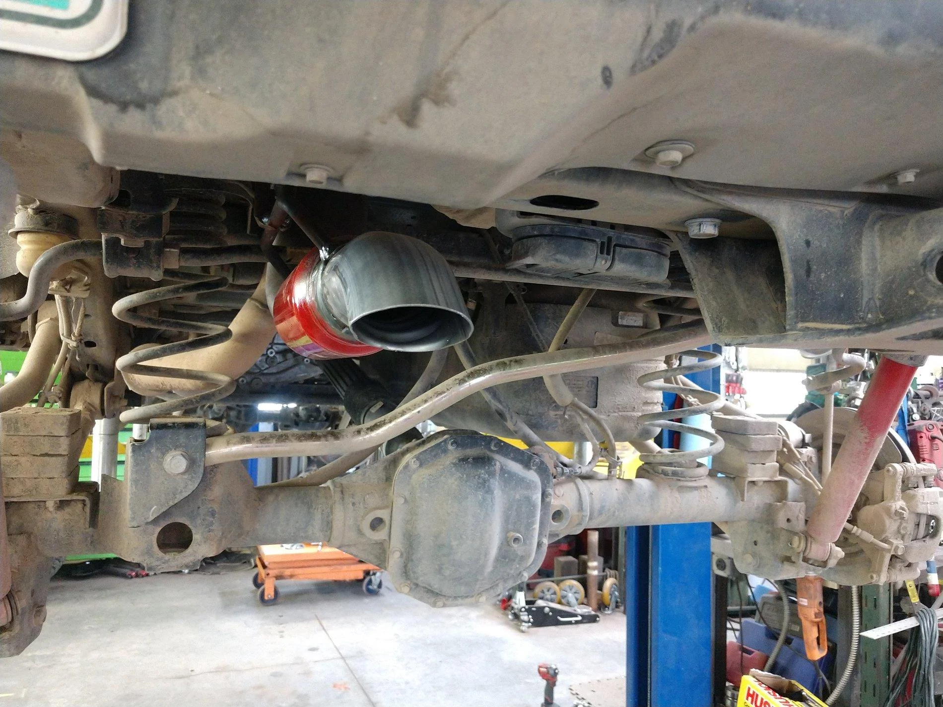

Finally had time to drive it....with all the windows up there's still definitely a drone. Is it better? Yeah, probably a little. Like I said, I had gotten so used to it I now have to force myself to listen for it.
I would say it has softened the "fart car" wanna-be-street-racer harshness under heavy acceleration, so that's good.
Was it worth it? Meh, probably not for most. It was worth it for me 'cause this is how I have fun.
