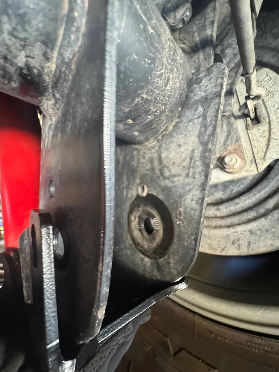

Yeah I was just climbing around underneath doing some cleaning and checking things out. I'd agree seems like the rear lcas are also pretty low on the back side. Protecting that area and the shocks back there seems like a pretty good investment as well. Which skids did you go with? I was looking at metalcloak because tbh they look badarse but the diff skids appear to be only for rubis?
I''m happy w RH4x4 LCA skids

It won't be the most popular, but I like how Artec LCA skids are the most minimalistic. They're more like a mount reinforcement than an add-on ski. I think that LCA skids become more important as wheel offset is further away, but for stock-ish offsets these should be able to prevent some damage without additional weight or loss of clearance.
Jeep Wrangler JL Most important under armor? IMG_3623
Rancho's red snow skis for reference

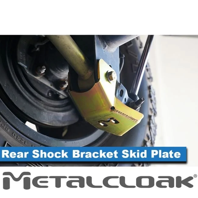

And I don't understand why Metalckoak would put their logo on the part of the skid plate that does the skidding... especially when Next Venture goes to the effort of putting UHMW in the same spot.
Jeep Wrangler JL Most important under armor? 2-jl-wrangler-rear-shock-bracket-skid-plates-1-jpg
