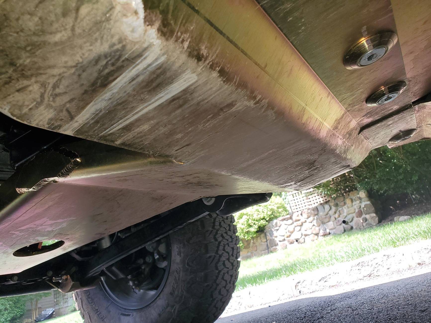

In my view the oil pan and the exhaust crossover area are both exposed and will lead to a bad day if you hit hard enough.
those would be my primary focus areas.
Case in point how my skids look over the exhaust over area on a rocky trail and yes I was picking my lines carefully

The oil pan definitely seems to be a popular choice as well. I did some searching and most of it is listed for the 3.6 not the 2.0. Not sure if they're interchangeable or not?

Don't think they are interchangeable as they bolt onto the engine mounts.
