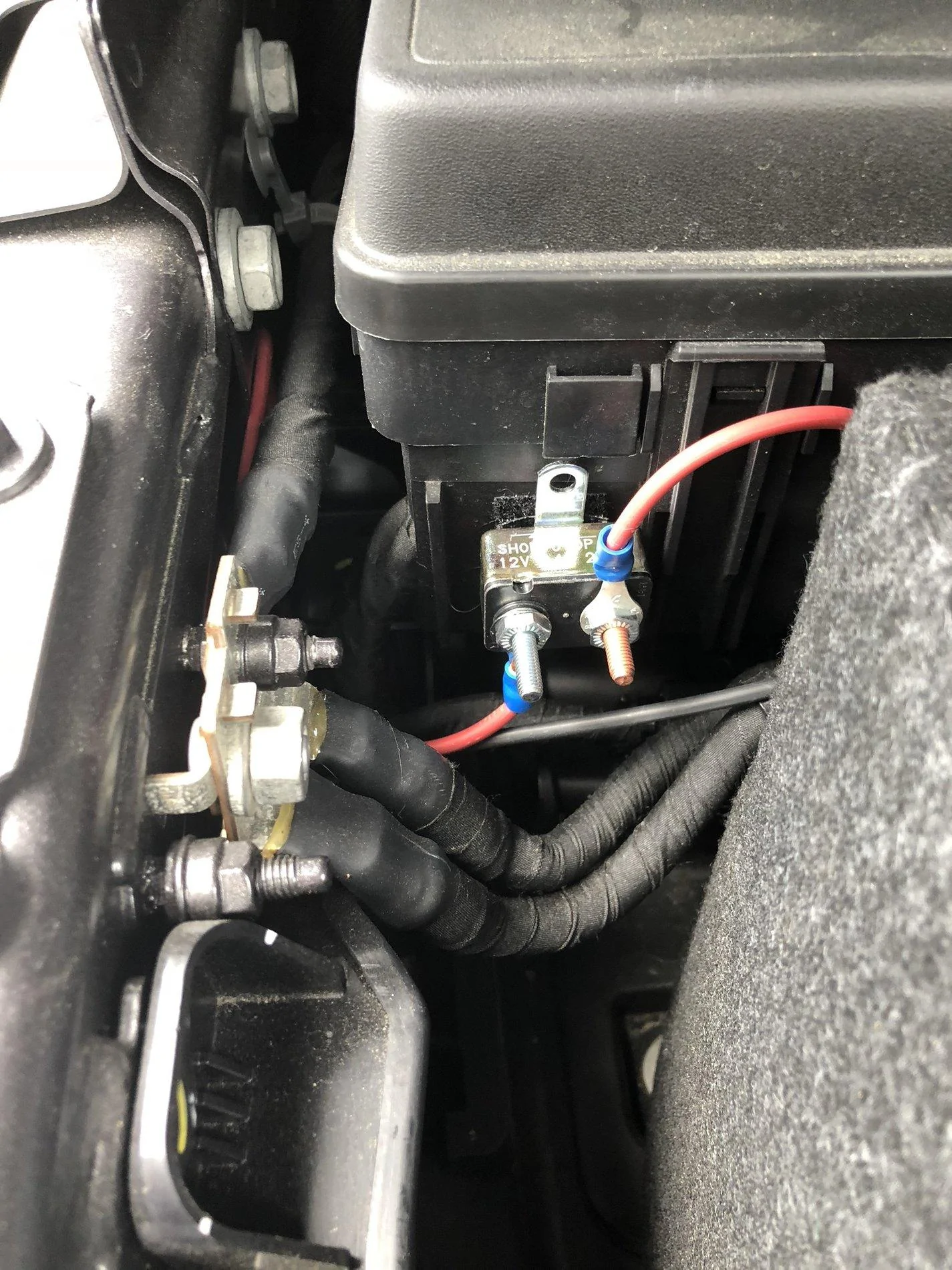

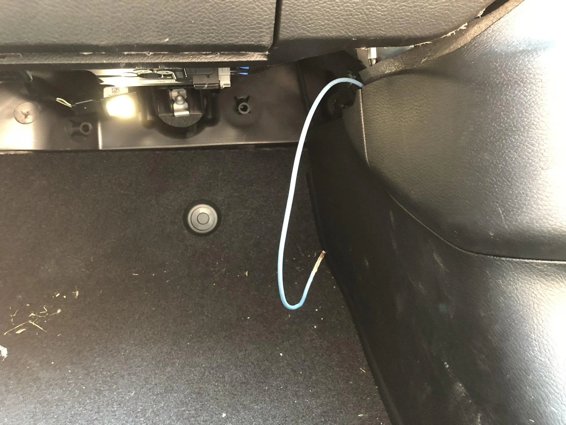

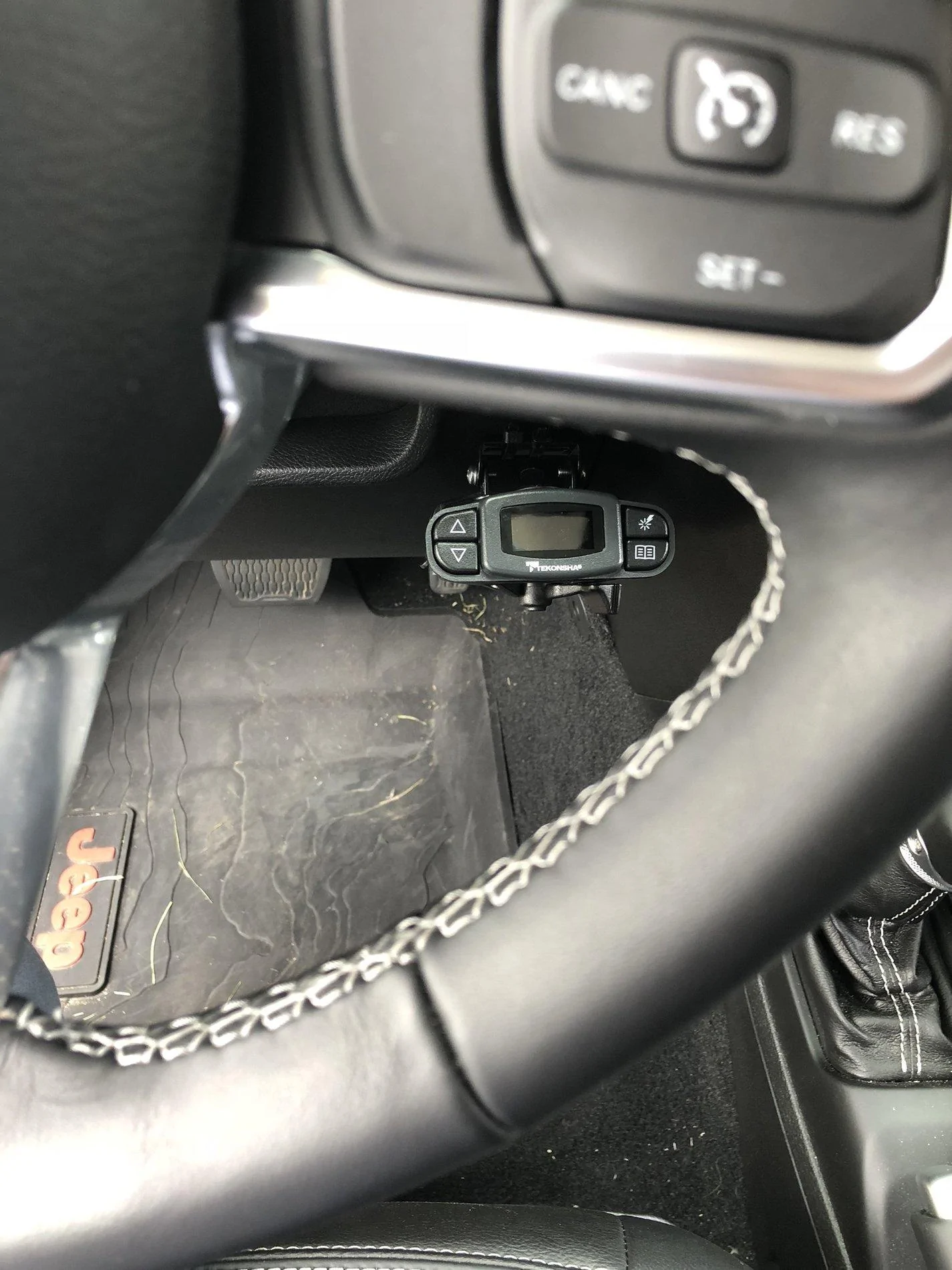

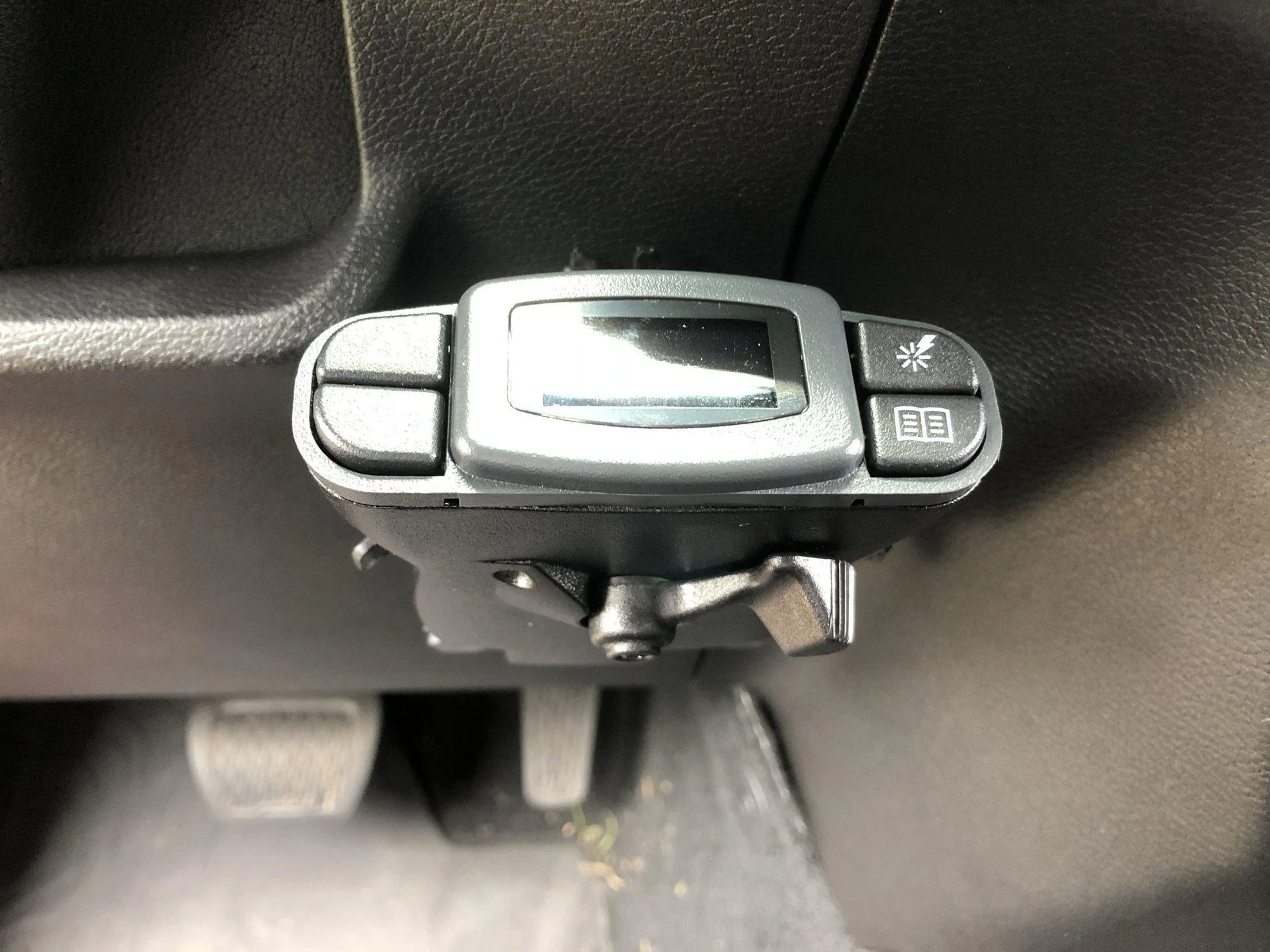

Added a brake controller this weekend. Without the tow package, the most difficult part is getting to the wire from the brake pedal, but the rest is straight forward.

Blue wires seems too short to reach the drivers side. Did you have to put an extension to it?
Yes, I extended the wire over to the controller. Ran the hot and ground to the battery through a 20amp auto reset circuit breaker.
Did you happen to take a picture of the location of the brake pedal wire?

Still haven’t been able to figure out the brake controller. There is an assumption that the brake pedal signal wire is not 12v causing it to not activate the trailer brakes when the brake pedal is pressed.
