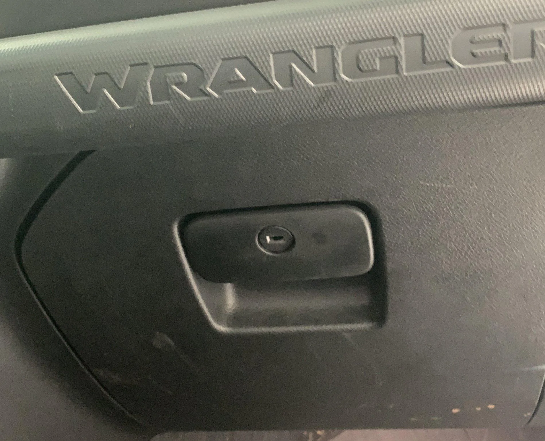

Step 1 - Locate your glove box and open it:
(It’s dirty, don’t judge me)

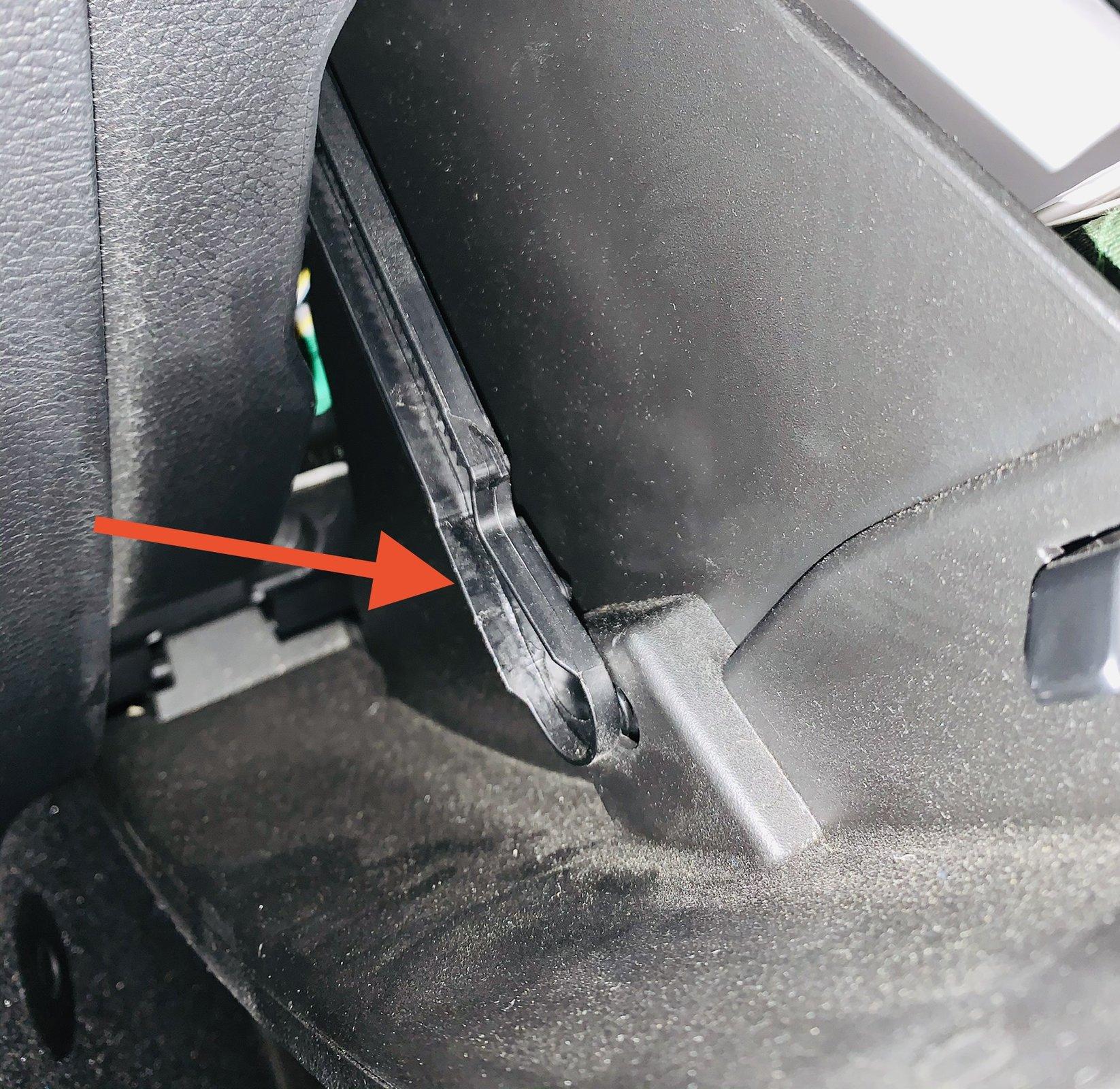

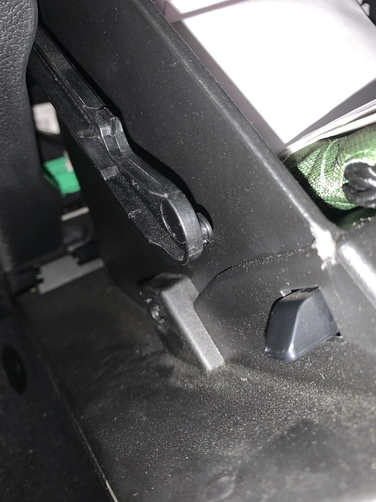

Step 2 - Locate the Soft Open Support located on the LEFT side of the globe box.
Push UP until your hear a loud click, once you’ve heard the click pull OUT AWAY from the glove box GENTLY.
Move the soft open support up and out of the way as shown below:

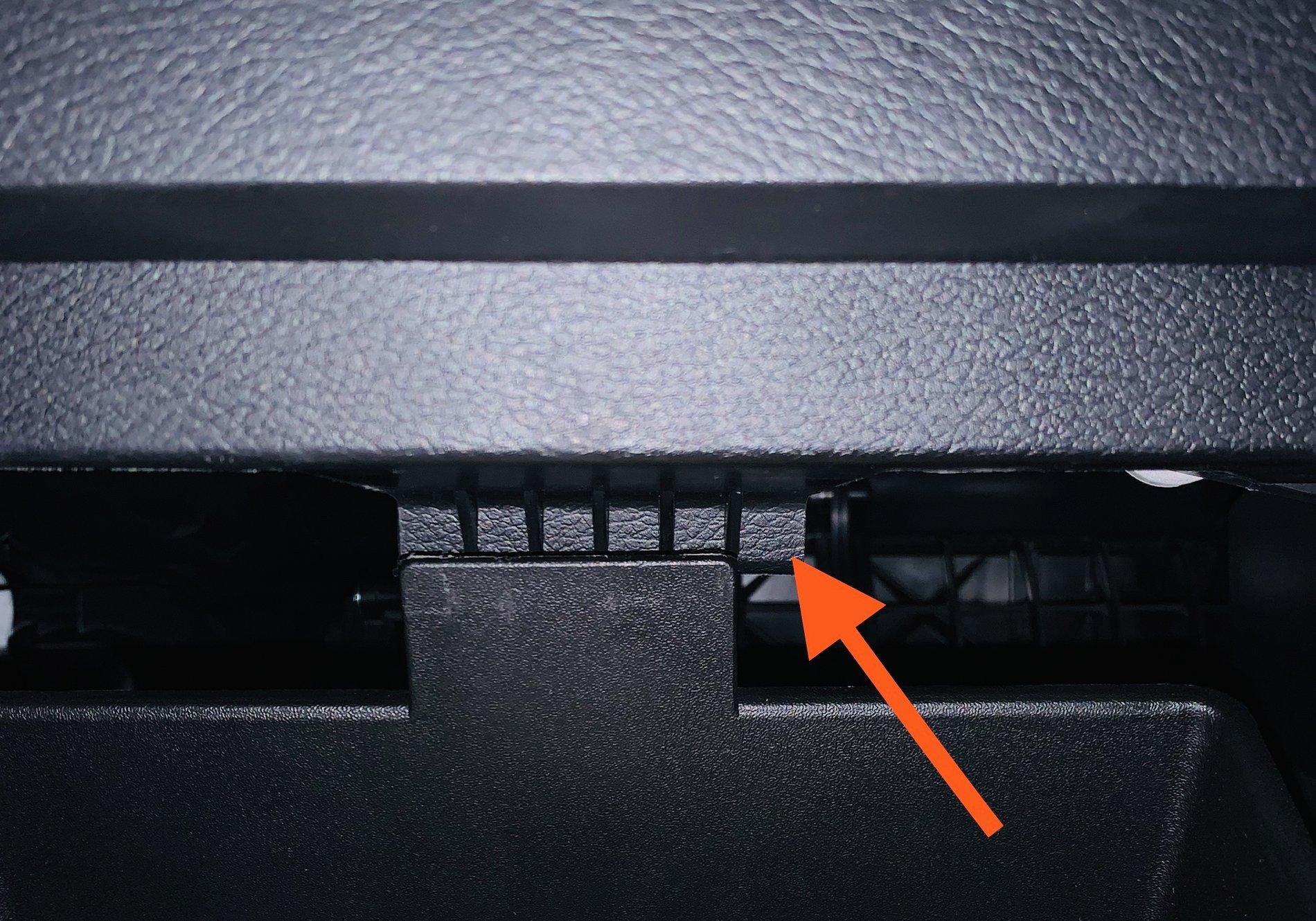

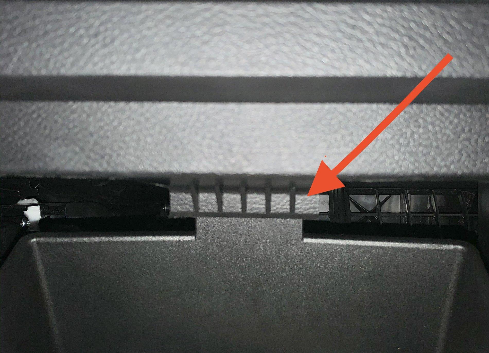

Step 3 - Locate Retainer Tab at the top of the globe box.
With your left hand hold and slightly push the glove box towards the closed position and with your right hand push UP on the tab. Once the tab is pushed UP your glove box can be removed freely.

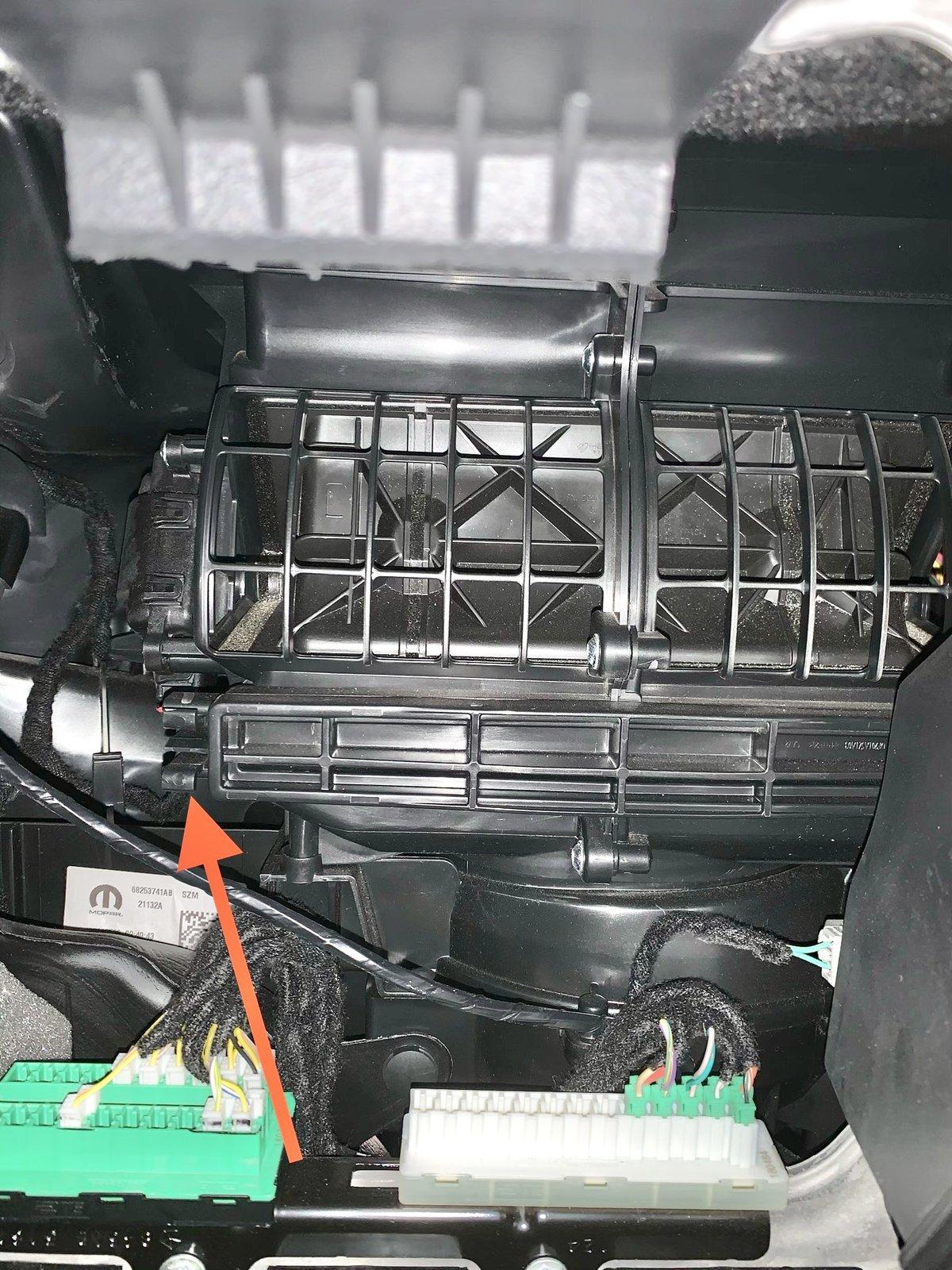

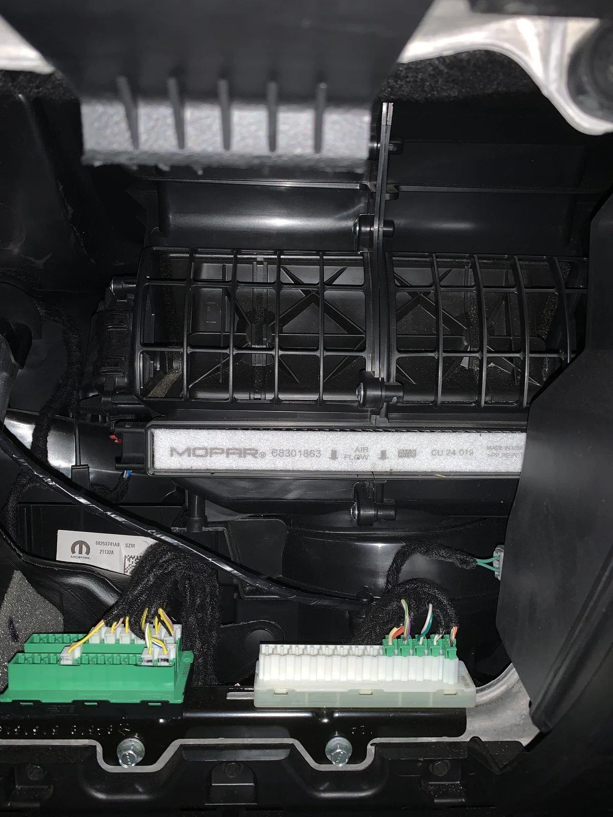

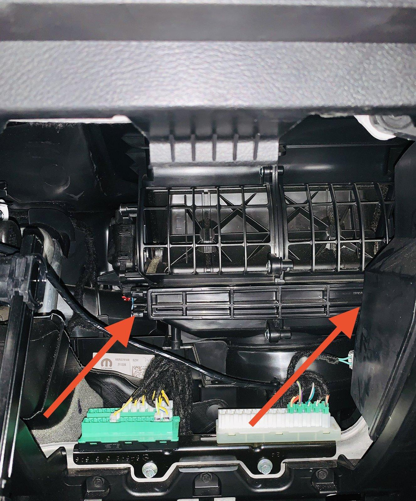

Step 4 - Locate the HVAC Access Door, Pinch Clip and remove:

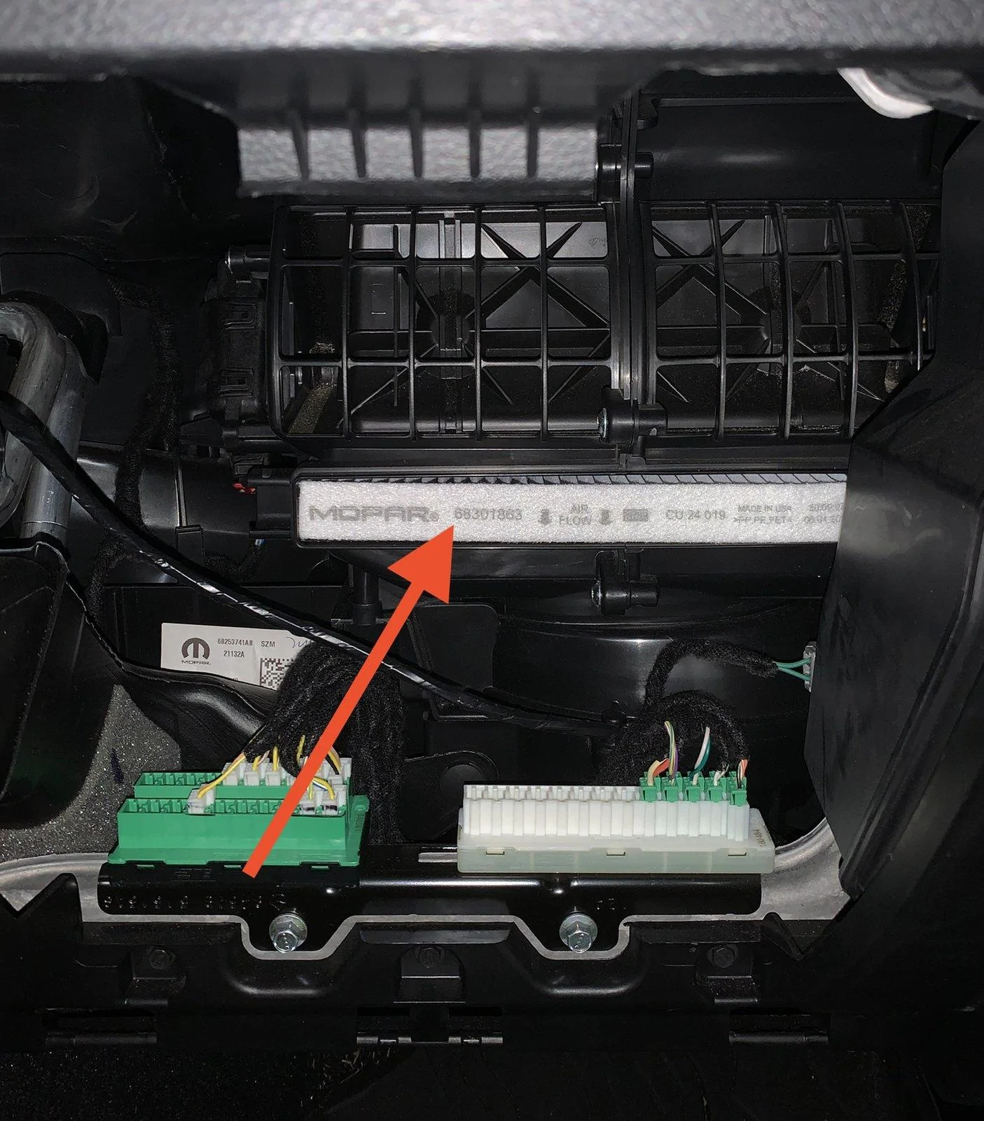

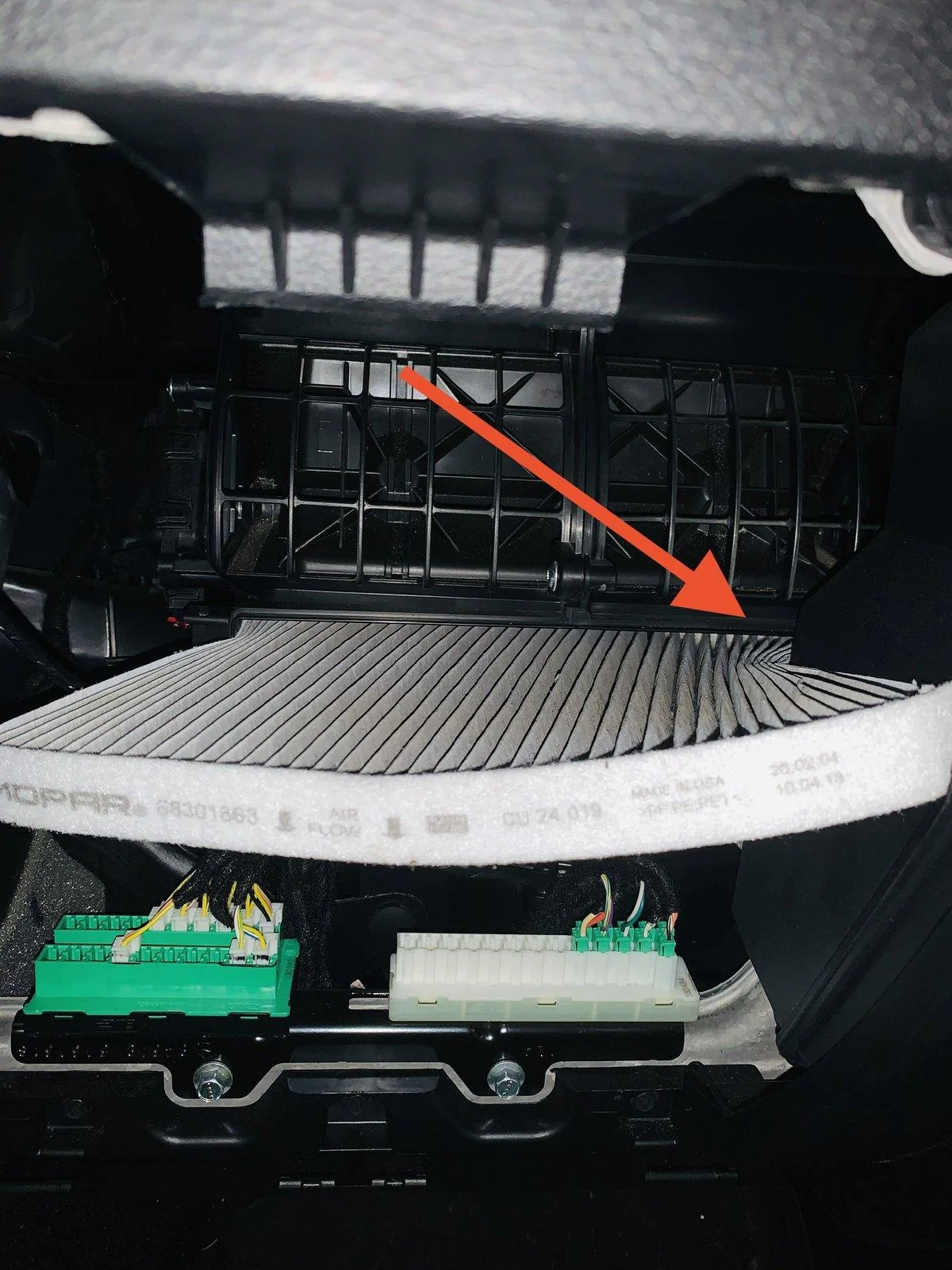

Step 5 - Remove Cabin Air-Filter by slightly pinching and pulling. It’s accordion design will allow you to do this:
Step 6 - Grab your new Cabin Air-Filter and insert into the empty compartment you just pulled the old one out of. AGAIN it’s is OKAY to pinch/bend it to get it in the compartment due to its design.

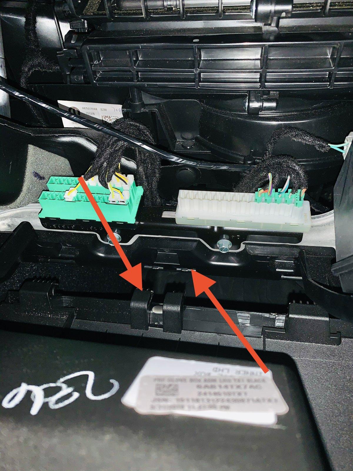

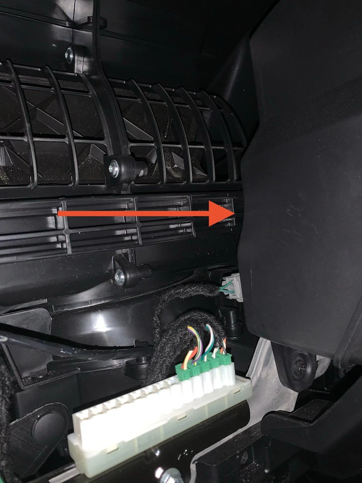

Step 7 - Reinstall the HVAC compartment Access Door. On the LEFT of the Access Door there is a clip you must pinch (just like you did when you removed it) AND on the right side of the Access Door there is male end that must be inserted into a cutout around that corner. You WILL be able to accomplish by feel as you cannot see it physically.

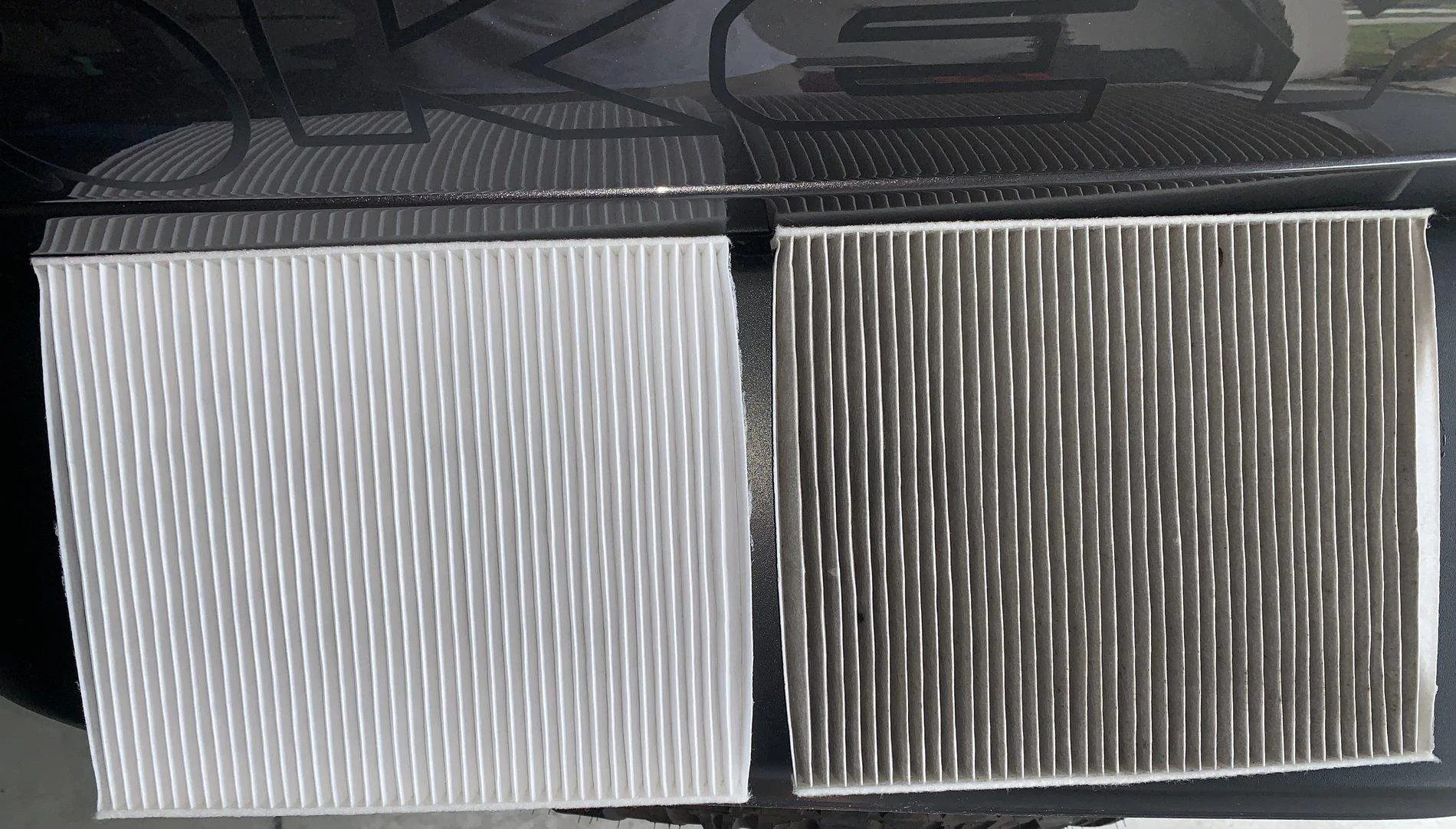

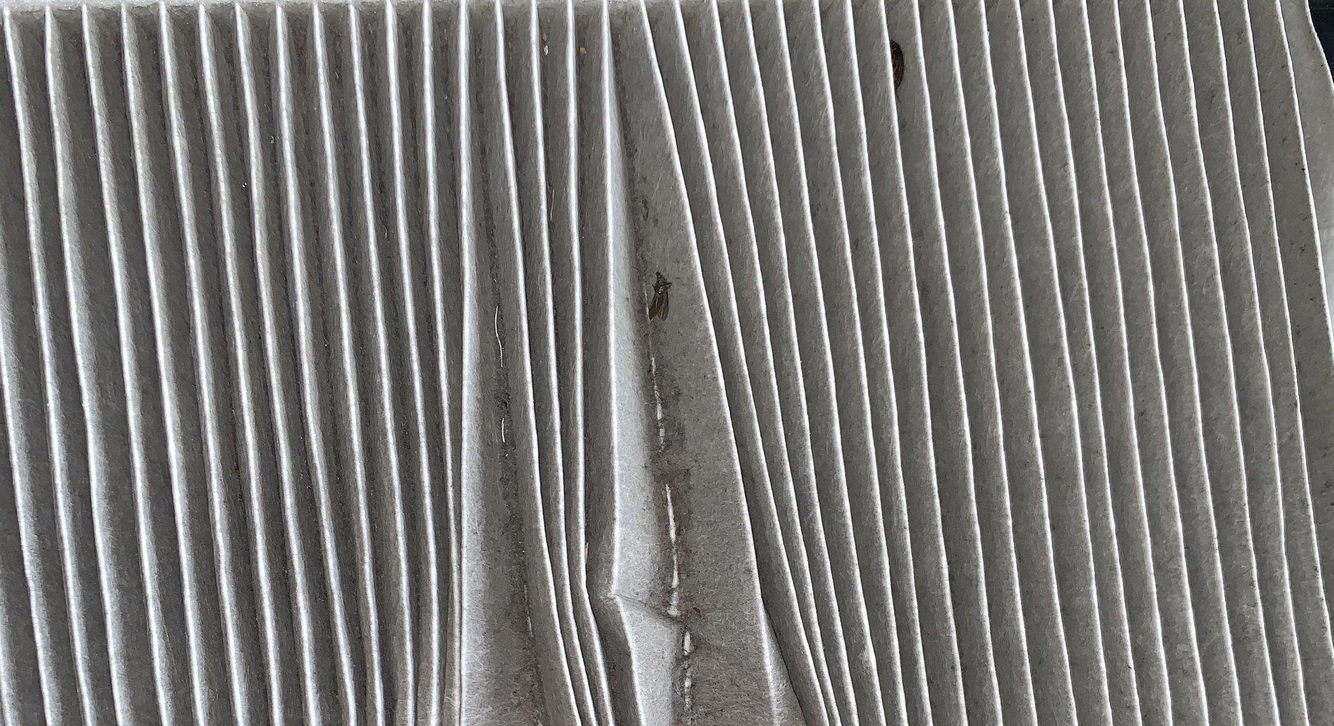

BEFORE AND AFTER:

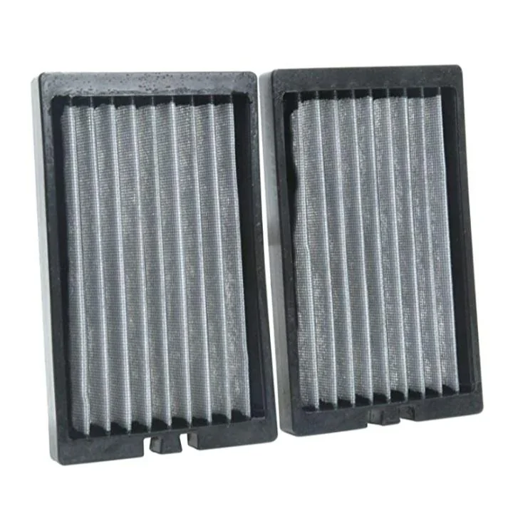

I think the K&N is a 2 piece filter, so you put one section in and push it to the passenger/right side to get it around the corner. Then you put in the other part on the left/dirvers side to fill on the rest of the filter compartment

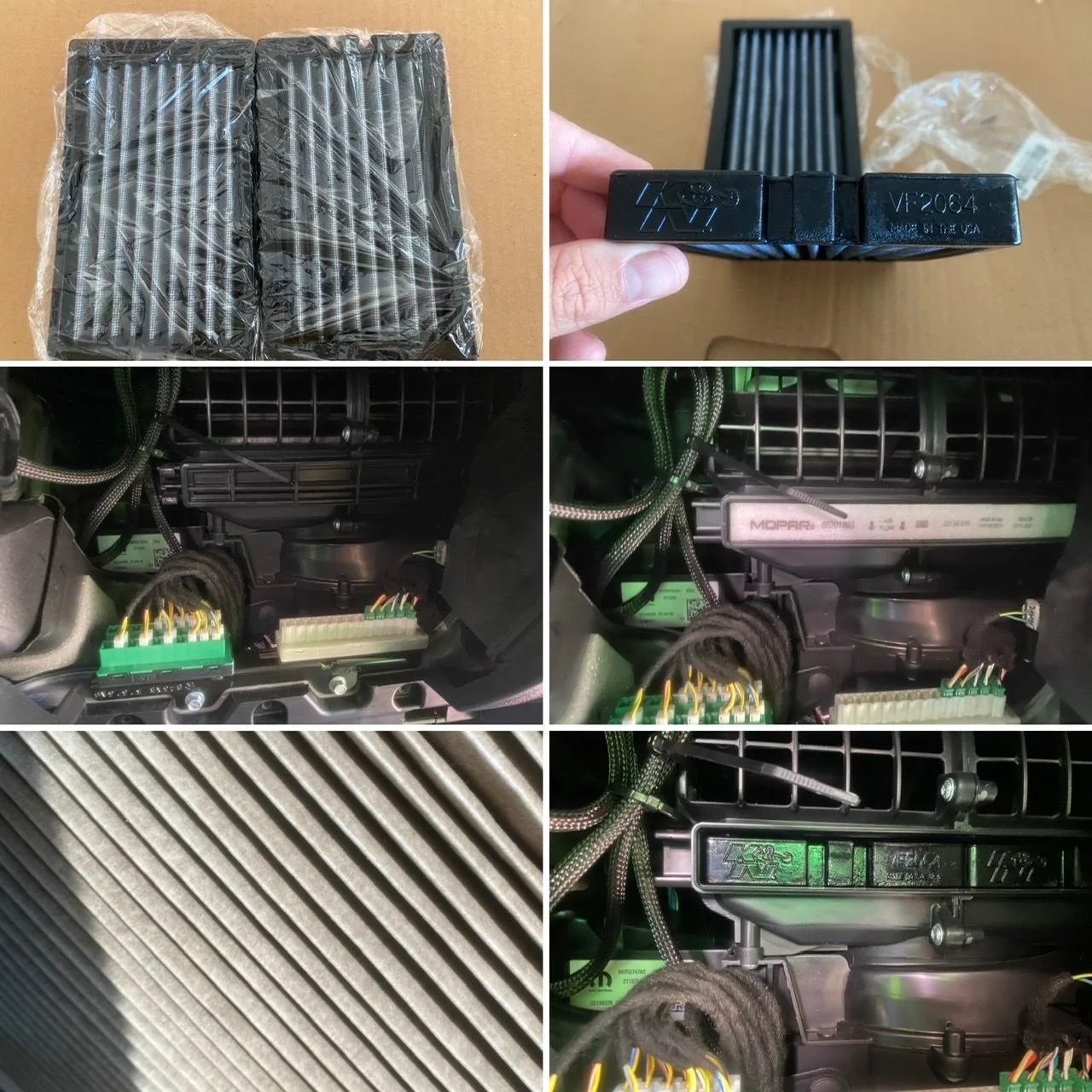

From what I've seen of the installation(was either a video or the instructions), you put the one in and slide it to the right and then put the other one it. I'm curious how tight the fit is though. I'll go ahead and order one from Amazon. Hopefully I remember to take pics before and during the install.

Very simple install and they fit tight but not too tight together that it was hard to get them in. Yes it’s a two piece. Probably the hardest part was getting the door back on that holds them in there, and it’s not the filter but just the awkwardness of how the door goes back in.
