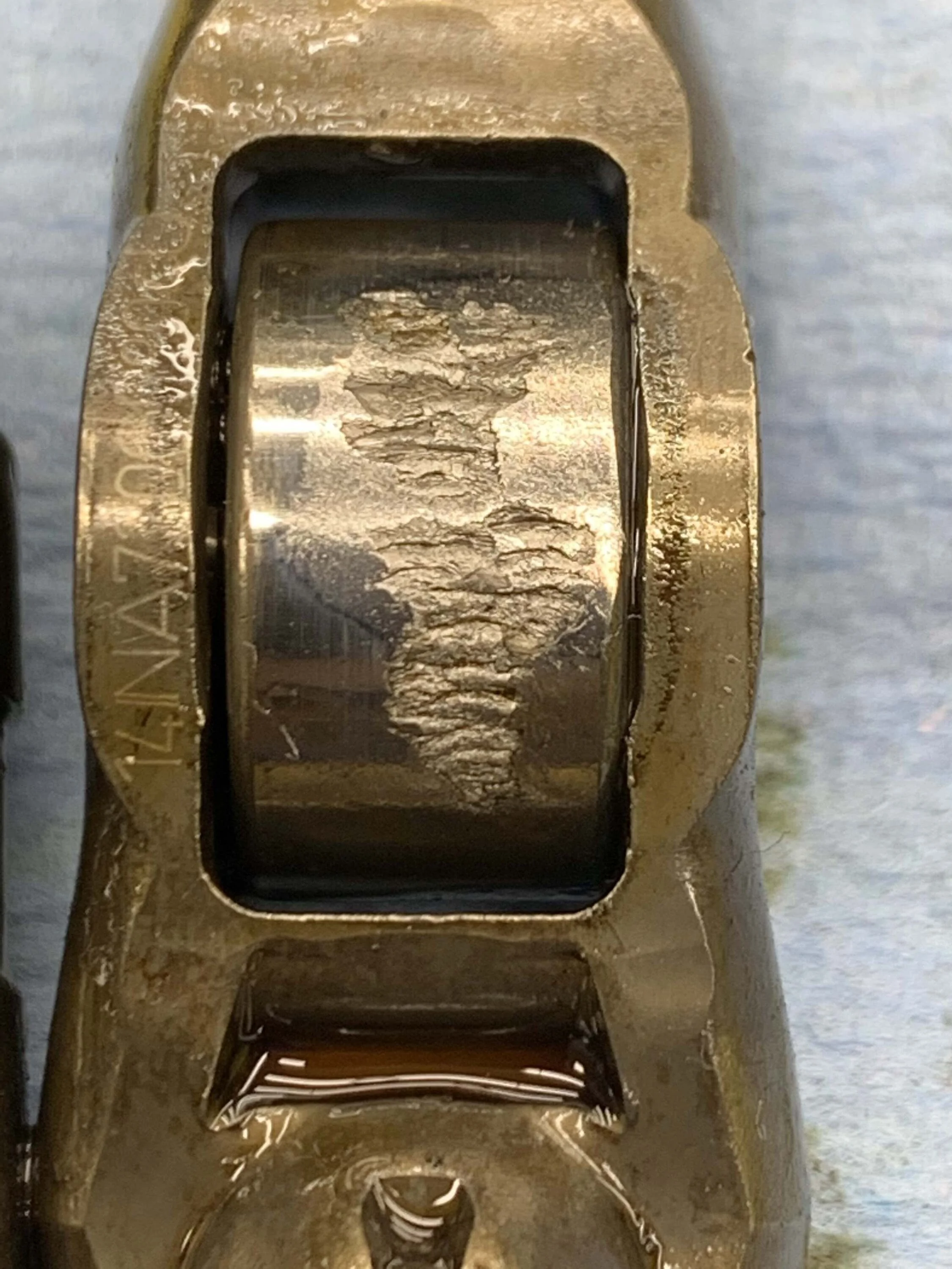

The 3.6 has been an issue for oil cooler leaks and roller/cam failures since it's introduction. It's been commonplace for almost 15 years in Jeeps, it's not a maybe, it exists.
The 3.6's VVT and VVL is electronically controlled via solenoid and via hydraulics after the solenoid does its thing, it is not anywhere near the same as 90s VVT.
The 2.0 and 3.6 don't have a 20% complexity difference either. They're damn near 1:1 for complexity. The only thing the 2.0 has that the 3.6 doesn't is a low pressure coolant circuit for the turbo. In fact, the 2.0, having only 60% of the cylinders of the 3.6, may be less complex. Remember the 3.6 runs 4 chains across its timing setup, has twice the number of prone-to-fail roller/cam combos, plus the janky seals on the oil filter/cooler housing, plus twice the number of head gaskets, and on top of all that the PUG engine is pushing compression up to 11:1 on an NA engine. The 3.6 is not a simple engine by any stretch of the imagination.

The 2.0 is significantly more complex to the 2.0. Direct injection, turbo charged, with an additional cooling loop. Just taking the valve cover off takes longer than taking *both* off on the 3.6L.
So Jeep designed the 3.6 for easy valve cover removal but not the 2.0. I wonder why...
