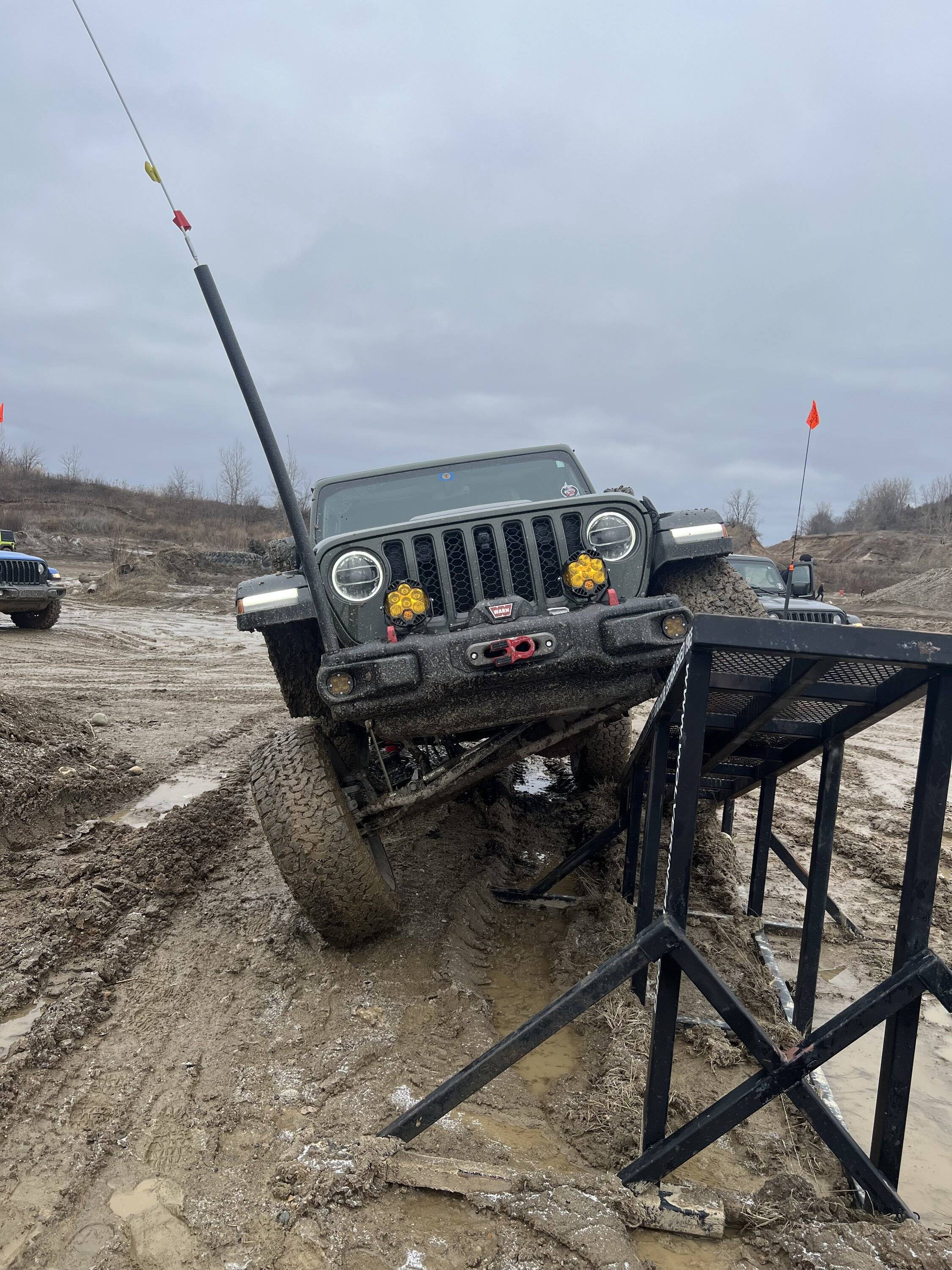

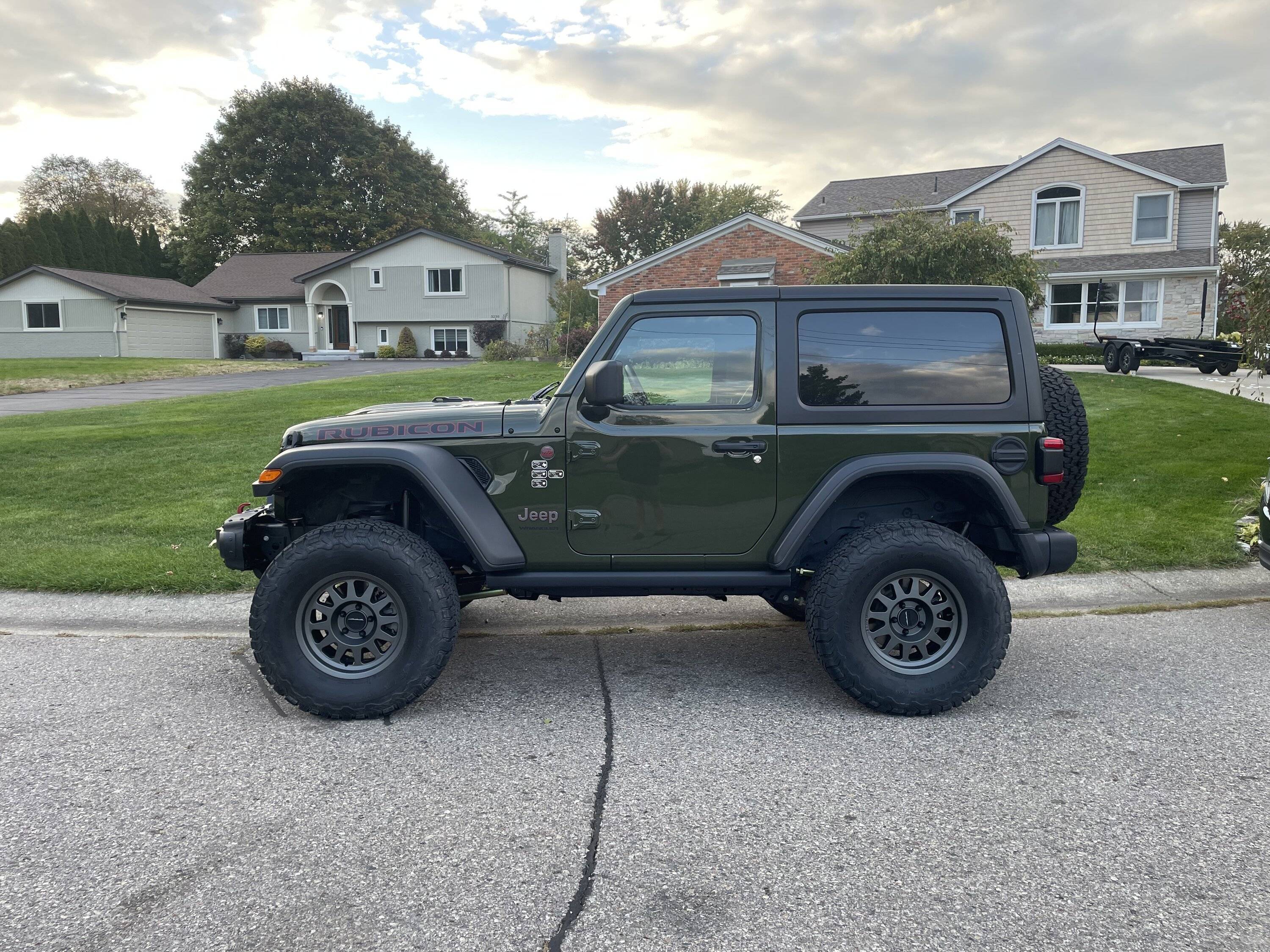

I appreciate all the information, it’s good to hear from someone who’s ran both MC and RK. I was concerned about the ride difference when loaded and unloaded, but it sounds like that won’t be an issue.
My goal is to run 37’s, from what I read that’s all l would really need to clear them. Which is why I chose the 2.5’ from Metalcloak, Rock Jock only offers a 3.5’ lift. Do you think it would be beneficial to opt for the 3.5’ from MC? I would also swap out the drive shaft of course.
Just depends on your preferences for lift height, as there are pros and cons to both.
With super long shocks like the Rocksports, you’ll still have plenty of droop that you won’t have to worry about less up travel limiting your flex off-road. Also, the lower height gives you a better center of gravity for on road manners and off-road on steep or off camber climbs.
Some negatives are, depending in how much gear/weight you run, you might find yourself hitting the bump stops more often than you’d like, or that you want/need to gut/trim your fender flares to regain some of that up travel. Also, your break over, approach, and departure angles won’t be quite as good as if you had that extra inch of lift.
I don’t plan on gutting my stock fenders because I am really happy with the way they look from the factory and my compressor sits right behind the driver’s side fender liner, so I can’t support most aftermarket options anyways. I do have my eyes set on some high clearance aluminum bumpers at some point, though, and will probably see if I’m happy with the 2.5” lift and 37’s before I swap springs. Both the 3.5” and 2.5” MC Gamechanger are identical aside from the spring lengths, so it’s an easy change.
If you run a smaller 37 like BFG’s, you may not need the extra bump stop or feel like you need to trim the fenders at a 2.5” lift, and to help with approach/departure angles you can always swap to high clearance bumpers.
Essentially, the whole thing is a balancing act that is going to depend mostly on what on-road and off-road characteristics are most important to you, as well as what other mods you may want to add or avoid as you continue building and using your Jeep.
