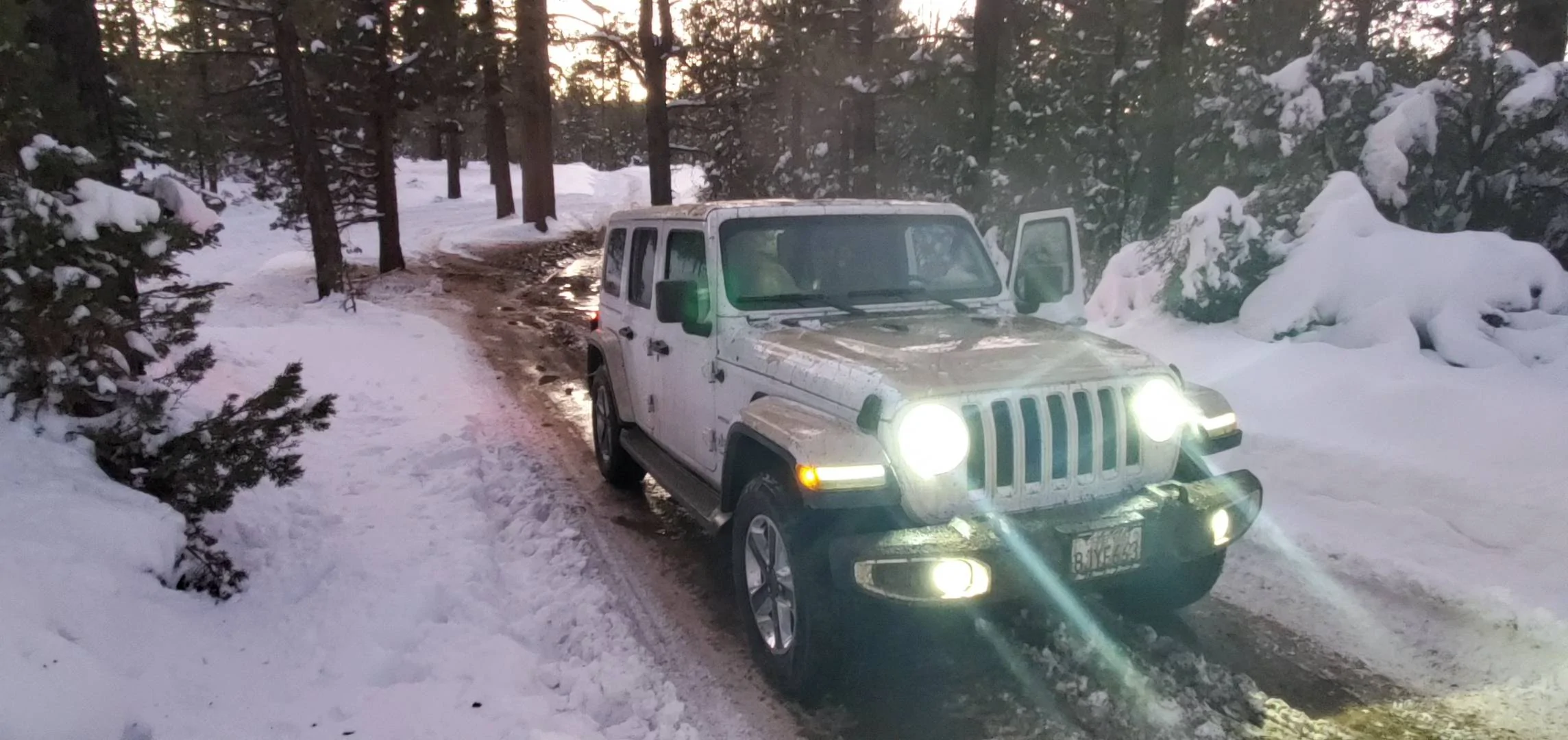

Sorry, I forgot to update I went with the KO2 35's. She does rub fenders at flex but not turns.
Needless to say a lift and steps are on the way for my wife.
We have property in texas now that we do some off-roading but not as much as when we lived in California for work.

I can see that there is not a whole lot of space between the tires and the fenders. The Rubicon fenders are higher than the Sport and Sahara ones. If you still have rubbing after the lift, you can consider those. Members sometimes sell new ones when they switch to after market fenders.
What wheels did you get? What offset?
