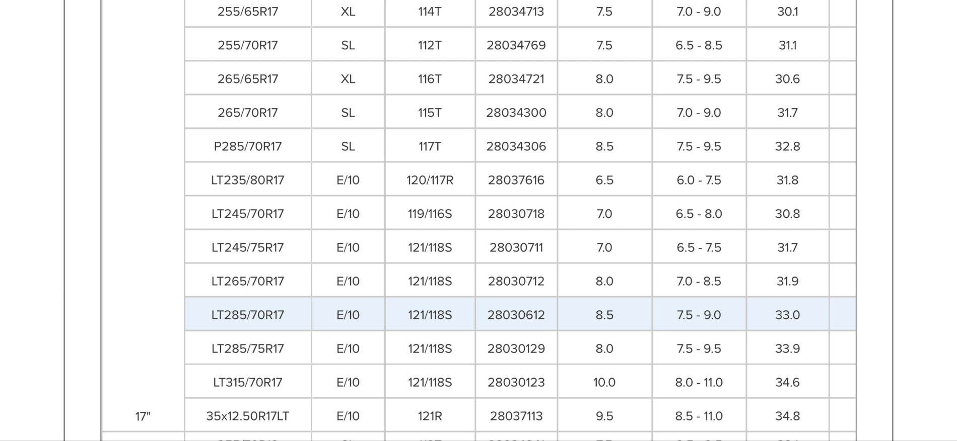

I’m trying to understand the compatibility of the tires/rims combo. From the chart above, seems min/max width for a tire that can go onto a 7.5” width rims is 205mm to 235mm so why does the factory standard wheels/tires size outside of this range?
Wheels are 17x7.5” and tires are 285/70R17.
I’m new to all this and try to search the internet for answers but can’t find an explanation. Please help, thanks in advance.
