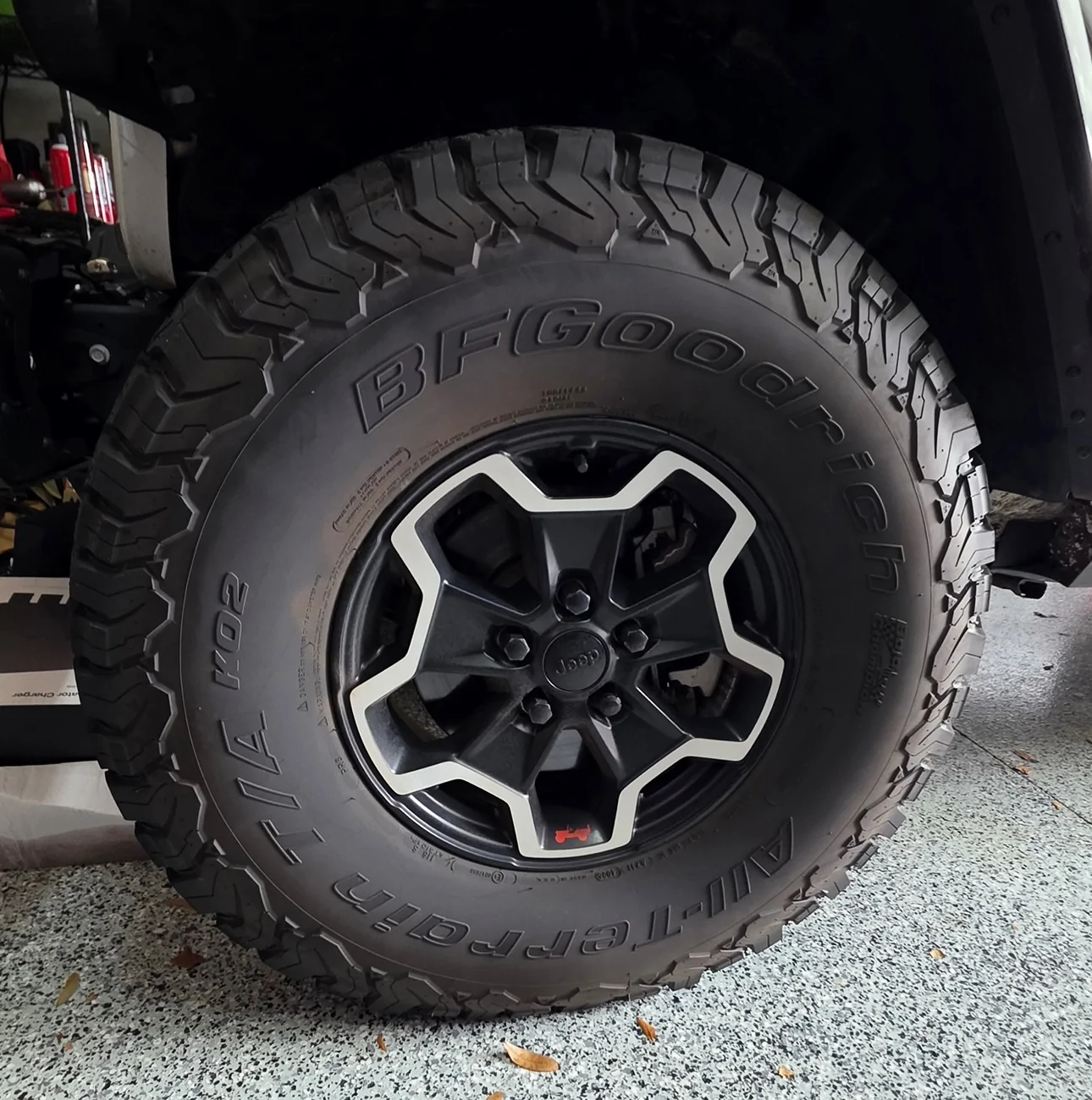

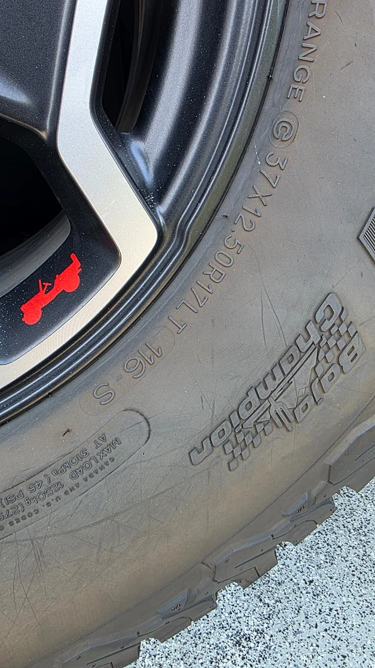

I have the 37" bf Goodrich KO2s on the 2023 factory Rubicon rim. Discount tire did the installation. At the time, DT's own website showed they were approved for 7.5" wide rims (it no longer shows that). Regardless, with the diesel I have had no issues. MPG is still pretty good at around 19-20 combined. At first with no lift, now with AEV 2" spacers.
And these were installed without any spacers nor life on a JLUR w/diesel?
I have not installed wheel spacers with these tires and have had zero issue regarding that. Months after the tires were installed, I did install a 2" spacer lift because I had read here on the forums that I would get rubbing if I went off-road with these particular 37s without a lift. I really like these tires because they are not a true 37, and they are some of the lighter tires you can buy in this size.
