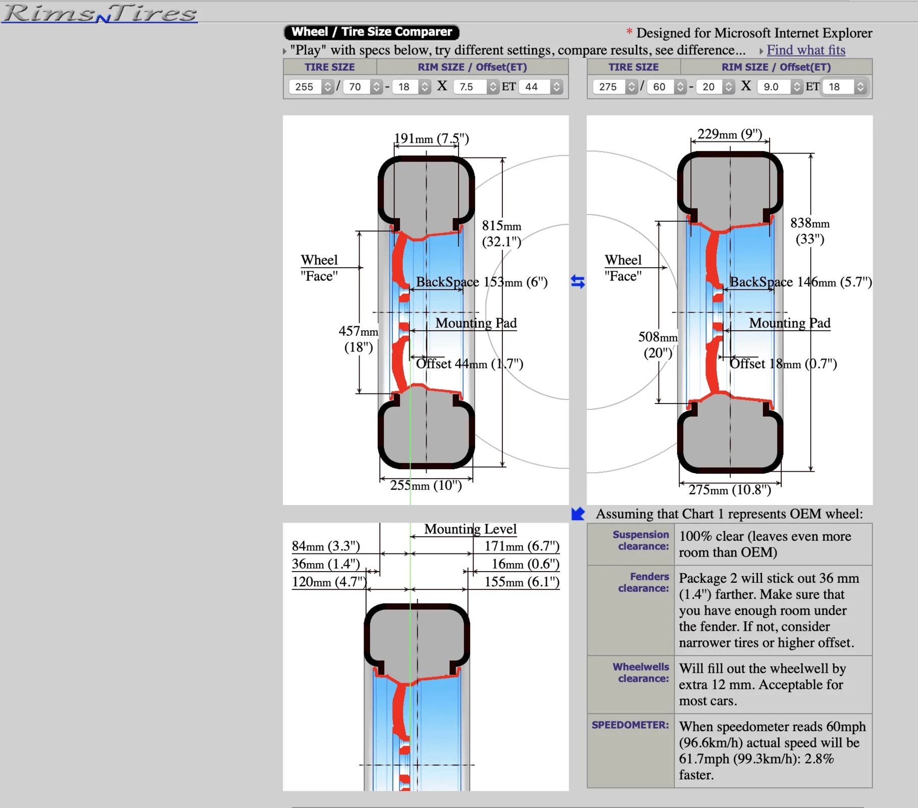

Here's the link w/ both sets entered, should work ok for what you're wanting.new wheel width would be a 20x9. i'm on that link, but honestly I don't know what I'm looking at either (or for) to determine whether it would work or how it would look
https://www.wheel-size.com/calc/?wh...60-20X9ET14&fcl=2in&wcl=1.25in&scl=2in&sr=0in
