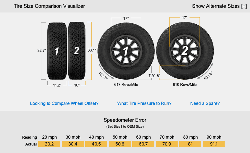

I want to get a slightly larger, more aggressive tire on my stock 2 door sport. I have the 3.6 and the auto. Of these two tires, which is likely to have the least impact on my current driving dynamics? They are the same brand and style tire. Price is almost identical. I prefer the look of option 2.
Option 1: 285/70/17, Load 117T, 50lbs.
Option 2: 255/80/17, Load E, 51 lbs.

Do both tires weigh the same? If so, the shorter wider one will impact your speedometer the least, but the extra width will increase drag on the highway. Whether or not this is noticeable is tbd.
Personally, I would go with the taller skinnier one because every bit of ground clearance helps off road and airing down the tires has a greater impact on the contact patch than just buying a wider tire will.

The 285/70r17 is the stock Rubicon size. It will ride fine. Make sure it is a load range C tire for comfort. I see the ine tire is load range E. Much stiffer tire.

A 265/70/17 (31.5") will give you the same diameter as your current 245/75/17s, with a little more width. There will be no impact on driving dynamics.
A 275/70/17 (32.2") will give a a slightly taller tire and a little more width with little noticeable impact if you stay with a load range C tire.
A 255/70/17, although a little narrower, will give you that same 32.2" height, but is far easier to find in P metric and load range C.
285/70/17 (32.8") is about the tallest and widest you can go with your stock Sport suspension. Many do that size and are happy with them.
The 255/80/17 is an interesting tire size. It will fit and will not impact your driving dynamics much. My only concern would be in an emergency lane change or and abrupt tun at speed. The narrow tread combined with the taller sidewall will allow for more sidewall flex when cornering/turning/sharp curves, and that will affect the handling dynamic. On the short wheelbase 2 door, that would be something to consider.
All of those tire sizes will fit on your current 7.5" wide wheel with no issues.

Load range is what you'll notice most. Stick with Load Range C. Maybe Load Range D. Load Range E is a very stiff tire and you'll need to be rather heavy to take it out of the "too stiff" zone.
@The Last Cowboy 's advice is spot on. I'll just add that 285/70R17 will rub at full articulation (but only at full articulation so many get away with it). Also 255/80R17 is what you want for winter. Tall narrow pizza cutters. It won't be the best for summer, especially mud.

Some very thorough responses. Thank you. My goal is to maintain as much of the current driving characteristics as possible, while getting a slightly more aggressive aesthetic. Is there a reason the taller, skinnier tires all seem to be load rage E? I like the look, but I'm concerned about the weight and stiffness you speak of.

The taller skinnier tires are load range E because they are popular on dually trucks, where a narrower tire is needed. .
