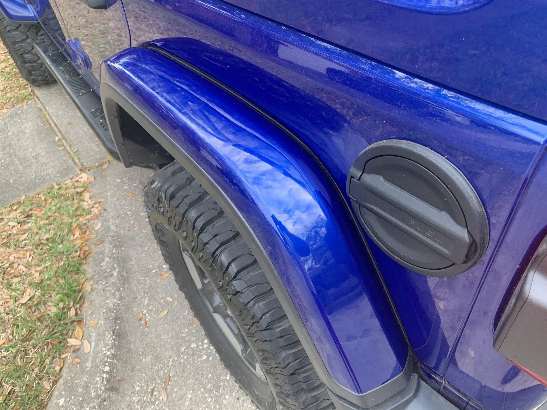

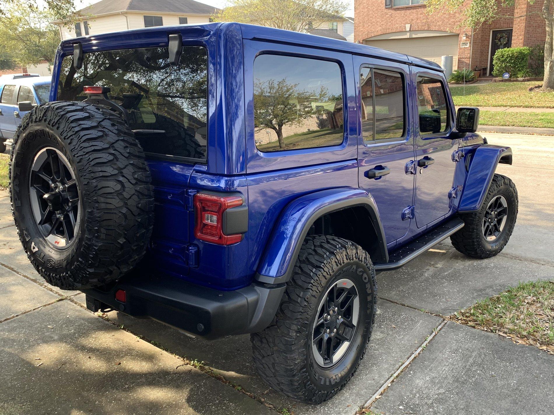

Those will fit and work. However they’ll fit much like mine do in the photos. If you use spacers they’ll stick out more. Also, some have reported that tire shops won’t mount 12.5” tires on 7.5” wide wheels, but they will mount 315mm tires on them which is 12.4”.

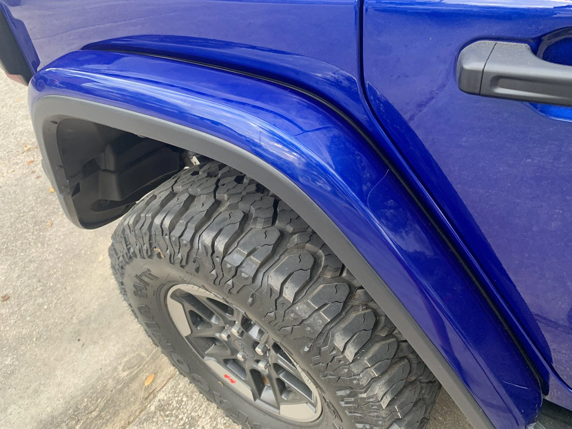

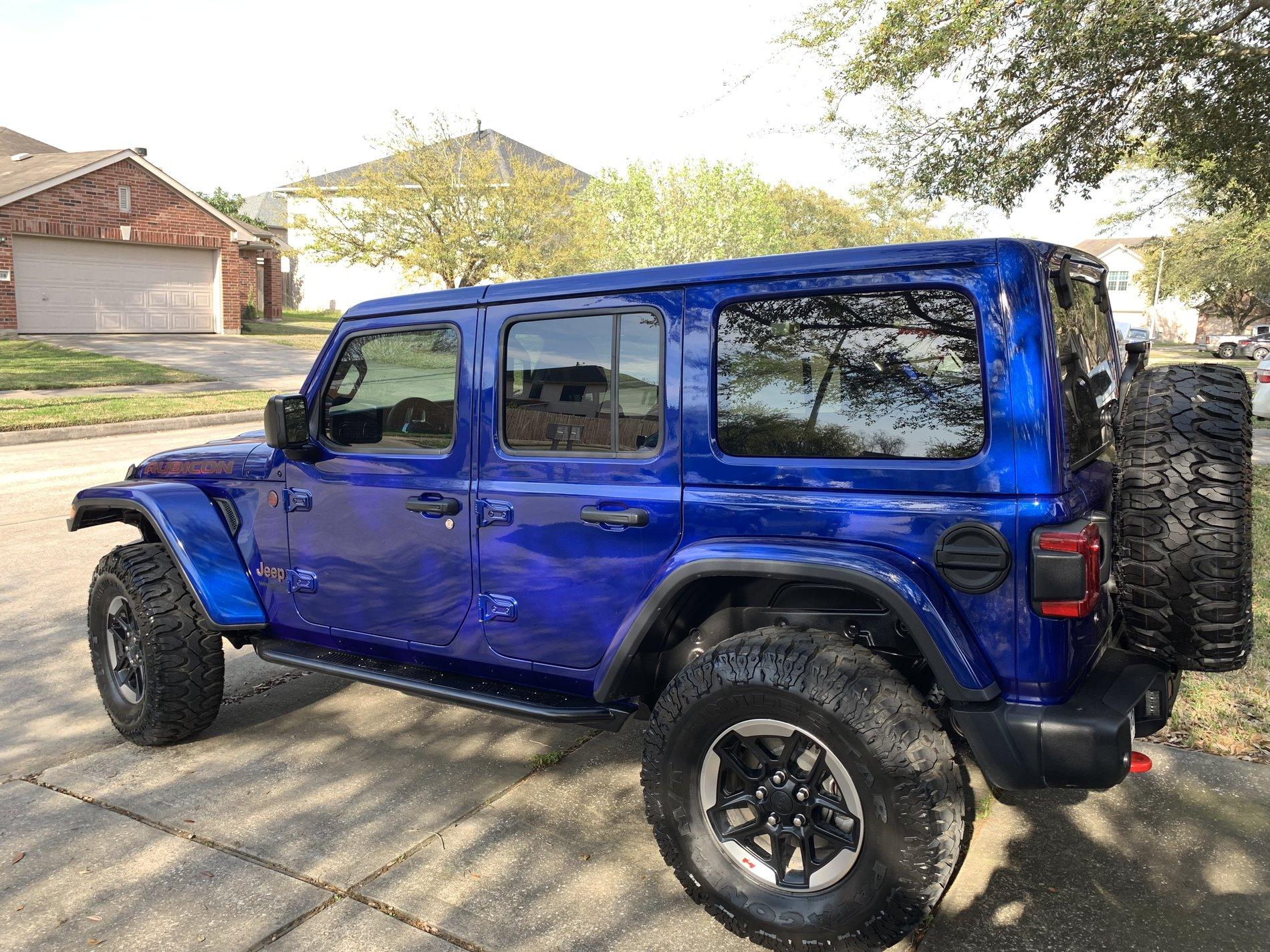

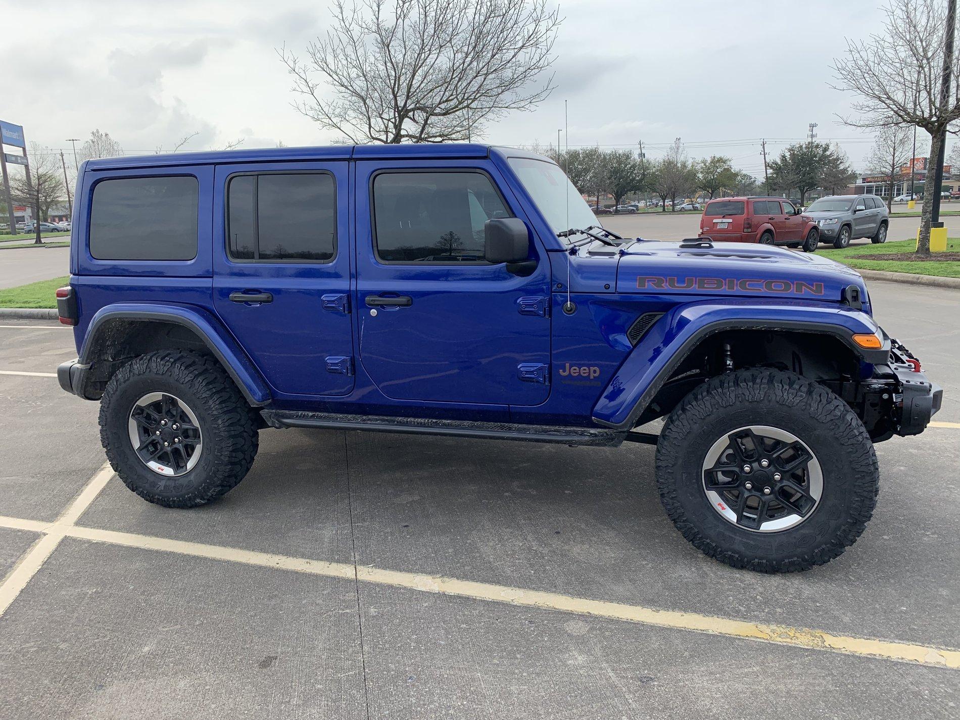

I am running 315/70/17 Milestar Patagonia M/T's on stock JLR wheels:
Jeep Wrangler JL Noob question - same wheels different tire size? upload_2019-4-8_10-25-18
Jeep Wrangler JL Noob question - same wheels different tire size? upload_2019-4-8_10-26-13
The size tire you mention sounds too small, unless you're looking for a 31.5" tire.
