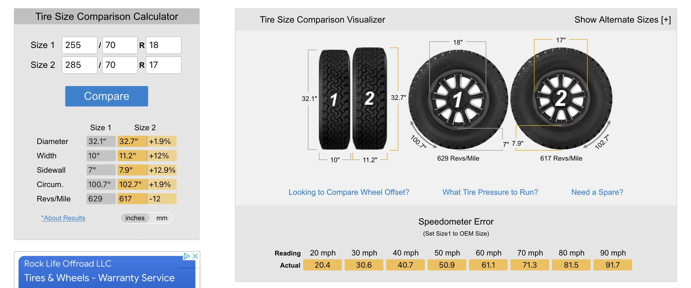

Sarah comes standard with 255/70/18 tires on 18 inch wheels. (Obviously)

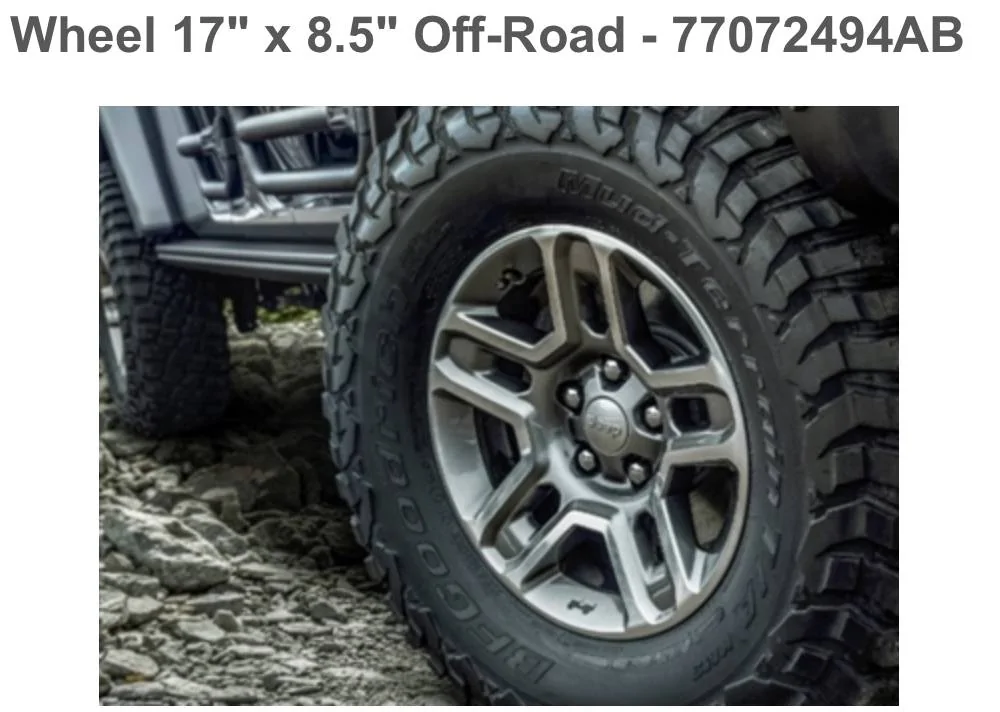

I want to upgrade to these Mopar rims - these are 17 inch 8.5 inch wide wheels.
So comparing tire size it looks like the narrowest fit would be a 285/70/17. My question is will these tires and wheels fit on my jeep without rubbing etc.
Can anyone help me out here? Some pics below for reference.
Thanks in advance for the help!

If you use this calculator it will overlay your old and new wheels/tire combo and tell you exactly how much larger the new tire is. https://tiresize.com/wheel-offset-calculator/
Just measure it yourself from the old tire and make sure you have enough room, especially with the front wheels turned as much as they can. You can do the same with the spare.

Yes, it will fit fine. It's a 33" tire on Mopar wheels. No issues. Maybe very slight rubbing at full flex but you'll have to check. Around town? Zero issues.
The stock tailgate will be fine as well. It's rated up to 85 lbs, not 50lbs like stated above. I ran 106lbs on it for 6-8 months with nonisusesz you'll be fine.

I have these wheels. They fit on the spare tire carrier without any issues. They’ll fit your stock Jeep without any rubbing or spacers required. A 275/70/17 tire will be very close to the same diameter as the stock Sahara wheels, slightly wider.

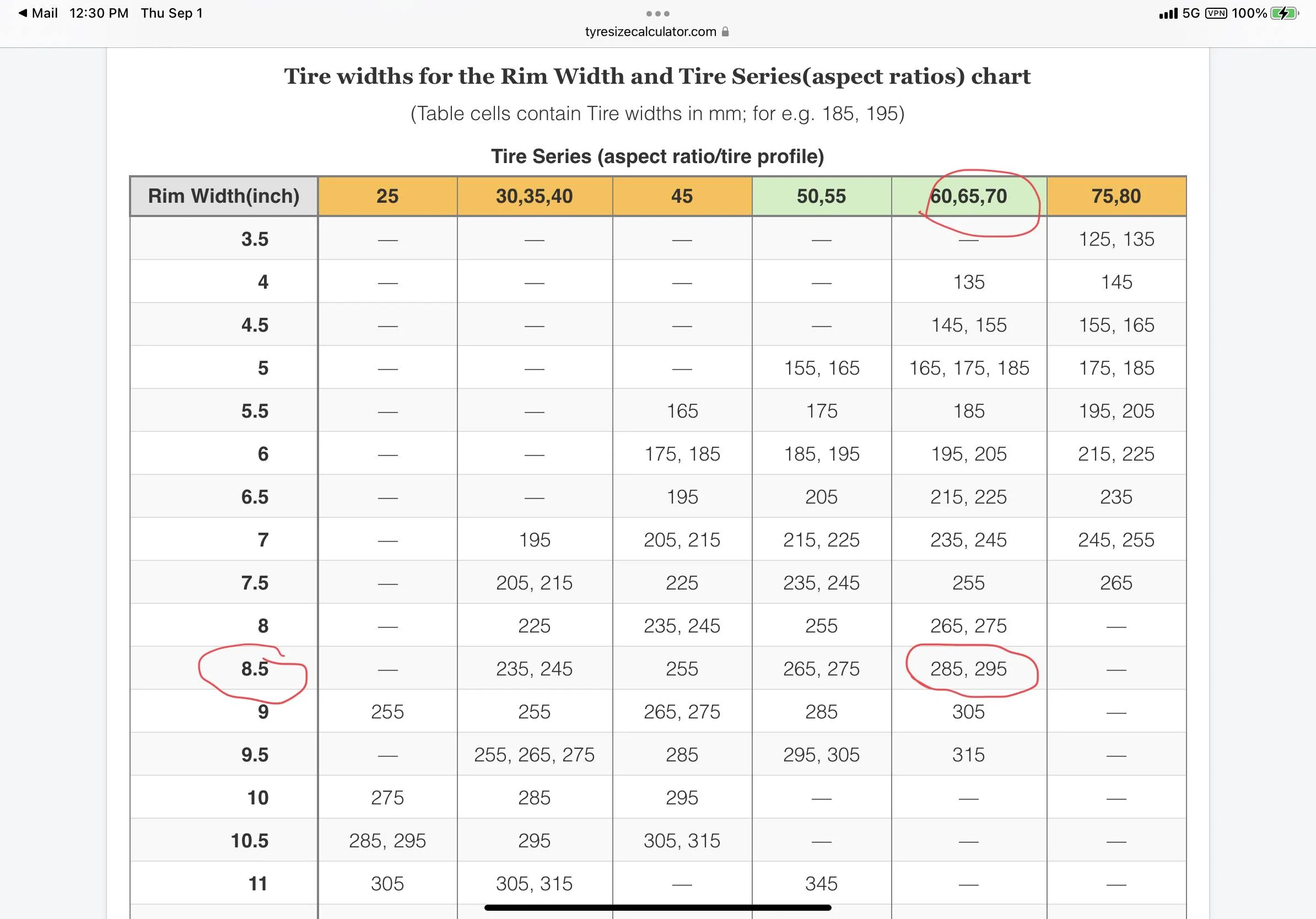

WIll a 275/70/17 fit on a RIM that is 8.5 inches wide? Really appreciate all the help from everyone!!!
Yes. It’s about as wide as you’d want to go in 275 tires, 9” might be a bit too wide.

@jeme, yes you can safely mount a 275/70R-17 tire on a wheel that is 8.5 inches wide.
Thank you Discount Tire. You all are who I use locally here is Florida. You guy do an incredible job and I will be ordering my K02’s from you soon!
